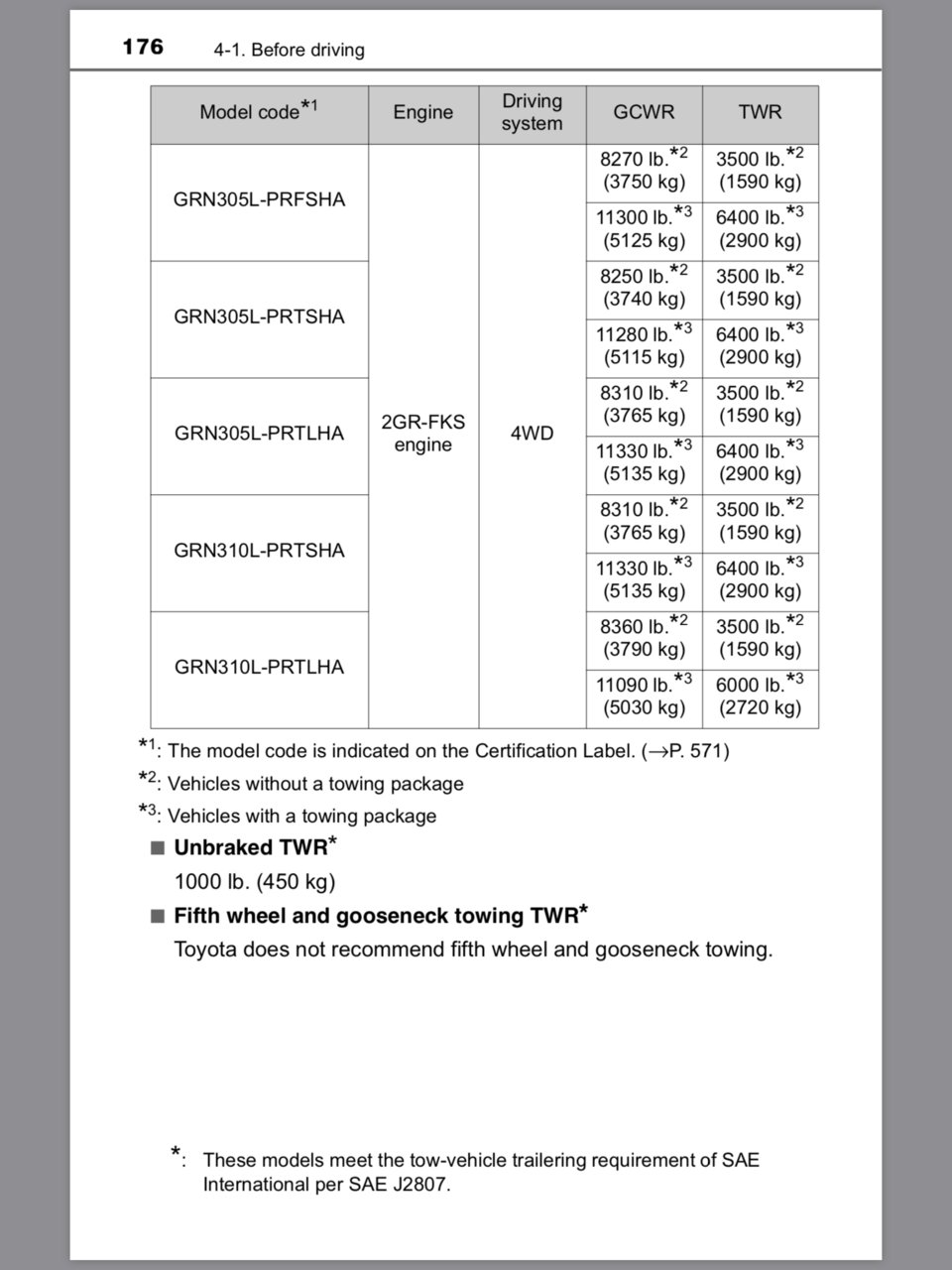

    Hate to disappoint you but 1000-2000 lbs. without brakes is pretty normal for small and midsized trucks. My 2017 Tacoma’s manual states unbraked TWR is 1000 lbs.

    I think you're the one mixing apples and oranges. See post #8
    From what you are specing, the Ranger is has a higher (stated) capacity both with and w/o a brake equipped trailer.
    And don't conflict state law with vehicle capacity. State law relates to the trailer, not what it's hooked to. So basically the vehicle specs for your comparisons both are more conservative than the law requires. Not sure that's bad. Since most folks can hardly drive well, much less tow well.
