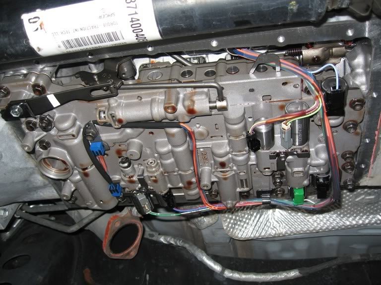

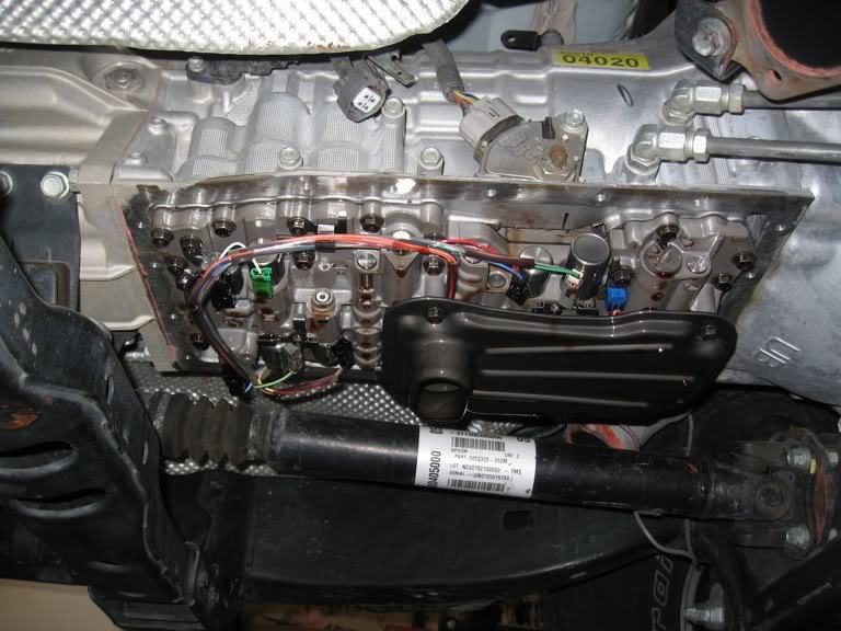

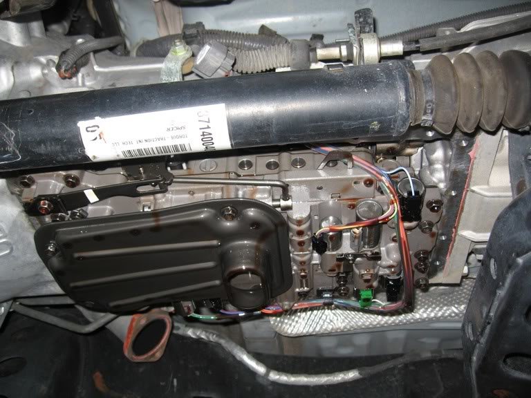

    Have any of you actually seen or touched the filter with your own eyes and hands?
    I have. And it is not a filter. It's a flat shaped pan with absolutely zero media of any type to filter with. Im not even sure why it is called a filter.
    Take it out and run water through it. It is hollow.:p
    The pan has a few magnets at the bottom where you will find very very fine metal "dust".
    I did my first change at 67K miles. 37K of those boosted. Fluid was obviously dirty but still very red. Refilled with Amsoil ATF after I had my valve body upgraded by IPT.
    You guys with stock power levels probably have squeeky clean trans inside:p
    I would recommend just draining the 3 qts out of the pan and refilling 3 new qts maybe once every 6 months or maybe once a year. Doing a complete and total flush is most likely a waste of money. Unless you already have 150K+ miles and this is the first time.

    Thanks for posting that photo ... it explains a lot.

    SO, is there a filter OR NOT?
    Nobody, even the pictures from the shop manual proved that there is actually a filter in there.

    That black can supposed to have filter/mesh inside. They all look like it, some have more components some less. How much material you had on the bottom of the pan?

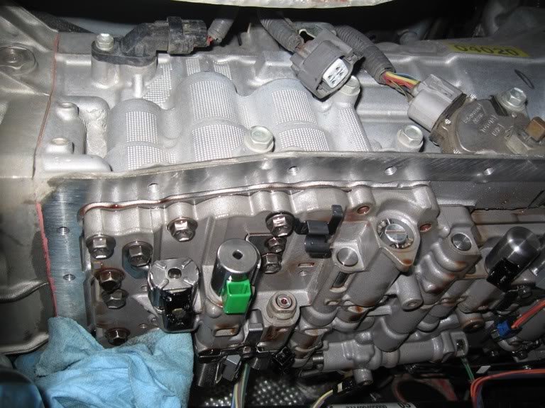

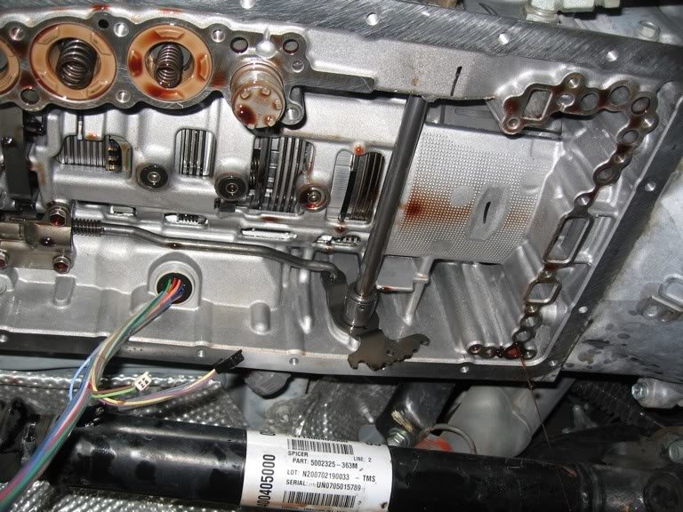

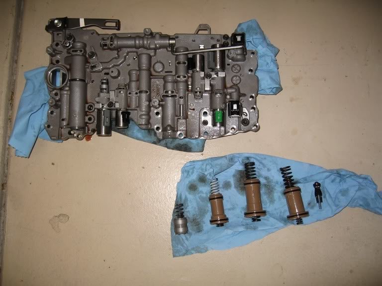

    Well mine was completely hollow. It might as well not even be there. From what I can tell it does nothing:p
    I had a small deposit of fine dust, maybe the size of a dime. The internals looks brand new inside. It was really clean to my surprise.
    Here's the rest of the pictures...
    VB removed, and whats on behind it when it's removed...

    That thing is called a Valve body oil strainer. Im guessing there is some mesh in it, but I havent seen one in person. The ones I have seen, have had a screen type material in them.
