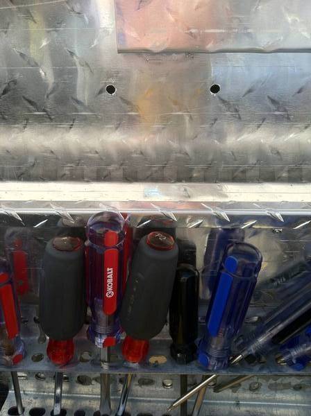

    so first i started out by seeing how far to one side i could put the bike. then i marked where the holes were on the mount and did a little drilling (my favorite thing haha)
    then i proceeded to just mount it up with a couple of screws and rubber grommet-nuts. but make sure you also put some sealant down in there to keep the weather out of the toolbox.

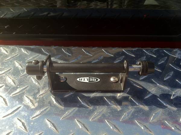

    this is her mounted up and chillaxin
