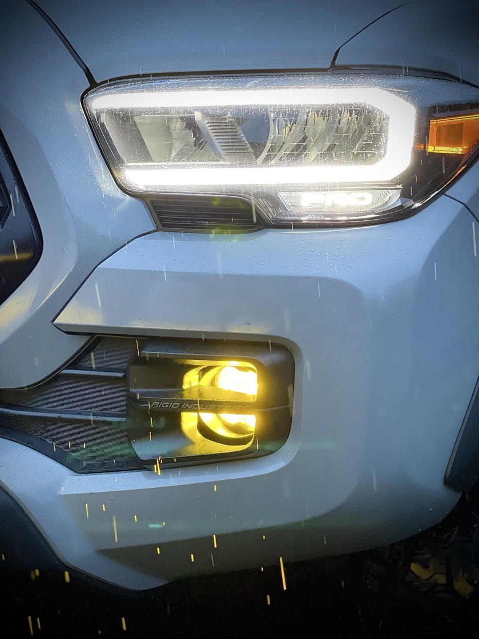

    Exterior:
    -LEER cap color matched cement
    -MESO LED puddle lamps
    -MESO LED mirror signals
    -MESO LED tail lights
    -2020 TRD PRO LED headlights @daveeasaplug and play harness
    -Diodedynamics 30” SS Stealthbar @Diode Dynamics
    -Diodedynamics SS3 Max fogs with modified rigid TRD Pro housings
    -Diodedynamics SS2 Pro ditch lights
    -Rigid flush mount reverse fog lights @daveeasa plug and play harness
    -Carbon mirror covers @tacomalifestyle
    -Seibon carbon TS hood
    -AVS low profile smoke hood protector
    -Viper Cut
    -Hella horns

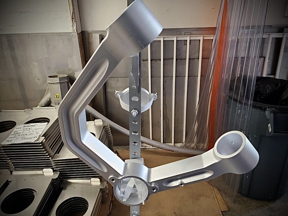

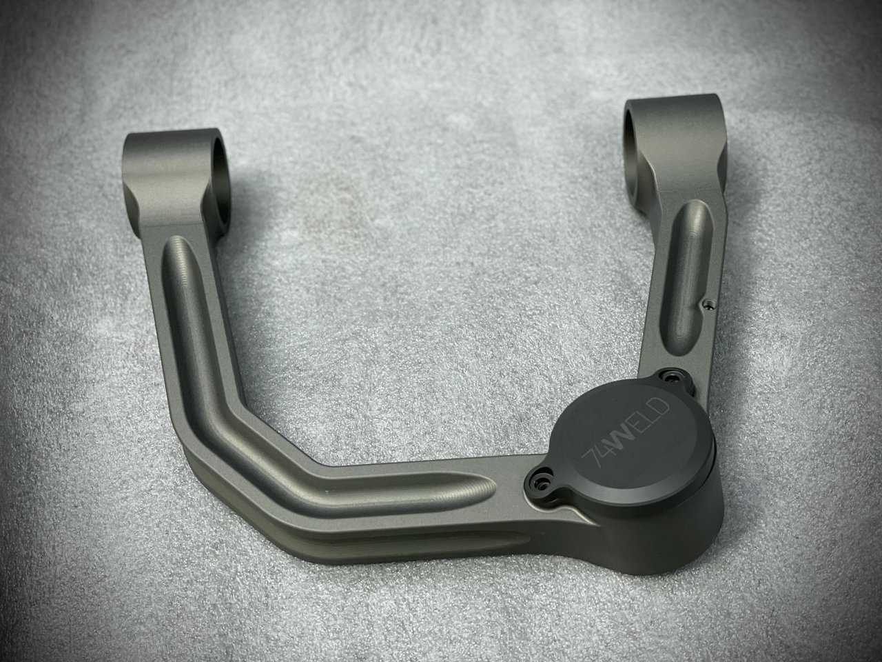

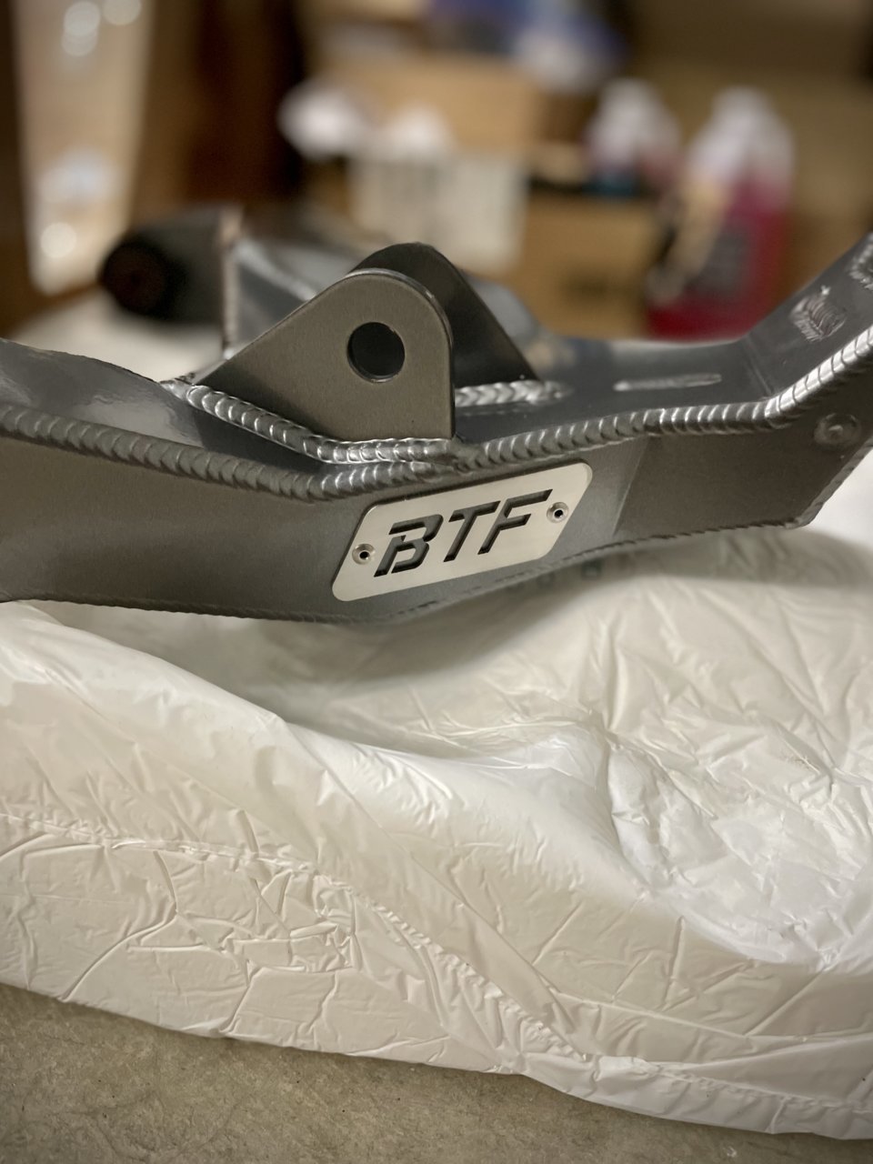

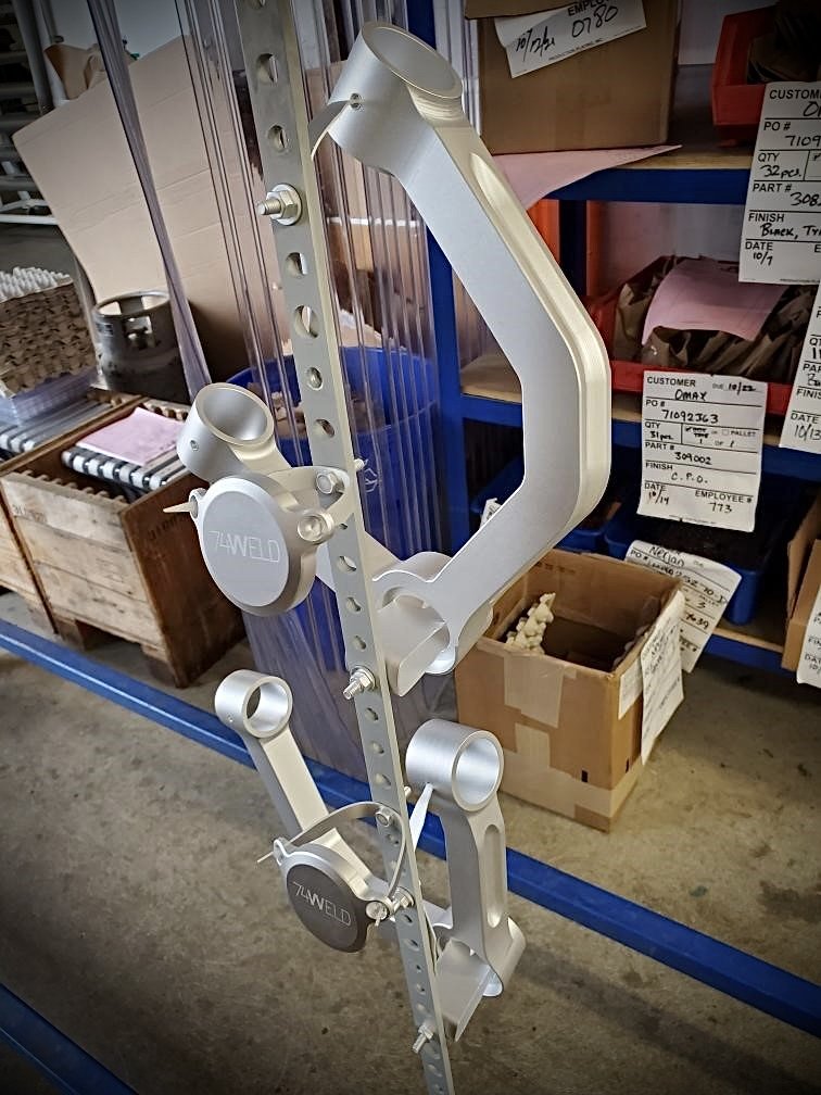

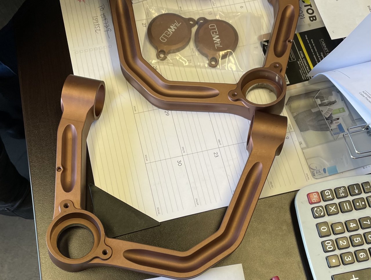

    74 weld would not allow me to order a custom anodized finish on their billet UCA’s. Nothing on the truck matches their bronze finish. So… the arms were taken to production plating in Everett and the bronze finish was chemically stripped down to bare aluminum. The arms were then anodized with the toughest anodizing available - hard anodized clear. The result is a dark grey gunmetal finish. This is how they should have come from the factory in my opinion. Extremely durable. Self healing. Matches any color truck, wheels, springs, whatever. Clashes with nothing. Will post some better pics when I install them next week.

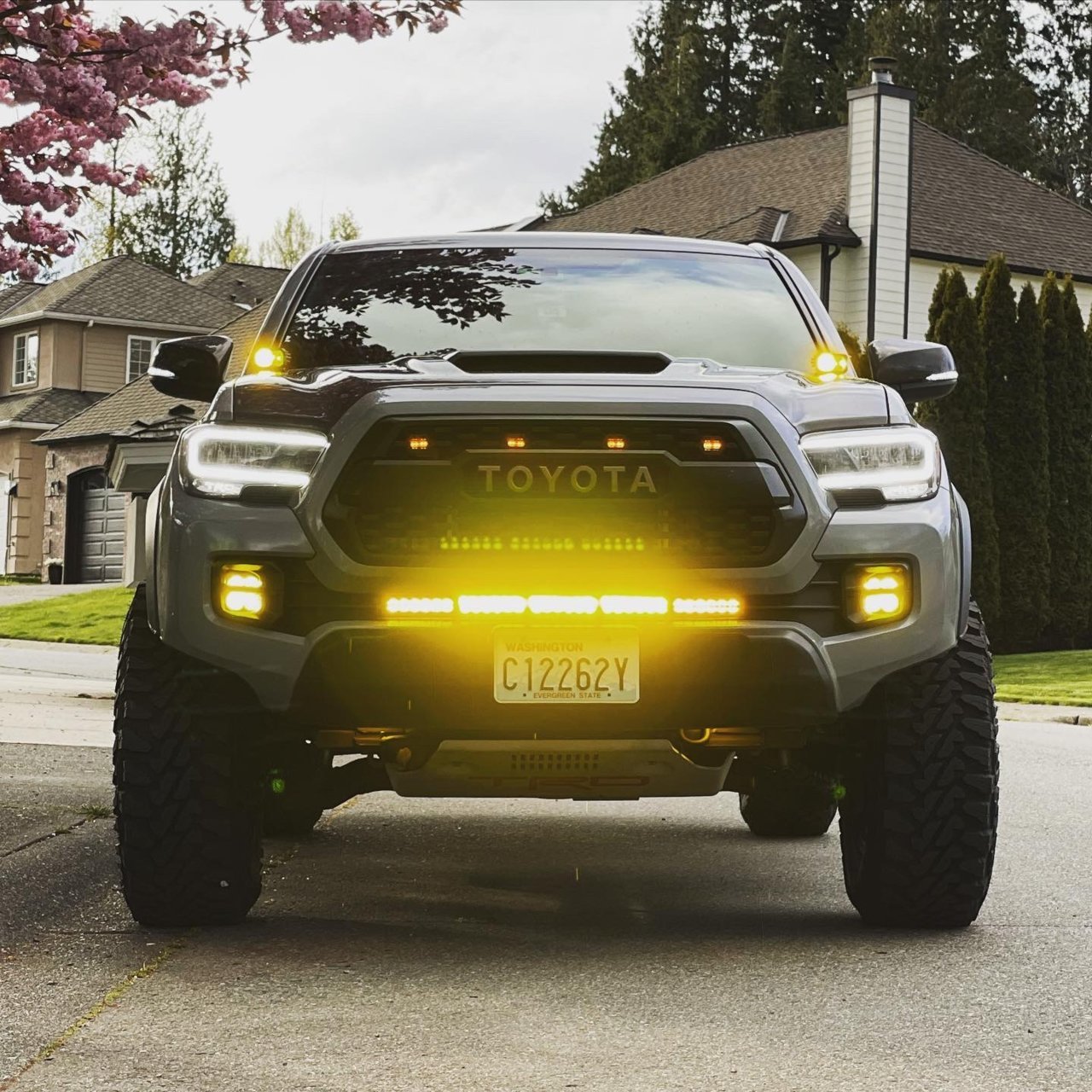

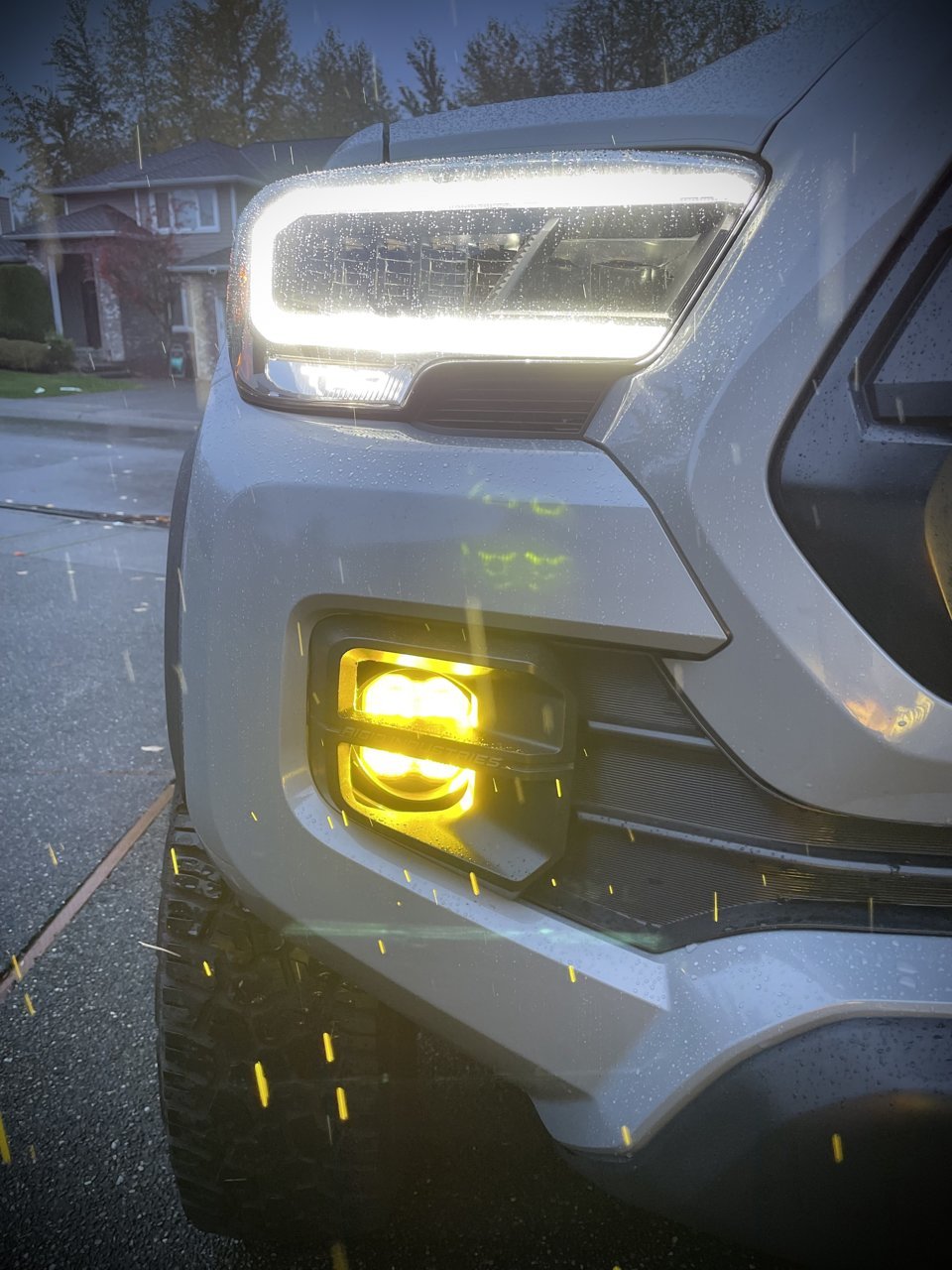

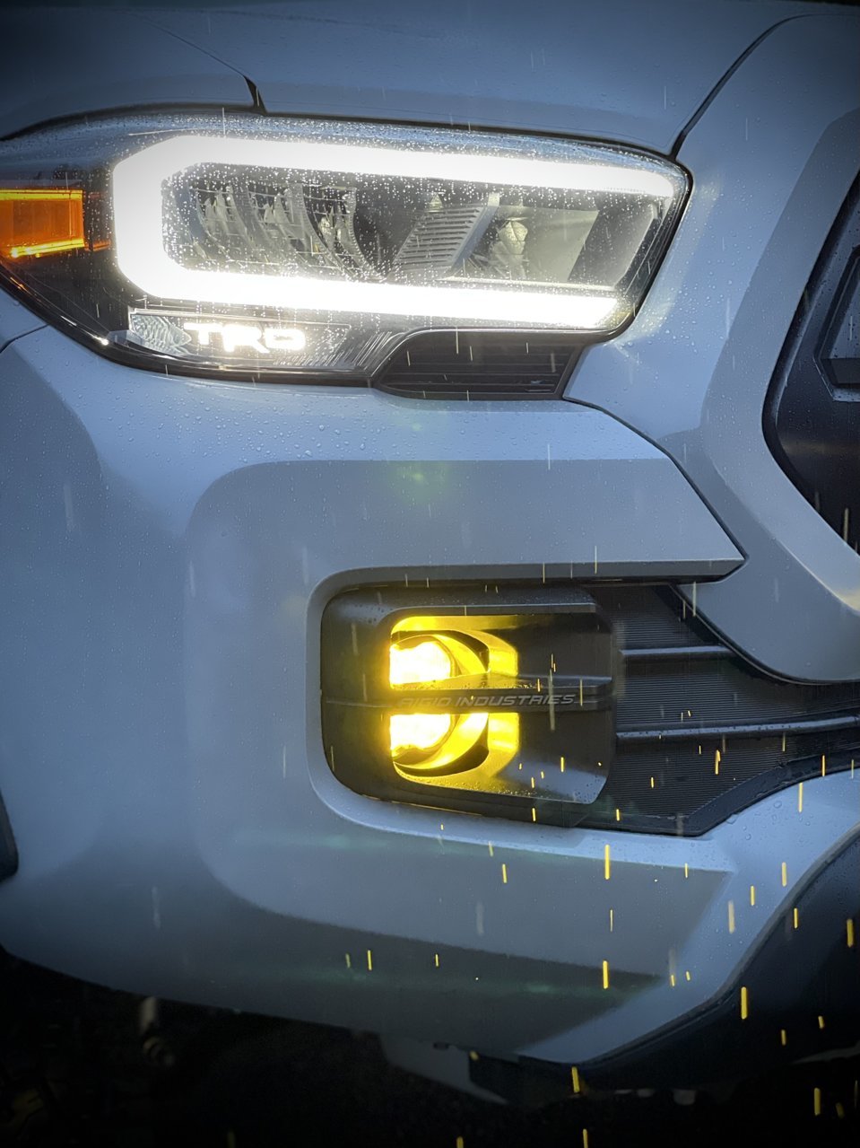

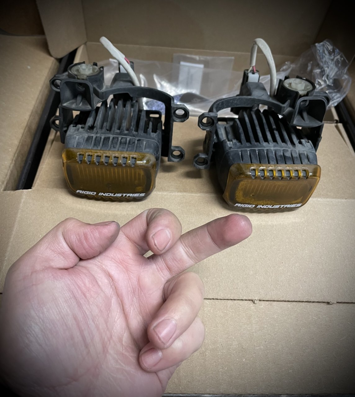

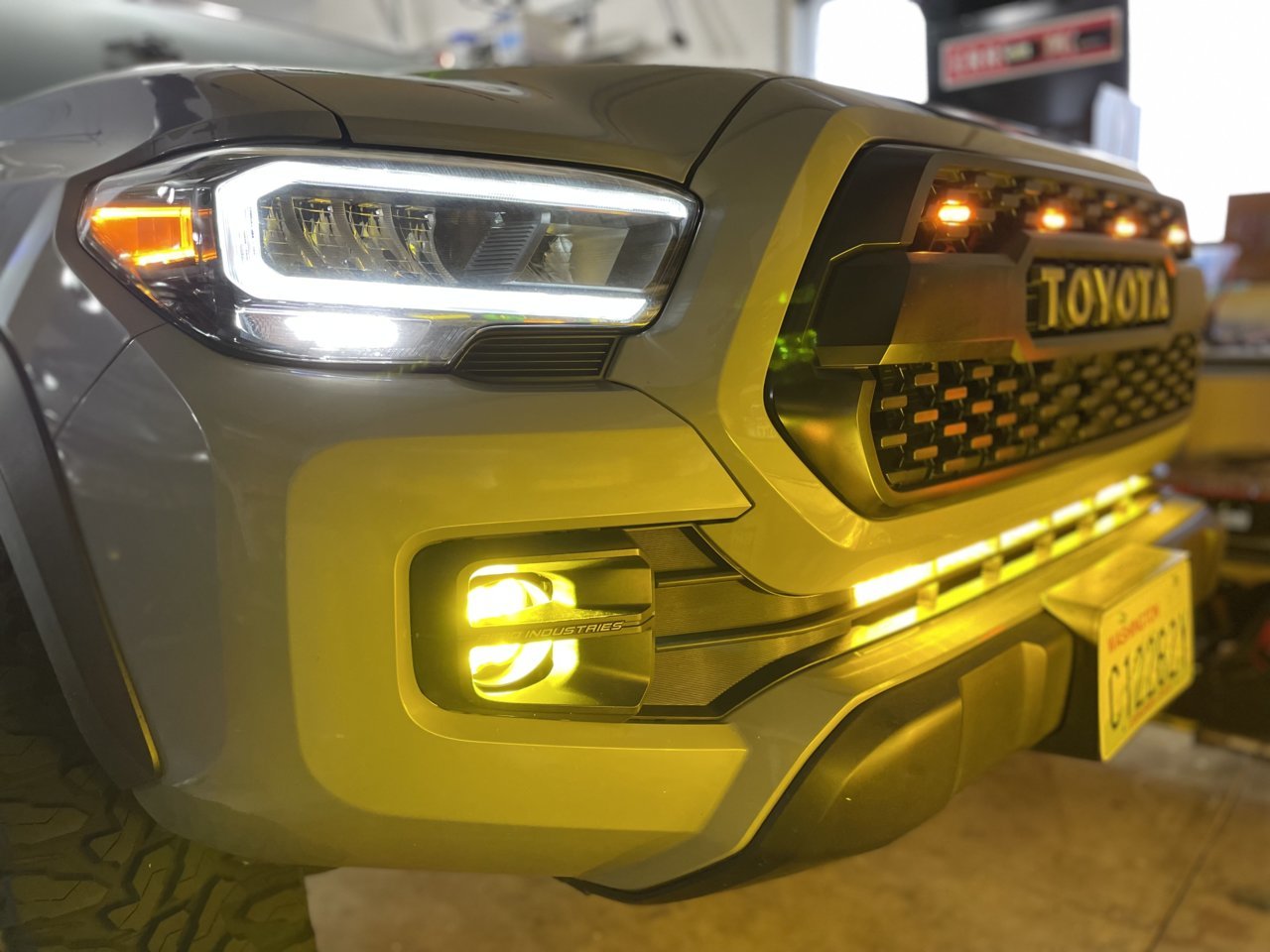

    Dremmeled out the TRD Pro rigid fog housings to accomodate Diodedynamics SS3 Max fogs. Night and day difference. Highly recommended!
    RTweet and mZiggy like this.

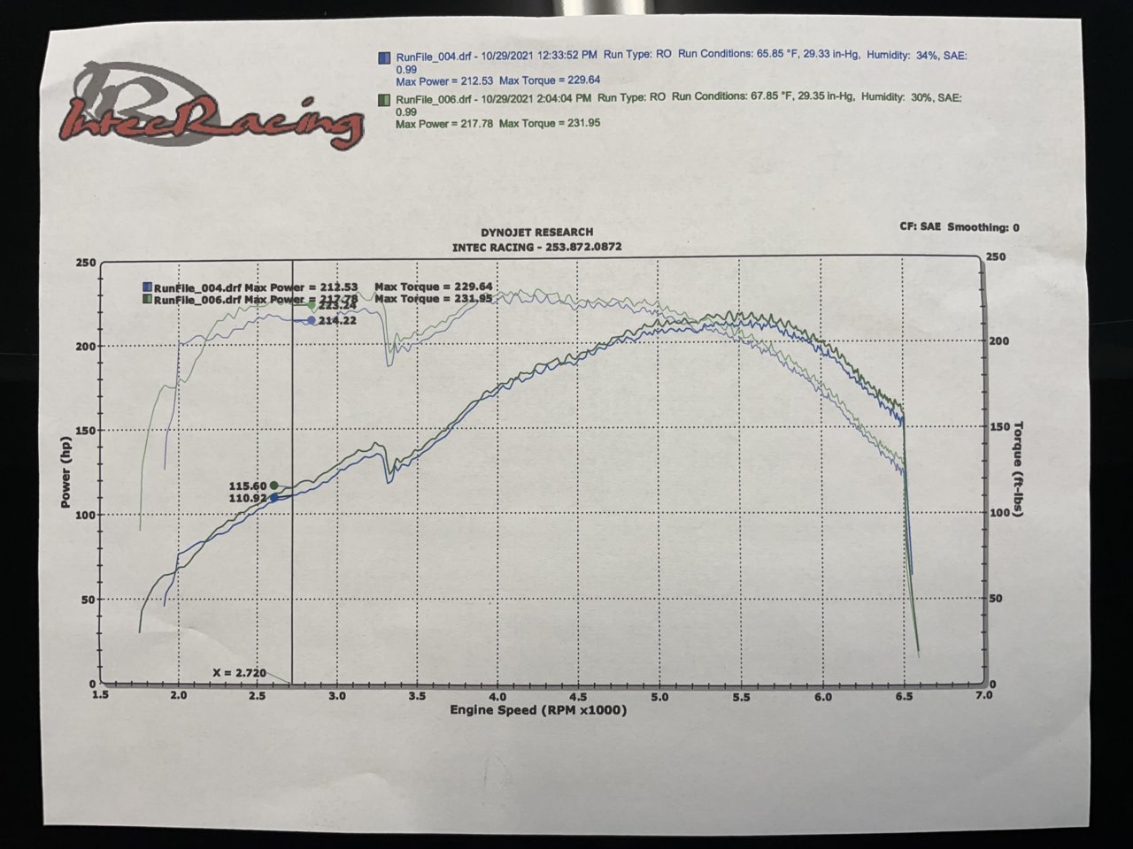

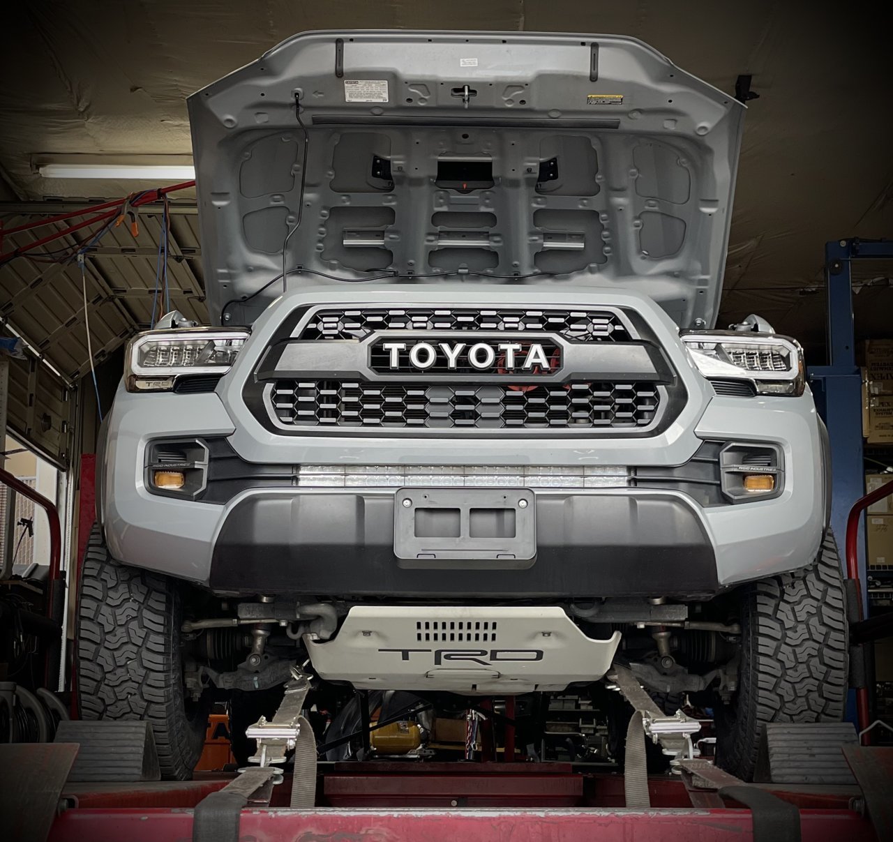

    Dyno results for the URD Y pipe:
    Gain 9 WTQ from 2200-3300 RPM. As we all know… this is the problem area for the 3.5L and yes you can feel this.
    tonered likes this.

    I wish the absolute numbers were higher, but it's all about the feelz.
    The S/C will take care of all of that.
