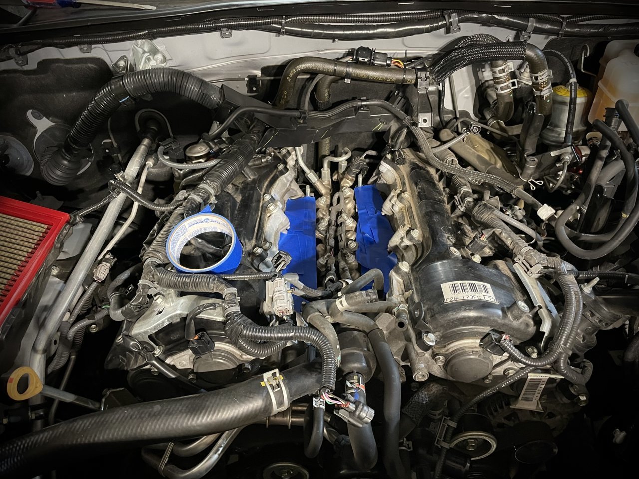

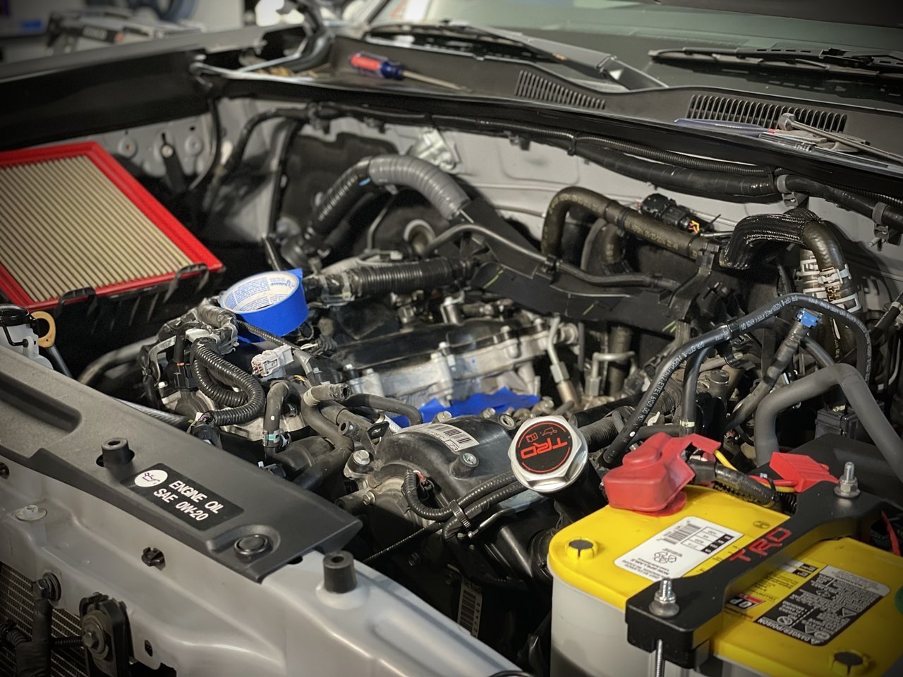

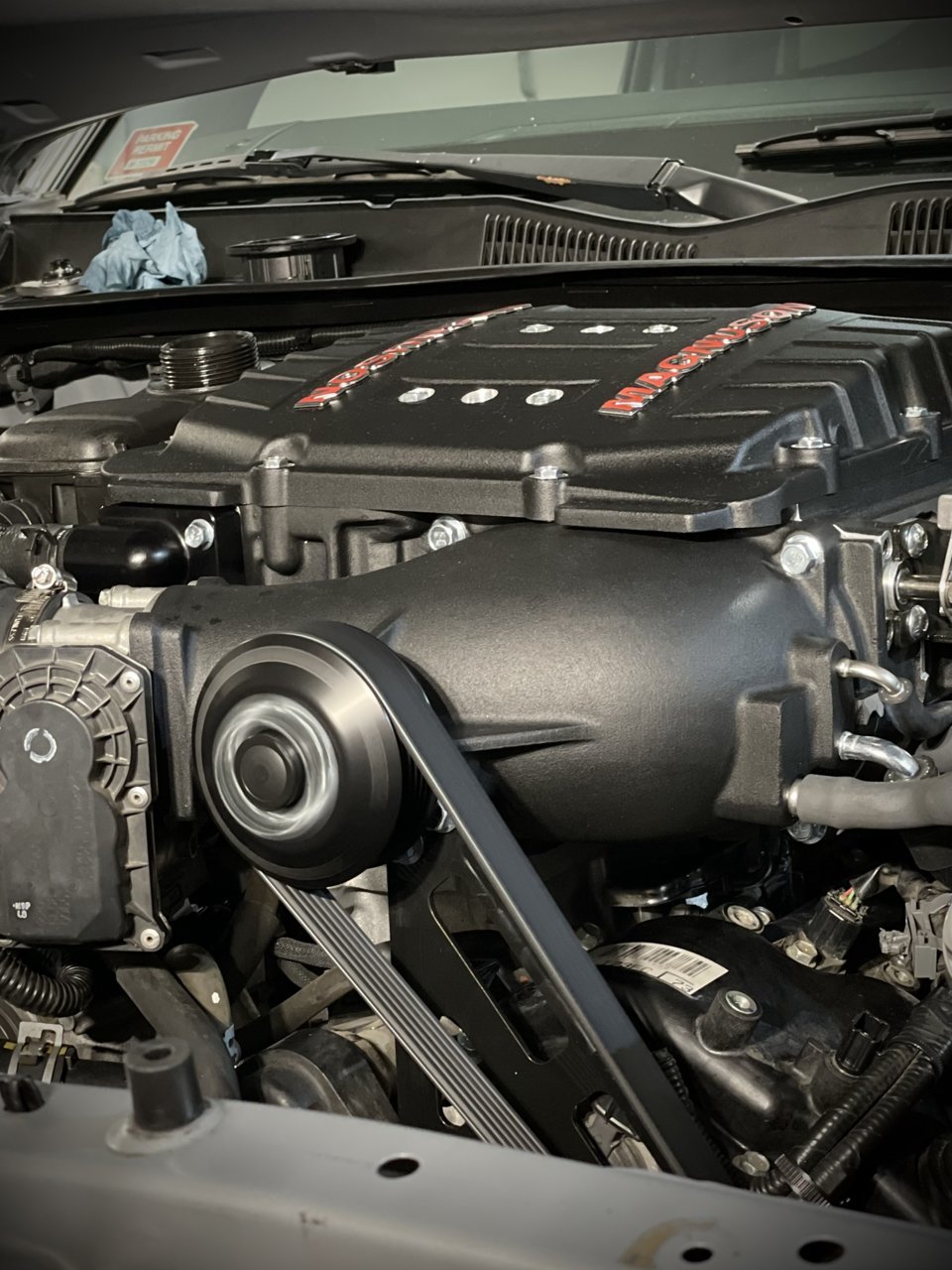

    My buddy Ed helped me install this thing yesterday. 7-8 hours? Gonna call bullshit on that one. Maybe on a brand new Tacoma with two experienced installers cutting half the instructions out. The instructions were very well done. We ran into issues getting the crank pulley off, (pulley holder bolts bent, had to bump start with breaker bar resting on frame), torquing the crank pulley down, etc. The total time was 15 hours. This includes draining the oil, changing the filter, draining coolant, removing the radiator, (to get an impact onto the crank pulley which ended up failing anyway), changing spark plugs, (bitch to get some of the coil packs out), cleaning some sludge out of the runners under the lower intake manifold, (catch can highly recommended), filling oil, filling coolant, burping the system at the end. There are definitely steps in that 260+ step install manual that I think folks are omitting when they say 7-8 hours install time. Anyways, had a blast! Not quite sure why folks complain about the power bump. It’s definitely an improvement over stock.

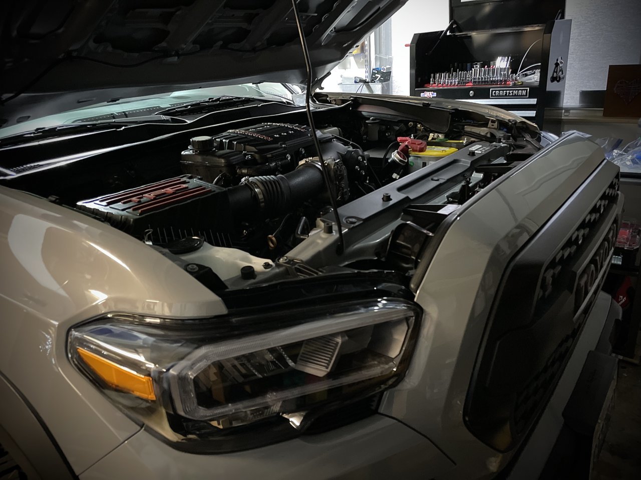

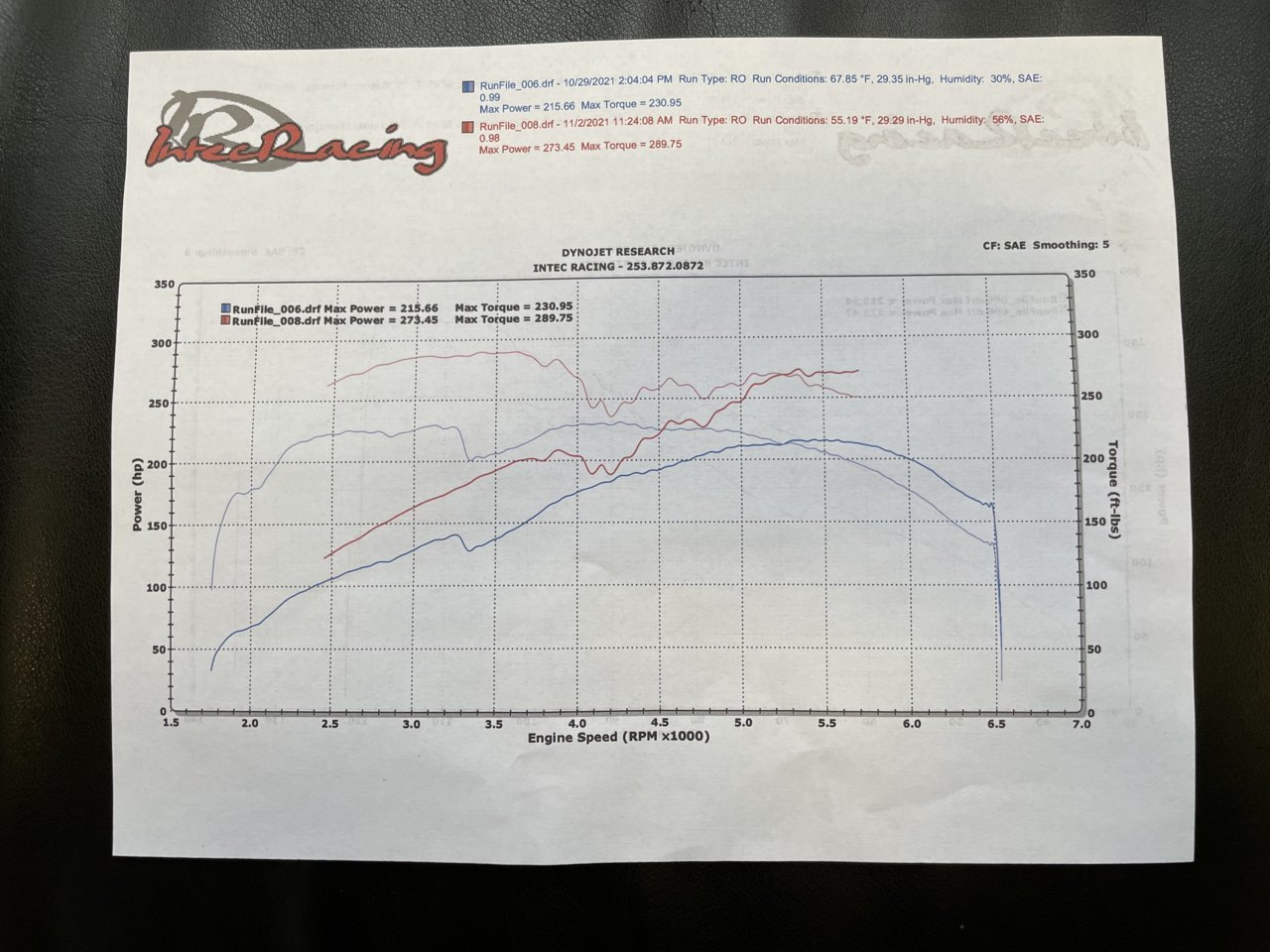

    Dyno results for the Magnuson supercharger. Significant gains over the OV tune 2.0.
    Yotawerx @mZiggy and @tonered forced induction tune uploaded. This truck is now a test mule for the manual transmission version. So far so good! Tuning on the dyno scheduled for Nov 18th.

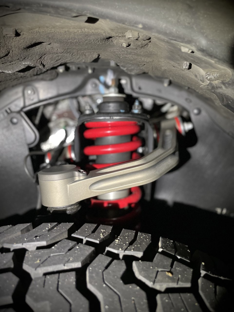

    74 Weld billet aluminum UCA’s installed. The bronze finish was stripped and these were hard anodized for durability. Caster set at +3.7 degrees.

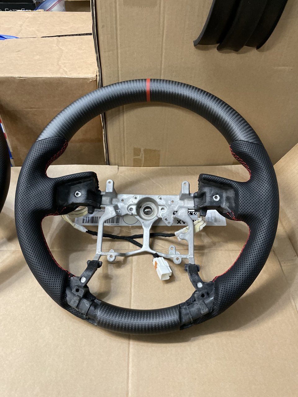

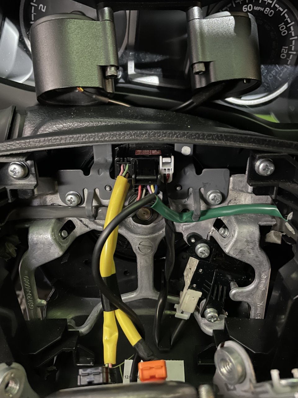

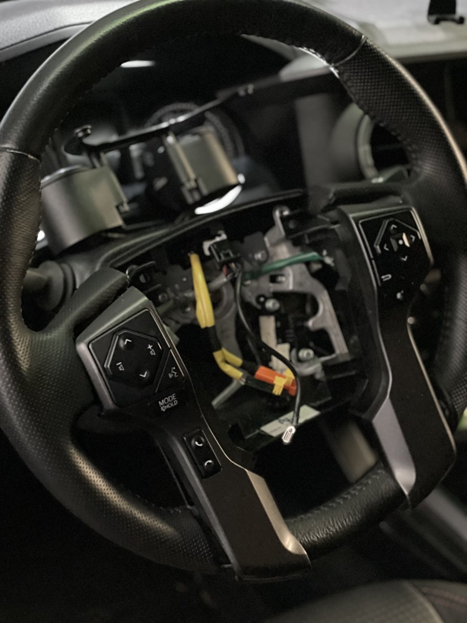

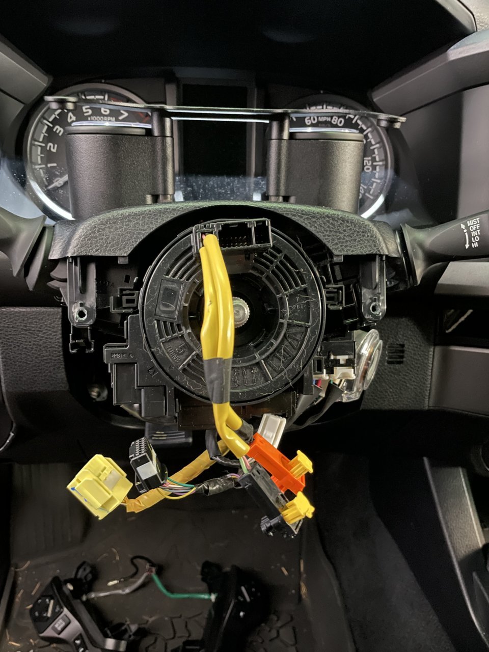

    Just installed this carbon fiber steering wheel. Beautiful and ergonomic.
    But… the clock spring doesn’t fit! So… no heating element.
    :annoyed:
    Roof Walker, RyanDCLB and mZiggy like this.
  13. Nov 9, 2021 at 6:37 PM
    #33
    Formidable
    Formidable [OP] Well-Known Member
    Jun 25, 2015
    #158158
    554
    2017 TRD PRO 6MT
    Install was straight forward given the difference in clock spring I couldn’t proceed with the heating element install. Basically just a wheel swap.
    1. Disconnect battery
    2. Undo side panels with plastic interior panel remover tool
    3. Torx 30 bit undo the airbag, pull airbag out
    4. Gently disconnect airbag clips with flathead toggling side to side under the clip as you pull up.
    5. Disconnect ground to airbag
    6. Disconnect connectors to clock spring
    7. 19 mm to nut holding wheel with impact gun. Pull steering wheel out. I used a rubber mallet to loosen.
    8. Remove rear shroud from steering wheel by gently prying the clips
    9. Remove button panels from steering wheel by removing four Phillips screws.
    10. Remove cruise control stalk held in by one Phillips screw.
    11. Reinstall on new wheel. Reverse the above process.
