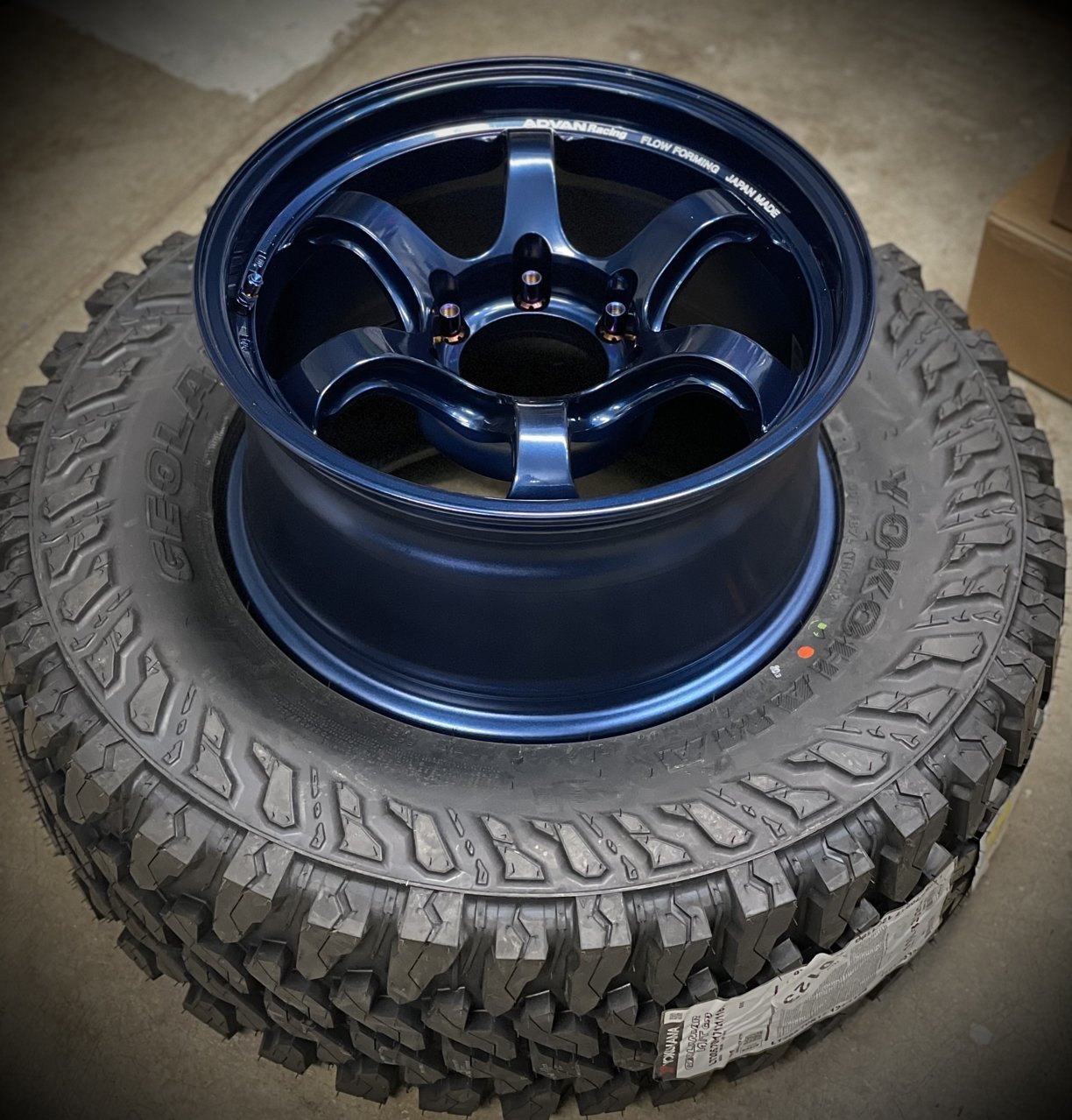

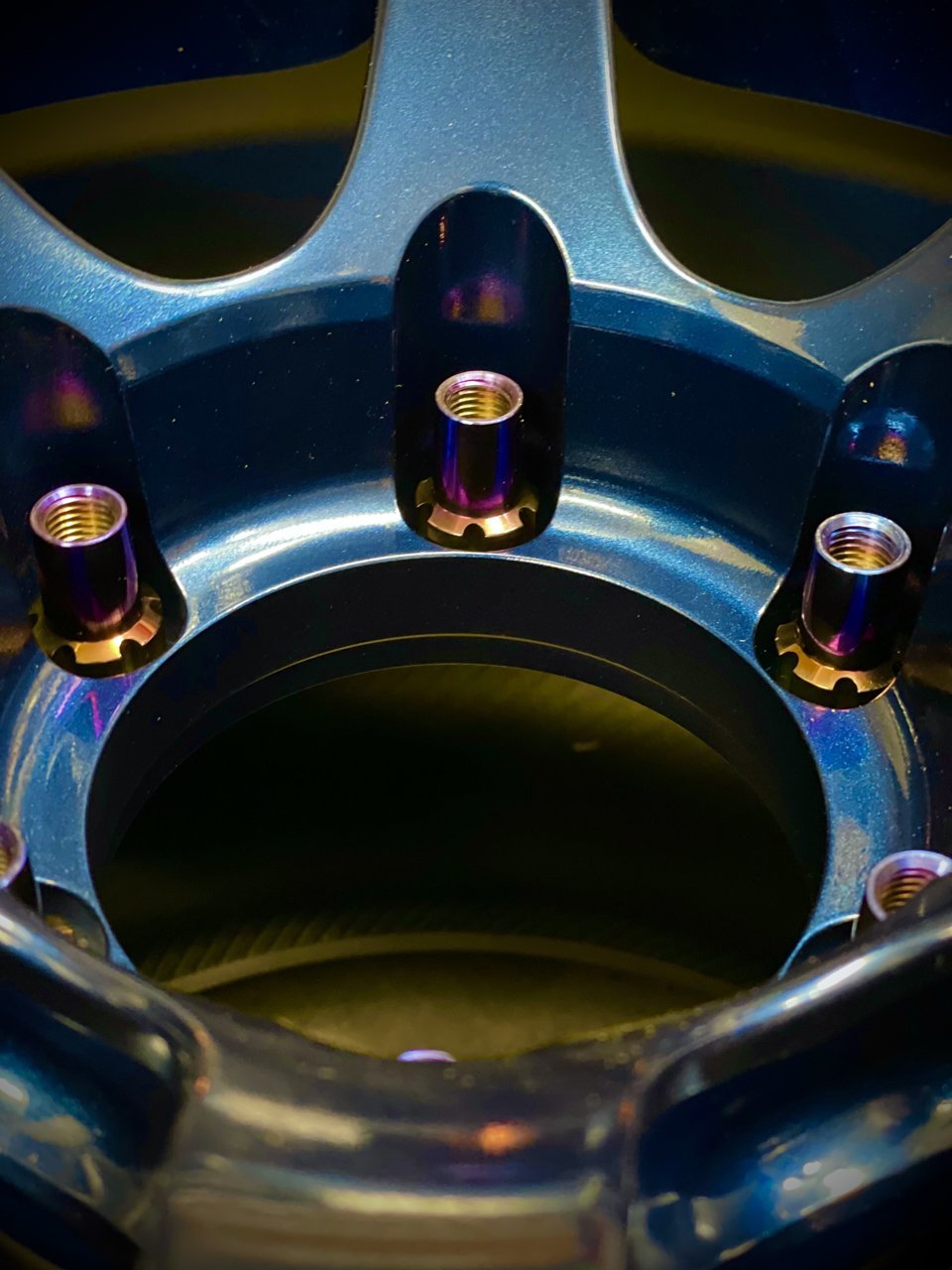

    Titanium works forged titanium open ended 48mm lugs to accomodate ARP extended studs, lock key, valve stems, caps. Advan RGD2. 285/70/17 Geolandar MT’s getting ready for mounting.
    Gonna trim some shit… lol

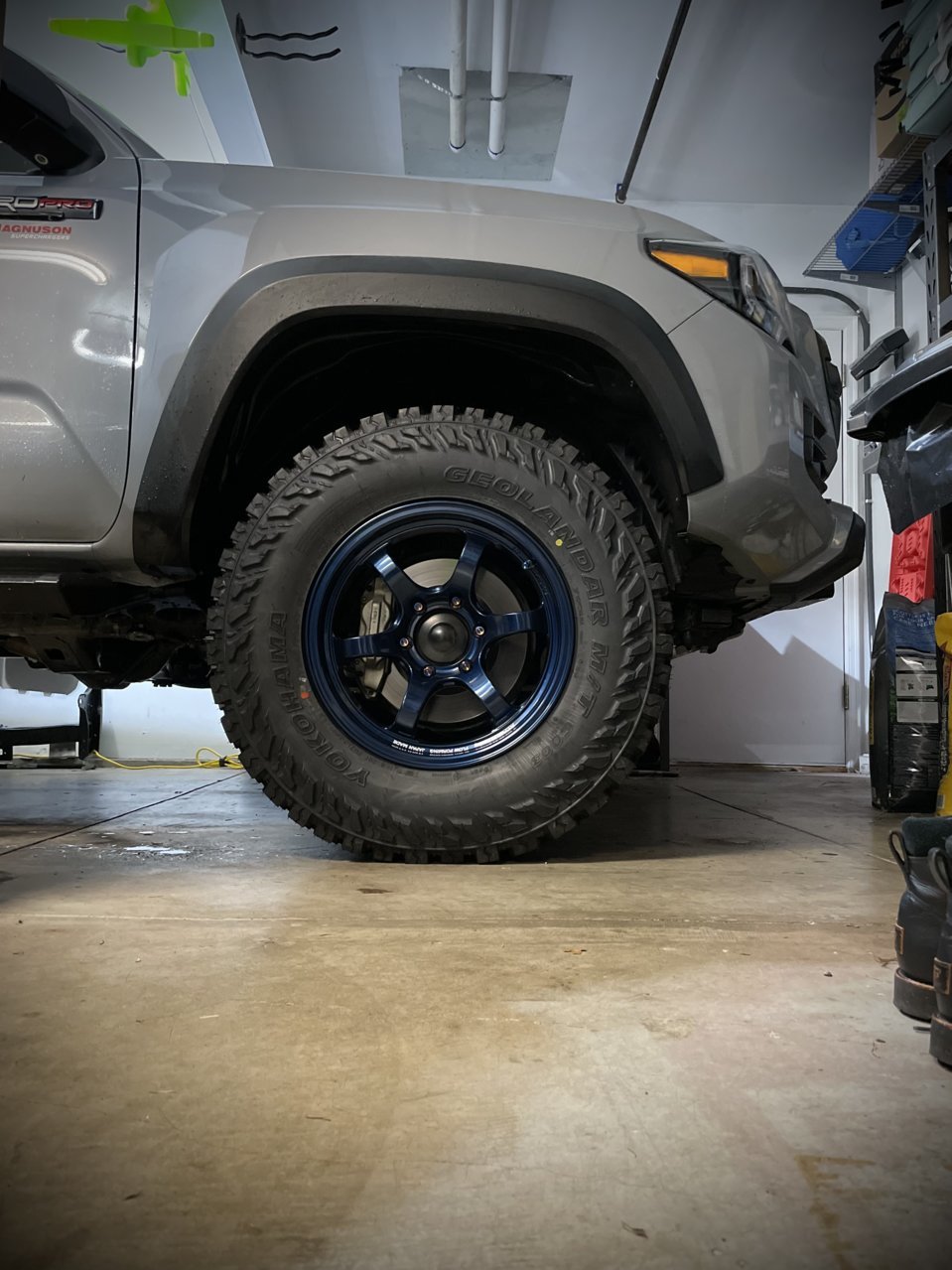

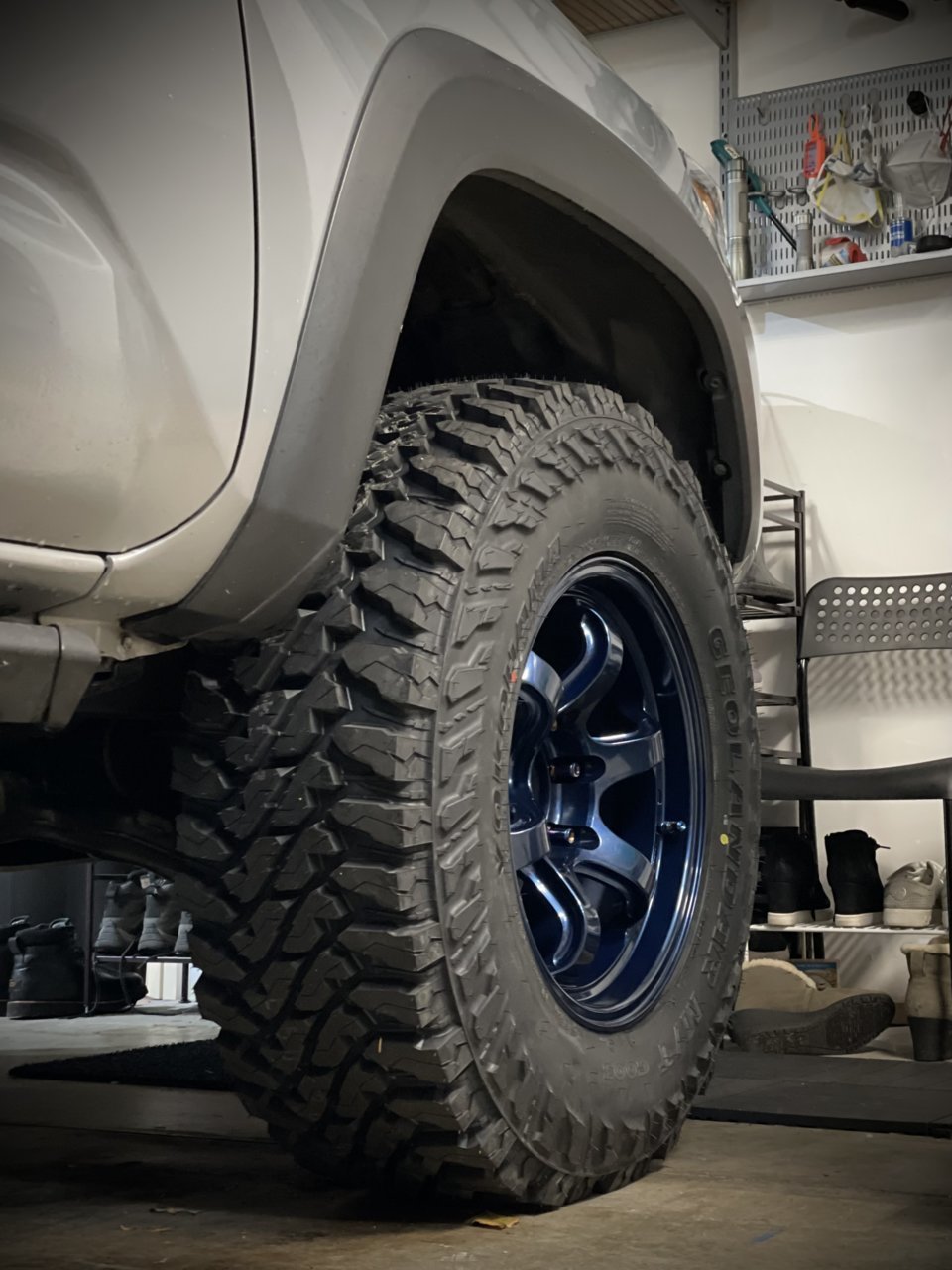

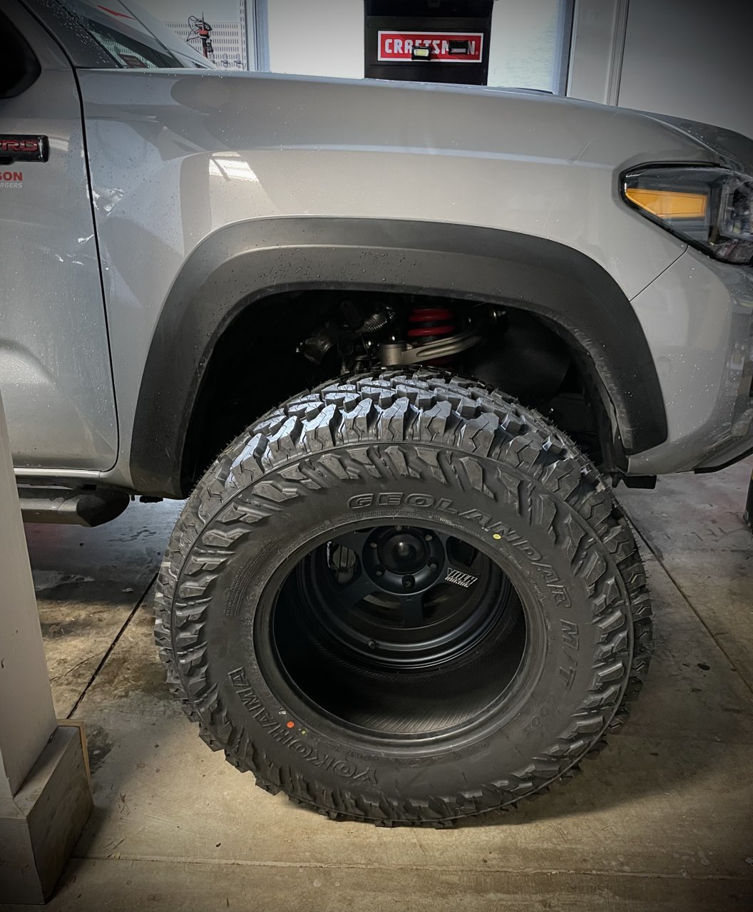

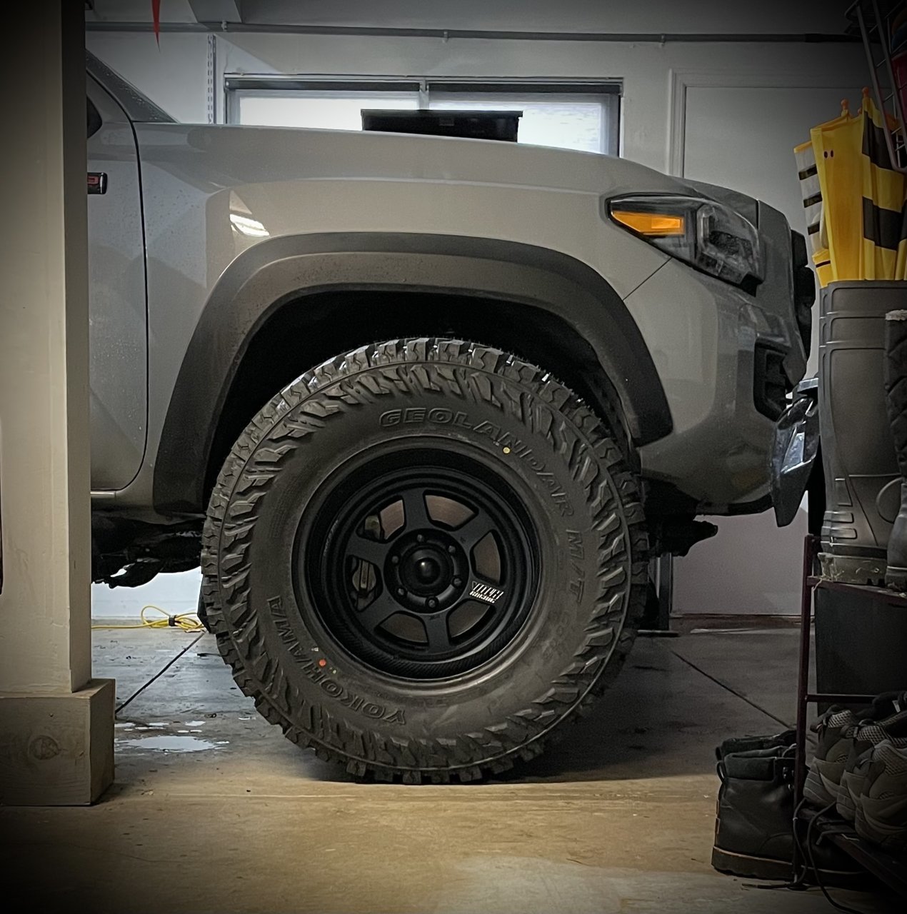

    285/70/17 Geolandar MT mounted on Advan RGD2 17x8.5 offset -10 by Right Away Tire. Wet traction is actually way better than expected. Zero vibrations at highway speed. Extremely quiet for MT tires.
    Thank you @Buttskevin21 for the CMC and pinch weld mod. No rubs so far!

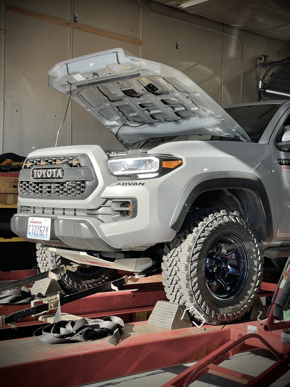

    Strapped down at intecracing for more @mZiggy Yotawerx dyno testing.

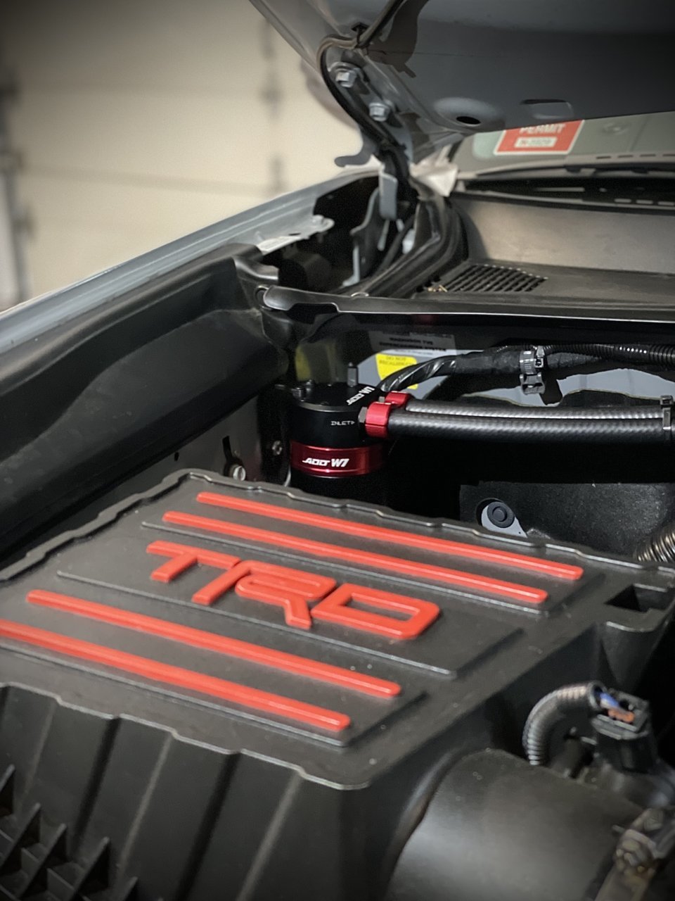

    ADD W1 catch can install

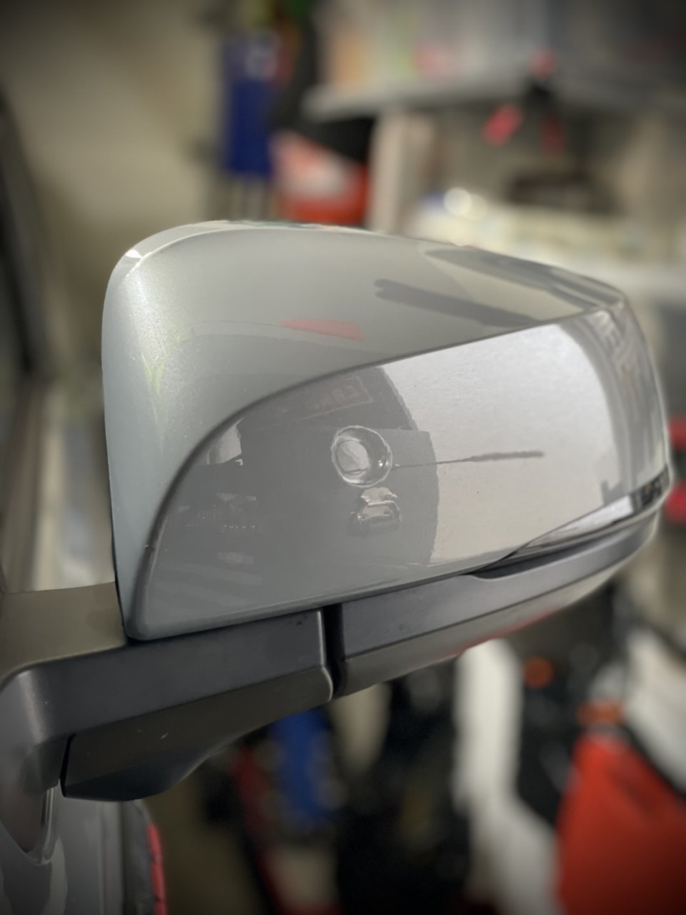

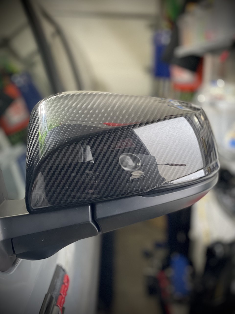

    @tacomalifestyle carbon mirror skins installed. Real carbon fiber. Perfect fitment.

    Excellent build! Did you have any rubbing with your TE37s at -20 offset? That is, before your CMC and pinch weld mod?
    looking forward to seeing more!
    Formidable[OP] likes this.
  20. Jan 30, 2022 at 6:31 AM
    #80
    Formidable
    Formidable [OP] Well-Known Member
    Jun 25, 2015
    #158158
    554
    2017 TRD PRO 6MT
    No rub with 265/75/16. No CMC. On TRD Pro suspension with eibach springs for street driving.
    Once Weld74 UCA’s and caster dialed to 3.75 deg… then it rubbed front fender liner very slightly in reverse full clock. That rub is worse now with 285/70/17. Didn’t bother to address it but it will require heat gun.
