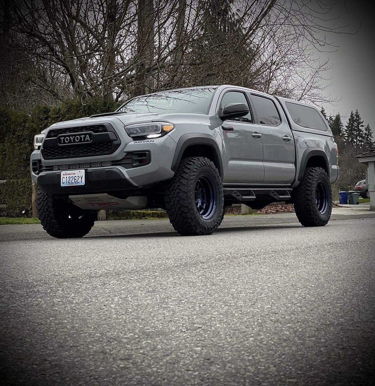

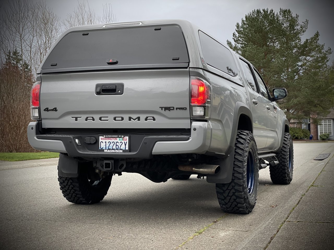

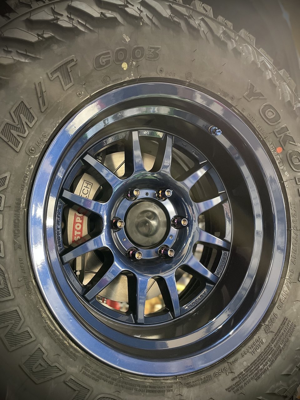

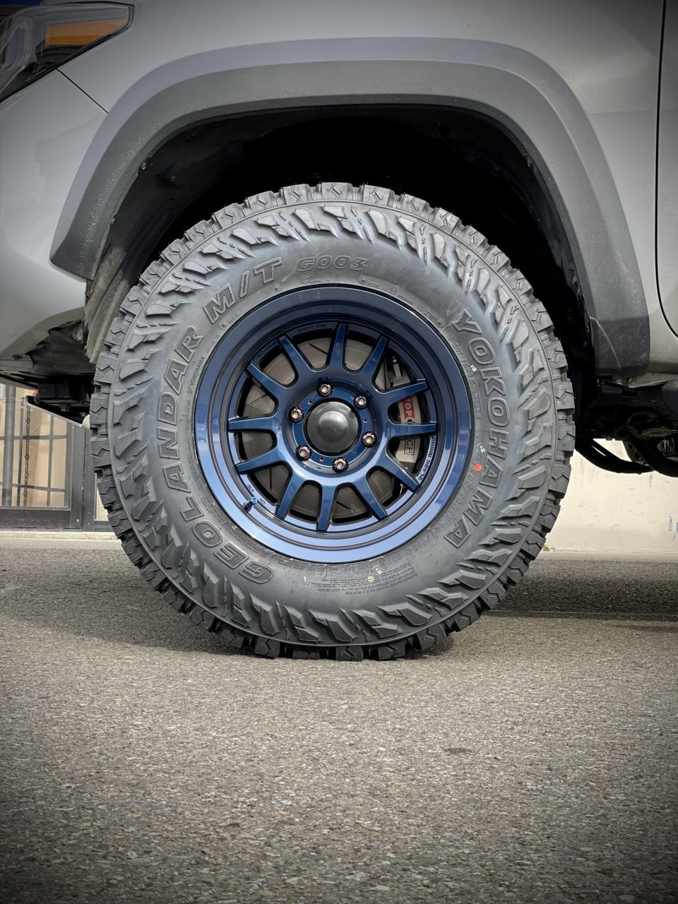

    Black rhino guide midnight blue mounted. Stance is now on point.
    17x9” -38 offset
    295/70/17 Geolandar MT

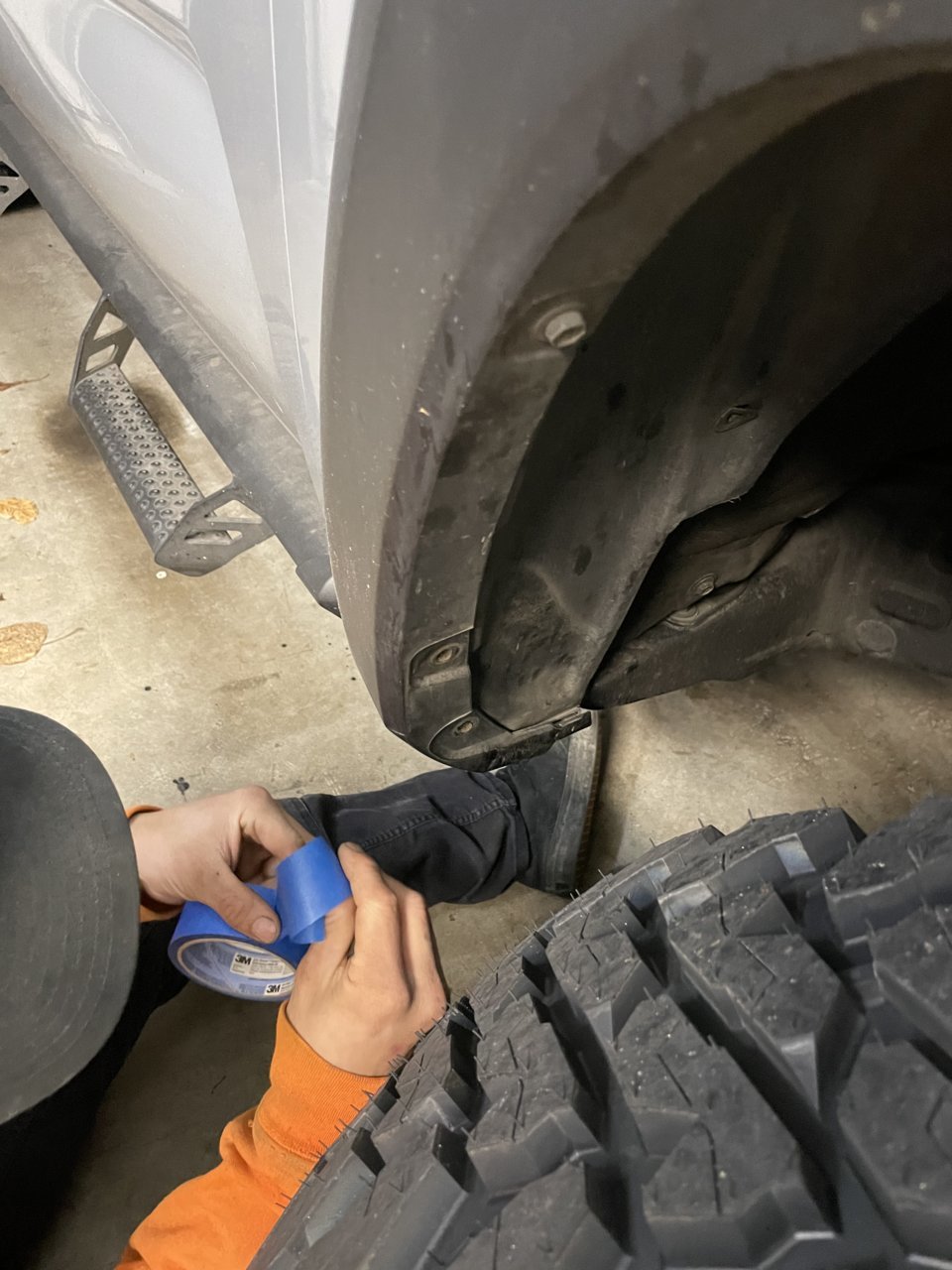

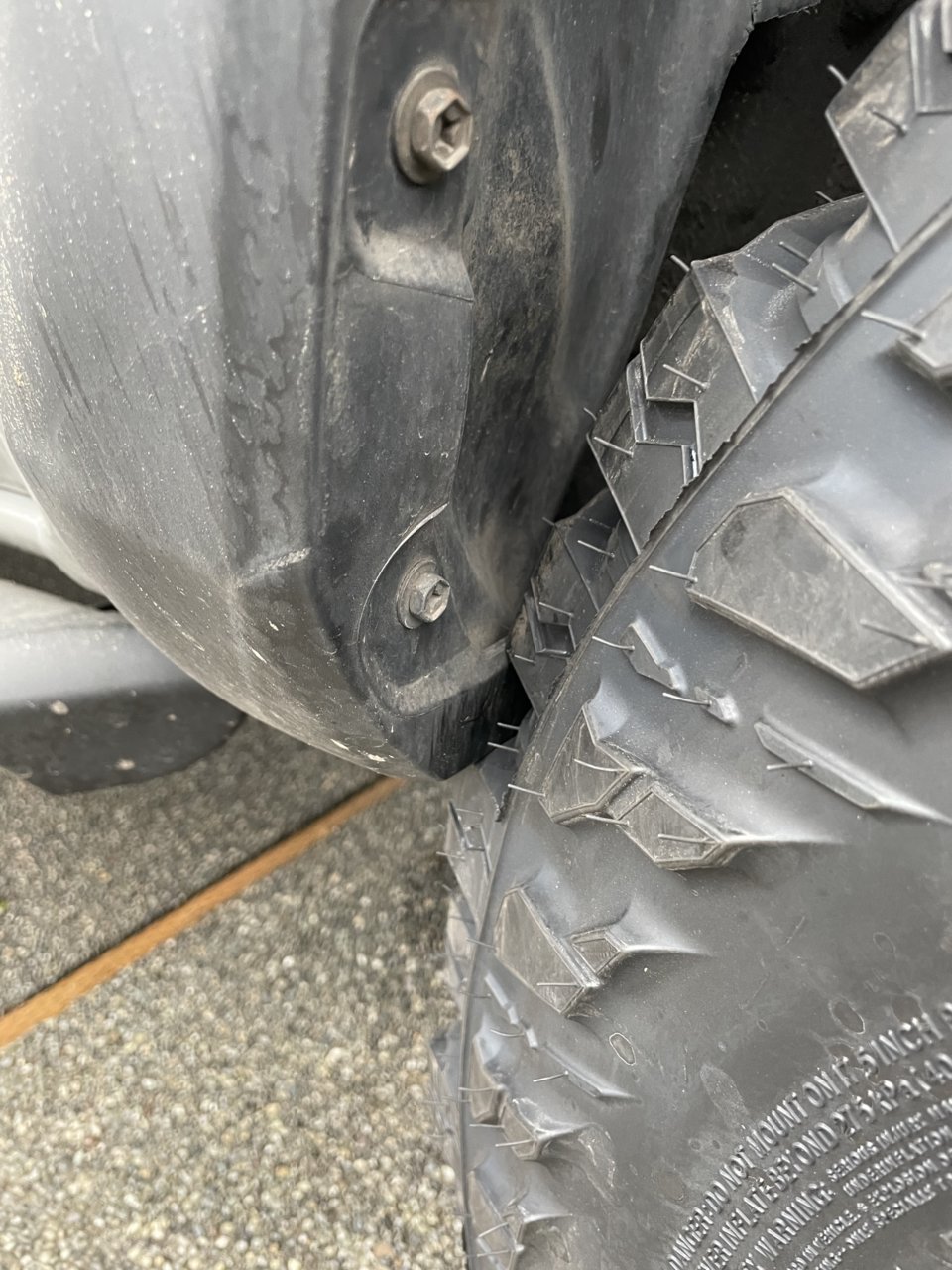

    Big thanks @Buttskevin21 for coming in clutch to trim the fender.
    Advan RGD2 indigo blue set of 5 with 285 Geolandar MT are for sale. Titanium valve stems and caps. Ceramicpro coated. Almost new condition. Send PM if interested.

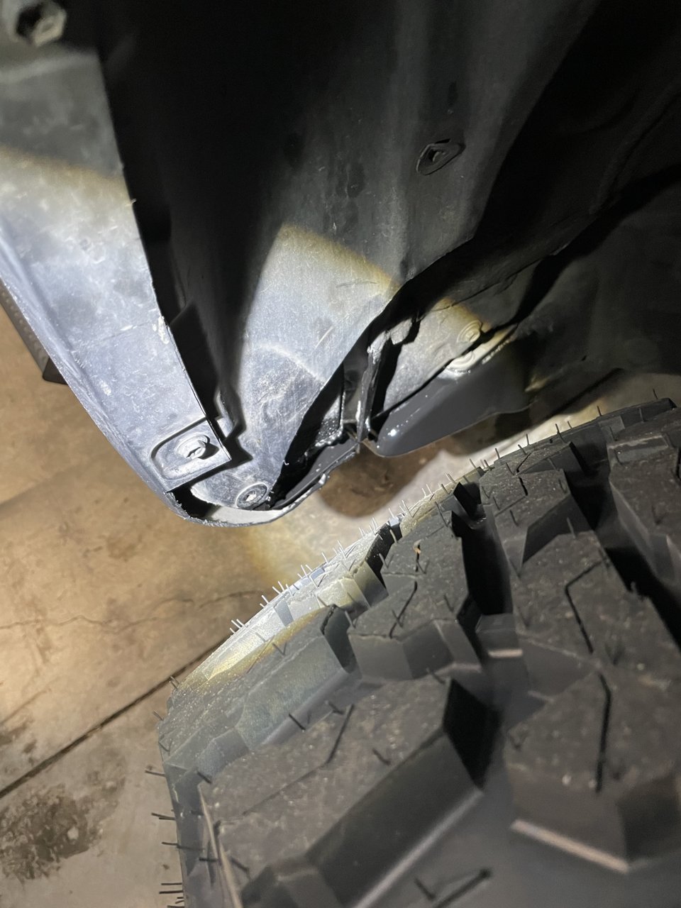

    How much trimming? Still need more but this makes it drivable for now.
    Thanks again @Buttskevin21!

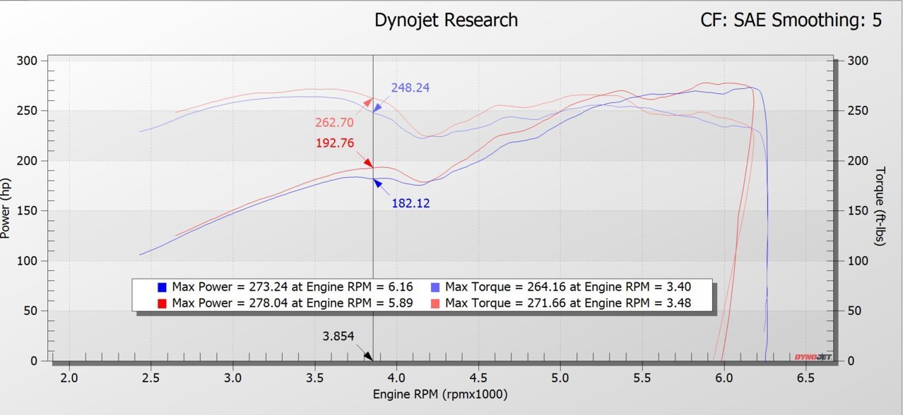

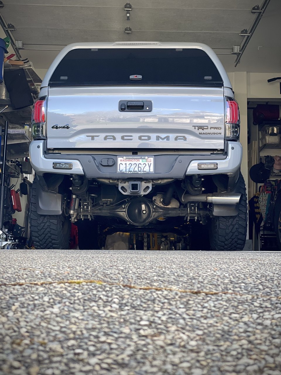

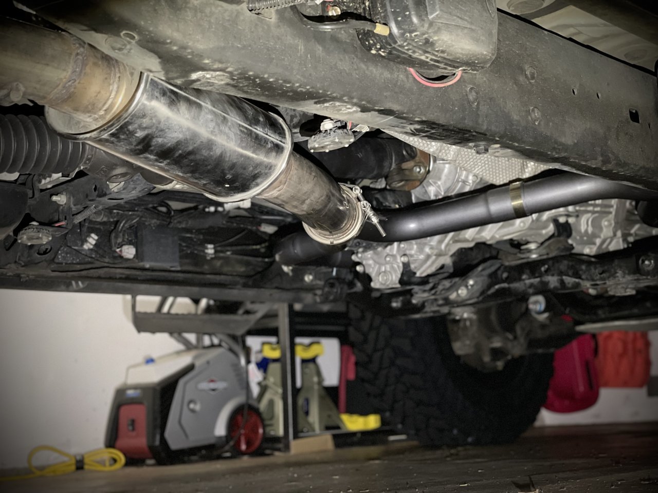

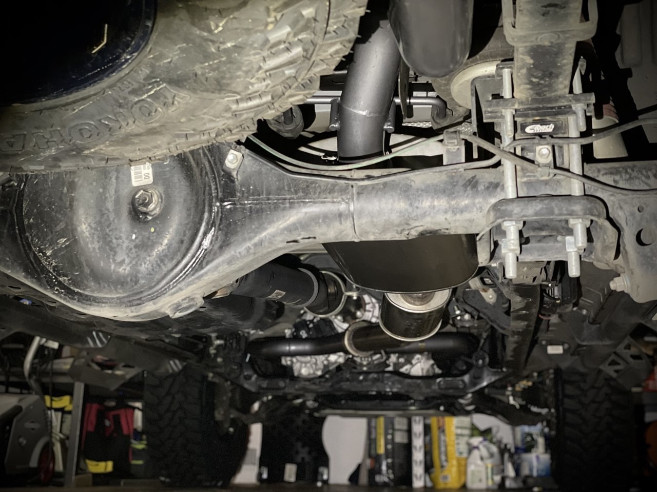

    Just installed this system I got used from a member on this forum @Tac0Tic0. Had the Y pipe and tail pipe ceramic coated with 2000 deg satin grey ice at performance coatings in Auburn WA. The tail pipe was coated due to the proximity to the 285 spare tire. The hanger contacts. Had the system installed on the dyno at intecracing in Kent.
    The following is a thorough and proper review of the system.
    Install: No issues. Intec was able to get the system on without a hitch. The Y pipe took some wiggling to get it into place but that’s about it. Granted this is used and so it may have posed an issue for the original owner.
    Impressions: A bit louder than my TRD Pro exhaust. Very nice rumble at start up, idle and rev. All aftermarket exhaust systems drone to some degree, even the TRD. The question is whether or not it’s tolerable. This system definitely drones a bit more than the TRD but it’s relatively minor. Sound clips below.
    Power: Decent power gain proven as this system was installed with the supercharged truck ON THE DYNO. Increases area under the curve as compared with the TRD. Delta of 14 WTQ at 3800 rpm and again at 4500-5500 rpm. Delta of 10 WHP all the way up the curve. Again, this dyno is in comparison to the TRD Pro exhaust. Of note this is with the magnuson stock tune and stock pulley. Very pleased overall.

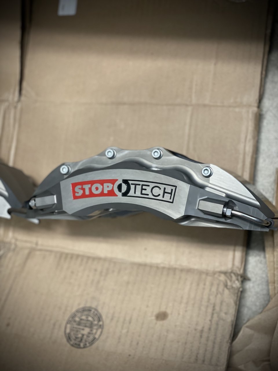

    Stoptech big brake kit 340mm rotors, 6 and 4 piston hard anodized calipers, and SOS performance rear drum to disc conversion kit with stainless lines, extended ARP studs, open ended 48mm titanium lug nuts installed by intec racing in Kent.

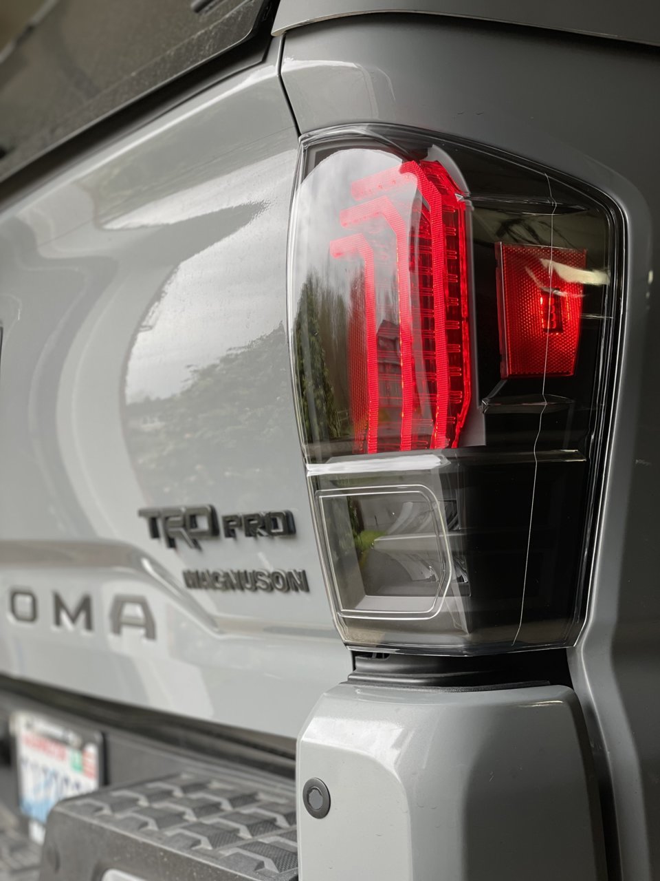

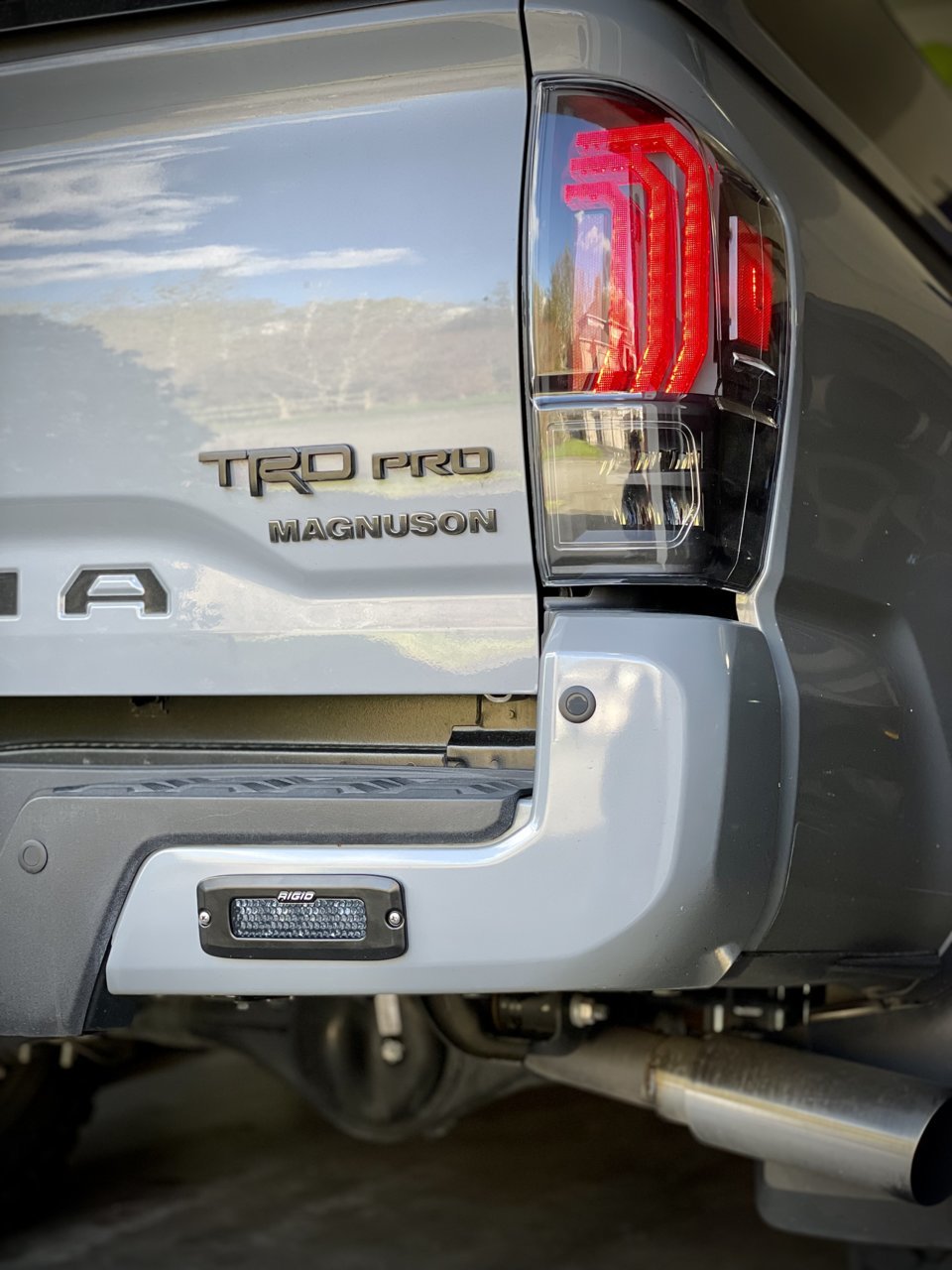

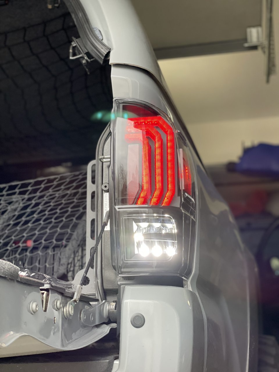

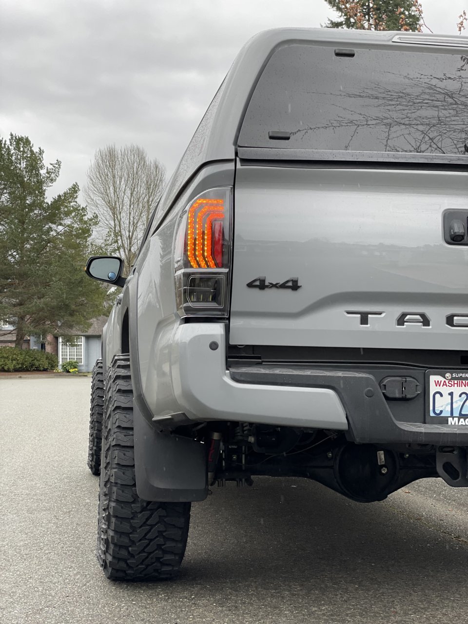

    @MESO LED tail lights installed. Night and day difference over the TRD Pro tails. Quality product. Goes very well with the Meso sequential turn signal mirrors.

    Agree. Initially I thought something was wrong. Pedal was a bit mushy. But it’s a pretty significant difference once you bleed the brakes correctly through techstream or the dealer. Happy with the mod overall. The calipers are the Stoptech Trophy calipers and were special ordered for this truck through Tom at SOS performance. Two lbs lighter than their standard calipers. They are hard anodized for corrosion resistance and will never fade… Not painted or powder coated. The red lettering will probably flake off over time.

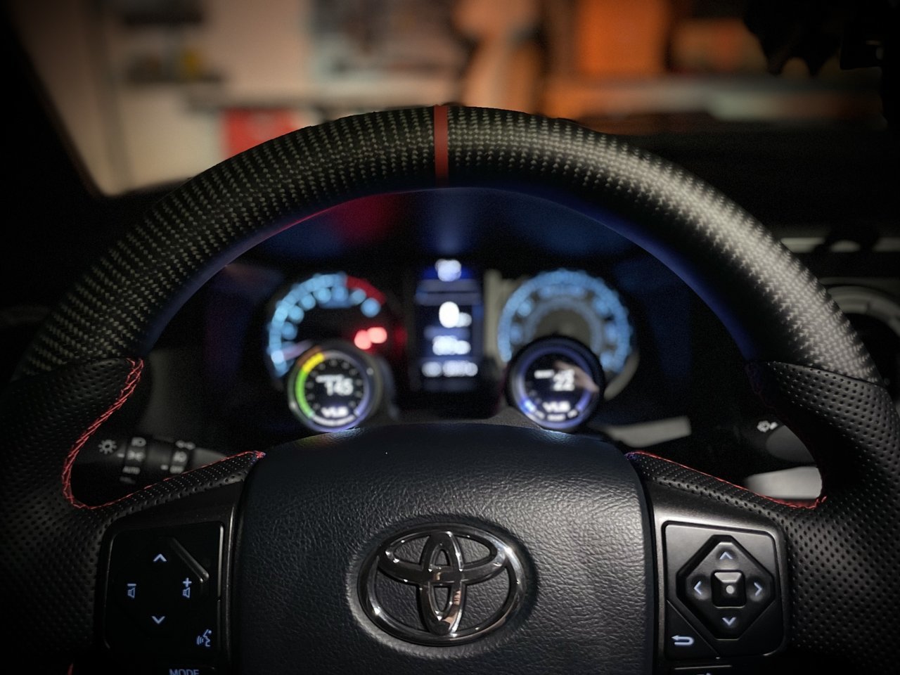

    How are you liking this steering wheel long term?

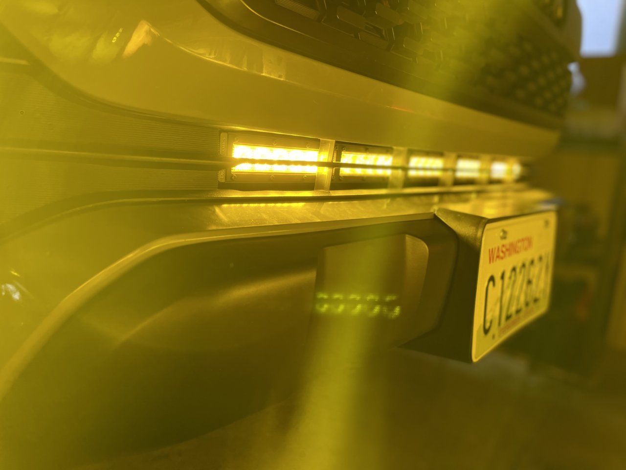

    Installed @Diode Dynamics 30” stealthbar and Rigid flush mount reverse lights.
