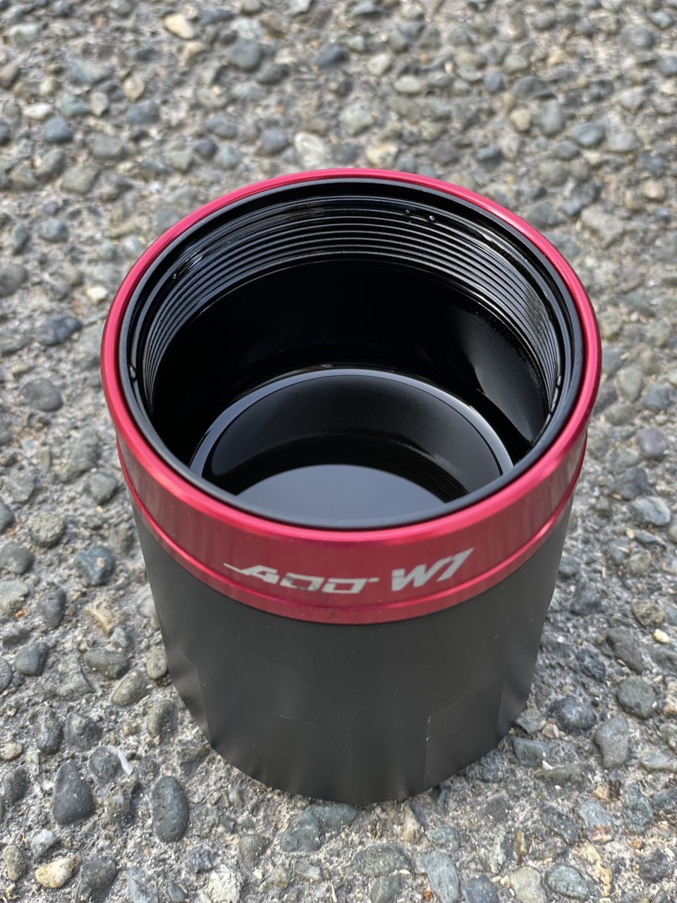

    ADD W1 catch can full of fuel and oil at 3k miles supercharged. This 3.5L puts out a lot of blow by.
    Now that the truck has water methanol injection, the 84mm pulley is reinstalled.

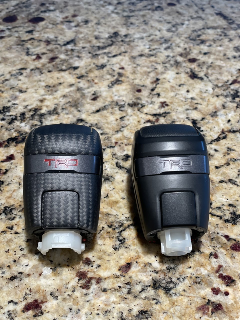

    Prototype custom made matte carbon fiber TRD Pro shift knob installed. I may be offering this on an exchange basis going forward… Not cheap though.

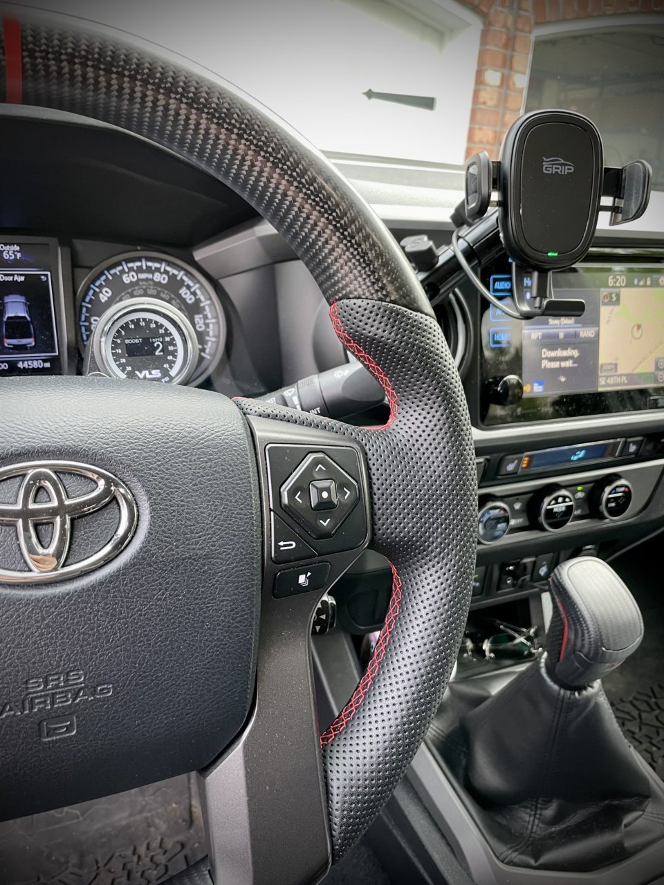

    Where did you get that steering wheel? Love this build

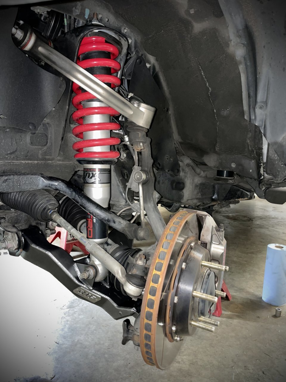

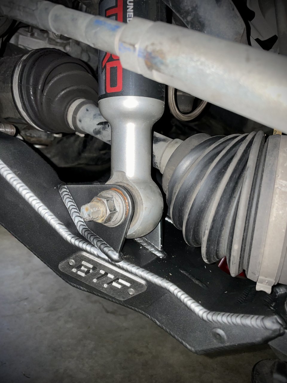

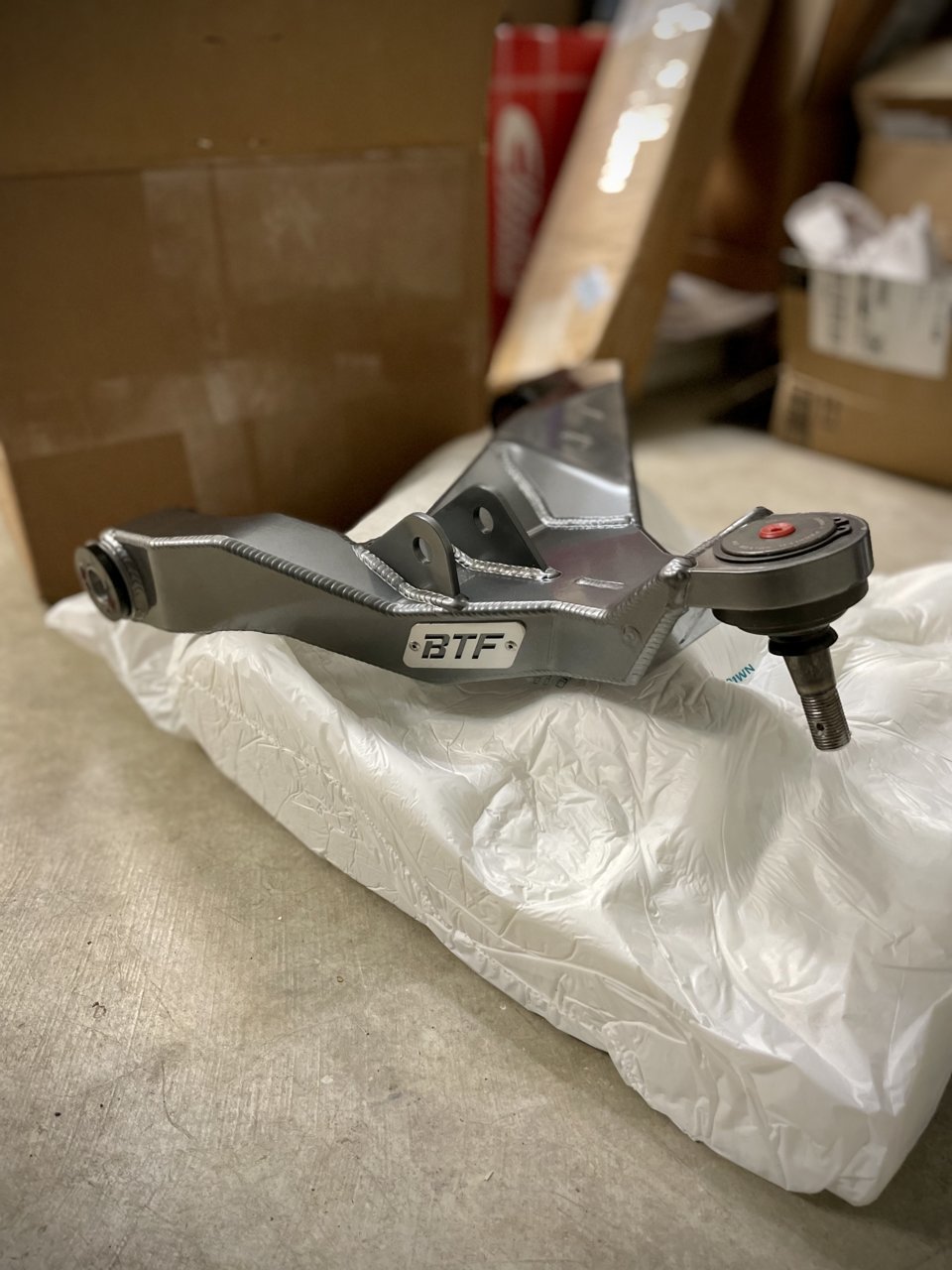

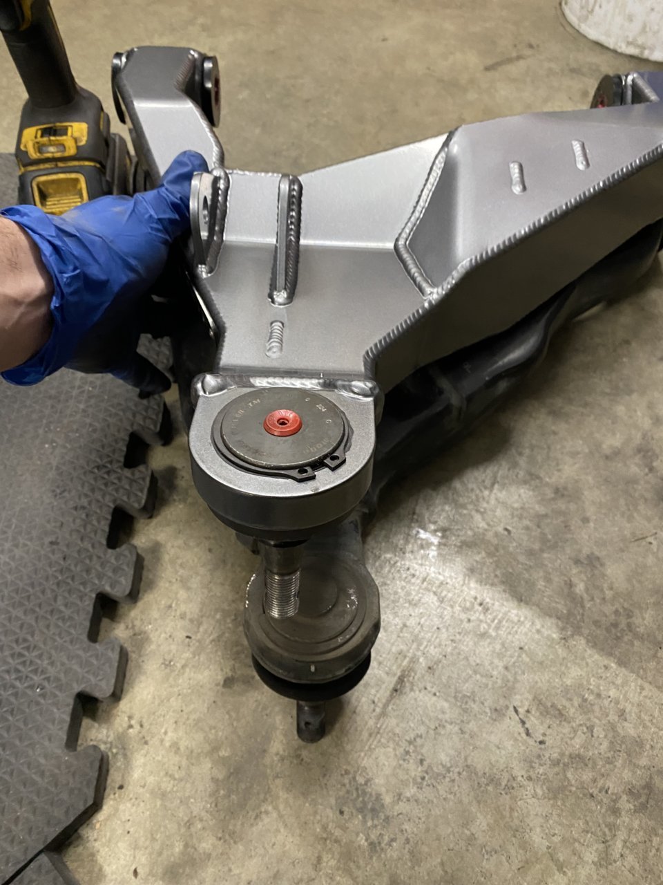

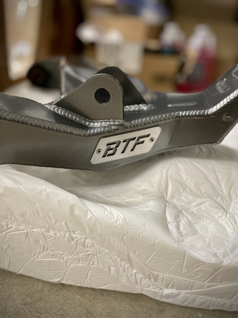

    BTF Fabrication stock length, caster adjusted lower control arms to be installed. Will move the front wheels roughly 1” forward for more body mount and firewall clearance. Should be able to get caster into the +5 range.
    Workmanship is top notch. Powder coating is legit and not the cheap crap I’m used to seeing on some offroad parts.
    tacopeter, 907rx7 and mZiggy like this.
  13. Nov 10, 2022 at 4:56 AM
    #133
    virginiamarine
    virginiamarine Well-Known Member
    May 20, 2013
    #104557
    1,435
    Northern Virginia
    FJCruiser/Double cab Tacoma
    Wow! Really nice LCA. Those welds look amazing. I didn't know these were even an option or I'd take a close look at them. For now I have TC. Great build my brother!

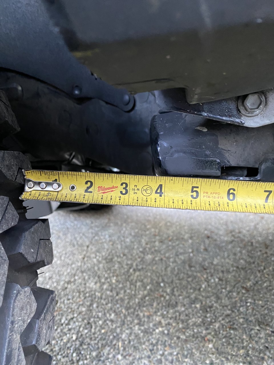

    Thanks man! They just came out. This is part of the first production batch at BTF. Seems ridiculous to need a CMC just to run 33”s on these Tacomas and this will offer folks additional clearance. I like that they kept a sealed LBJ instead of uniball. Where I live, they salt the roads regularly during the winter. Uniballs and heims get nasty quick!

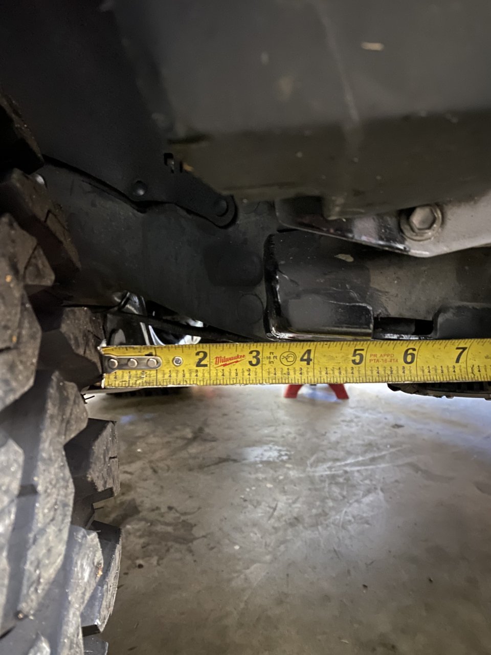

    Thanks! Just had Vince Stanton install the BTF LCA’s today. Moves the wheel forward about 3/4”. Build quality is top notch. Can see the difference overlapped on the stock LCA. Also the additional clearance at the CMC was measured before and after.

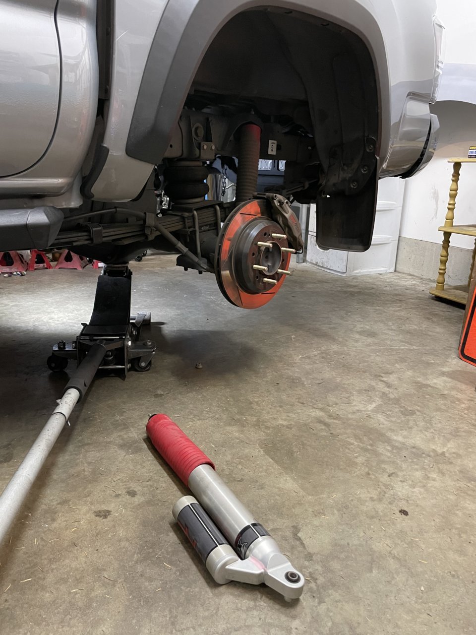

    Also had Vince Stanton install rebuilt TRD Pro shocks today. If anyone in the seattle area needs work done I highly recommend him.

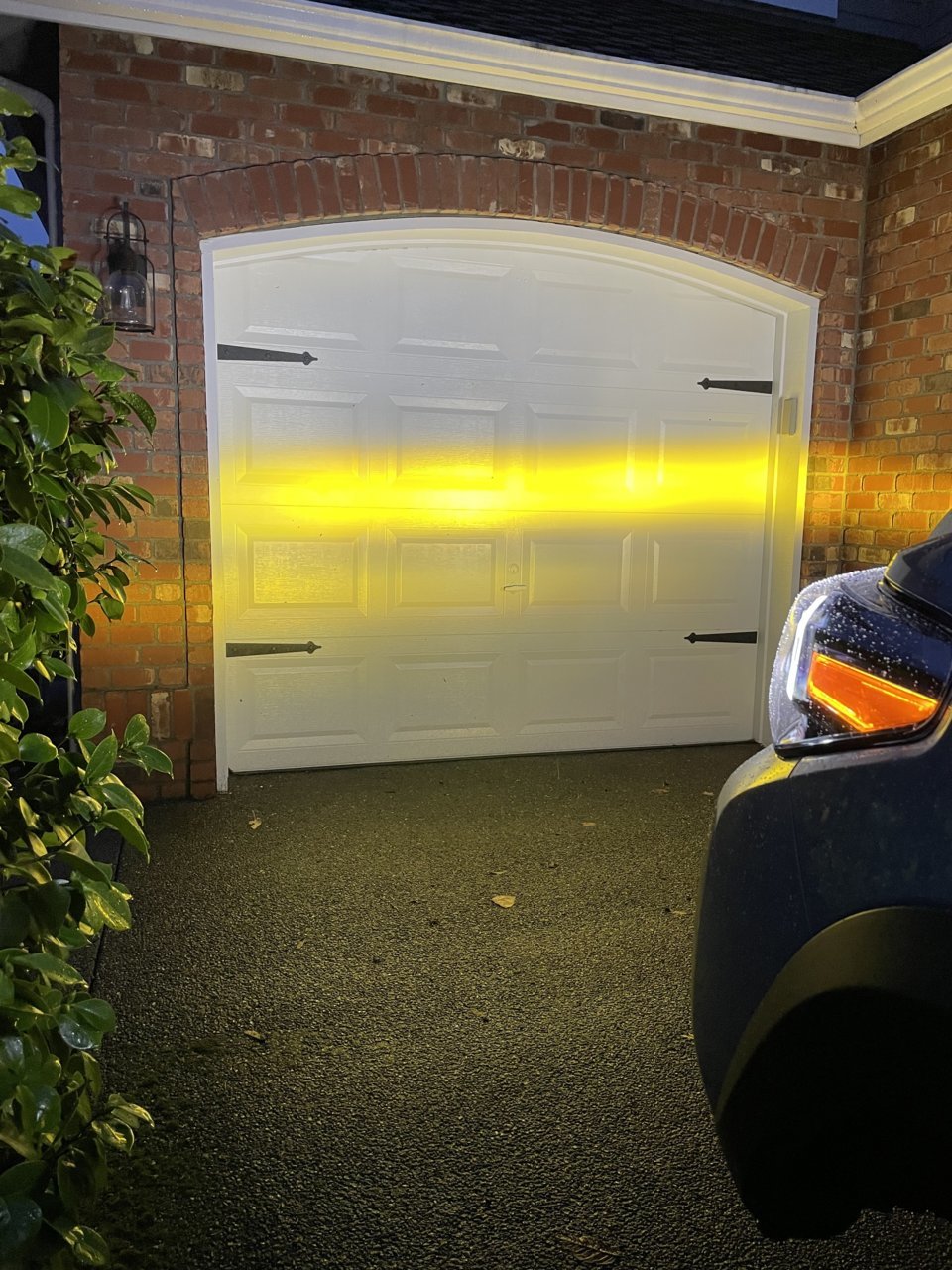

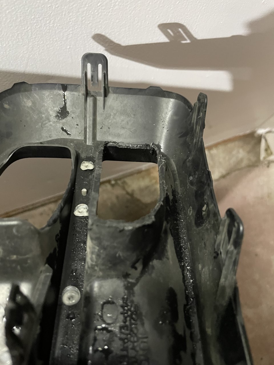

    Could you post up pics of the back of the rigid fog bezels? Would be interested to do the same thing. And I don't want to cut too much.
    How is the width of output on the fogs? Does the rigid fog bezels get in the way? As I know they have a larger blockage than the traditional fog bezels.
  18. Dec 24, 2022 at 7:26 AM
    #138
    Formidable
    Formidable [OP] Well-Known Member
    Jun 25, 2015
    #158158
    554
    2017 TRD PRO 6MT
    Minimal clearance is necessary. Honestly you’re not going to gain anything by going with the OEM housing over the Rigid. Since installing the DD I’ve never once thought… Hmm… I need more lateral output. The DD fogs blow the Rigids out of the water in every aspect including overall output, center flood, lateral flood, beam cut off, visible color, (actual lens vs amber cover). The Rigid housing was retained just for that OEM + look. They are garbage otherwise.
    Comparison pic taken on a slant with beam aimed up on purpose to demonstrate the difference. It’s literally a night and day upgrade.
    Chief_CNMI[QUOTED] and Pinchaser like this.

    I appreciate you posting up the pics! This by far the coolest TRD Pro imo!

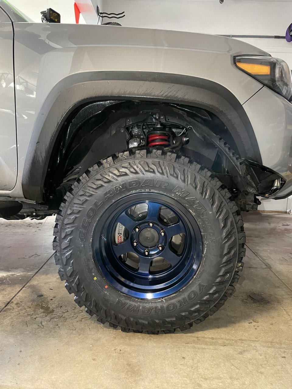

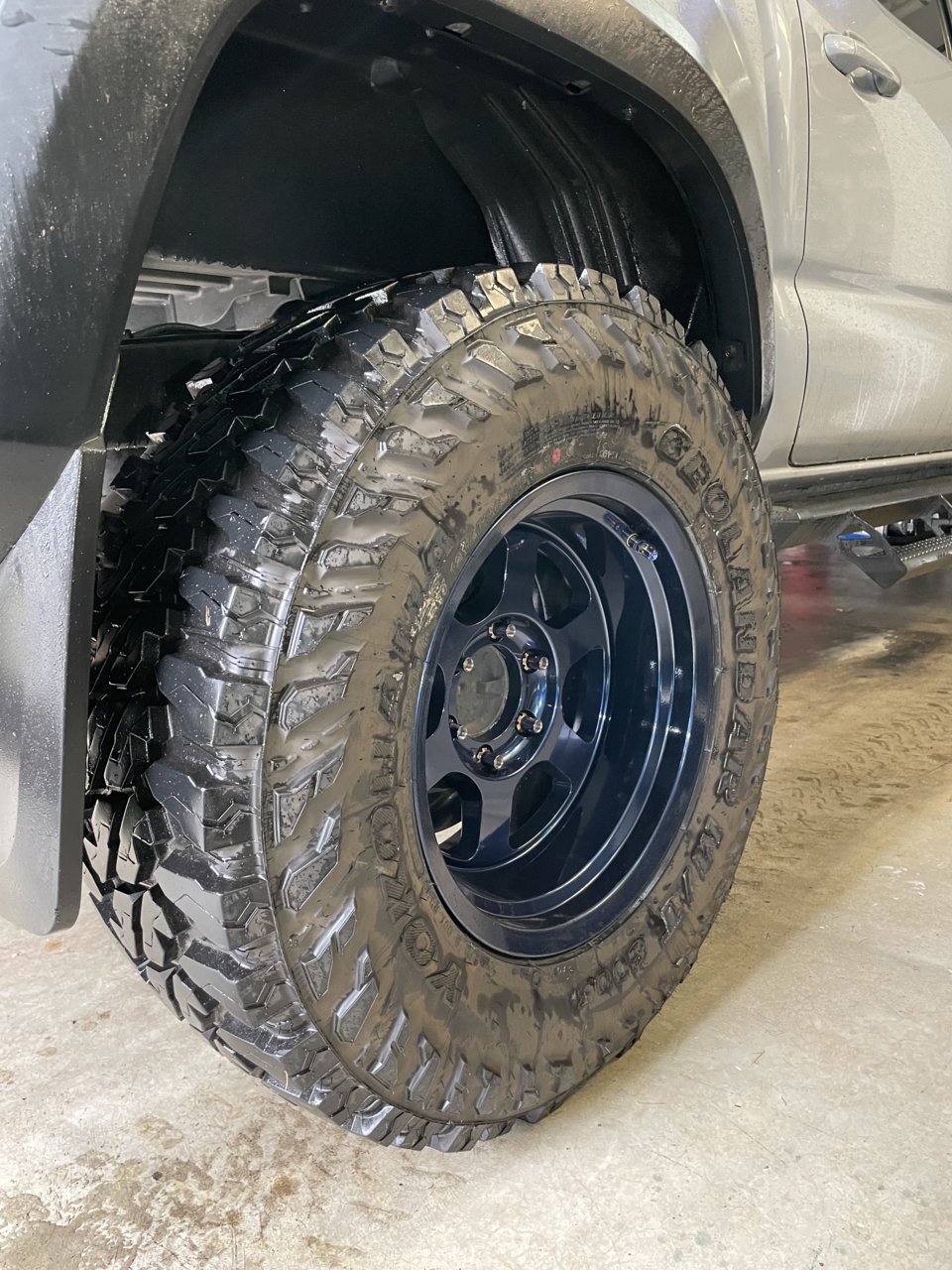

    Shoe change. Set refinished in mag blue at bulletproof coating in California.
    Old set of 5 Black Rhino Guide now for sale. Wheels only.
    17x9 -38 offset
    Midnight finish
