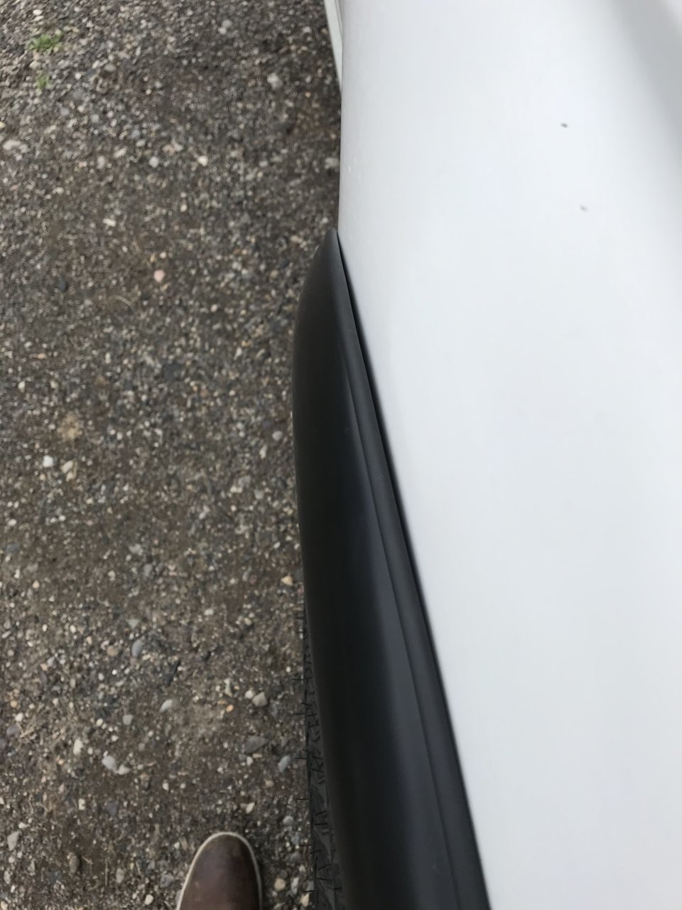

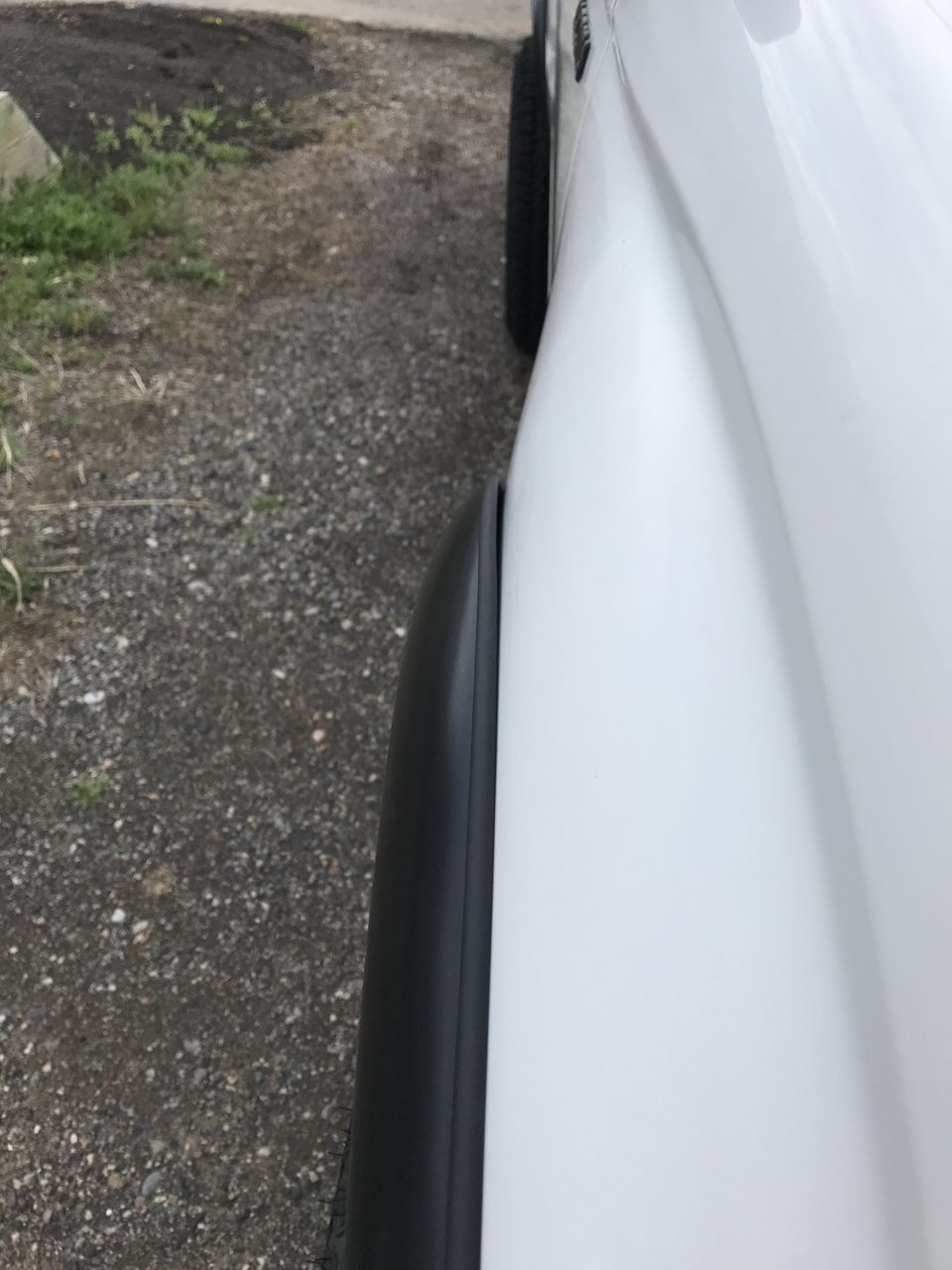

    Wondering if their is anyway I’d be able to fix this since I don’t want water sitting inside it and creating rust on my fender. Could I heat it up then form it to be more snug to the side of the truck? Anyone got any ideas?

    heat gun and a thick leather glove... heat up the fender flare and then push & hold it and have a friend dump cold water on it.

    think a blow dryer will work?

    Around 6 months old. Been using trim shine on them and making sure they’re kept clean. My buddy hit my fender the other day by accident and it sorta made it a little pushed in not noticeable but made it so my flare was pushed out a bit. I also baby my truck like hell and wash it almost every 3 or 4 days
