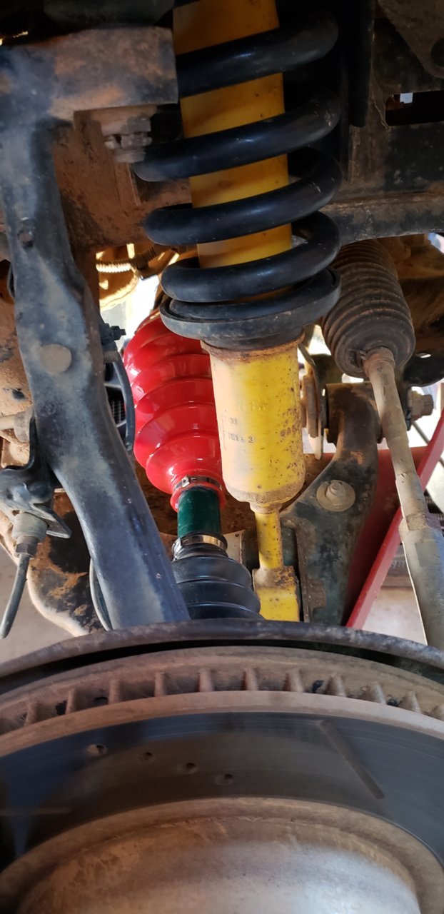

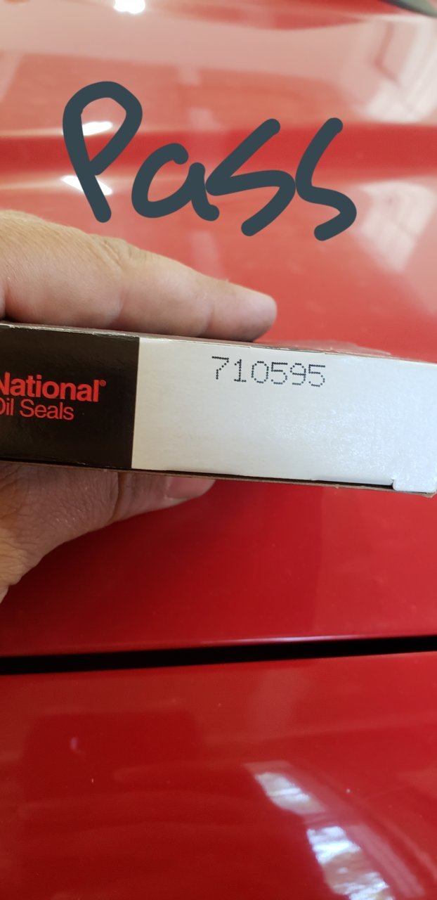

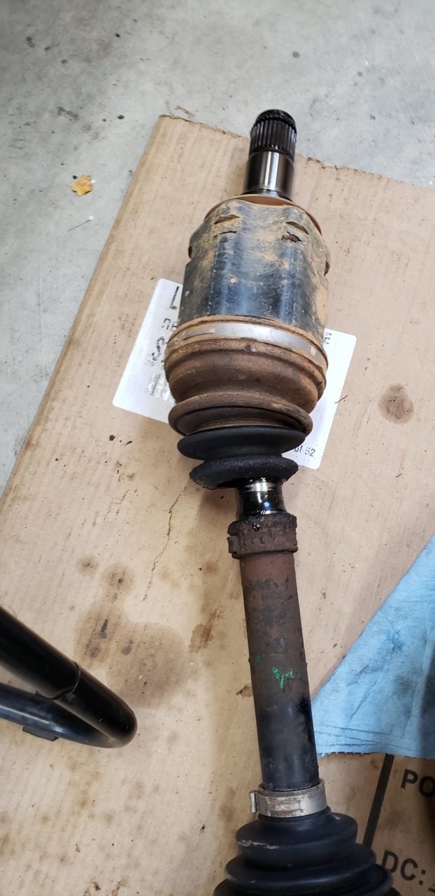

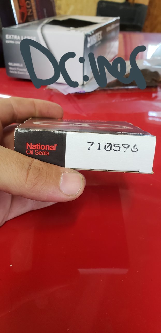

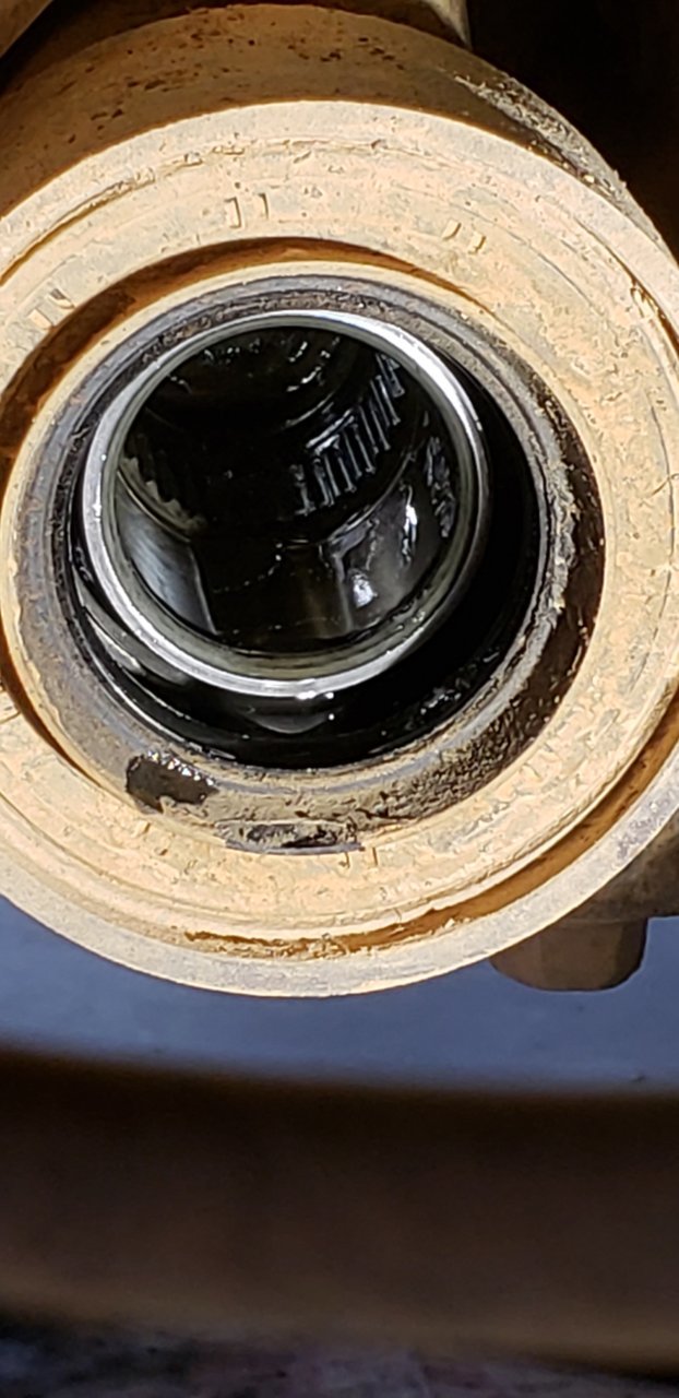

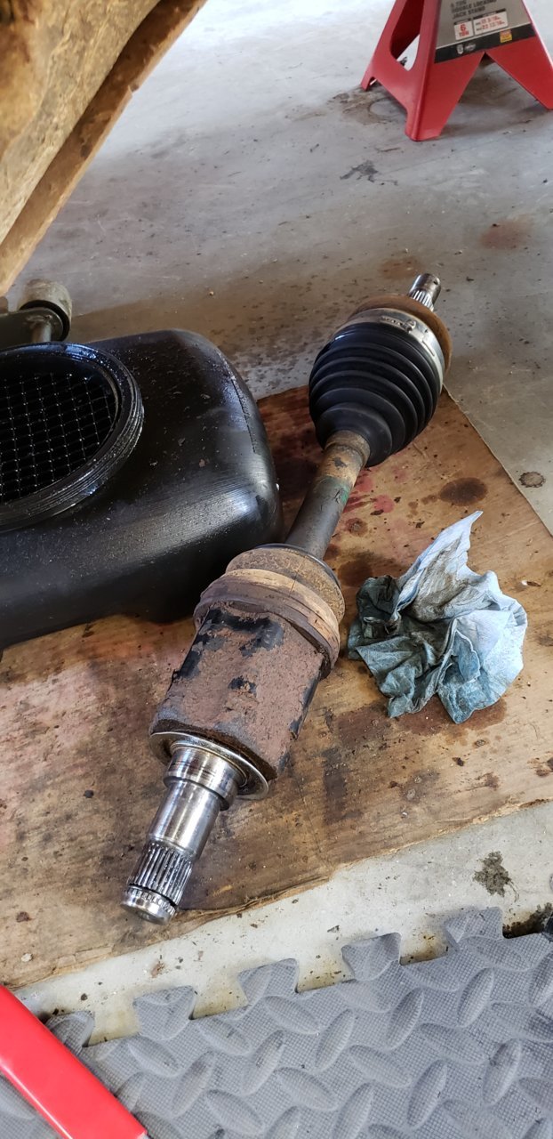

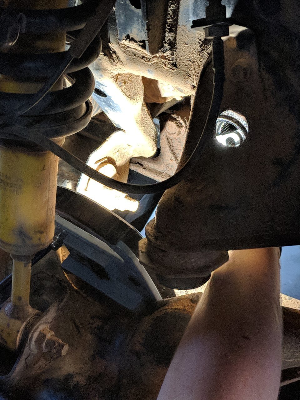

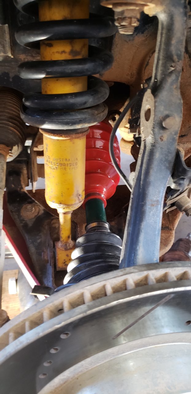

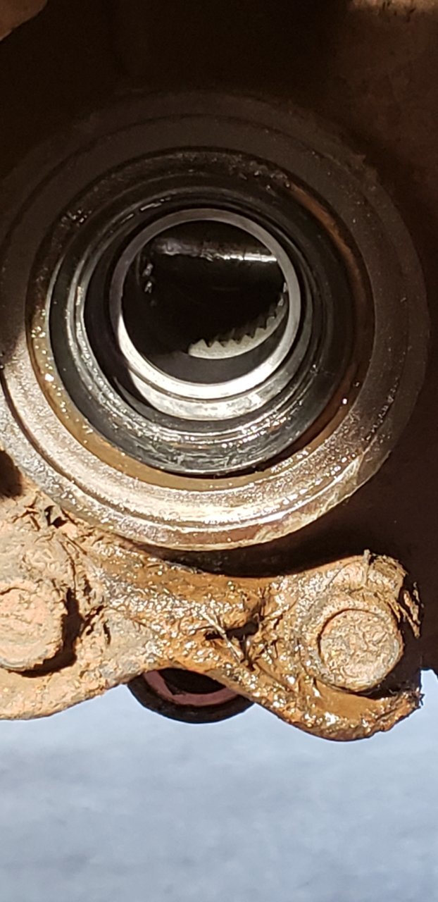

    200569 miles
    New CVJ axles installed (with silicone high angle boots)
    ECGS bushing installed (only one needle was bad)
    New timken oil seal on driver side (left) right one was good, just dirty
    Front and rear diff fluid changed
    Oil change
    Didn't get to do the tie rods yet as the outer ones are for a 2WD so gotta ship them back but they will be next.
