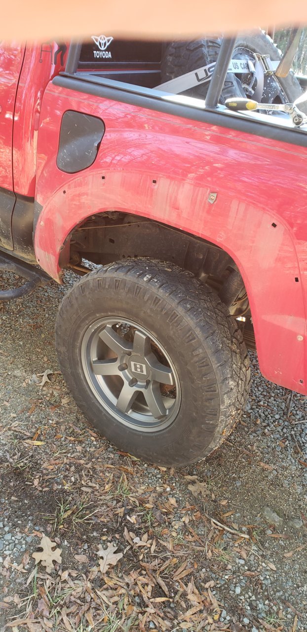

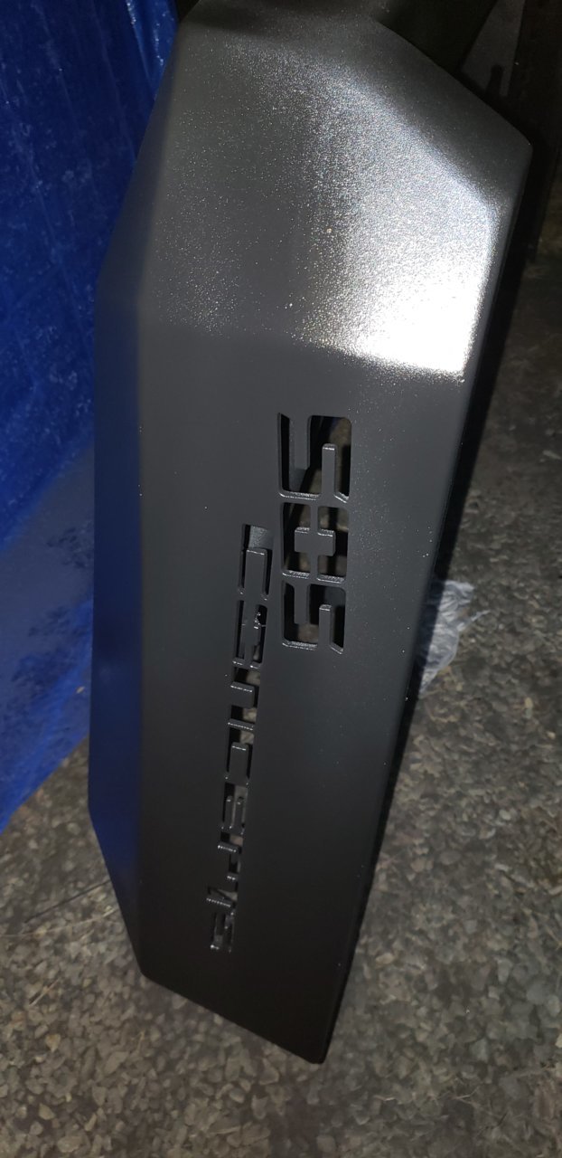

    Looks like a good texture. Not too much and not smooth like paint :thumbsup:
    Now for the bed sides :sawzall:

    How did you prep the inside?

    After the sanding that I could do, it was sand blasted, acetone wash, 2 coats of primer, and now the bed liner

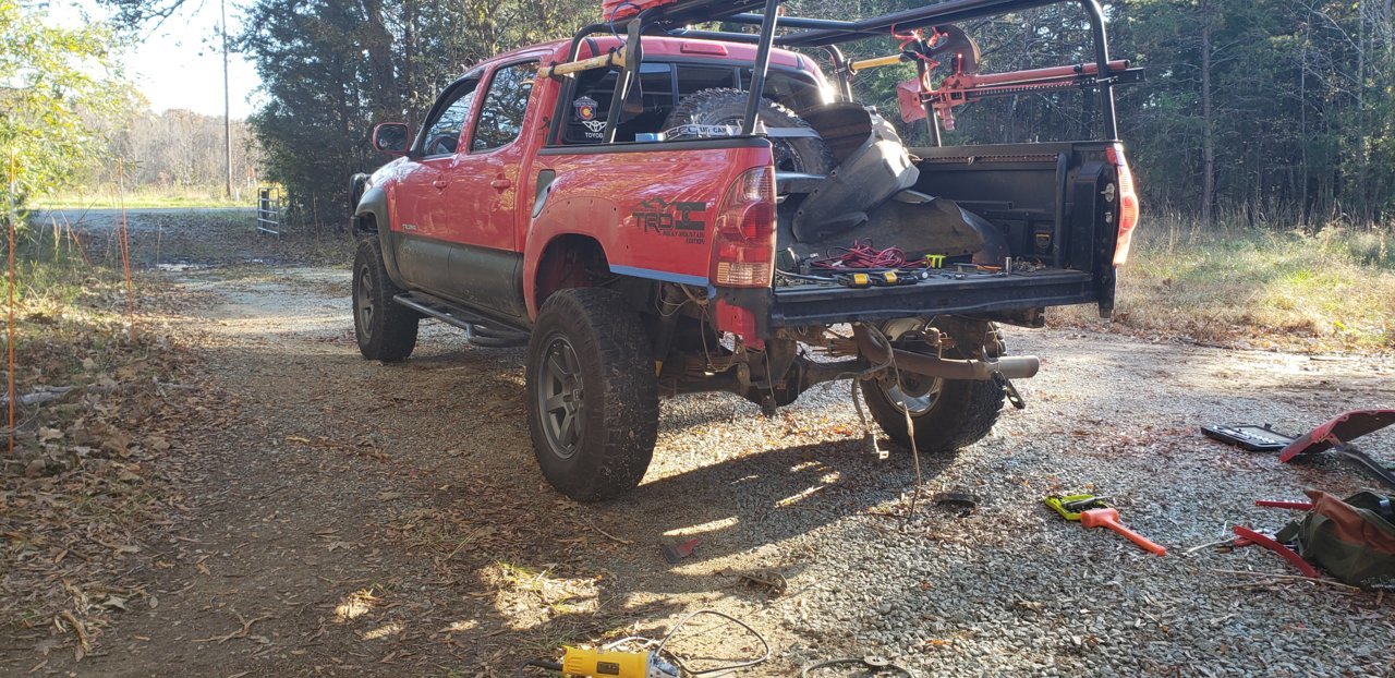

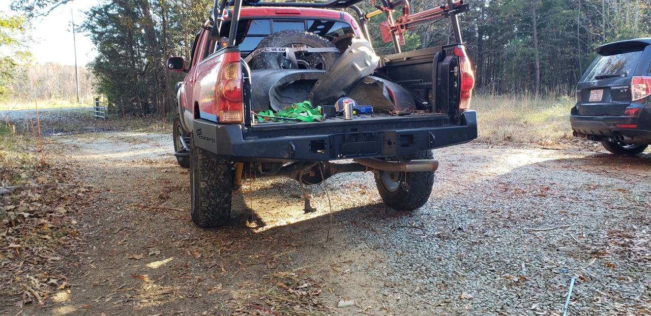

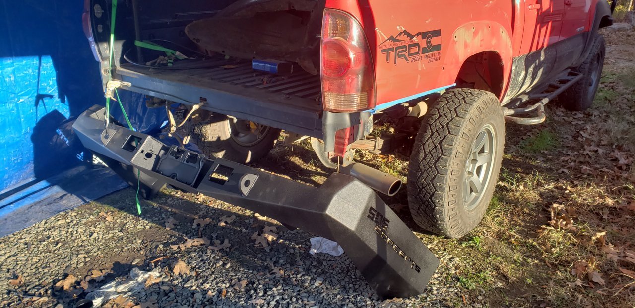

    Well holy shit that's a pain in the ass to do by yourself. Ratchet straps and dead blow hammer ftmfw to keep it held up so you can beat it in to place. I've gotta wire up the back up lights still and then do some touch up but it's done!!! Had to add my broncos license plate to rep the team too :D
    Thanks @EddyRRT @ovrlndkull @dan0mite for the build, transportation, and holding on to it for me lol

    :fistbump::jellydance: Looks good man!!!! Get some of that blk edge trim stuff for the bedsides to finish it off.

    Good to see you joined the dark side!!
    No #asslesstaco pic for @Coop68 ?

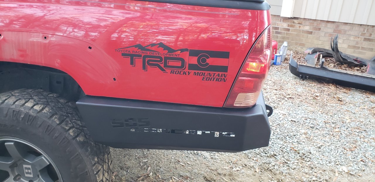

    I know my sos ifs skid has held up to some hard hits
    That bumper should serve you well!! :D

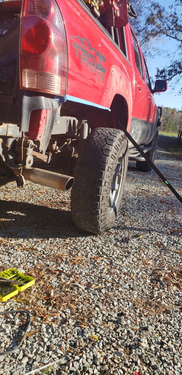

    You should of hacked the exhaust off over the axle while you were cutting on the truck.

    When I cut mine, I cut in the bend right at the spring hanger. Just enough so if it hits a rock it will miss the hanger. But still push most of the exhaust out away from the body

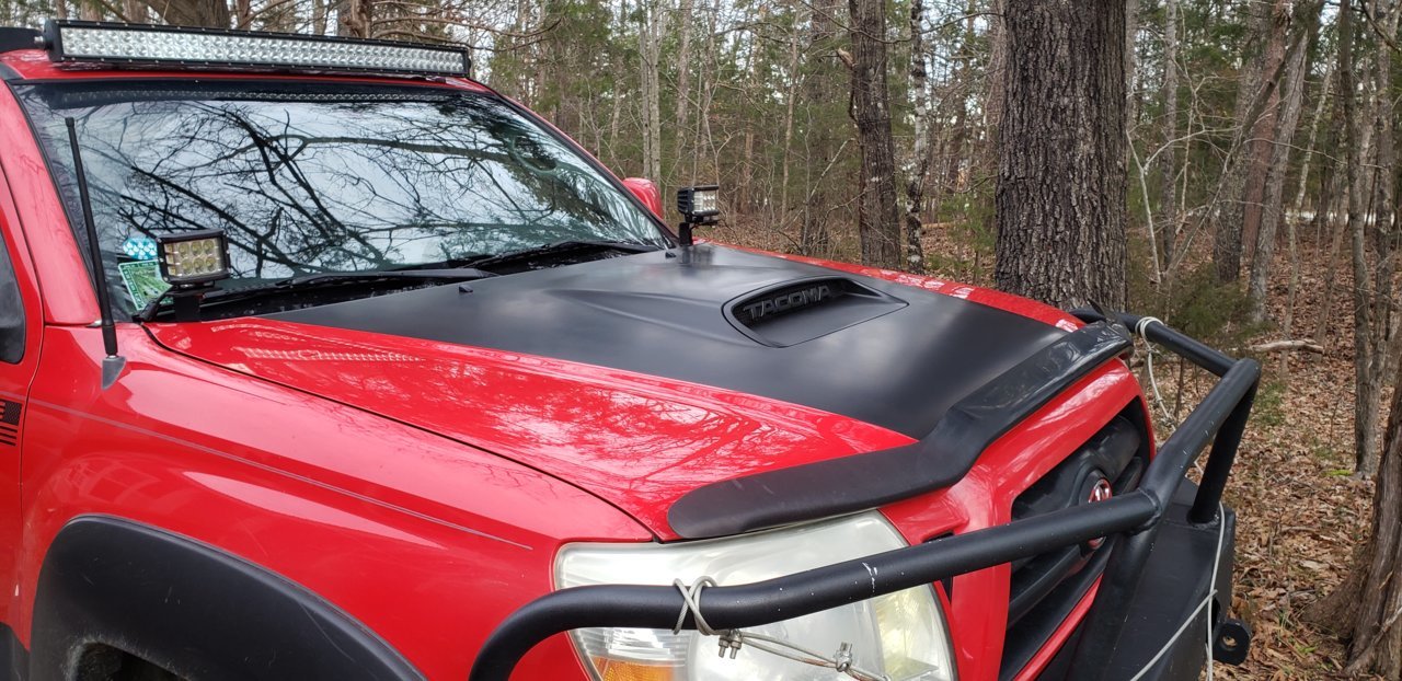

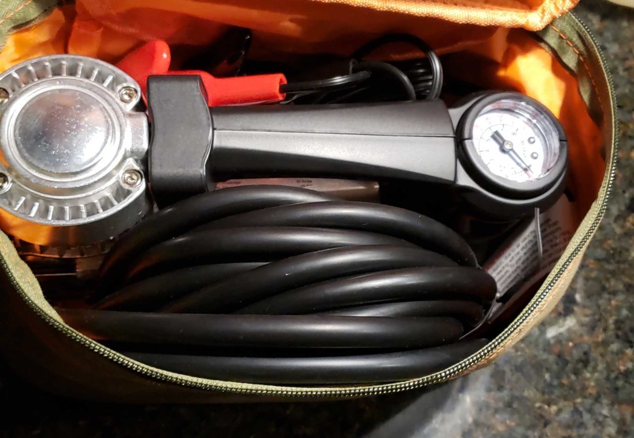

    No more sun glare mod and the wife unit got me an 88p compressor for xmas so I don't have to borrow others any more!

    How'd you do the hood it looks really good!
    Red Baron[OP] likes this.
