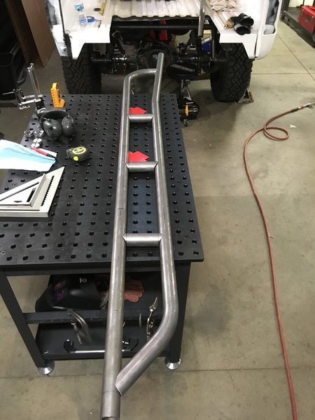

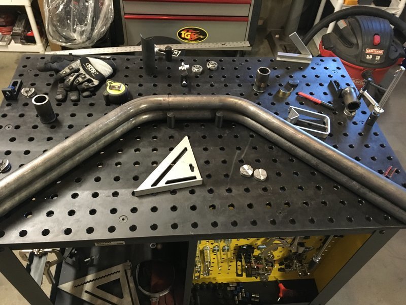

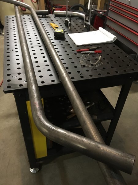

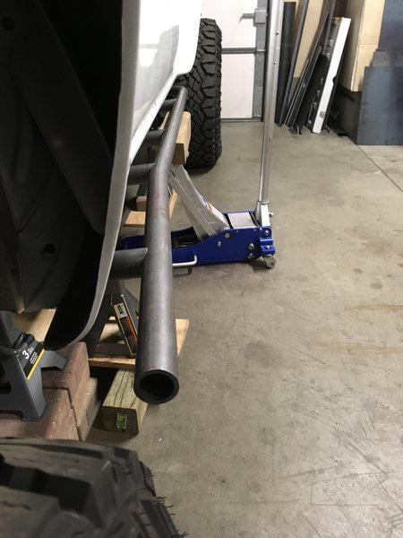

    Had a little time after work to do some bending. So I started making my sliders. DOM 1.75" x .1875"
    Front has a 45 degree bend.

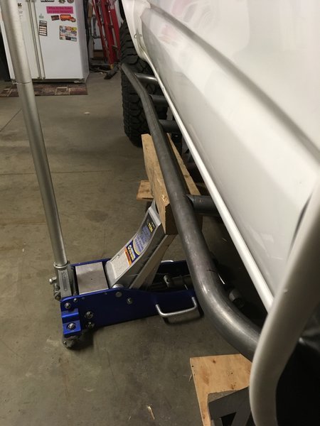

    2 Tac's and ran out of gas. Gonna mock them up, then I'll trim the ends off.
    Set up now with cross braces centered at 16" might add one more and center on 12" ???
    I'm gonna have four cross braces going from the frame to middle tube. Truth be I left the gas on last week.....

    looks strong and clean!

    Those are looking nice! Subtle but effective kick out. Sweet design

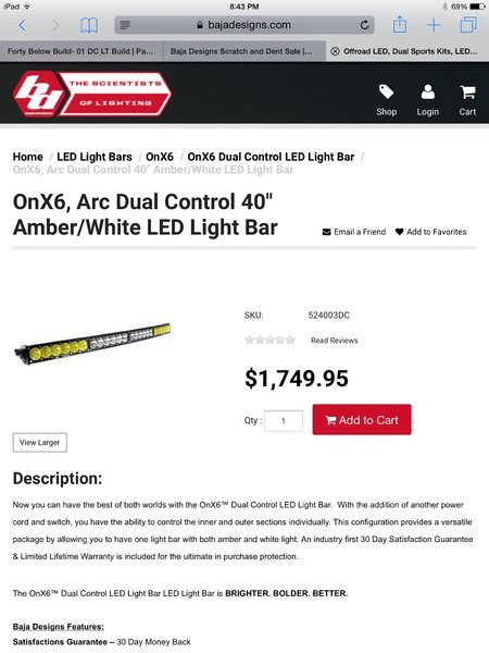

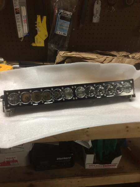

    :D:D:DPicked these up used from a TW member @glorifiedwelder.
    Was gonna go with a led bar on the front, but changed my mind. image.jpg So I think I might sell this Baja Designs 20" Onyx 6. I bought from @Baja Designs on there scratch and dent sale page. They said it was a floor model. It's in great shape. I never did any thing other then take it out of box.
    Then with the funds for selling the 20" light bar I can by this

    I might be interested in your onyx 20 inch if you sell. I have the S8, but it isn't quite as bright as I would like.

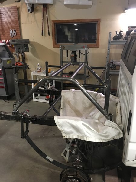

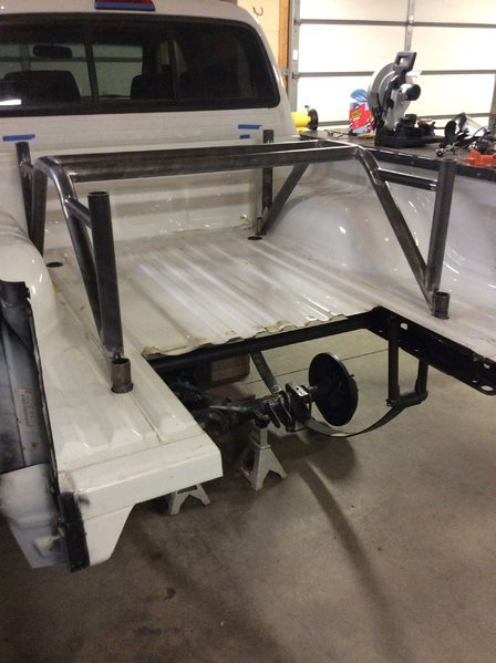

    Made 3 of the 6 mounts for the removeable bed cage.

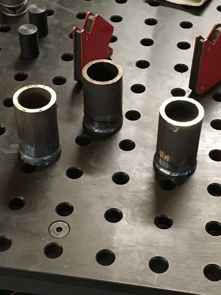

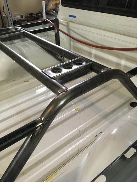

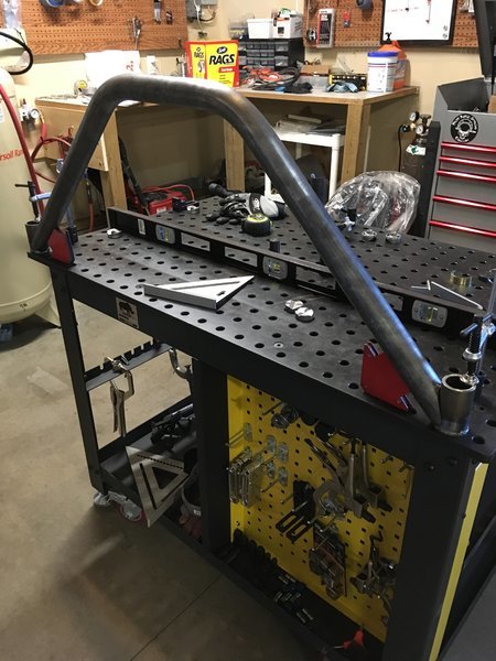

    Did a little more work on making the bed cage. I plan on 4 posts with horizontal braces to mount RTT or a small safari basket.

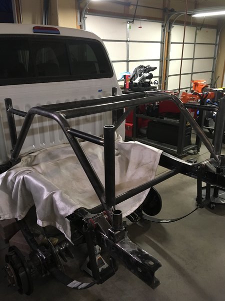

    Got it all tac'd up. Still have to gusset all the mounts to the frame. Install gas tank again, and see if I can fit in a cross brace, thinking fuel fill lines are gonna screw me.

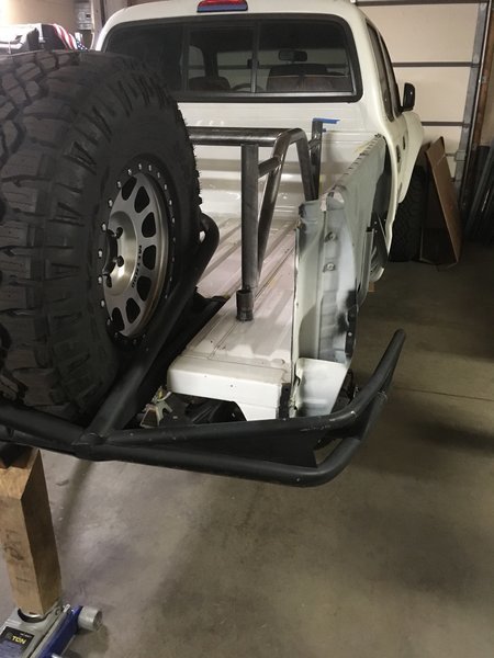

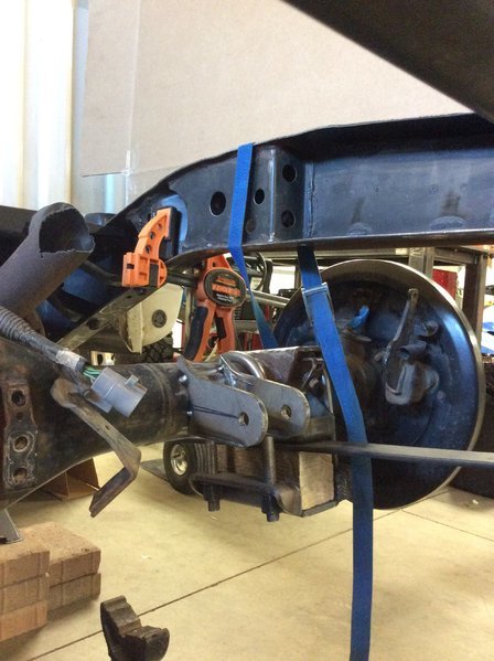

    Cut the holes in the bed for the mounts. Got each one right the very first cut. Fuc'n miracle in my world.
    Mocked it up with the bumper to make sure it all fits.

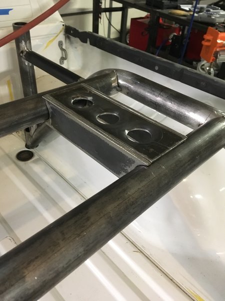

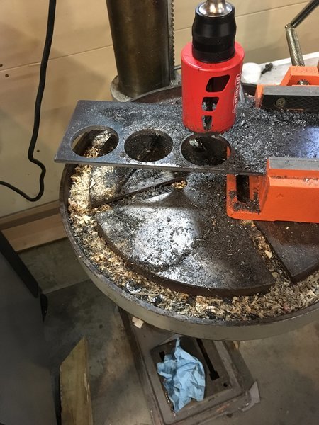

    Just when I get going, work comes to a crawl. Didn't get anywhere near what I wanted done today. I notched some 2"X 1/4" flat bar for the shock mounts. Then added dimples to some 1/8" plate.
