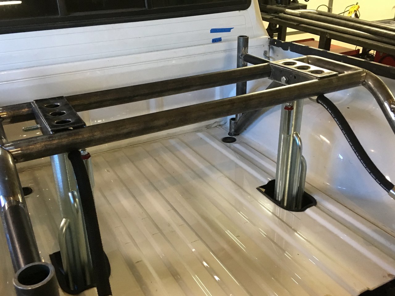

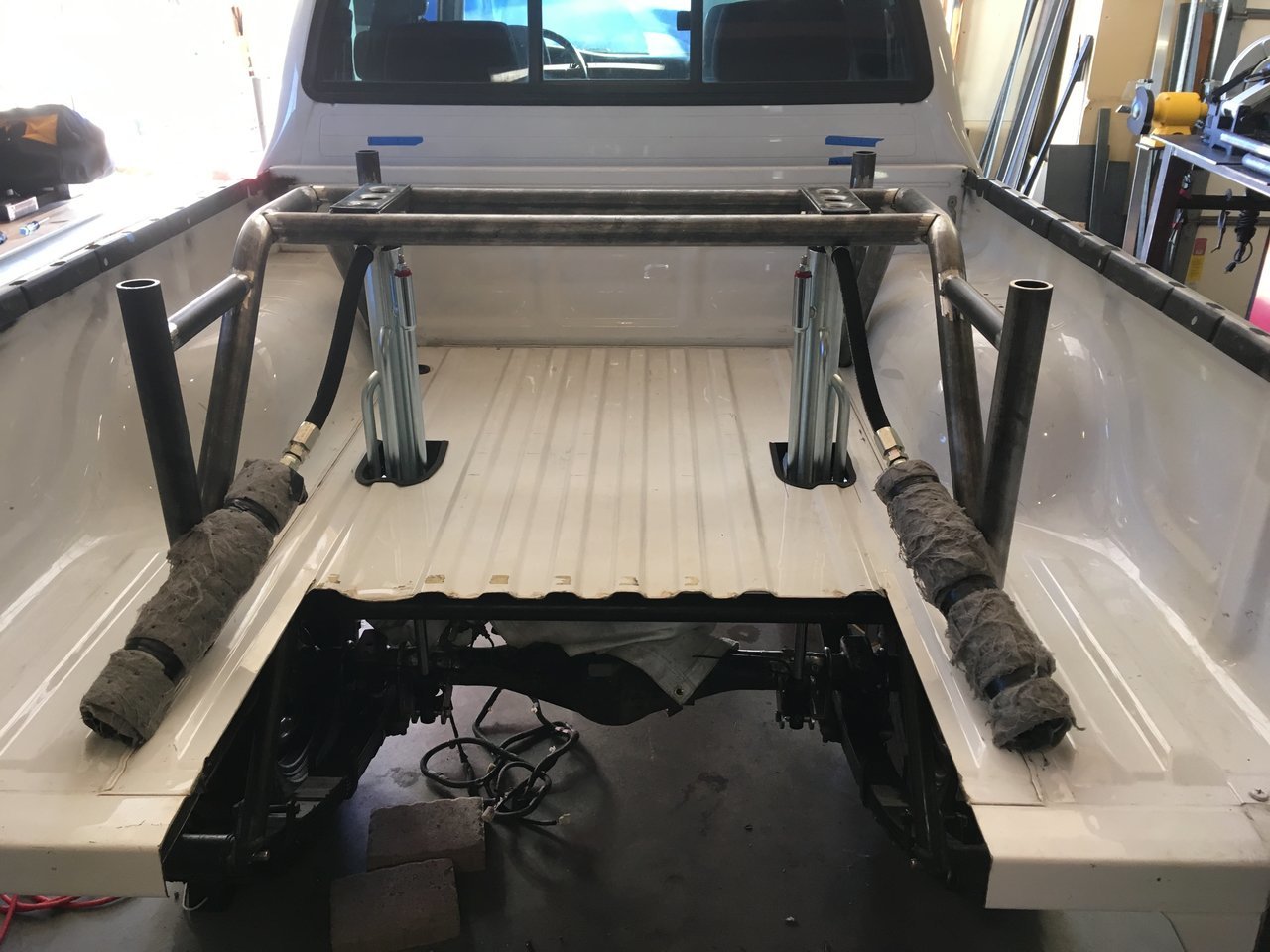

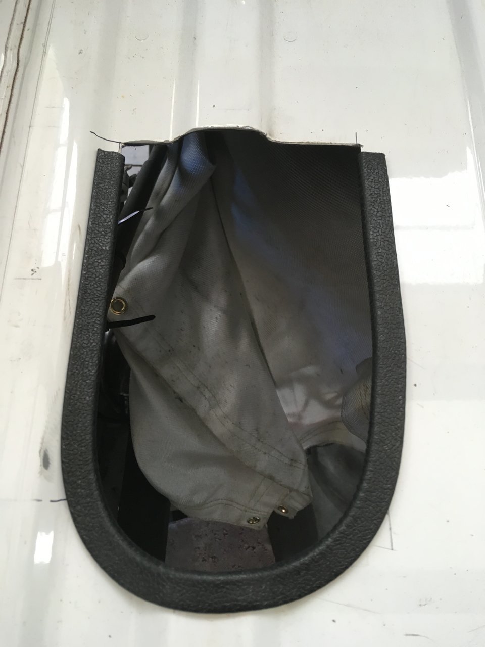

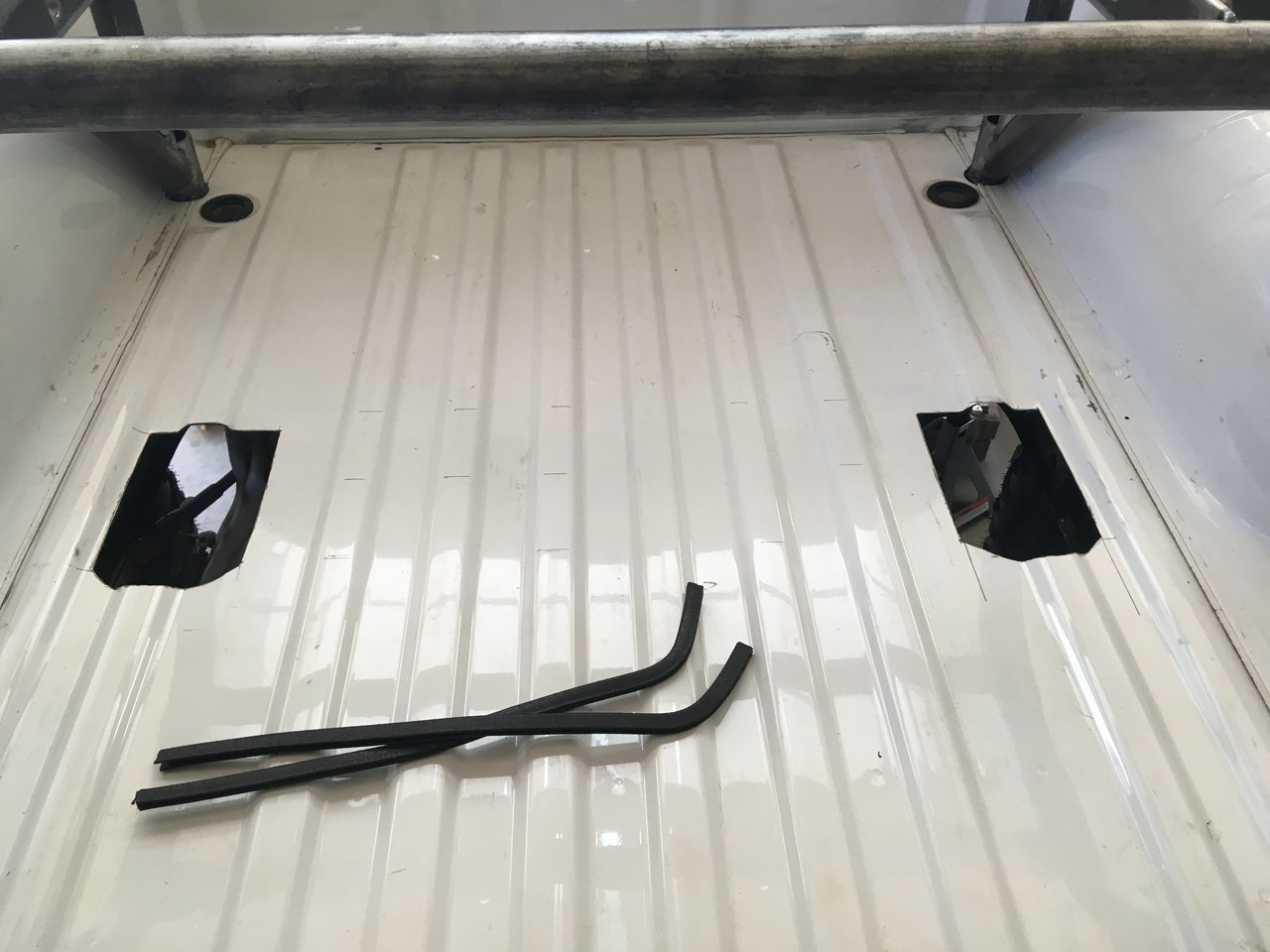

    Cut some holes in the bed for the shocks. Then lined the cut out with some plastic trim. I need to get a little more to finish off the top edges.3278B73B-C094-4382-885F-07677FBEE66D.jpg8FD2A1EA-6D34-4BE6-9B3B-EF12D0D3CA2E.jpg8CCECCAE-4455-4139-AB9B-42AD978193B9.jpgB844A5C9-EAA8-46B0-87BA-0B1312EBB0C6.jpg

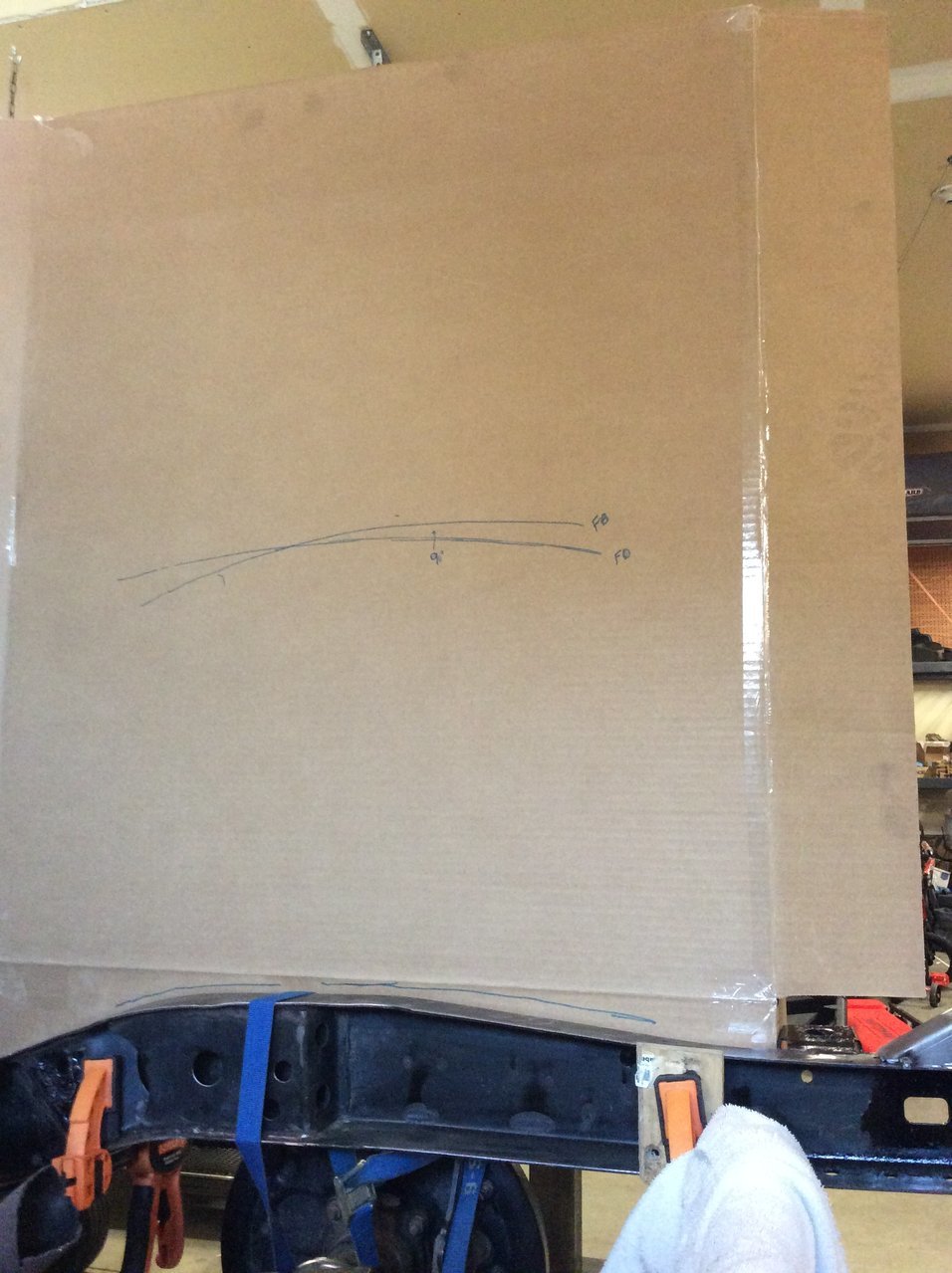

    Gettin after it. How did you determine the mourning location for the shocks?
  9. Oct 28, 2017 at 8:56 PM
    #229
    -40
    -40 [OP] Well-Known Member
    Jul 26, 2015
    #160383
    1,057
    North Dakota
    01 DC Camburg LT & 17 OR OME BP-51
    1 st Gen TRD Supercharger. URD 7th Inj. Camburg 4x4 LT Kit. Tundra Brakes. 3rd Gen just get’n started, OME BP51 Dakar HD, Camburg UCA & various armor.
    I wanted the shocks to be near vertical. I gathered from other members posts the vertical position is easiest for tuning purposes. I used a sharpie and some cardboard and traced out the arch at full bump and droop. Then lots and lots of cycling the suspension. C145AF17-C579-4983-92CB-0AC551D9CED1.jpg
