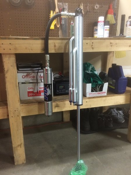

    After years of believing that I had 10" my wife is doubting me....:eek:image.jpg

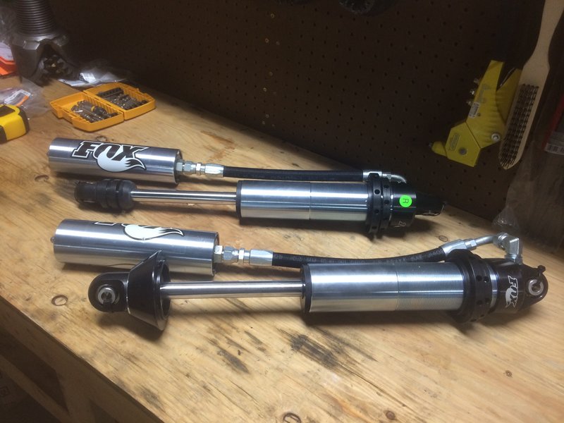

    And in case you tell your wife you got 18" :brianr: I showed her this.image.jpg

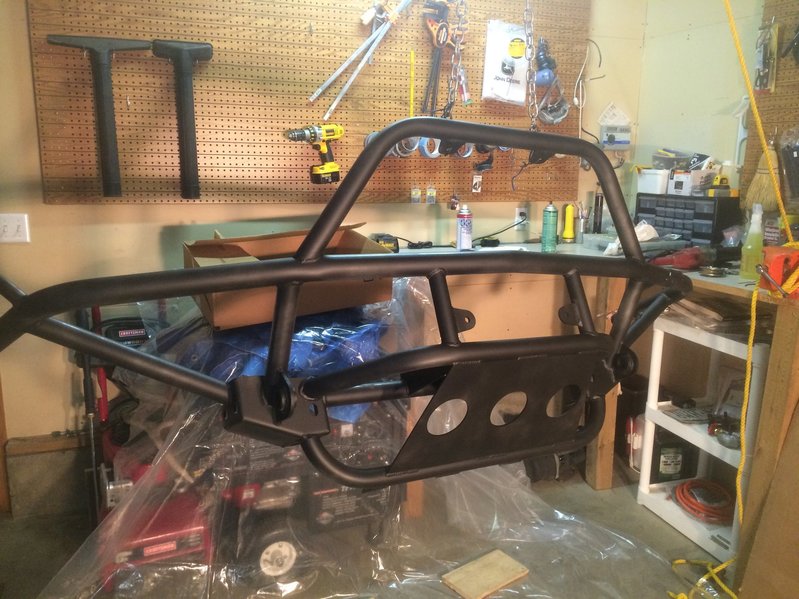

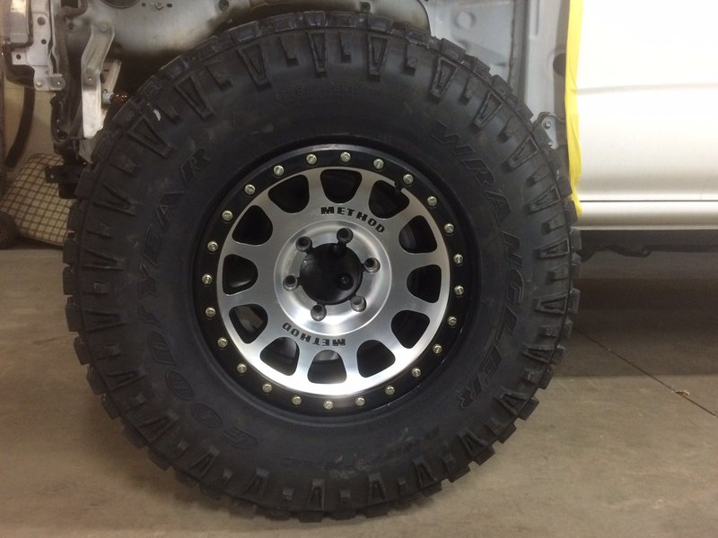

    Picked up some new Duratracs this afternoon. 285/75/16. Still wondering if I should have went with the solid black rims instead. Had I bought the solid black I'd be wondering if I should have bought these. Not sure why I care, they will be scratched to shit in no time.image.jpg

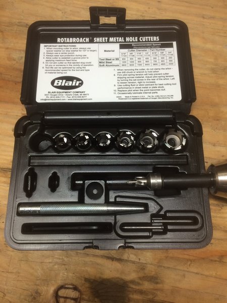

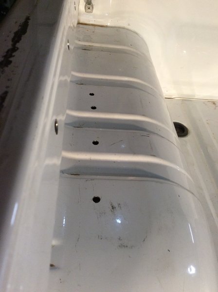

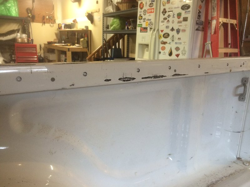

    Drilled out the spot welds on the bed. I just drilled until the sheet metal separated. I'll go back and drill them all the way later.image.jpg

    There are four in the wheel well on the driver side, and 3 on the passenger side.image.jpg

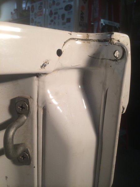

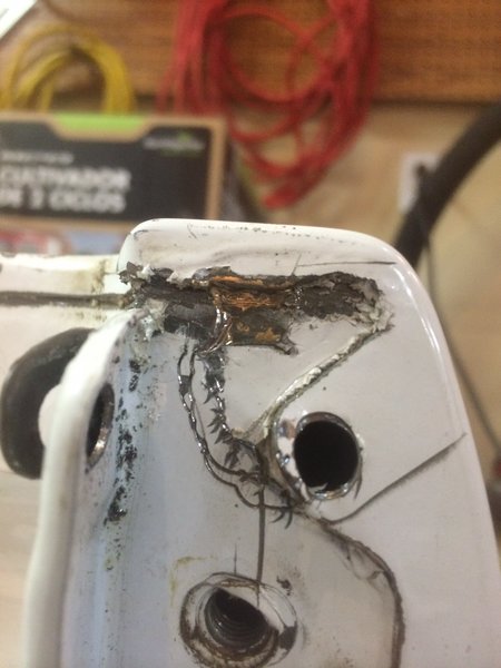

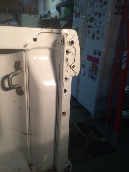

    I'm having trouble in the inside corner near the top. Doesn't appear to be a spot weld. The articles I've read don't mention this as a problem area. All the other spots the sheet metal has separated. Once I figure it out I'll remove the bed from the frame.image.jpgimage.jpg

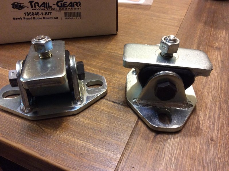

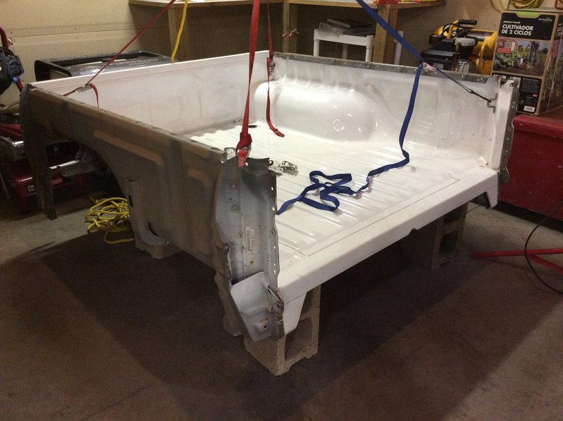

    Got some more parts delivered today. TG bomb proof motor mounts. Hoping to install them and the URD 7th injector this weekend. Figure with the bed off it will be easier to drop the fuel tank.image.jpg

    image.jpg Removed the bedsides. The inside corner was difficult. The weld was not a spot weld it was rather sloppy, almost like a brazing. I scraped the paint until I found what was holding it.
