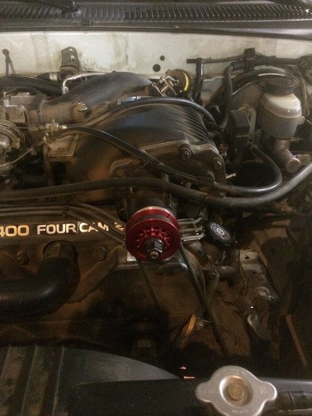

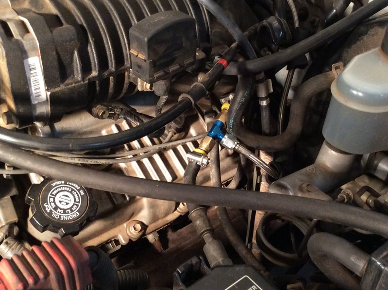

    URD 7th injector and 2.1 Pulley.

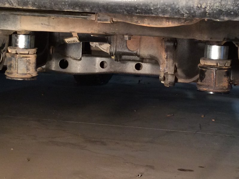

    TC Diff Drop Kit

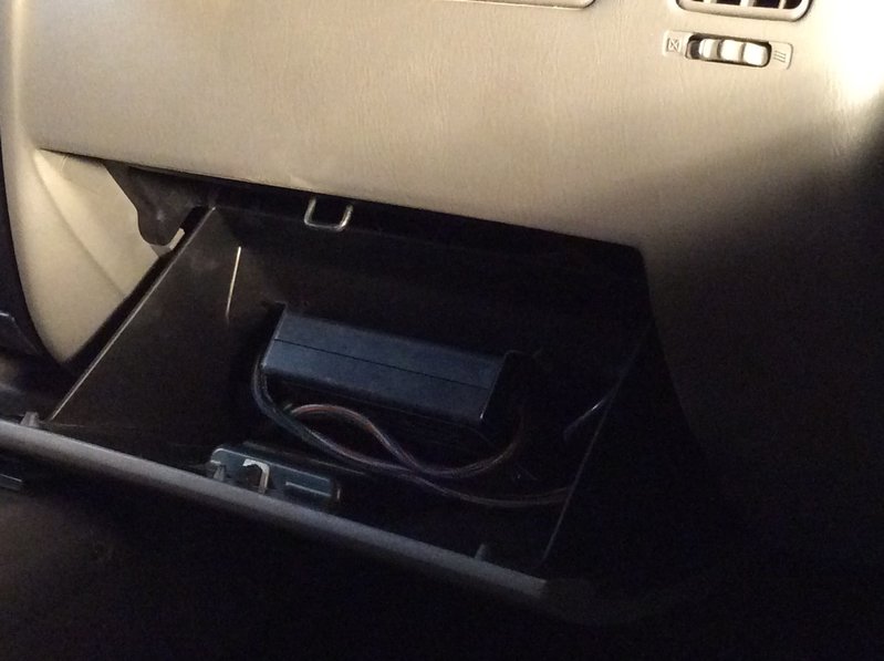

    image.jpg image.jpg image.jpg URD 7th injector kit. I mounted the ECM in the glove box.

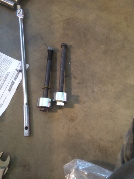

    TC diff drop kit

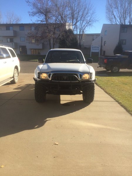

    image.jpg image.jpg Wife was wanting her spot back in the garage. I'm done working on the truck this week. I go back to work.
    Should give me time to order my tundra brake conversion parts.
    Plan is to complete the entire front end in 2 weeks.
    1st. The tundra brake swap.
    2 Camburg LT Kit. W Tundra CV's.
    3 solid motor mounts
    4 bump stops up front and the limit straps
    5 After hours work ......pinch weld mod, maybe body chop mount. :proposetoast::proposetoast:
    after the front end is done I'm gonna finish up the fenders and hood.
    ChadsPride likes this.

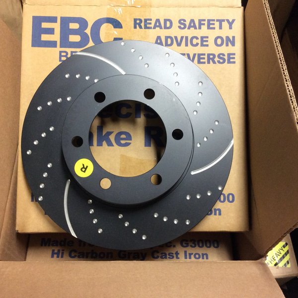

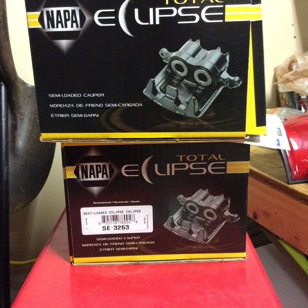

    EBC Rotors and Pads got delivered today. Calipers I picked up from Napa the other day.
    Hopefully get them installed next week. After I read the safety advice of course.image.jpgimage.jpg

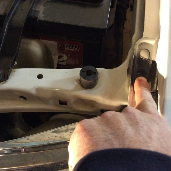

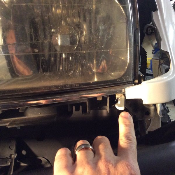

    How was it removing the fenders and where were the two spot welds you mention?
    Thanks.

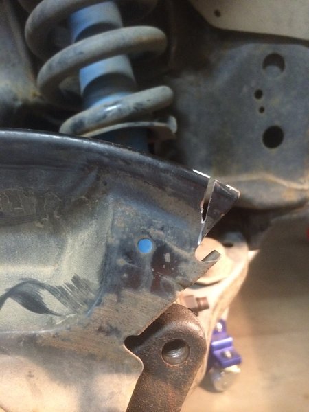

    The front fenders are really easy.
    The spot welds are on a support bracket that sticks out, and then near the very end of the fender just under the head light.
  14. Nov 12, 2015 at 2:06 PM

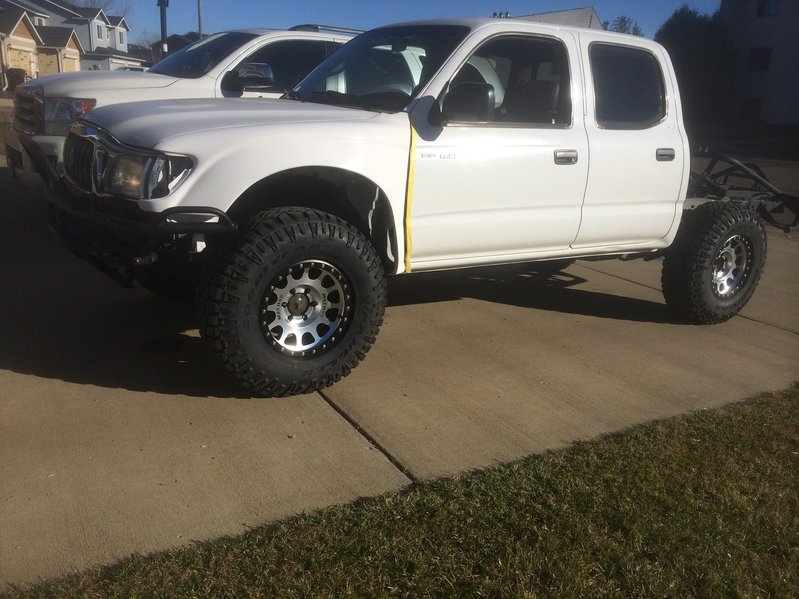

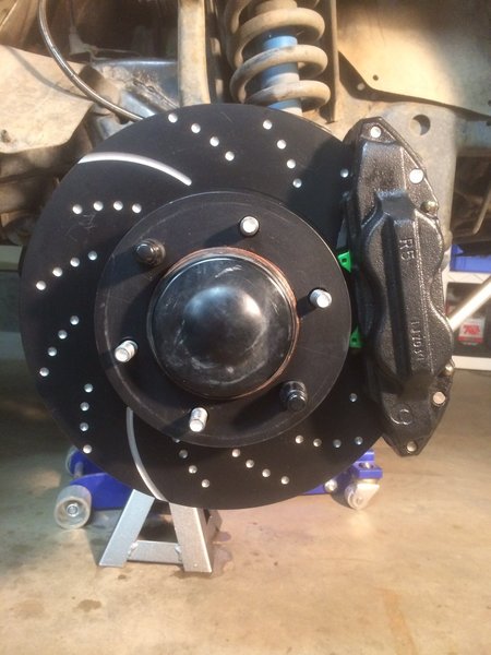

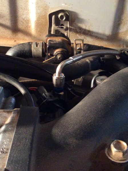

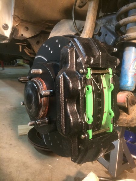

    I managed to get the Tundra Brake swap done last week. Worked a little after work each night. I followed this link. To be clear I used the 13WL calipers from Napa. EBC Rotors and EBC Brake Pads. I used parts that would fit on a 2005 Tundra. I altered the Banjo bolt, but only temporary. I wanted to make sure my rims ( Method NV 16x8 w/ 4.5 BS) cleared the calipers before I ordered custom brake lines.

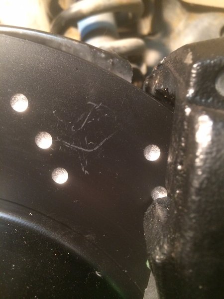

    Before I trimmed it and after.
