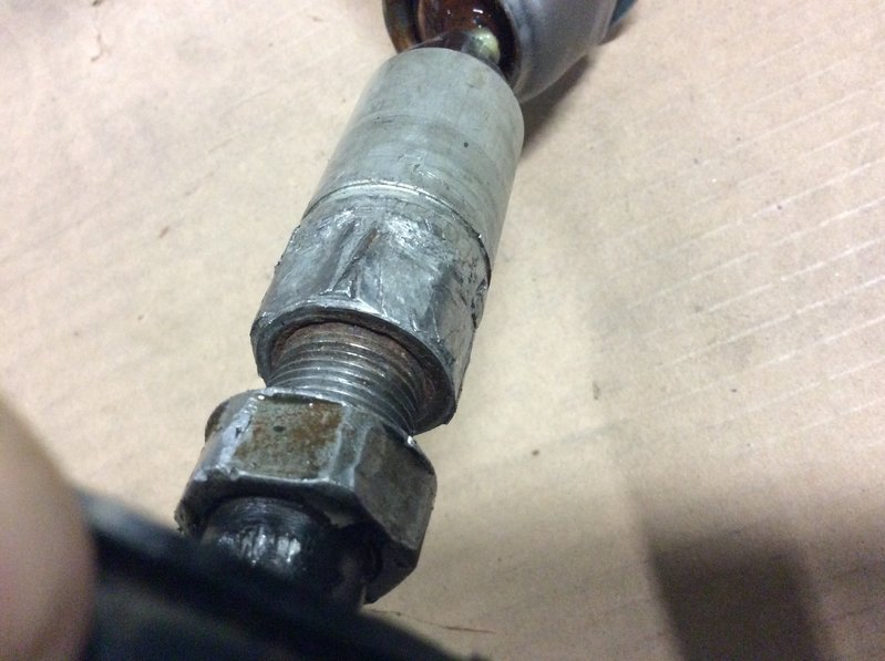

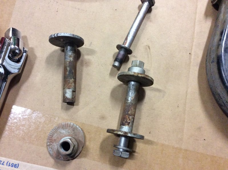

    I started to tear the front suspension off. Things went good at first. I ran into 2 problems. First problem was one of the Camber Bolts had to be beat out pretty good. The second was passenger side outer tie rod was seized up to the inner. I had to order new parts for both. image.jpgimage.jpg

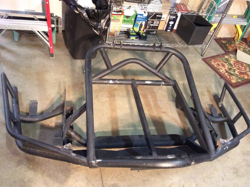

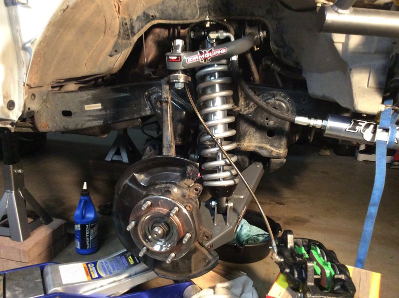

    Managed to get all of the old suspension out along with the CV's. I mocked up a few things so I can visualize it all. I started looking at where and what angle I'll mount the bump stops(A few guys in the LT thread answered my questions about that. Thanks to Anthony250f and FlapJack935 for the info and some pictures) where the brake lines will go, where do I want the zerks facing etc... I do plan on putting it all back together, cycling it all before I start tacking stuff on. I just like to visualize things so I can plan my next 20 moves. Got a long way to go but it's a start.

    subbed. brings back memories putting mine on lol gonna be badass man youll love it. thats Juans old tire carrier right?

    I think it might be. They guy I bought it from in AZ showed me a picture and the license plate said Juan 51 or something like that. I bought it from a user named outdoor AZ I think.

    yea thats his, defiantly a nice bumper/carrier. have anymore pics on it on? was thinking of picking it up when it was for sale but i already had my relentless bumper. good to see it go to a sweet build

    I'm a ways away from mounting it. Its just sitting on the floor.

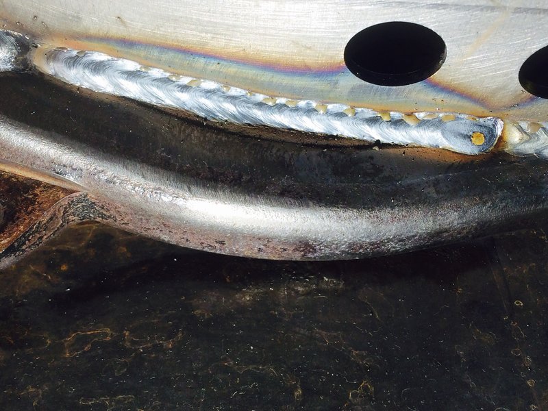

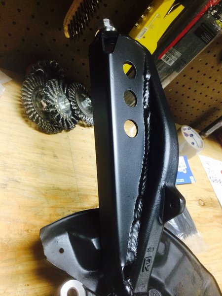

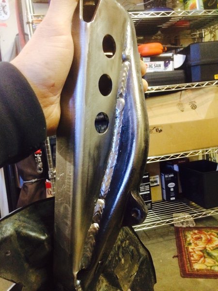

    Days off couldn't come soon enough. Got the TC Spindle gussets on today.image.jpgimage.jpg

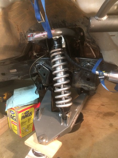

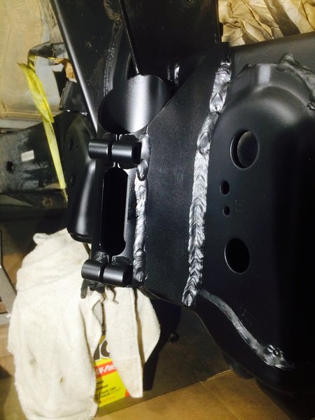

    Got the cans mounted today. Took me all day. Started with cardboard templates. Cycle suspension. Tack mounts, cycle suspension, tack brackets,cycle suspension. Take suspension off to make room to weld. Damn I'm getting good and taking this off and putting it back on. image.jpgimage.jpg

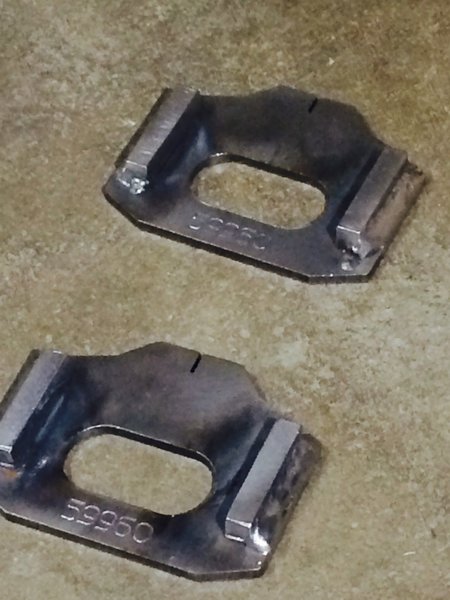

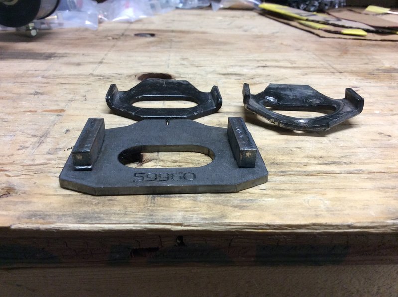

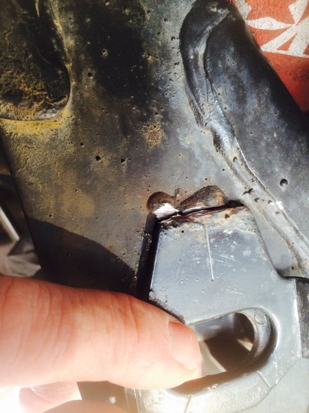

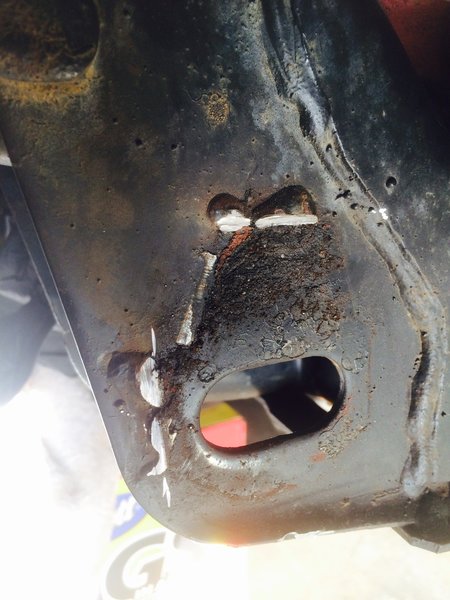

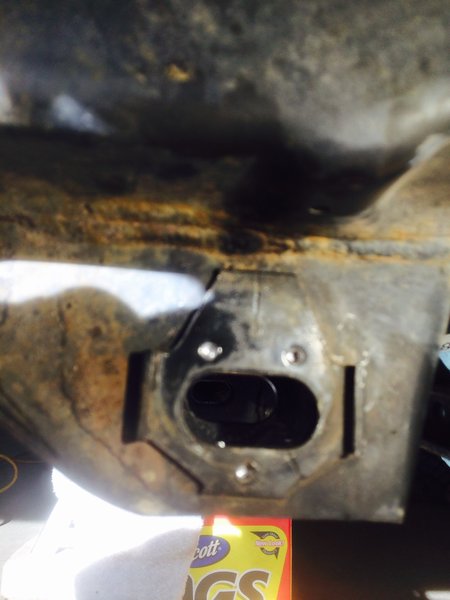

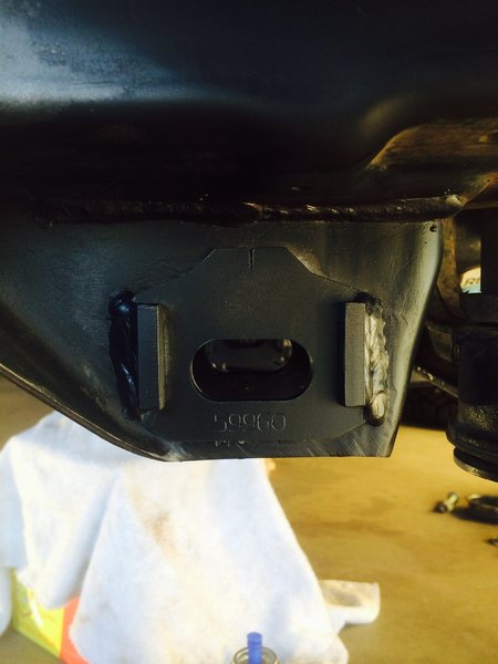

    Removed the factory cam tabs today.
    On the rear 2 I used a Dremel with a cutting wheel on the welds. Then a air chisel to remove them. The rears came off easily.image.jpg image.jpg The fronts are a bit more difficult. It was tight in one spot and I was unable to get a drill straight on the spot welds.

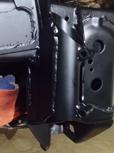

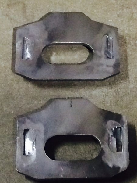

    Welded up the TC cam tabs. I'll put them on tommorow. (Shitty photos)

    Welded on and first coat of primer.

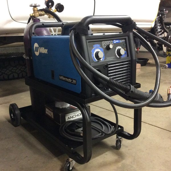

    Some random pictures and my new welder I got myself for Xmas last week.

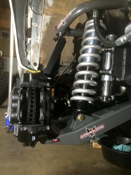

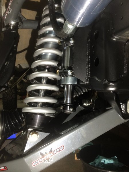

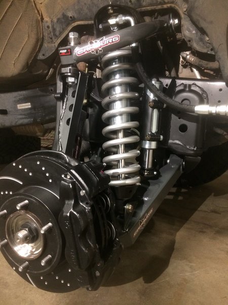

    I got the suspension put on tonight. I still have to torque everything up at ride height. Put the brake pads on and get the twist out of the brake line. Also have to mount the remote resi.
