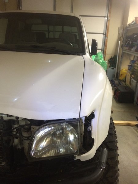

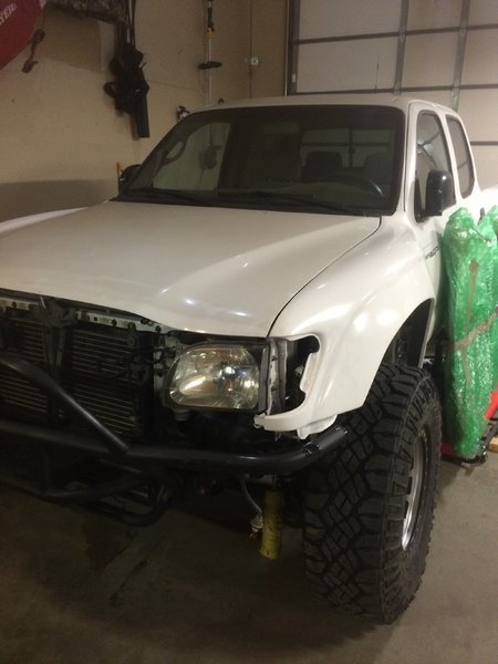

    The front glass went on pretty smooth. It's not perfect and I don't really care. We don't have Malls where I'm at. That's the supercharger hood still wrapped up. Maybe I'll get that on this weekend. And by weekend I mean Sunday from 10am- 3pm.

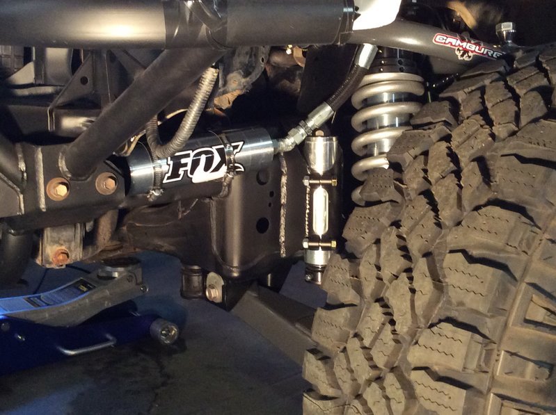

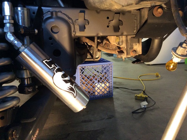

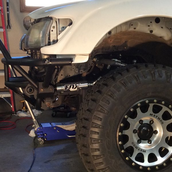

    Got around to mounting the remote reserviors. I made shorter hoses, the factory hoses where way too long. Then added some 45 degree JIC fittings. Welded on the mounts, primed and painted. image.jpgimage.jpgimage.jpg

    How did you crack them open without losing oil and pressure and whatever?
  12. Feb 23, 2016 at 6:56 PM
    #92
    -40
    -40 [OP] Well-Known Member
    Jul 26, 2015
    #160383
    1,057
    North Dakota
    01 DC Camburg LT & 17 OR OME BP-51
    1 st Gen TRD Supercharger. URD 7th Inj. Camburg 4x4 LT Kit. Tundra Brakes. 3rd Gen just get’n started, OME BP51 Dakar HD, Camburg UCA & various armor.
    I had already released the psi when I was putting the front suspension on. I held the reservior with the valve up and released it slowly I had a tiny amount of fluid leak out. When I took apart the hose I made sure the shock was stroked all the way out. I unbolted it right at the top of the shock tower, I lost a few drops. Then took the reservior and guessed at the volume the hose held. Poured 2-3 ounces into a container, waited ten minutes or so for it to drip down the hose and back into the reservoir. It was actually pretty clean I thought it would make a bigger mess.

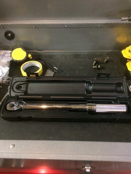

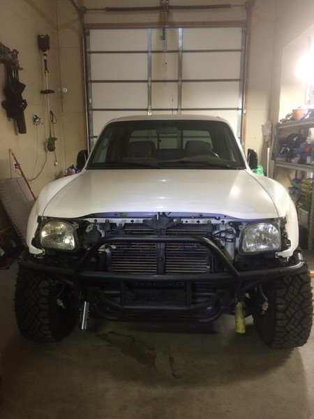

    Tried to mount the super charger hood: Fail. Couldn't find riv nuts long enough around town.
    My new Torque Wrench (CDI ) came this week so I finally got the front suspension torqued to spec. Win.
    Planned on changing front diff fluid: Failed. I got side tracked.

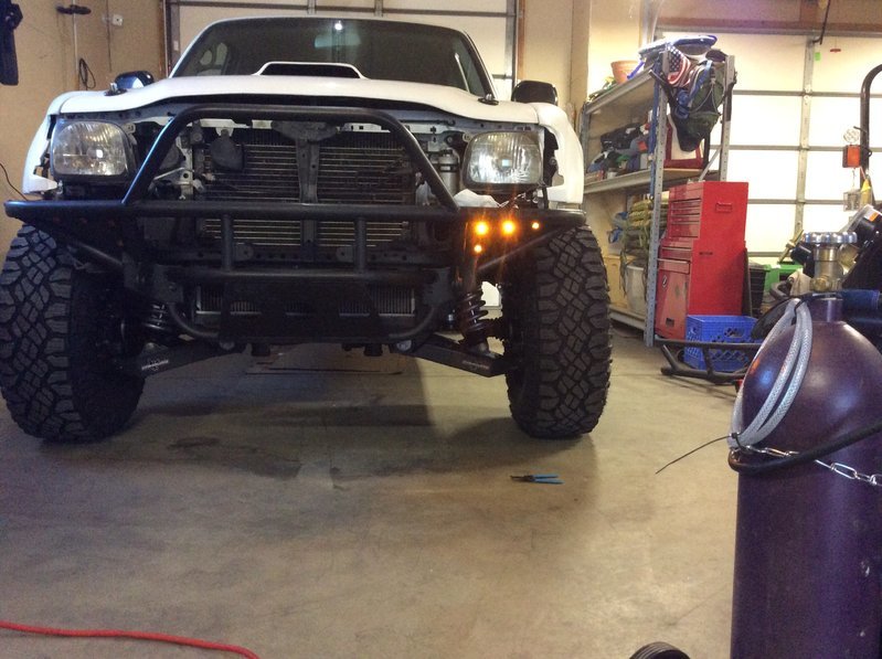

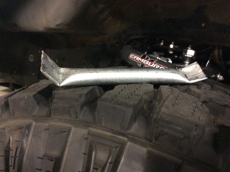

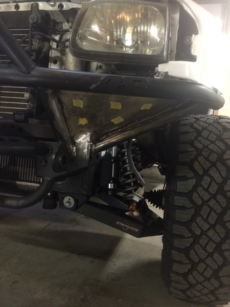

    Made some filler plates for the bumper. Tie, first one I cut too short, second one was good.Couldn't find reasonable priced led markers, so I ordered them from Amazon.
    Plan is to put the led turn signals where the yellow tape is on the filler plate.

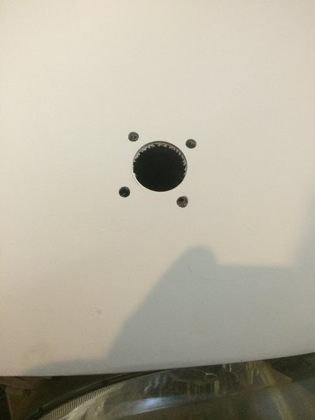

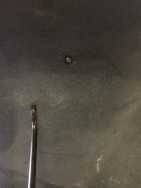

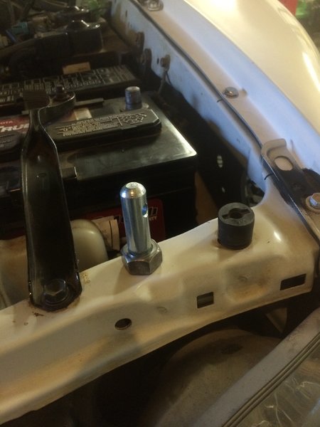

    I mounted the hood pins tonight.

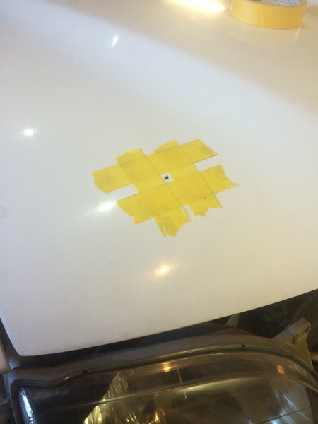

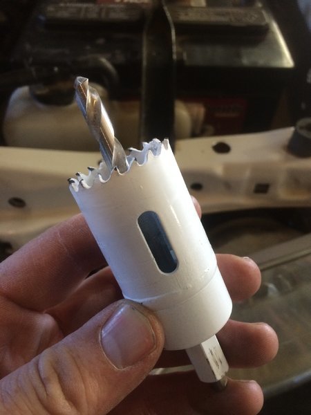

    Started out with putting the hood pins in a pre existing hole. ( I used this spot as a reference to make the holes even on both sides of the hood) I then placed grease on the ends of the pins and closed the hood.
    I circled the spot where the grease made contact under the hood.
    I drilled a pilot hole, then tapped off an area about 2"x2"
    Now the best part. Cutting a hole in a perfectly good hood.

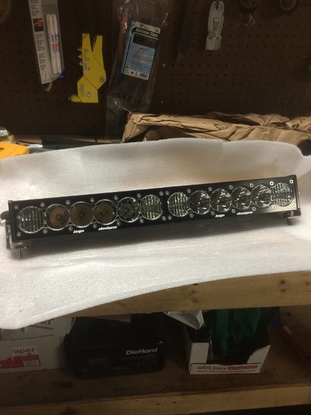

    New light bar was here when I got home. 20" Baja Designs.
    Got it off the Baja Designs Scratch and Dent Thread (@Baja Designs )Hardly a scratch on it.

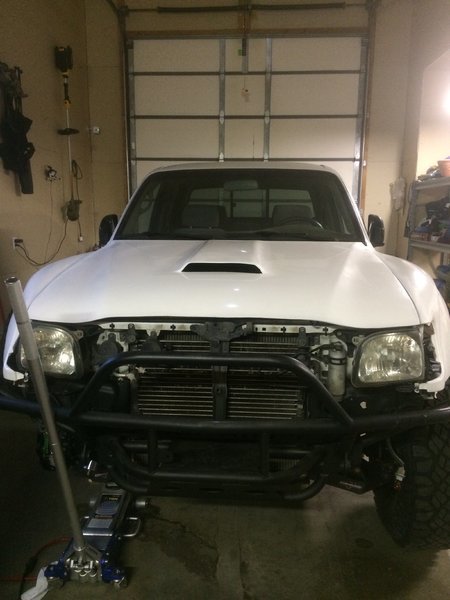

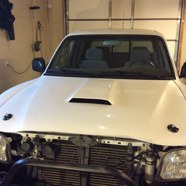

    Hood pins installed. Look cool but not really fun to install. Rounded hood made for a PIA install.
    And I forgot to install the squirter nozzles.

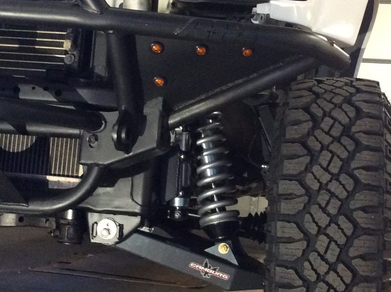

    Got the filler plates done, primed them and put the LED's in.
