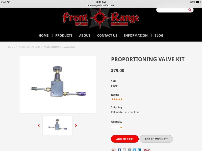

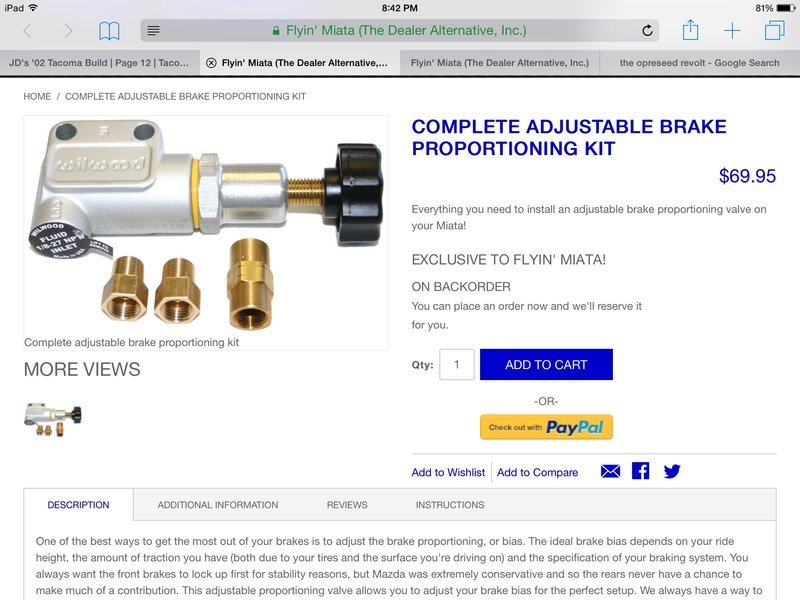

    I've been researching manual brake proportioning valves. Anyone have suggestions on brand ? I'd really like something that I won't have to spend a day looking for a fitting to fit a fitting to fit a fitting:annoyed:.
    Saw this on a members site. Seems like a good deal. I'd like something with all the correct parts to start with.
    SilverGhost likes this.

    Most I've seen use Wilwood. Yeah you need fittings. Use a swagelok for sure! Works amazing
  17. Apr 27, 2016 at 6:36 AM
    #117
    -40
    -40 [OP] Well-Known Member
    Jul 26, 2015
    #160383
    1,057
    North Dakota
    01 DC Camburg LT & 17 OR OME BP-51
    1 st Gen TRD Supercharger. URD 7th Inj. Camburg 4x4 LT Kit. Tundra Brakes. 3rd Gen just get’n started, OME BP51 Dakar HD, Camburg UCA & various armor.
    Ended up going with this one. Couple other people recommended it, has the fittings and wasn't back ordered.
