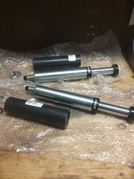

    So I sold the fox bump stops and the frame mounts at a loss :annoyed:
    Decided to go thru the frame instead. So now I got these:D:

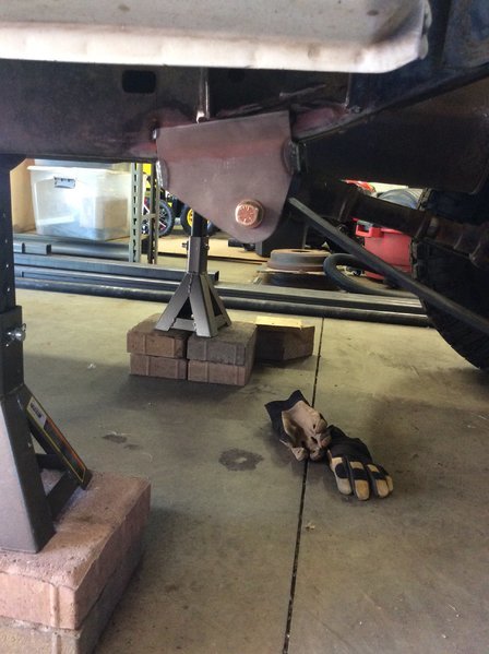

    Tac'd up the hangers, perches and cycled suspension.I think Im back about .5" too much. Gonna cut off the perches and move everything forward .5"

    i also like to use pavers and jack extensions lol

    It has been on those all summer. They are the "heavy duty" pavers.

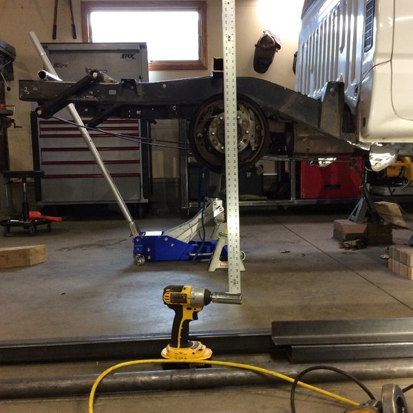

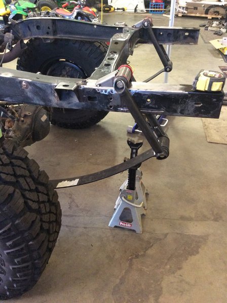

    I Moved the perches forward 0.5"
    Removed the rear cross member and tac'd in a temporary.
    This is where it sits just as the springs look like they are about to go negative arch. Shitty picture but the center of axle is about 26.5-26.75" off the ground.

    im impressed by your balancing skills of the ruler on top of the socket on the drill :thumbsup:

    I didn't even notice that lol funny shit. A guy has to do what a guy has to do to get every inch of travel.

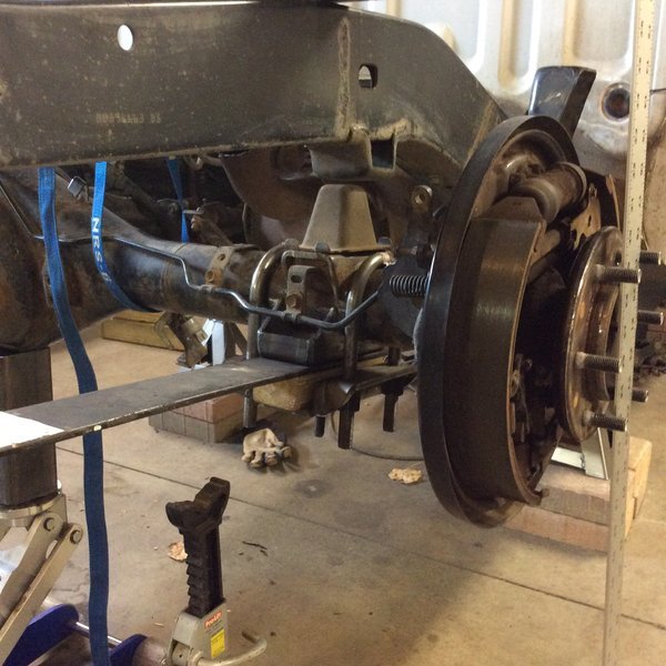

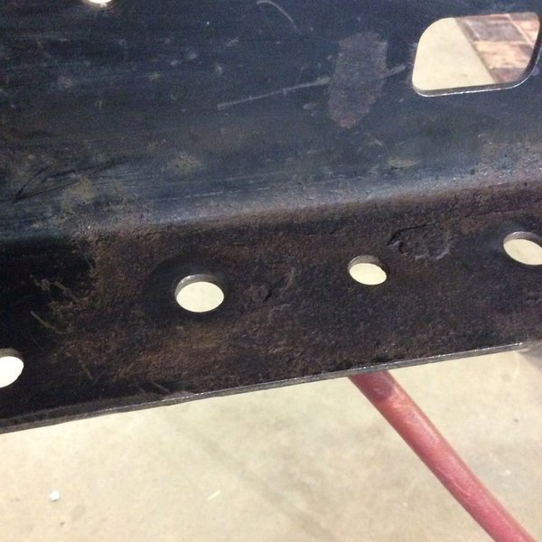

    Preped the inside of the frame rails today. Scraped of the loose paint and found some rust. This was the worst spot, and a majority of the rust. image.jpg
    I plan on painting it with this stuff.

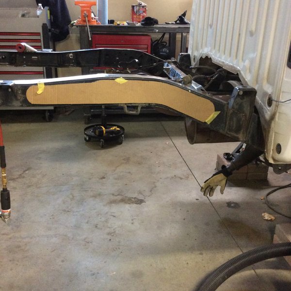

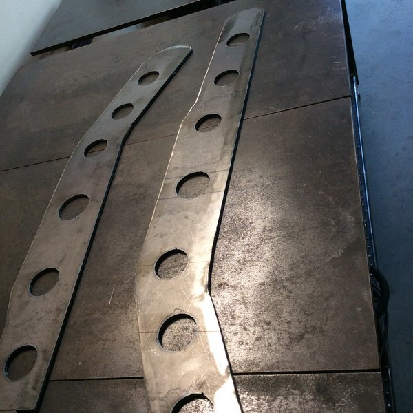

    Made up a template for some home made frame plates.
    I was gonna weld the cardboard on, but figured the tape would be just as strong.
    Break out my favorite toy (plasma cutter) tomorrow & cut off the factory strike plates, then cut the frame plates.
    I was gonna cut some 1.75" holes in the frame plates, mainly because I already have a hole saw that size. Any suggestions on that idea???image.jpg

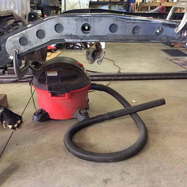

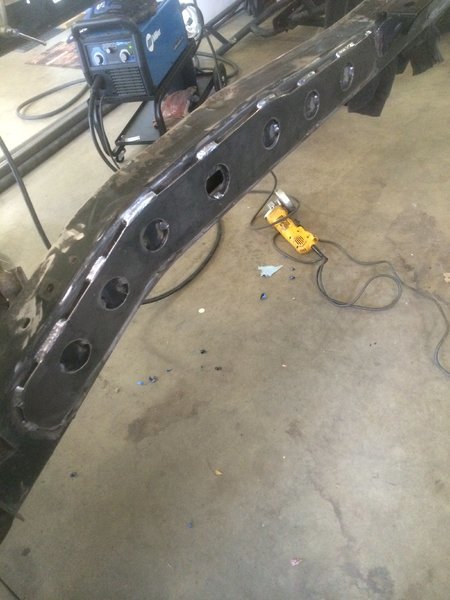

    Home made frame plates. Damn pros make it look so easy. Took me half a day.

    Got the plates welded on.
