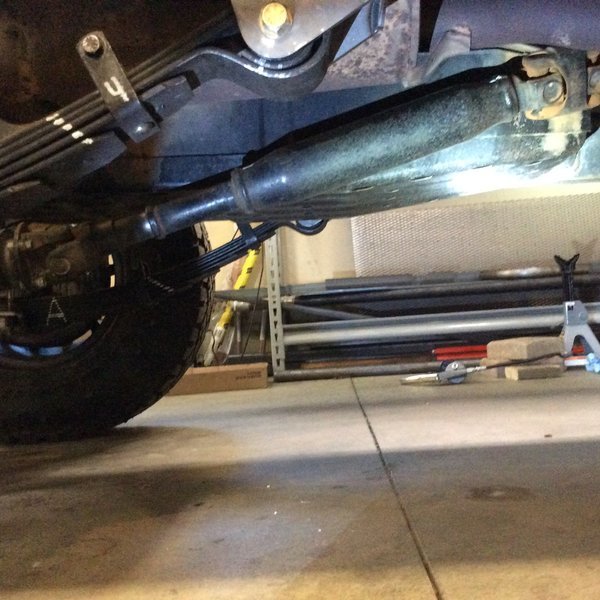

  4. Feb 21, 2017 at 8:29 PM
    #164
    -40
    -40 [OP] Well-Known Member
    Jul 26, 2015
    #160383
    1,057
    North Dakota
    01 DC Camburg LT & 17 OR OME BP-51
    1 st Gen TRD Supercharger. URD 7th Inj. Camburg 4x4 LT Kit. Tundra Brakes. 3rd Gen just get’n started, OME BP51 Dakar HD, Camburg UCA & various armor.

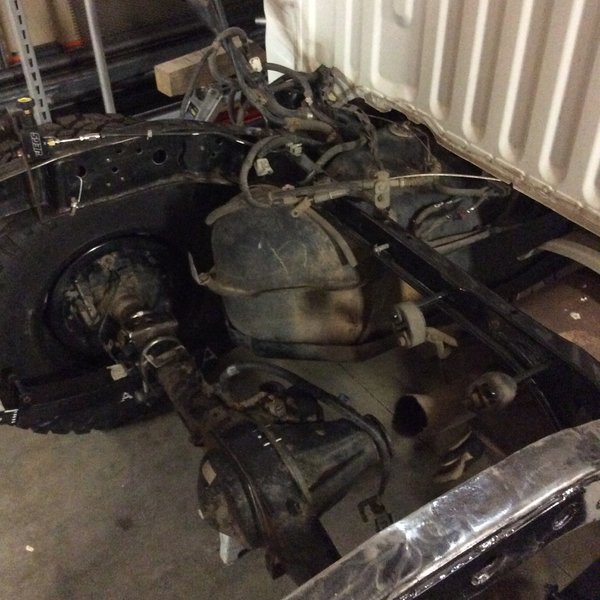

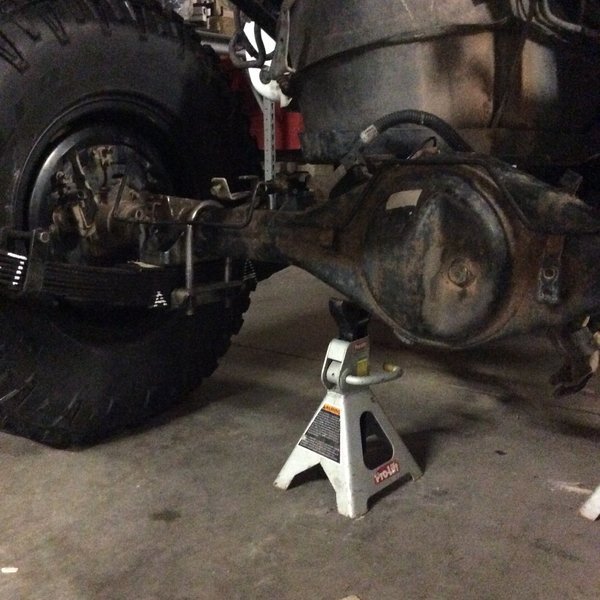

    :turtleride: Threw the gas tank back in. Put some weight on the back end ( no this is not where my bumper and tire will be), and......finally set pinion angle and tac'd perches on at ride height. Not bad for 3 months of work IMO :turtleride:image.jpgimage.jpgimage.jpg

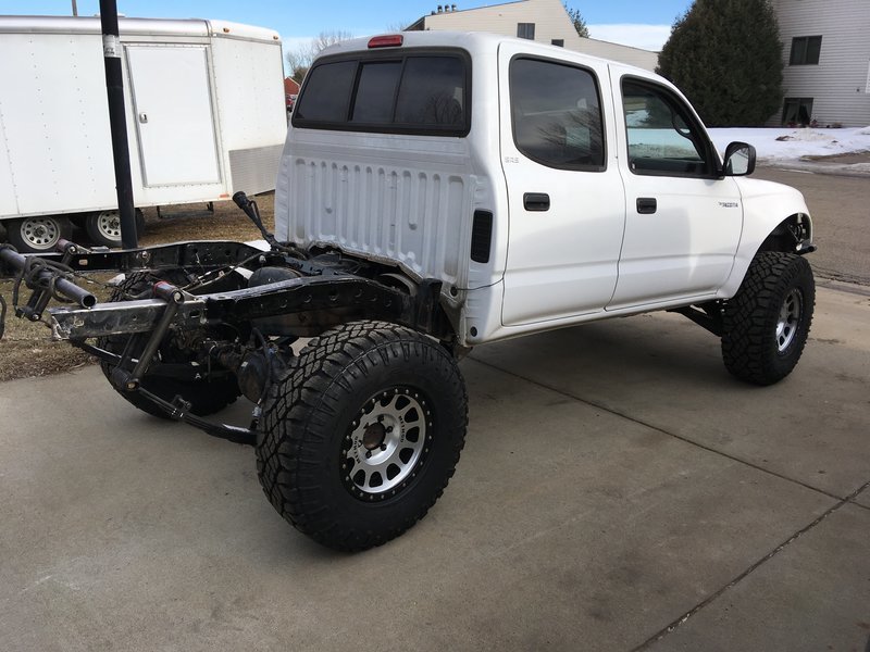

  6. Mar 7, 2017 at 8:38 AM
    #166
    -40
    Jul 26, 2015
    #160383
    1,057
    North Dakota
    Pretty sure my pinion is set wrong. Damn it, back in the dungeon it goes.

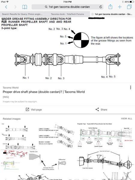

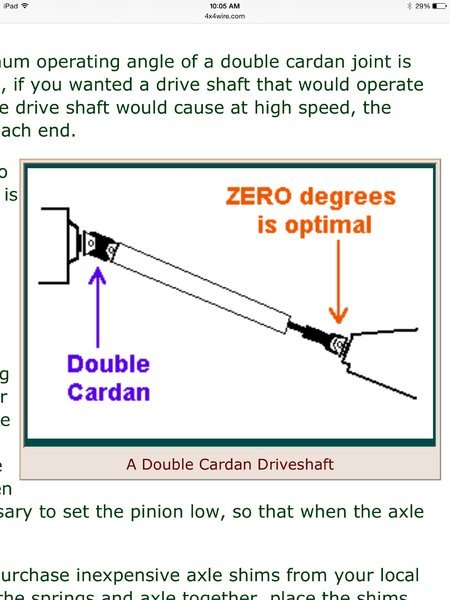

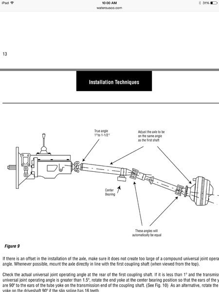

    Remind me about all the fun I had today, what not to do, what went right the 3rd time I did it.

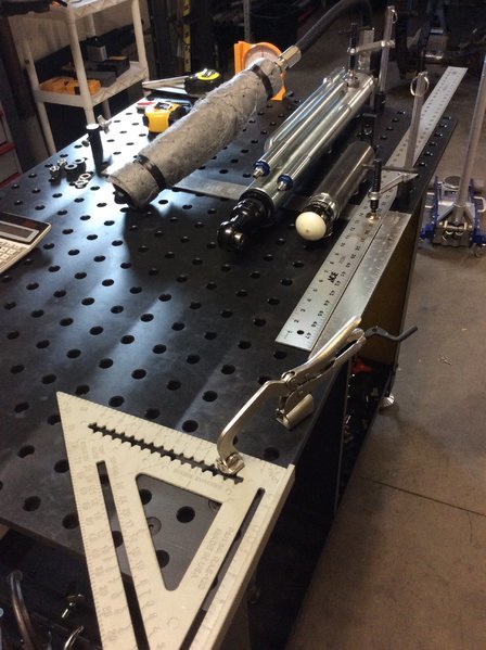

    A little lay out to see how things will sit.

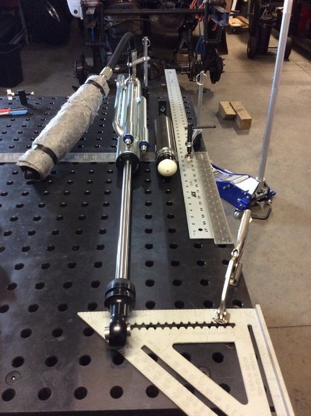

    Id like to mount my shocks at 90 degree for tuning purposes. If I'm correct I should be able to place the mounts at the 90 degree mark. I have approximately 3/8"of shock travel left on droop, and 3/8" of travel left at full bump. The difference between the arcs at the 90 degree mark is 1/2". The 90 degree mark is 1/4" from both arcs.

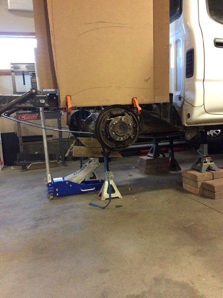

  13. Mar 23, 2017 at 6:32 PM
    #173
    -40
    Jul 26, 2015
    #160383
    1,057
    North Dakota

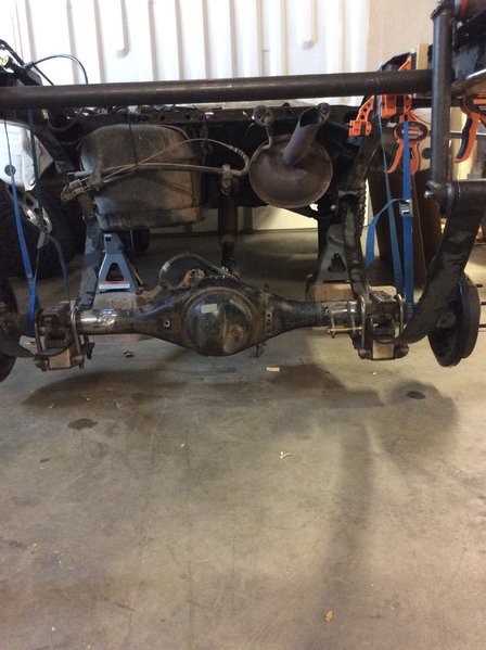

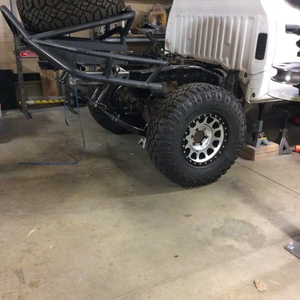

    Just about Bumped here. ( ignore marks on cardboard)
    Fiberglass is not set perfectly. Just threw it on to see how clearance was. I can bump up another inch or 2. Should clear no problem.

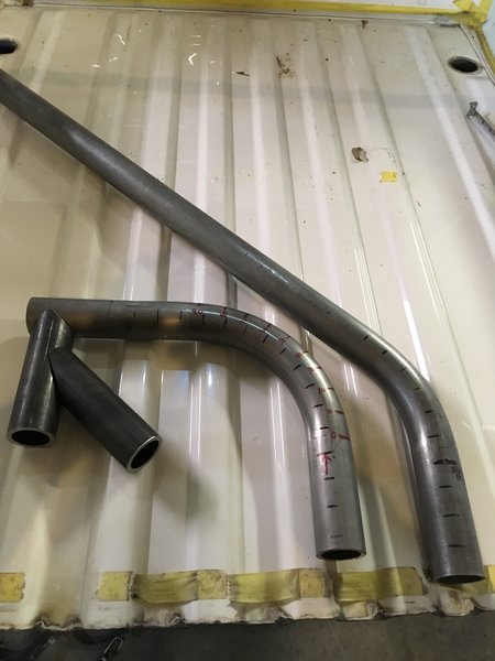

  14. Mar 23, 2017 at 6:35 PM
    #174
    -40
    Jul 26, 2015
    #160383
    1,057
    North Dakota
    Made some cheaters for the bender. Before calling it quits for a week or so.
  15. Mar 24, 2017 at 6:26 AM
    #175
    FlapJack935
    FlapJack935 i member
    Nov 25, 2013
    #117294
    3,196
    Jack
    Abq New Mexico
    Wannabe Trophy Truck
    Sick Gnar Trophy Truck Tacoma and King Ranch Raptor Killer

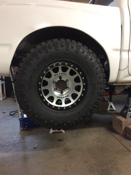

    tundra axle or no? im worried with my links im gonna get screwed on up travel because im out past my fiberglass at full bump. and i dont really wanna deal with glassworks to get 7" glass
  16. Mar 24, 2017 at 9:20 AM
    #176
    -40
    Jul 26, 2015
    #160383
    1,057
    North Dakota
    Stock axle for now. I'll use it until it breaks. Im looking for a tundra axle tho. Just not much in my area.
