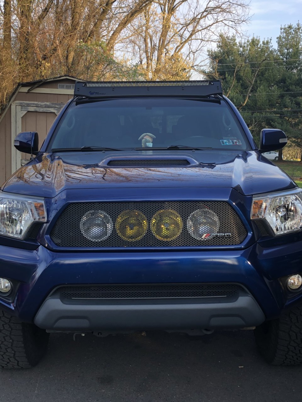

    I'm more looking for photos... I'm trying to figure out what looks the best.
