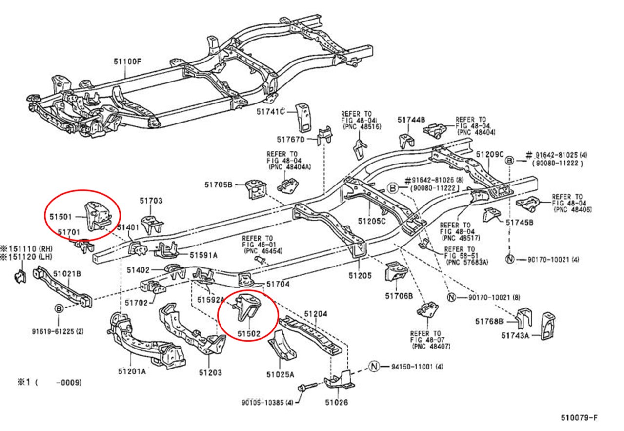

    If anyone has a parted out vehicle with a rust free front end, I am in need of both forward upper suspension mount brackets welded to the frame. Mine are rusted and the through-bolt holes will probably break when I change my UCAs. Part numbers: 51501-35080 and 51502-35080. See red circles in diagram. I'll attach an image of mine when I get a chance.

    Your talking about the mount where the Top of the Coil Over rides??
    3 holes the complete Assembly bolts to and the Cage nut holds everything together?

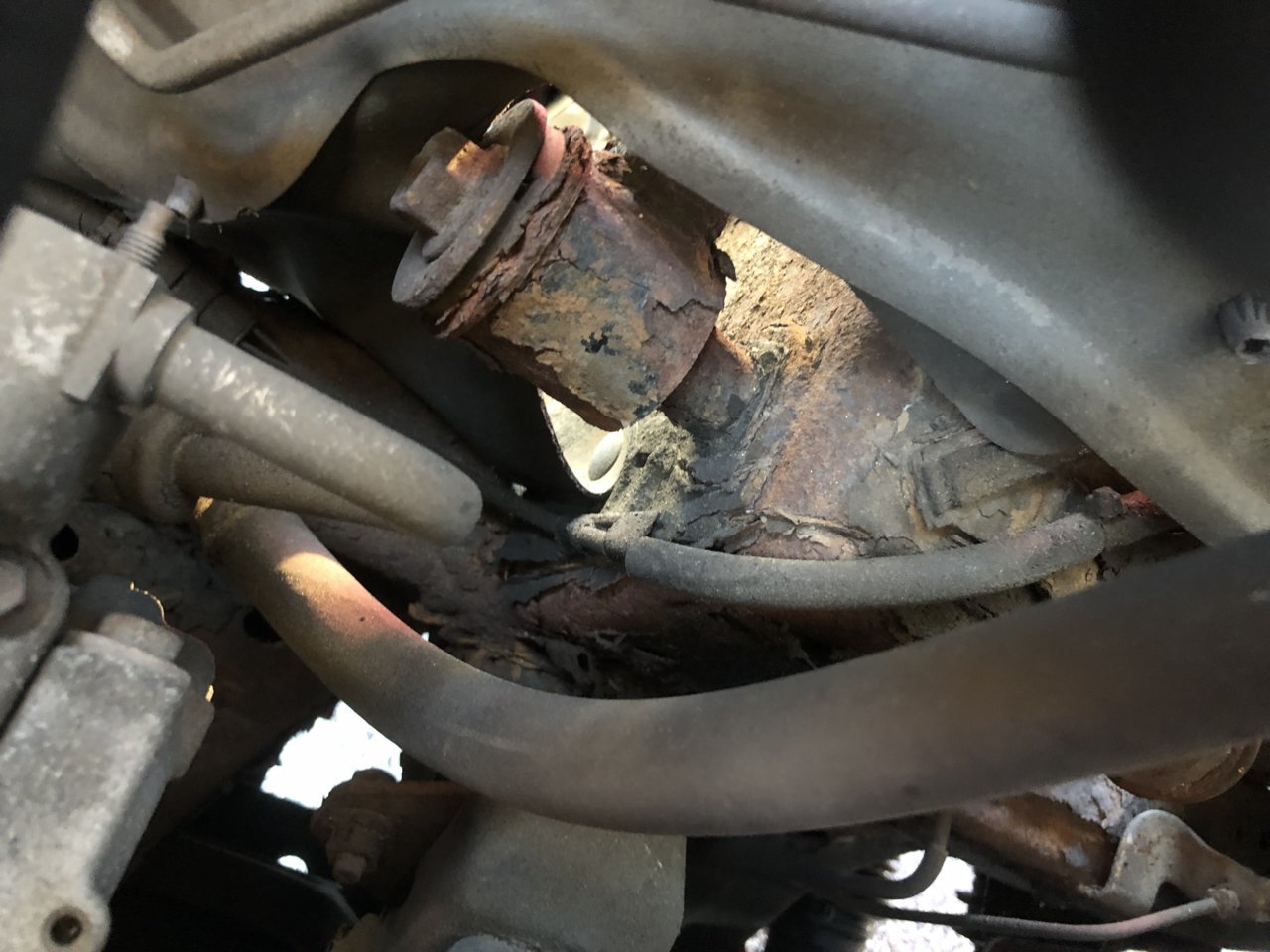

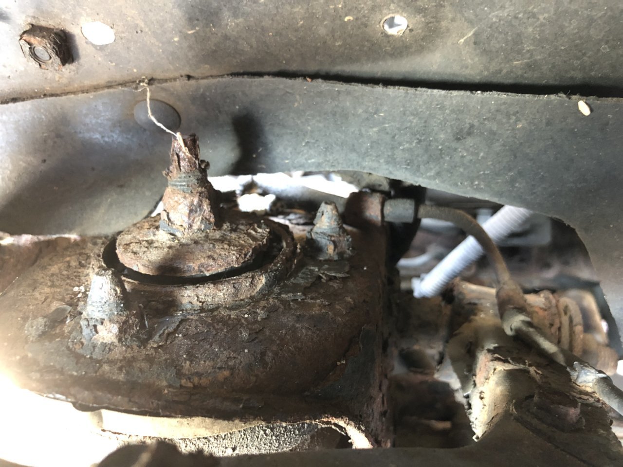

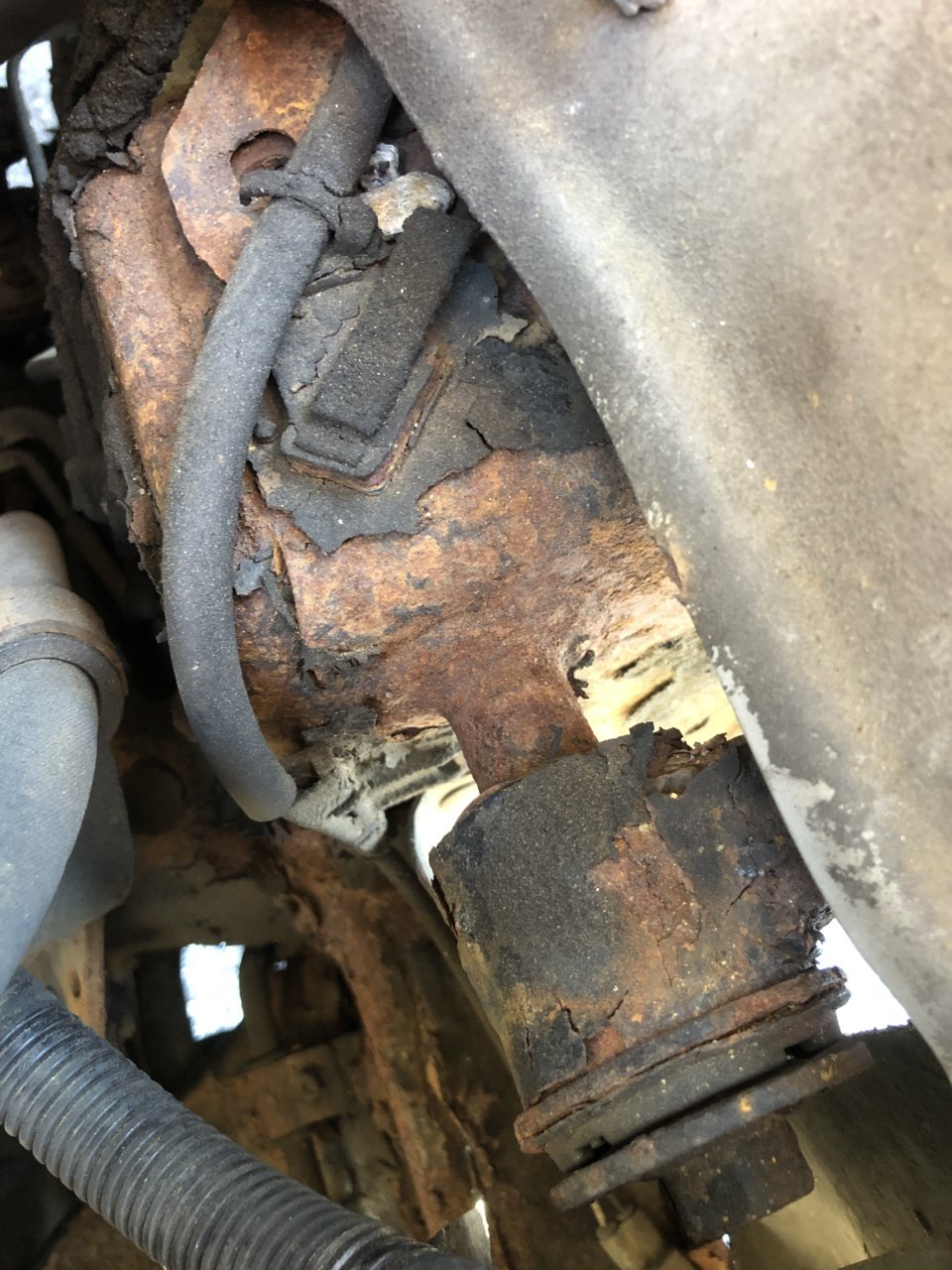

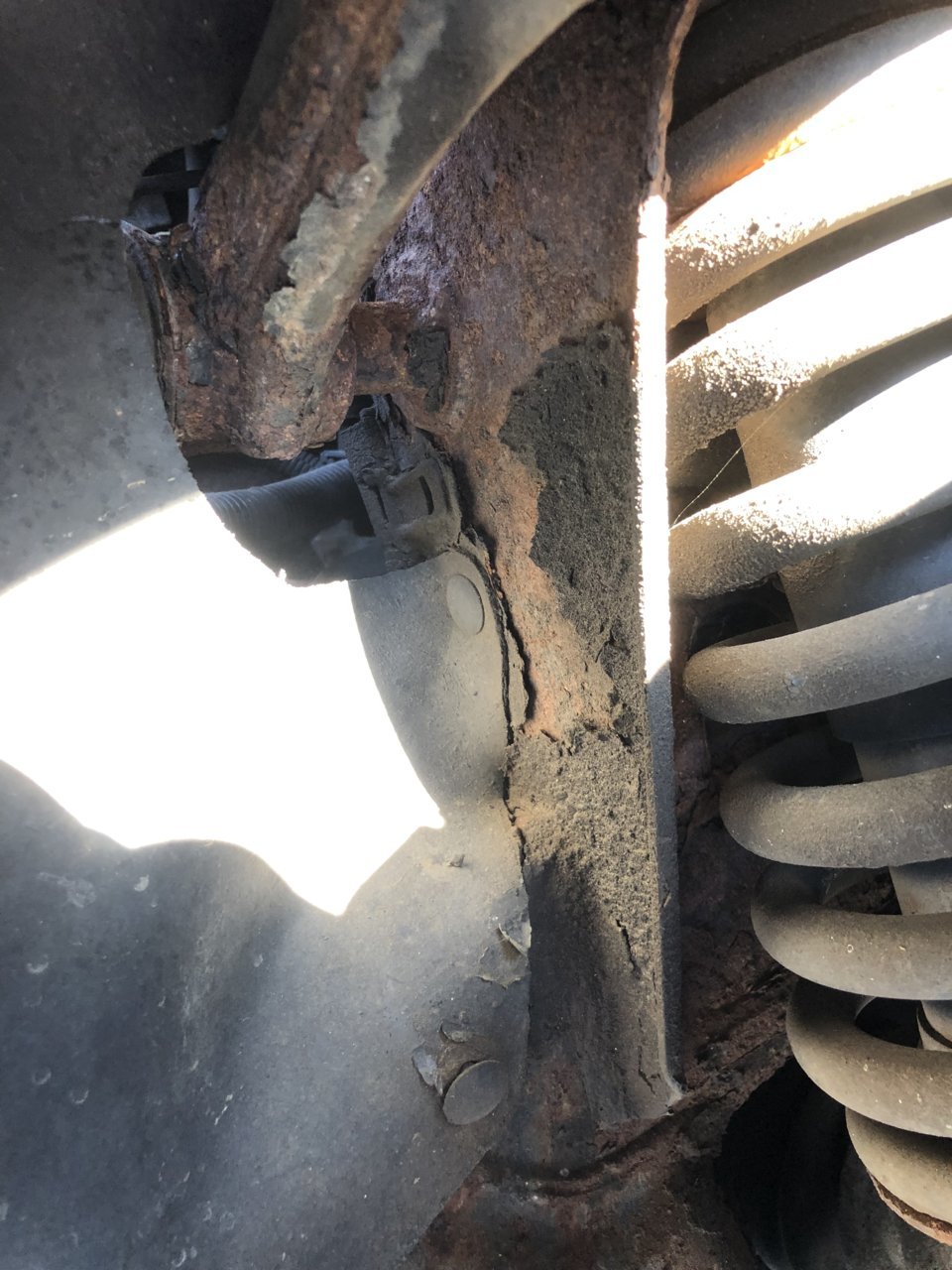

    Yeah the whole bracket housing welded to the frame where top of coil over bolts to. See images. I thought about having one fabbed if needed. I’m sure my welder brother could do it if needed. Can you show me an example of one you did?

    First I would clean off all that loose rust off and see what you really have.
    See if there is anything to work with.
    What is the rest of the frame like ?? This could be a major adventure.
    In any case it all needs to come apart if it breaks and you need new pieces to do the job correct The engine needs to be removed .
    At that time a front frame splice might be the easier route .
    Get your friend to give you ideas as they are up close and in person.

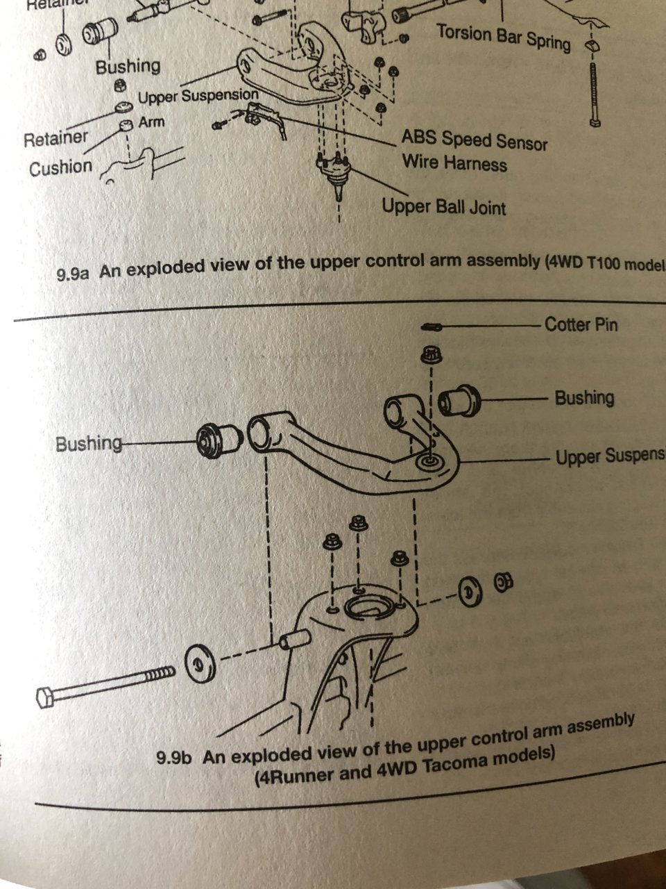

    I should do that. I thought those UCA mounting bolts was a long through-bolt. Is it not? It looked fused to the bracket with rust so I was guessing it would break the side of the bracket or snap off upon removal. Maybe if it does and the rest of the bracket is solid enough, I could have a patch plate welded on the side and re-bore a hole. If it's a welded on mounting stud and not a through bolt, that would make it a bit more challenging.

    You should just try to clean the rust off of that stuff to see were your at, surface rust mixed with loose and pealing paint often looks worse than it really is. The nut on the uca bolt is most likely seized, but the bolt itself is well sealed and may not be seize in the tube in the frame. Just pull the wheel off and start wire wheeling things, you may find you have more meat there then it seems at first glance.

    Oh I see what you mean now, I was looking at the wrong diagram. Now I see what I feared probably won’t be so bad. I was looking at that rusted tube thinking it was a solid bolt seized with rust. Thanks for setting me straight.
