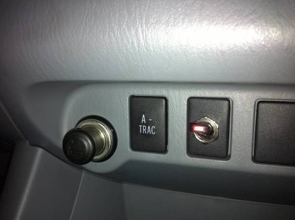

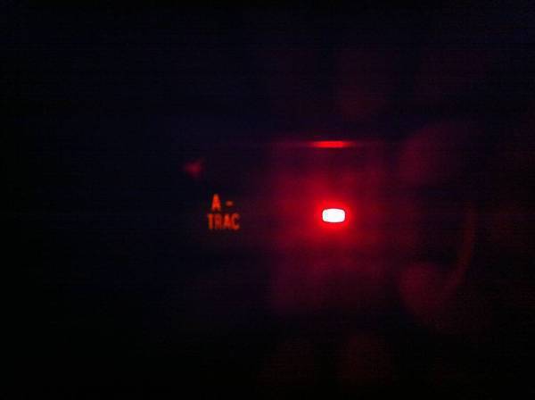

    I have been looking for a good switch to wire my offroad lights for awhile. All my blanks to the left of the steering wheel were full from OEM switches so I wanted to fill the blanks under the A/C panel. (09+ only). Most the OEM style switches are made to fit the left side, or too expensive. Most the stuff online was ricey. I needed something now so I ran to radio shack and found this:
    http://www.radioshack.com/product/index.jsp?productId=3111493#
    There are 2 great things about this switch. First, it only illuminates when your switch is "ON". Second, it sits snug into the pre-existing slot.
    I just popped out the blank and trimmed it so the face would sit flush and drilled the hole for the switch. Not a bad deal for <$5.
    Trimmed blank
    Installed
    Switch on in the dark

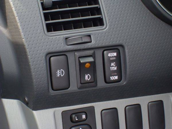

    So has anyone put this switch HL96517 in above the center console like the above red one?
    I have only one blank slot and want to install it next to my A-TRAC switch.

    Do you put this switch into the blanks under the A/C panel??
