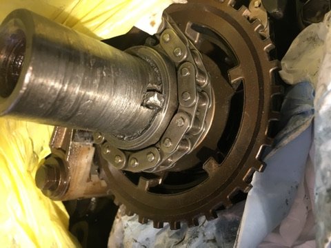

    3rz to 2Rz bebuilt block and new heads
    Had same.....someone stabbed my HB on off from the key...
    damaging the KEY....
    Subsequent repairs just wallowed out the key seat.....ruining the crank....Most likey over zealous air impact......
    First sign of trouble.....whole dash lights up....all the warning lights on......HB spinning free.
    From now on I will always take off the sharp edge on the key seat on leading edge of a new Harmonic balancer....just to give trouble wide berth......
    Oil pump gasket goes avg 80K or so.....HB removal is required path to this.....unfortunately...
