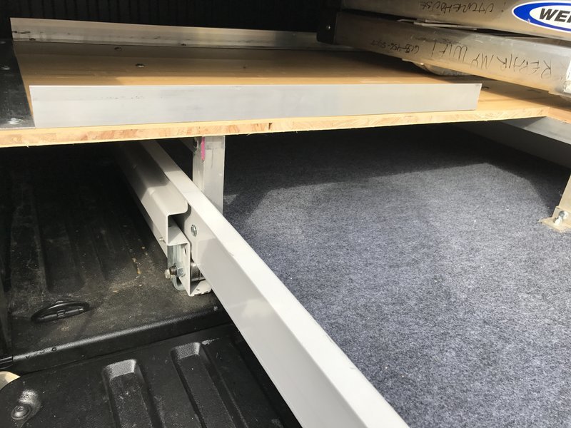

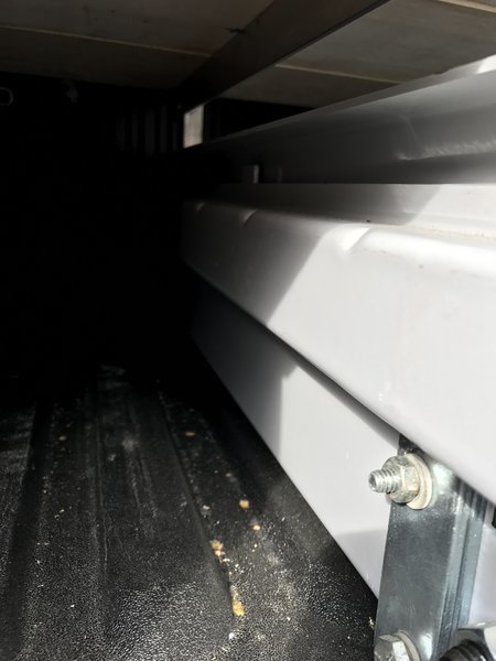

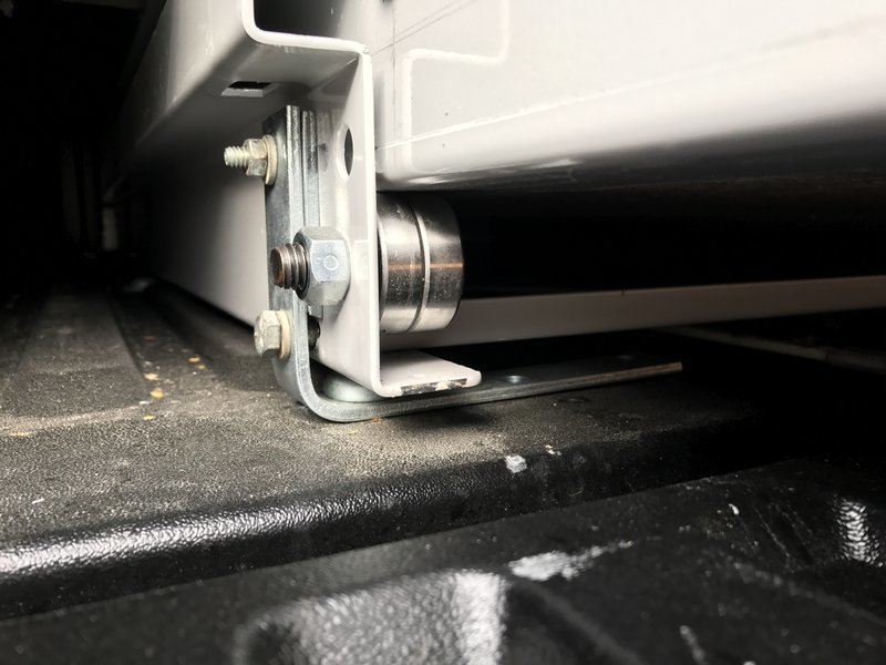

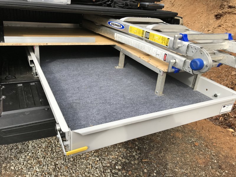

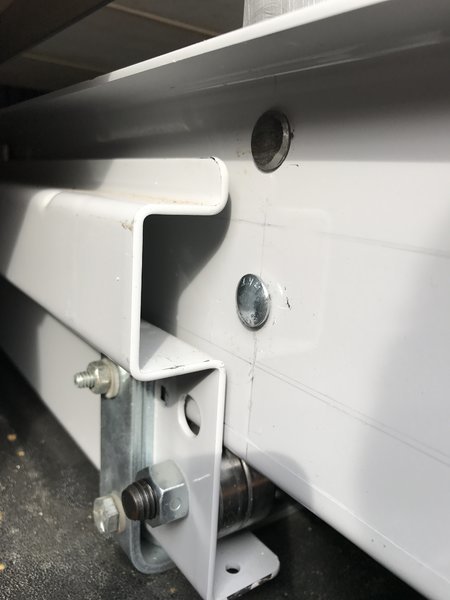

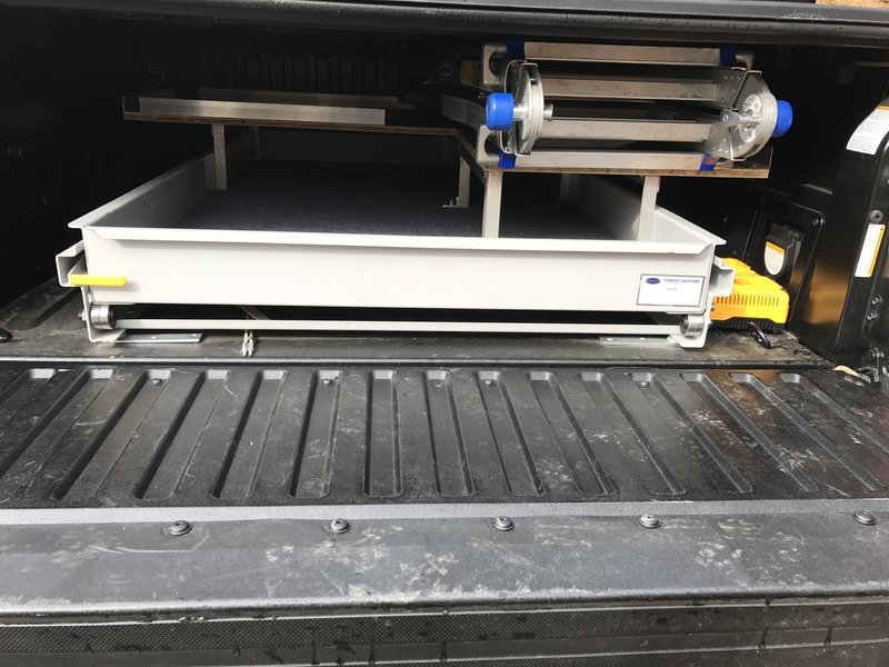

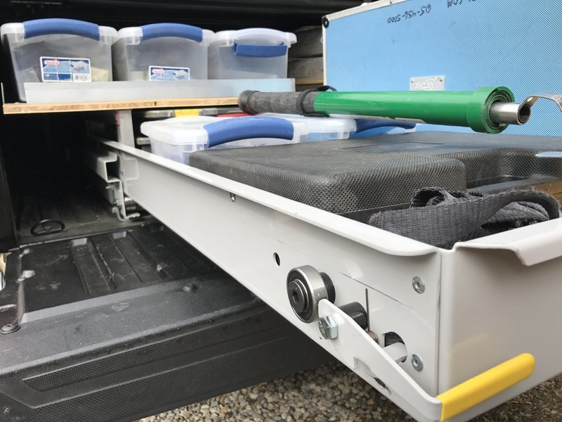

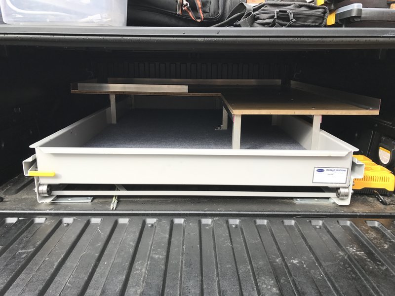

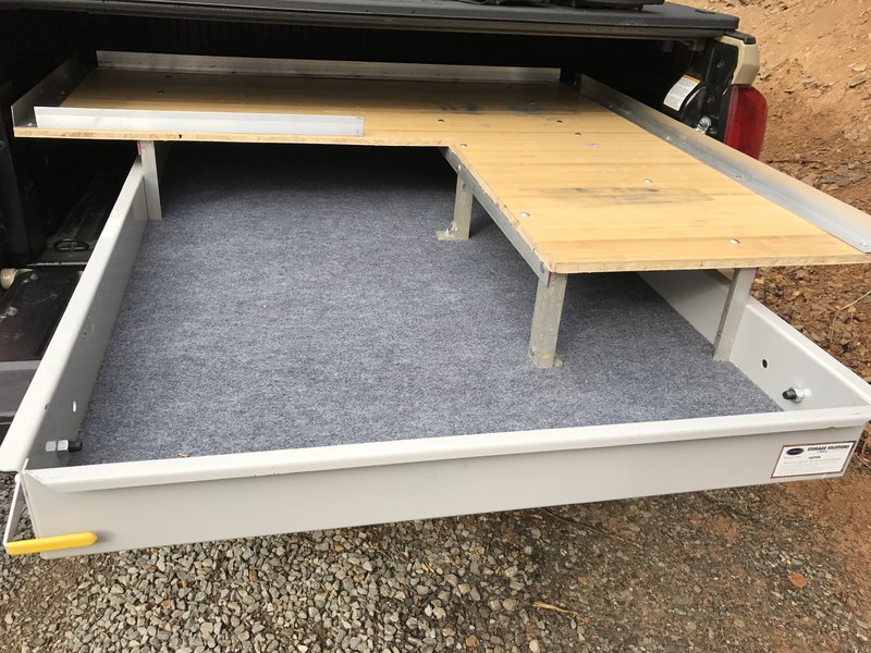

    Here are the Pics I promised...
    I used heavy 90 degree framing bracket I found at lowes and drilled holes to mount with.

    Here the pics I promised-
    mquibble, RANGER13, remgu2000 and 3 others like this.

    More pics with close up of mounting bracket
    jberry813 likes this.

    Here are pics with my tools parts equip, etc
    rlx02, Longtech, remgu2000 and 9 others like this.

    I purchased heavy 90 degree framing brackets from lowes and drilled them for my application- then I used carriage bolts with the heads ground down to fasten the assembly together
