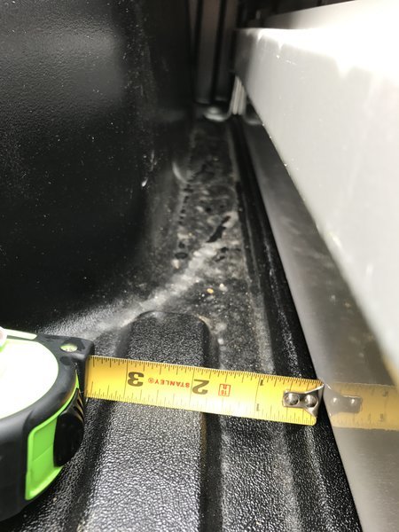

    Here is pic of the side area still usable.... The drawer slide width measurement is from protruding rail that is above the narrowest part of the floor. The rear bracket might be a little difficult- but think still doable.

    The above pic is why I am so convinced the 42" wide model will fit- there is far more than 1.5" on either side available
