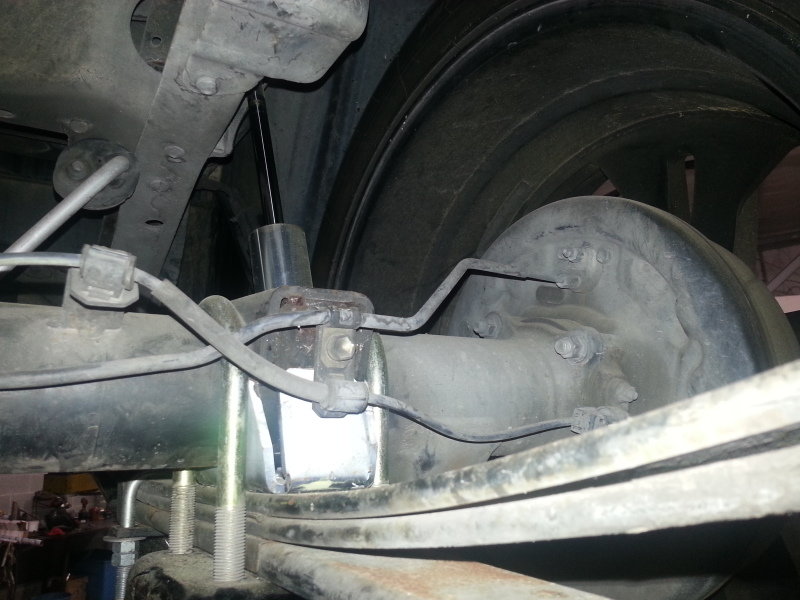

    Two tips on the Caltrac leaf spring perches. The hole for the leaf spring bolt, needs to be drilled out just a bit. Get the outer edges welded together prior to installing. Otherwise the sides will flex and will allow the axle to rotate while driving.
    Once the sides are welded together, then you can possibly just install it and not have to have it welded to the axle. I had installed mine without having the sides welded, and the flexed. Caused my axle to shift. Thus the warning.

    Hey Tor can you show me a picture of what you're referring to? I'm a visual type of guy:D

    Here you go.
    I know that other companies make SOA perches specifically for the Tacoma. I just don't know their name brands, off of the top of my head. Those might come fully boxed already.

    Ahhh now I understand. Thanks Tor :thumbsup:
