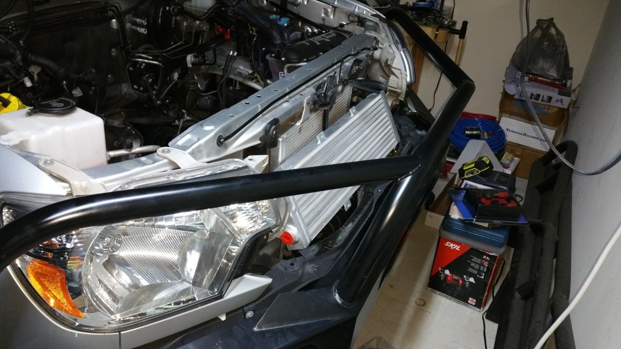

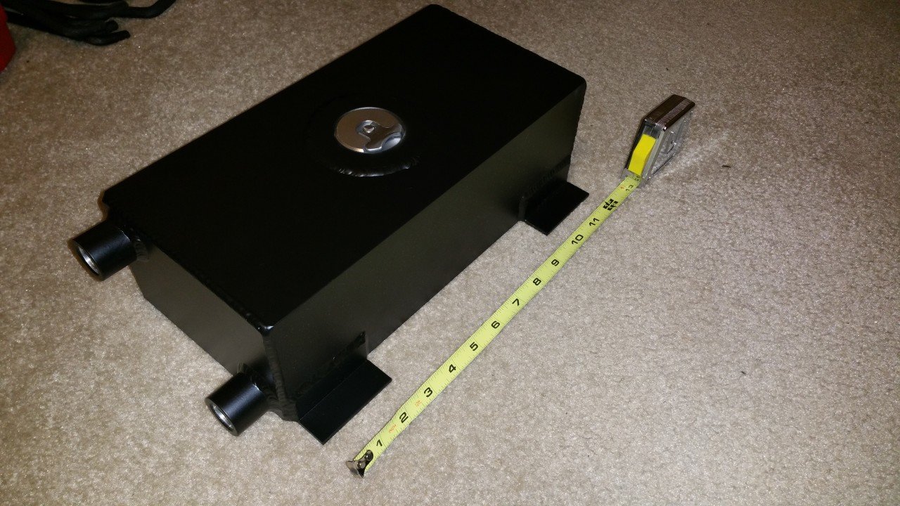

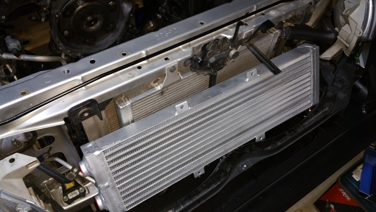

    Nice! Where did you get the heat exchanger and aluminum reservoir from? :)

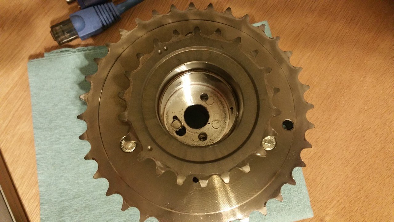

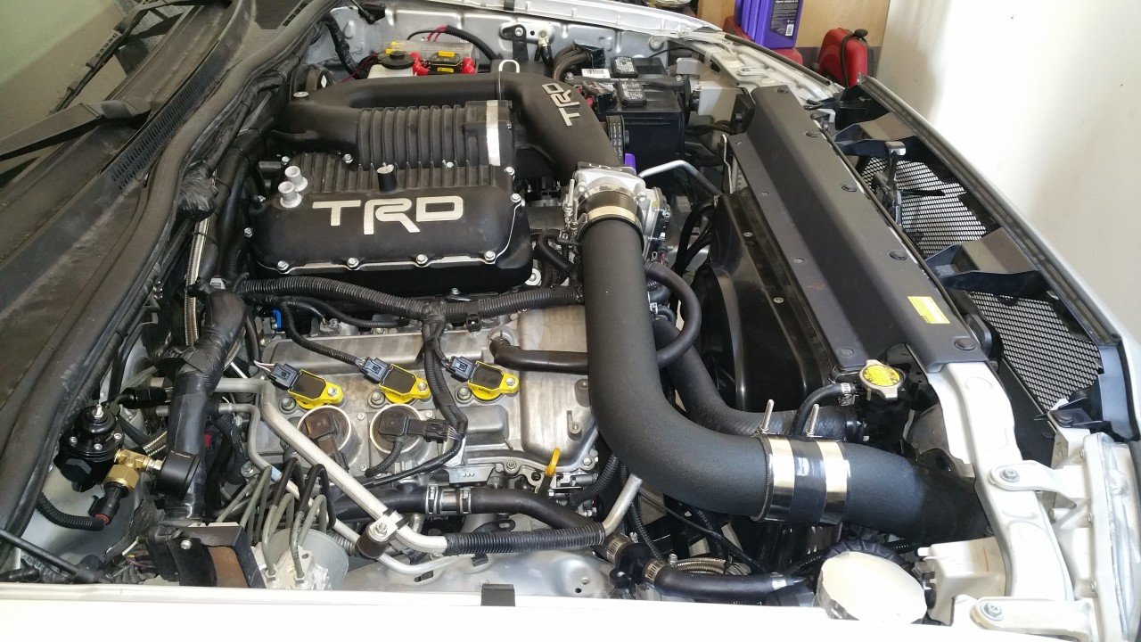

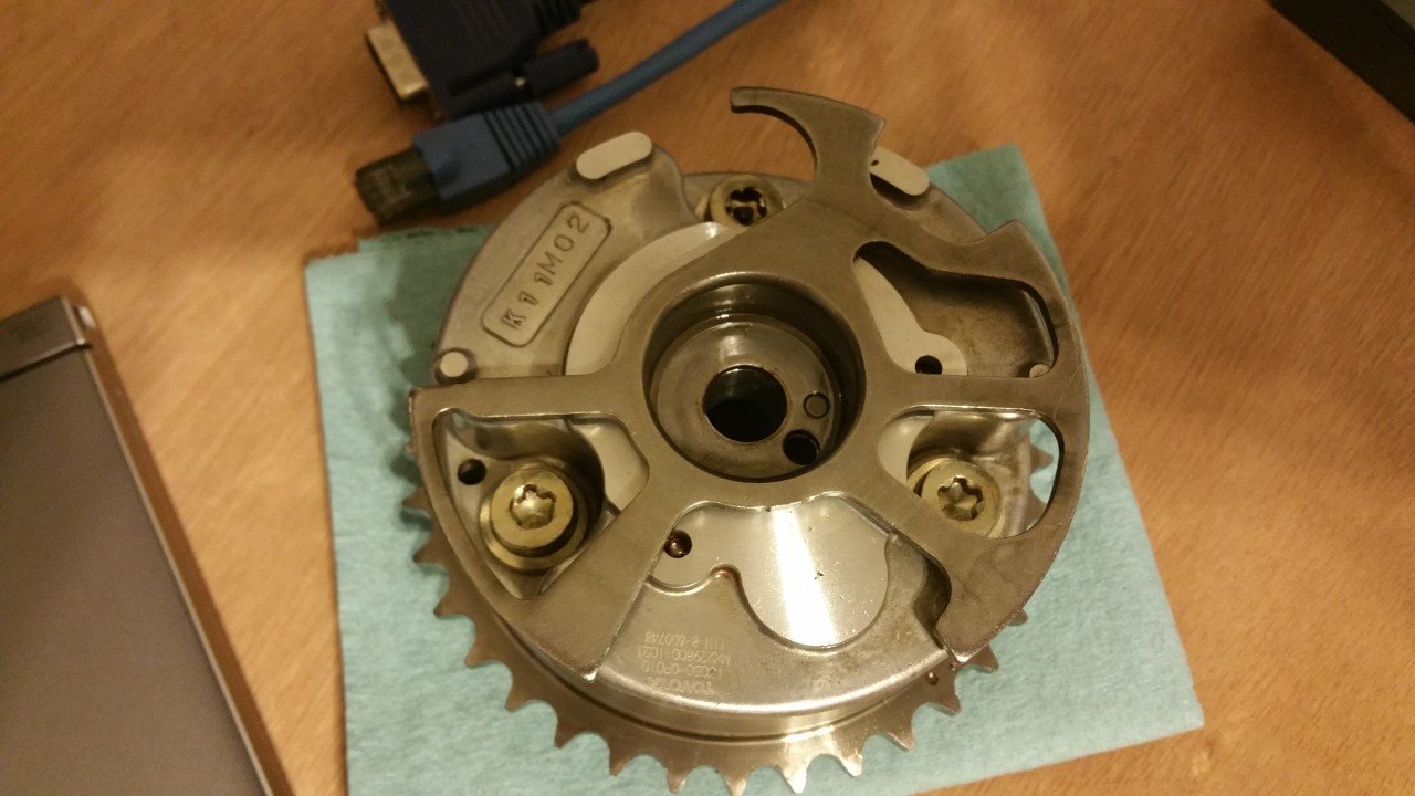

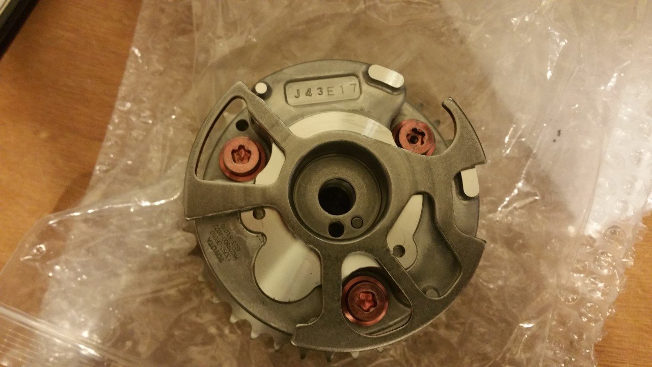

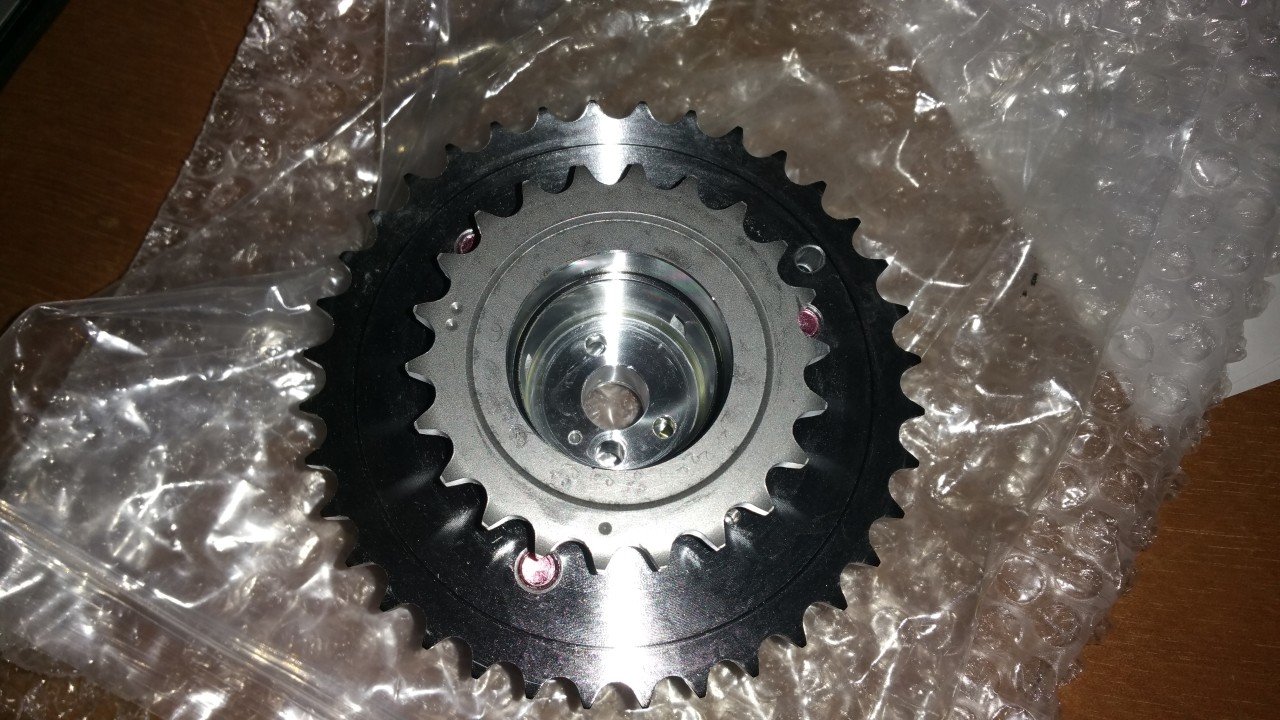

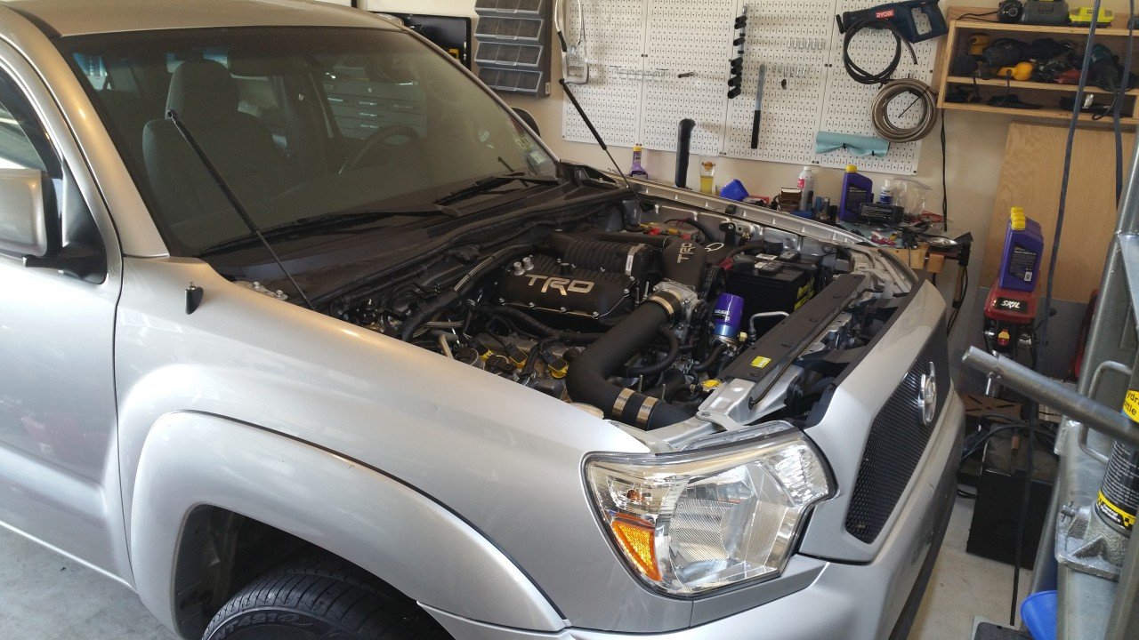

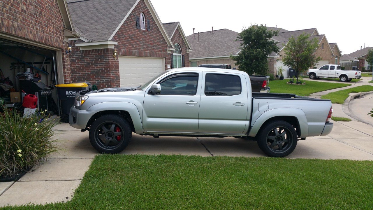

    In addition to the head studs possibly being lose, the intake cam gear wasn't aligned properly. I had to order a new one and rebuilt the engine again. Primed oil today and tested compression cold, then fired it up! It's running great, very smooth and no leaks or weird noises. Good compression and oil / fuel pressure, need an alignment and inspection / registration. Note to self: less beers when building engine...pay attention! I'm lucky I didn't bend any valves or mess anything else up, I drove it for like 10-12 miles in that condition misfiring on all cylinders on bank 2 and a misaligned cam gear, tsk tsk!
    NEW Intake Cam gear
    OLD Intake Cam gear (Driver's side, bank 2)
    Rebuilt, oil primed, compression tested, ready to fire
    Running, full frontal:
    Look Ma, No Leaks!
    From the side:

    Man, I was wondering when there would be a good news update. I am really excited for you, that you were able to not only find the problem, but not have any valve/piston damage as well. It could have been much worse. All turned out well, and thank you for sharing what the problem was. :thumbsup:
    How does it feel to be driving it around now?!
