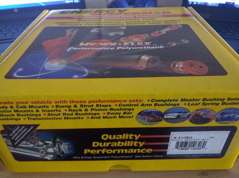

    Gonna install the ES body mount kit and shock tower buffer to see if it will kill my clunking and rattling.

    How tough is it to install new body mount bushings? Is there a DIY? I've never even considered it (or checked to see what shape mine are in). At what kind of mileage should you start thinking about replacing them?

    I just started last night and only got the front two done. I got stumped on the four under the cab. It is easy enough to get the main bolts out but I think I have to lift the cab a bit higher to change the drop-in bushings which sit on a plate bolted from the top. I was afraid to lift any more without thinking about what all was connected.
    I think 200K is a good time to think about body mounts. Mine area all cracked and dry rotted. I'm taking pictures to I might do a writeup when I finish.

    Just got my Body mount bushings!
