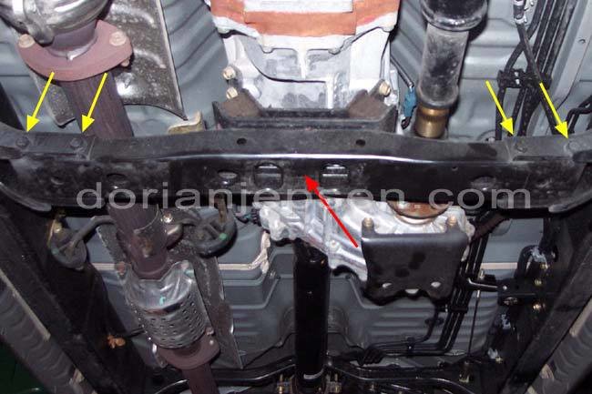

    Well, a bit of a long shot, transmission crossmember?

    Yeah as I said above in the other post, I tightened the cab mounts and the transmission crossmember and I don't know which one was too loose but after tightening all of them, clunk is gone. That was months ago now. Simple and easy fix.

    Haven't had time to remove the sway bar completely, but I did get under the back today and torqued down the 2 19mm bolts that hold the front of the leaf springs on. I was getting a clunk when I'd pull into my driveway and catch the sloped part of the curb. Like pushing the rear axle to the side abruptly. It happened every time, and the only bolts on the rear that I haven't put an actual torque wrench on is those front leaf spring bolts because of their position. I need a torque wrench adapter.
    I grabbed a 19mm box wrench and just cranked down on them. Seems to have solve that problem, but I still want to get 89 ft-lbs for peace of mind.

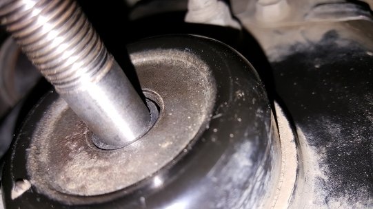

    @jtweezy Question, did you assemble the Old Man Emu's..? I ask as from what I know the 2886 coil is very stout, you need a heavy spring compressor to compress them. You're noise may be that the shock & spring aren't seated and the top hat bushings are slightly moving. I had a similar noise and had my old 2886 removed and re-assembled this helped solve my problem. Also as metioned above by @xJuice make sure you get the bushings right. Hope you find the problem.

    @xJuice & @mouse007 -- I did assemble the shocks myself with the 886s. I used a coil spring compressor and an impact wrench to turn the compressor bolts. I don't remember which bushing/washer was new or old, but basically I used every new part that came with the new shocks, and reused whatever wasn't provided new. The only one I remember 100% is the nylock nuts that hold everything together.
    To answer your question, I slid everything onto the shaft, but aside from trying to get the spring seated in the existing indention under the top hat and in the spring seat, I didn't pay super close attention to everything else.
    I will be swapping the springs to 887 springs soon, so I'll be taking the struts apart and reassembling. I will pay much closer attention this time around.
    Question about reassembling the strut...
    When you torque the top nylock nut, do you leave the spring compressed so much that it's not pushing up on the top hat? In my head this seems required to get proper torque, otherwise you could be torquing against the resistance of the spring pushing up on the top hat.
