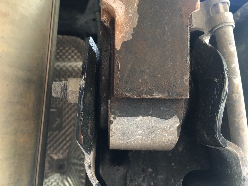

    ICON Vehicle Dynamics Uni-Ball UCA, ICON Vehicle Dynamics Extended travel remote reservoir coilovers, with 700# Coils and CDC (Compression Damping Control) Clicker Valves. Dakar Leafs Old Man Emu Nitro Sport Shocks Toyotech U-Bolt flip kit, Goodyear F. & R. extended Stainless Steel Brake lines. aFe Pro Dry drop in air filter. ARB Bull Bar. Weld on AVID Off-Road Rock Sliders W/ Kick Out. Tires: 285/75 R16 BFGoodrich KO/TA's. Light Force Blitz 240's 12v. Warn M-8000 W/ Viking Off-Road Synthetic winch line.
    Well, I am almost 99.9% sure this has solved my Clunking/Popping noise....!!!
    As mentioned by @jtweezy in my case, the noise was coming from the rear spring pack. I have Dakar Heavy Leaf's and as you can see in the pictures below the O.E. front spring eye busing was moving laterally on certain weight transfer situations. I would hear/feel this on the Passenger side only.
    So, I mounted up the Wheelers Off-Road bushings. These new leaf pack bushings fit a lot tighter and there is no space between the O.E. mount and spring eye, this should do the trick..!!!
    I will continue to monitor this and see if the nosie is 100% gone
    Crom, Acerwin and jtweezy[OP] like this.

    BOOM! Done!

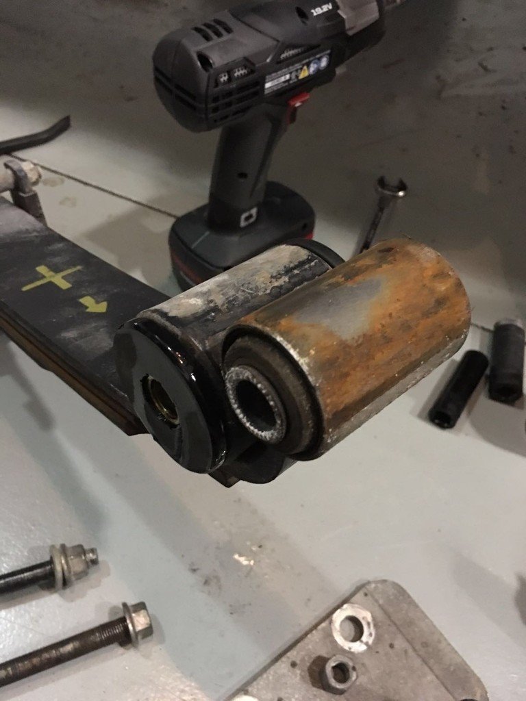

    I didn't get the Wheelers bushings, but here's a link to the ones I got from Amazon (they're Energy Suspension): https://amzn.com/B00LSTUAQ6
    Edit: Used those bushings and Super Lube Synthetic grease. It was the grease recommended by Total Chaos for their UCA install, so I had some laying around.

    I used Slee Off-Road's instructions for installing the OME kit and I think they mentioned it. But I also remember seeing it in an ARB document. Either way, to anyone installing Dakars, I say ditch the OEM bushings and put in poly from the get go.

    I pressed out the stock bushings too. They are crap. If you look at the ends of them, they are rough and end up wearing holes in the metal as the rotate. The poly bushings are much much better. The stock bushings are a super bitch to get out though. Have fun with that.

    How long did you have the stock bushings in for? Mine came out easy with a ball joint press and a socket wrench.

    Well if you have fancy tools like that I'm sure it's nothing. I had a C-clamp lol.
