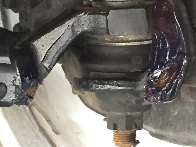

    I've been dealing with this since new, 12000kms
    On the steering bump stops, apply a bit of grease to each side. Smooth it out with your finger. Then try and recreate the pop. Go back and have at look at the grease and see if there is evidence of contact..
    I'm pretty sure that could be your culprit.

    The Kootenays
    '22 DCLB
    I'm pretty sure that's where my pop is coming from when turning into or out of a driveway.image.jpg

    That is the steering stop. So when turning out of a driveway they seem to be contact and poppin( the two greased areas)
    ChadsPride[QUOTED] likes this.

    Mine pops at a 1/4 to 1/2 turn. So I know my issue has nothing to do with the steering stop making contact. Has it seemed to help quiet yours down? Or did it make it go away ?
    I need a dang go pro to mount and then I can see what's moving and what's not!
