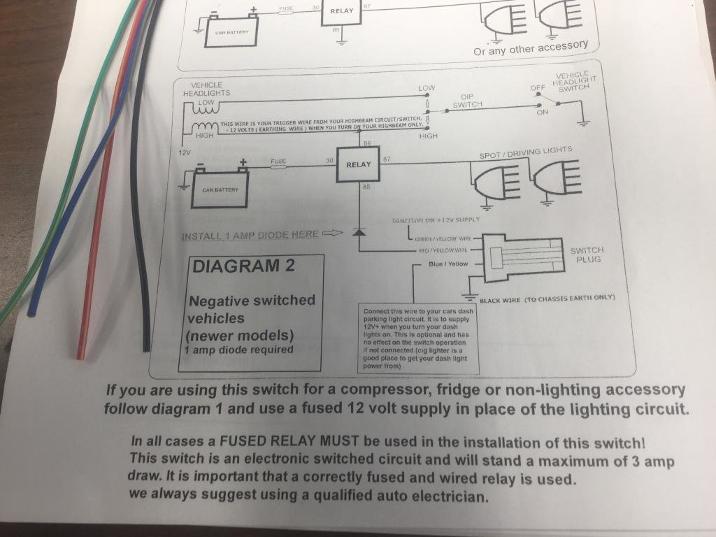

    My switch just came yesterday and this is the wiring diagram it came with. Do I use the negative switched method for a '13? Does this make my led bar come on with high beams only? And is this accurate for the wires from the switch? And last question, which wire is everyone tapping into for the dash illumination circuit? Thanks.

    I just installed one of these switches this weekend into my 09 DCSB OR and used the Negative Switched diagram. The button works as it should using the diagram supplied. The text on the button lights up when parking lights are on, and when I push the button the image lights up and turns on the bed lights.
    My button went in the blank in the lower dash by the atrac button, so I tapped the wires that light up the gear selector light (green/white and green wires). The only issue that I had was that the button dimmed opposite of the lights in the truck when tapping the green/white wire. I somewhat remedied this issue by tapping into the green wire instead. The button no longer dims like the the rest of the interior lights, but it does come on when the parking lights are on as I described above.
