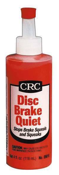

    what did you use on it? have a pic of the can?

    It comes in a little squeeze bottle and looks like this:
    I used a different brand but the bottle looked the same and the stuff was orange just like in this photo. Make sure you let the stuff dry for the recommended 10 minutes...don't rush it. You can find this stuff at almost any auto parts store. Sometimes there are similar products available in an aerosol can. Stick to this stuff so you can put it on fairly thick.

    Usually, brake pads have anti rattle springs, which usually don't look much like springs, but serve to keep the pads secure on small bumps. They can also be easy to lose when replacing brake pads, or they can also just wear out, fall off, rust out, wear through, etc.
    To get them you usually must buy some over-priced "small parts kit", but I prefer a couple coats of that Permatex brand spray can disk brake quiet on the back of the pads. Much easier & cheaper to deal with.

    The "springs" which you mention were there. And I even tried rigging up my own spring going across the backs of the pads...but it did not help.
    I agree that the spray can stuff is easier to use. Maybe it would work in this situation. Not sure. I see no need to try any other product now that I know this works, but someone else out there may wish to try it. As for being cheaper?? Both products are about the same price.

    Oh, I meant it was cheaper than replacing those little springs.
    IMO, they wear out fast and need to be replaced too frequently.
    Anyhow, I've used several types of that goop over the years, and I like the spray can stuff the best.
