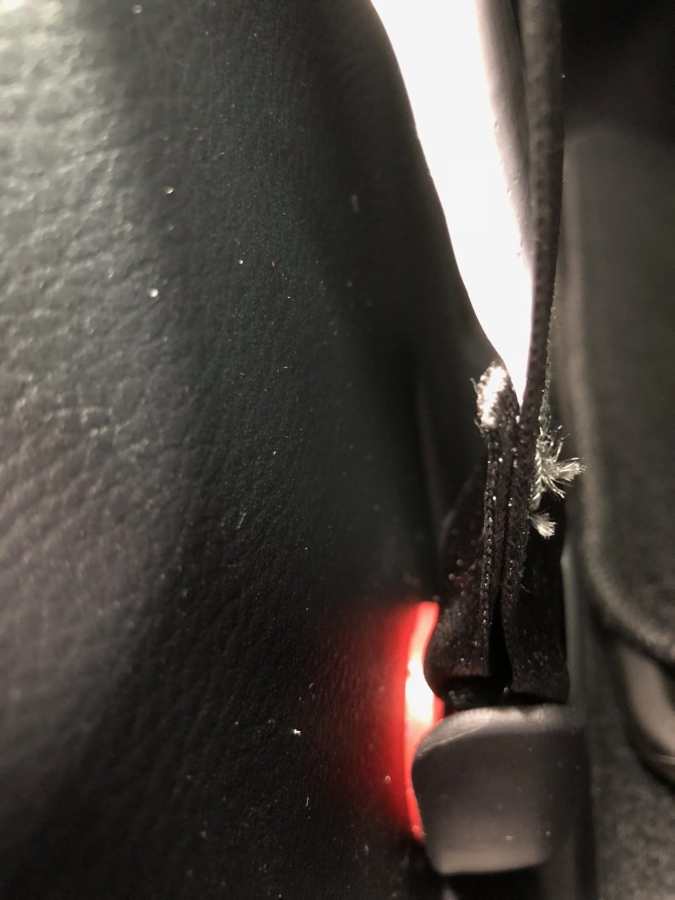

    Bottom of the seatbelt where it bolts into the B pillar. Bolt is tight but there's space where the plastic cover can move. I took a rubber gasket (red in the image below) from a garden hose and cut a slit and placed it over the bolt. Rattle gone.IMG_0049.jpg

    I narrowed it down to the passenger side dash or seat. Shake your passenger seatbelt near the bottom to confirm.

    Also when someone gets out and they take off the seatbelt, if it’s kind of twisted just a little the actual seal belt clip will rattle against the b pillar plastic. Does this in my truck all the time. I have to reach over when I’m driving and re-adjust it almost every time
