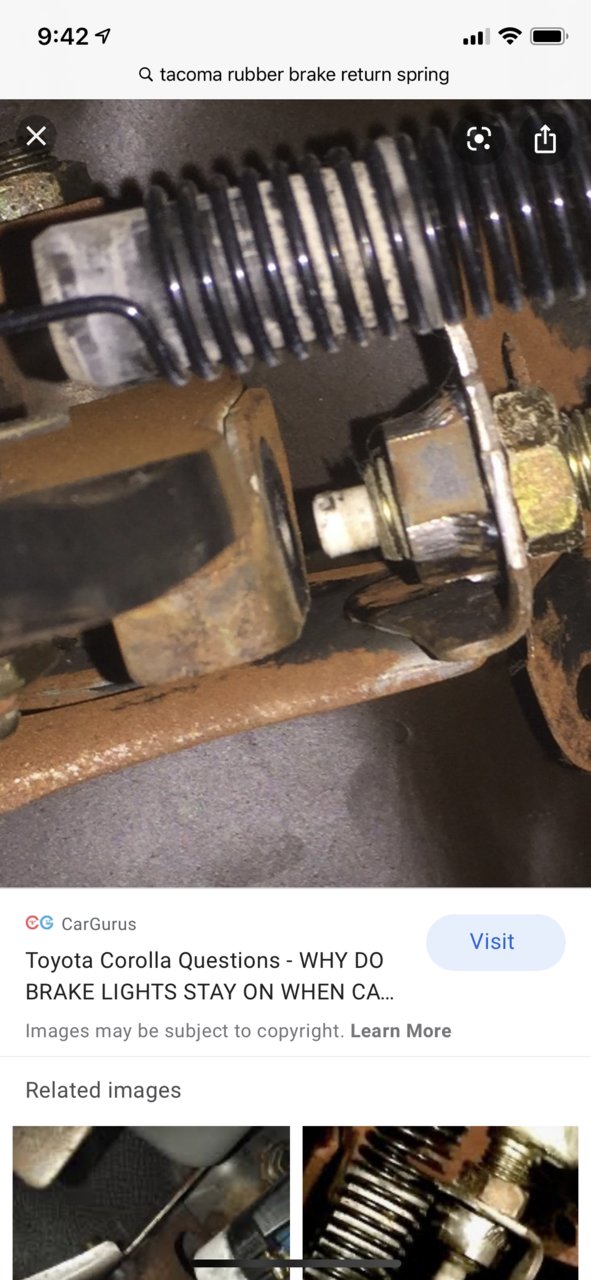

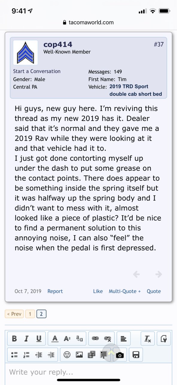

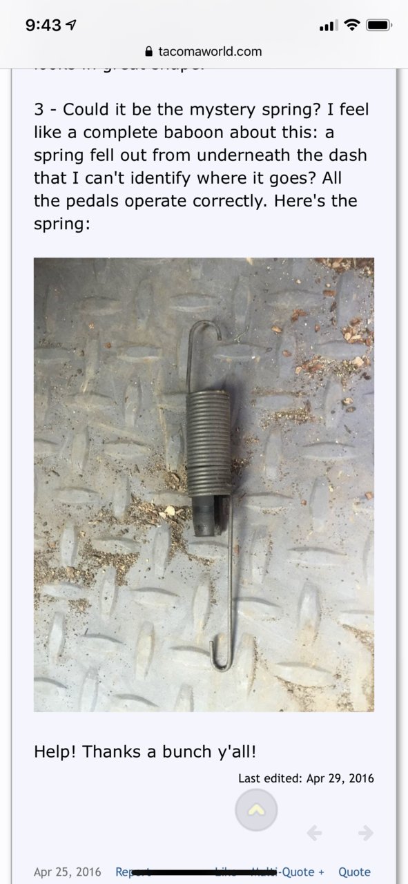

    Soooo - some pics from other threads etc after investigating....
    First pic is from a post where a person found a ‘mystery spring’ in their Taco (clearly the brake return spring) and it shows the rubber piece in the spring.
    Second spring is from a Corolla post about a brake return spring, shows the piece (so must be a Toyota thing).
    3rd pic is a pic of a post about the spring, and seeing ‘something in the spring’ - so guessing the are referring to the rubber piece.
    6D7124D5-FA88-460B-B040-A7E279576806.jpg 29D93418-471B-4982-89DC-D41B72E22633.jpg 866B13D4-BC2B-4D99-947F-4546661B2BF3.jpg
