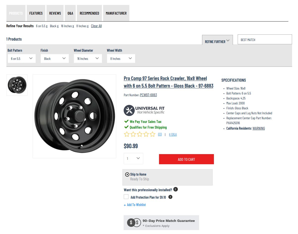

    I wanted Level 8 Mk 6 wheels (matte black, -10 offset) but they are out of stock and I'm not sure when they will be available.
    I found Pro Comp 97 series wheels that I like with a backspace of 4.25 (no offset listed).
    I want my wheels to poke out a little so I'm wondering if these would do (and also flat black not gloss).

    According to this is a -6mm offset

    Will most likely have clearance issues on brake calipers with those wheels.

    That's what I was getting with a converter I found online. Either -6 or -7.

    I went on Pro Comp's website and put in my vehicle, I keep getting results for 5 lug rims.

    Spoke to a guy at 4WP about those same rims and said the center caps will not fit also since they are push through and the tacos use hub-centric rims they recomended a series 7032 and said it had all the specs to make it fit. Think it was 0 offset
