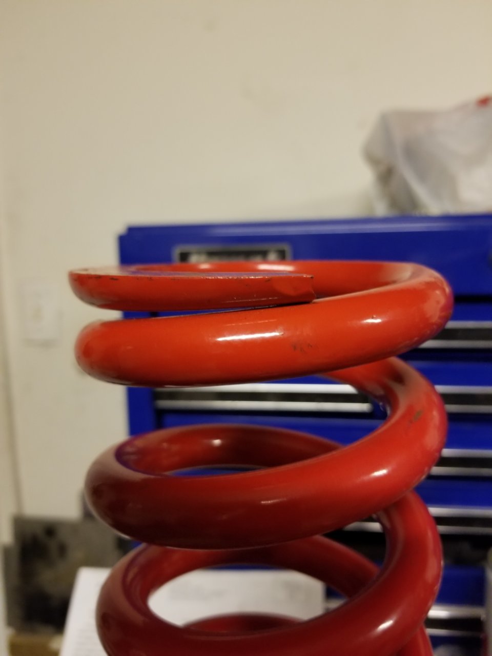

    Is the coil that comes with those 14" long too? Like with Kings?
    Reason I ask is that some (like Icon) come standard with 650lbs but 13" coils so going up to one inch longer but same load rating isn't a good idea

    You know i never thought about measuring mine. Just did. My factory ADS have 13" 600lbs coils. So going 14" 650lb coils wont work? Trying to go 2.5" of lift

    It's completely fine. A lot of people swap out the 13" for 14" coils so retain the same amount of lift with less preload, resulting in a smoother ride.

    If you're maxed out of preload with a 13" coil than you can achieve more lift with a 14"

    Well you can put it on as others have said but you'll have the same amount of preload and will not get a smoother ride compared to using the original ones cranked up to the height you want. It just doesn't work that way ;) you're gonna get coil bind.
    If your original coils won't support all the weight then a longer AND stiffer spring is the answer

    Yeah im affraid that the 600lb coils wont hold up the weight of my dcsb with plans to add some more weight

    Yes, I thought you said your ADS coils already have a 650lbs rating.

    My truck dropped 1/2" switching 650 to 600. I read on here or another forum were they put on a pro suspension from a 4runner on a Tacoma. Said it had 13" coil instead of a 14" so he didn't get any lift.
