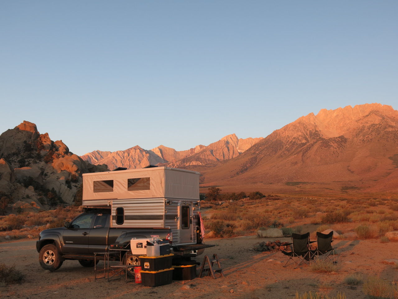

    Little flashback from quarantineland

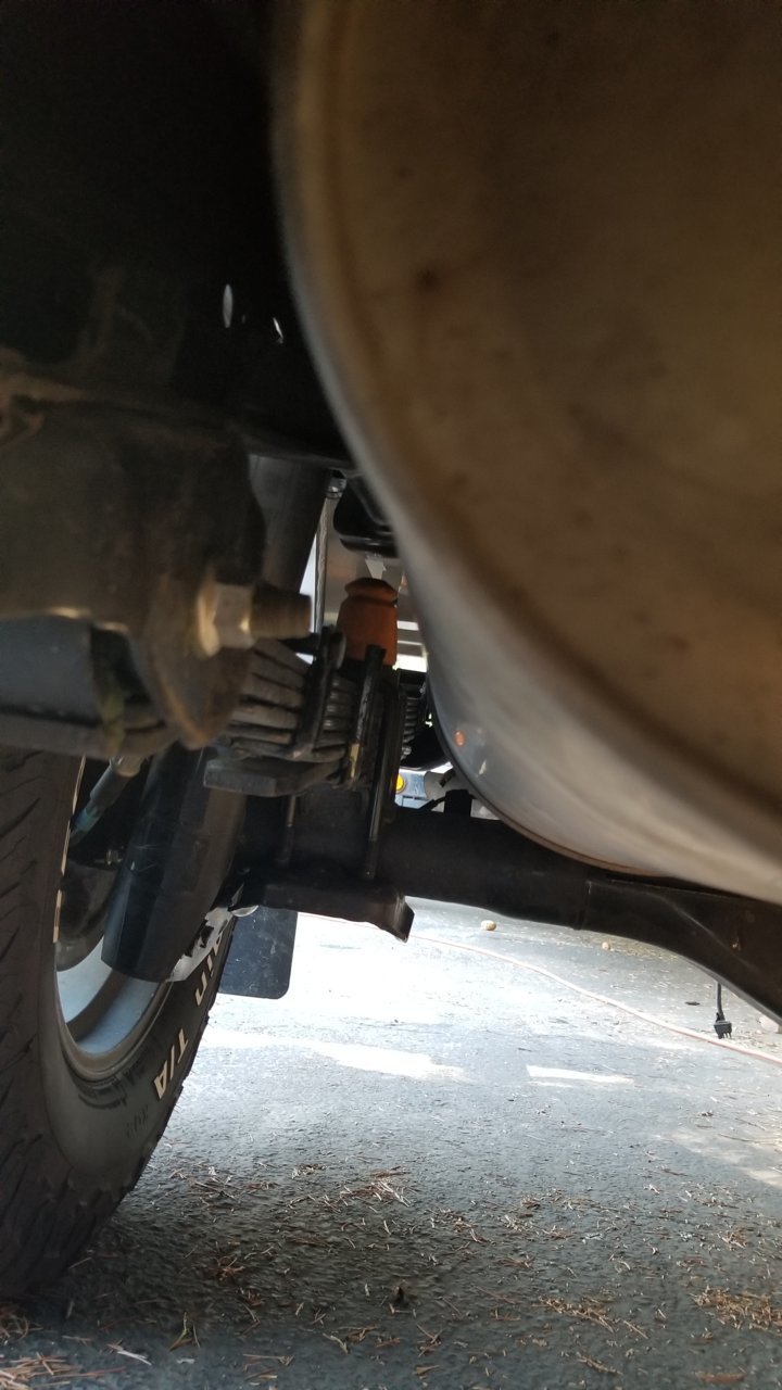

    I agree with @friendlywithbears. Here's a photo under my truck with brand new Dobinson's, less than 500 miles. It shows the springs being completely flat.

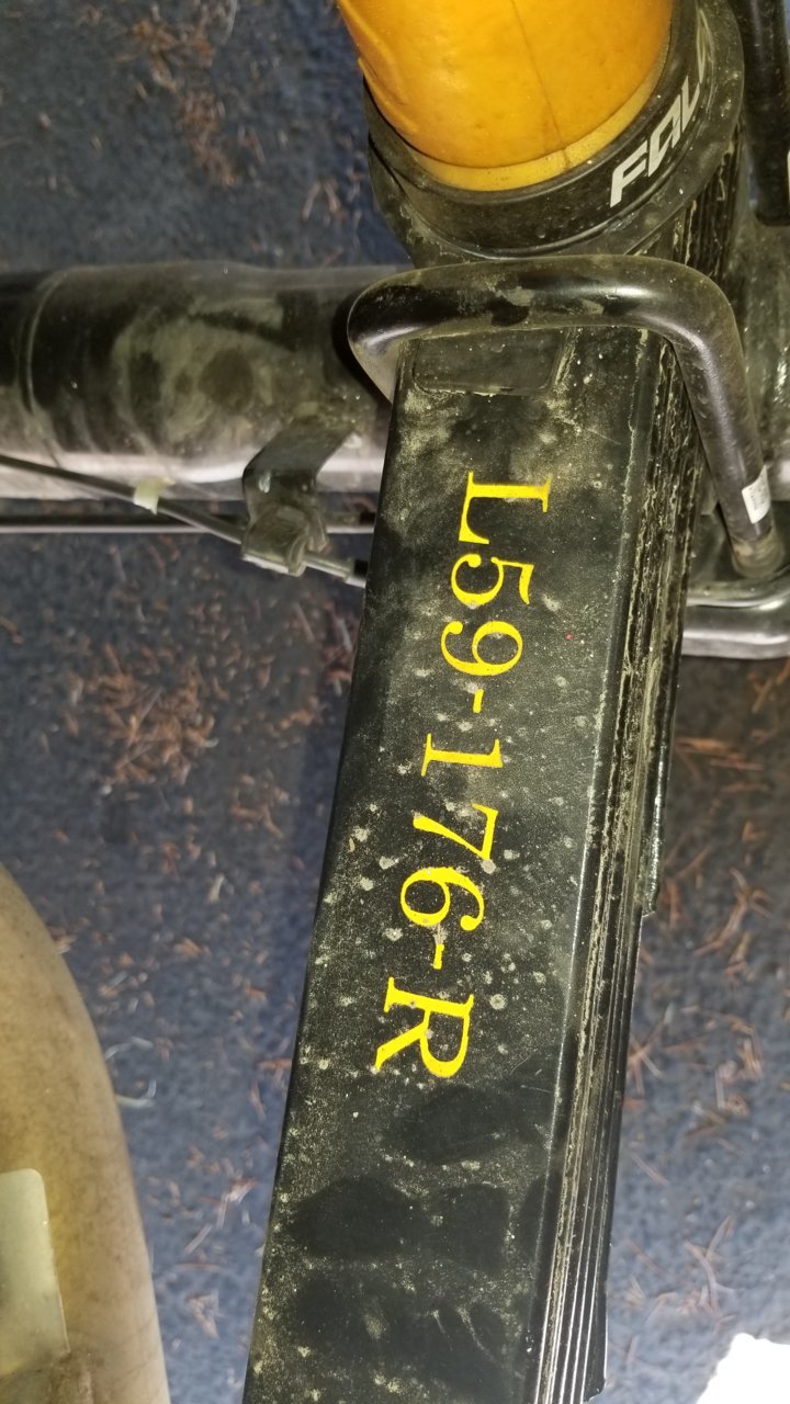

    This shows the Dobinson's spring model. This is the heaviest duty made for the Hilux. Its my understanding that its normally not even sold here.

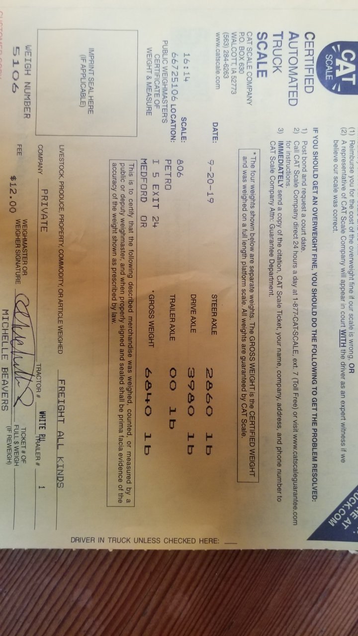

    Maybe my truck is heavier than most slide in models. I think Tacos with FWC slide ins where the owner intends to remove the camper regularly then Dobinson's with air bags would work really well, better in fact than my setup. My particular truck with custom leaf springs with the camper on works really well but with the camper off the drive will be excessively stiff.
    Since my intention is to leave the camper on, I requested the Dobinson's be replaced with custom Deavers

    Tacoma's w/ Flatbed FWC's will always need Air-bags with cradles and bracket extensions to to handle the weight. We would never send out a Tacoma flatbed build with just leaf springs alone regardless of brand Alcan/Dever/OME or Dobs, they need added support when loaded.
    If someone is having 176R's go flat w/a slide-in that's a different story.
    It is also a very fine balance when it comes to a flatbed + additional accessories (LRA tank, etc.) on a Tacoma. This is why you see more full-size trucks in combo with Flatbed FWC's, these allow more people hauling, gear and vehicle accessories to be added while staying within GVWR.

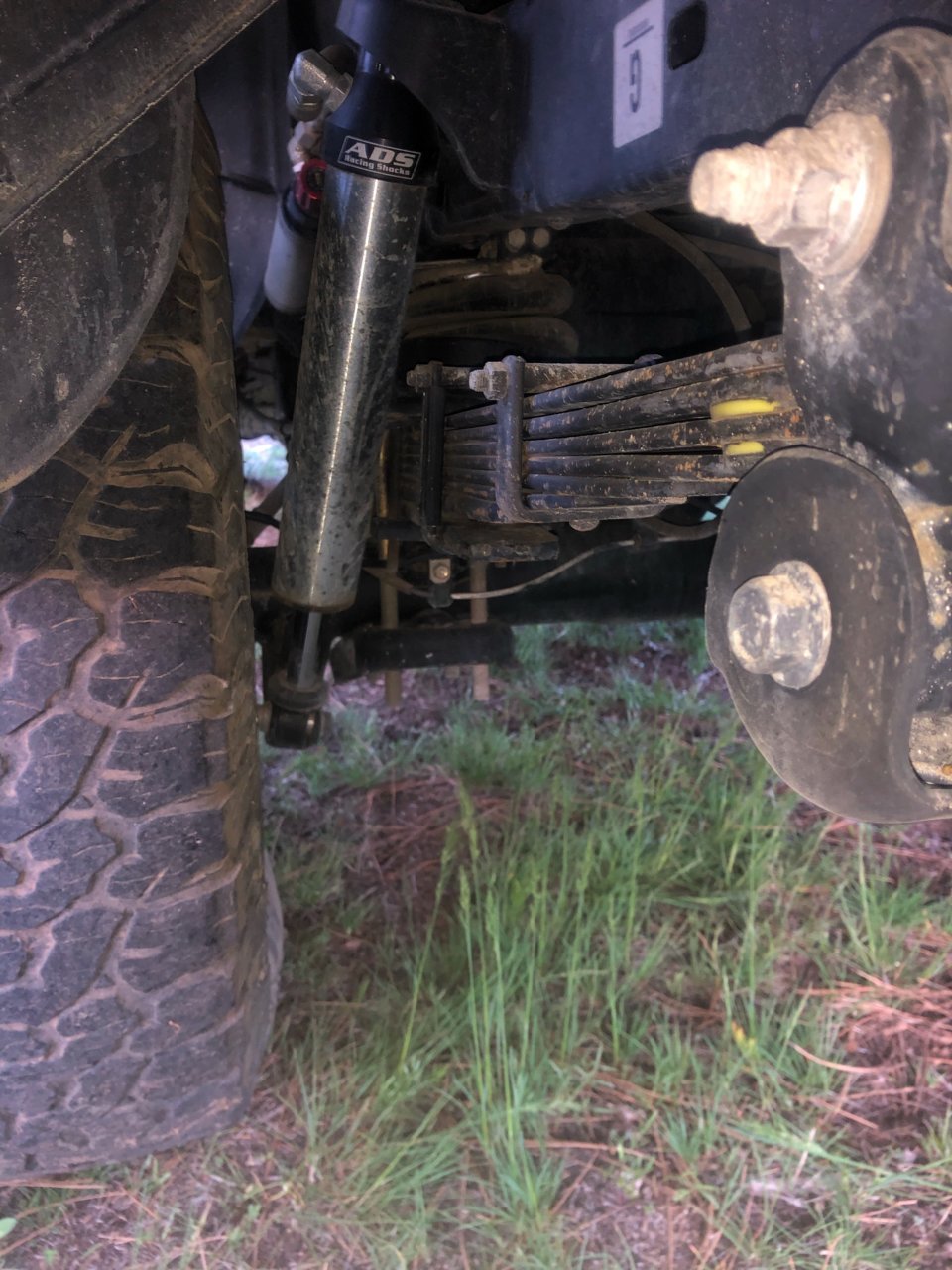

    Probably the heaviest here, 110 k miles 3+years later (full time) and they still have an arch. OME modified.
