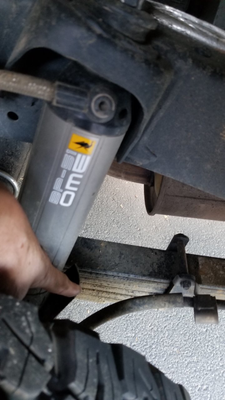

    If I may ask, who makes those shock gravel guards?

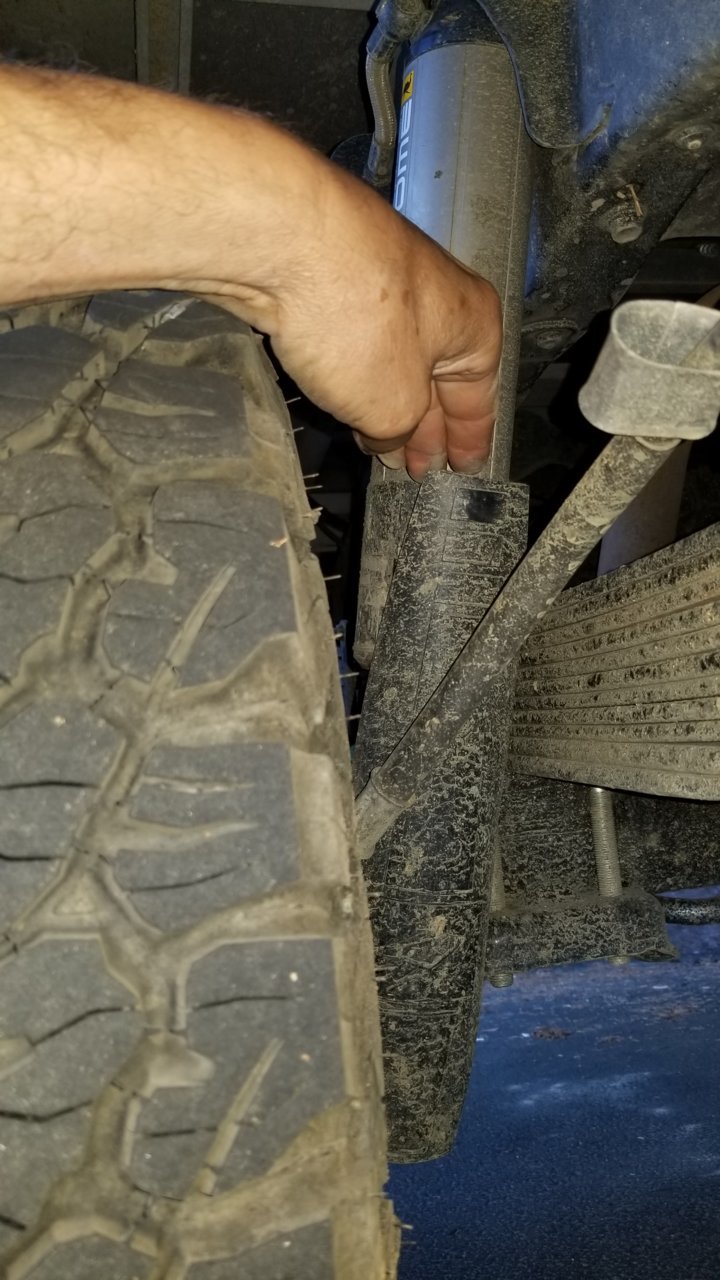

    I’m sorry yes, you. Hard black plastic ones in the picture.

    Ah. Unfortunately those are part of my OME BP51s
    I'd call them more of a mud guard as they're not super robust.
    But they would prevent chipping from gravel

    Thanks for the pics!
    Doesn’t look like it will work on mine, darn. Our shock piston rods have a high Rockwell hardness, but when you’re in granite or basalt country there’s a chance for a nick and thus tearing the seal.

    You might try the Fox guards? They talk about using them here:

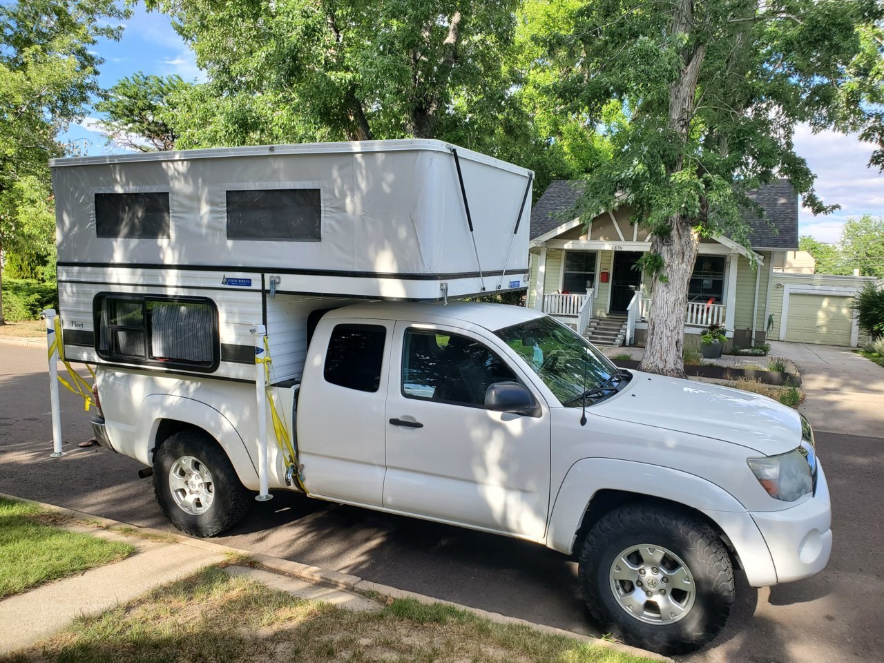

    Finally joined the club!
    The tie downs were just to get it home, its chilling in the garage while I await the brackets from FWC.
    Fleet shell with couch.
    Been reading all the info I can get my hands on. WTW has been super helpful.
    Initial plans are skme kind of storage units, solar and second battery, outlets for charging, adding a fan to the vent.
    Any super hacks, easter eggs, must haves you guys recommended or resources?
    Thanks! Can't wait to start adventuring in this thing!

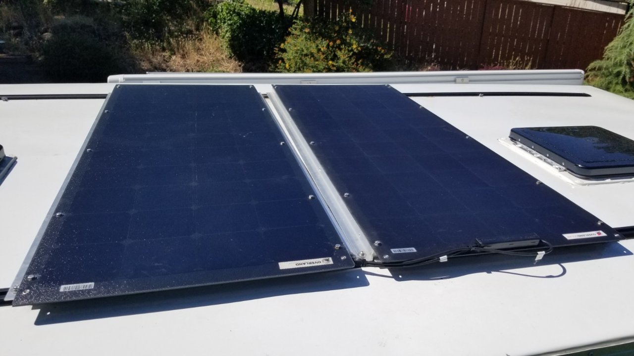

    We’re running with 2 160 watt panels from Overland Solar. One nice thing about these panels are that they are designed and built to be mounted directly on a sailboat’s roof and walked on! They’re built tough and have a grippy surface similar to a golf ball. They’re a great small company based out of Boise, ID
    At the truck’s current location, from 6 pm until 9 am, the panels are shaded and the battery provides camper power and typically uses about 22 amp-hours or 300 watts of electricity running the frig. In 2 1/2 hours (9:00 am to 11:30) of sun, the battery is fully charged. Don’t need to run the truck to keep the battery charged

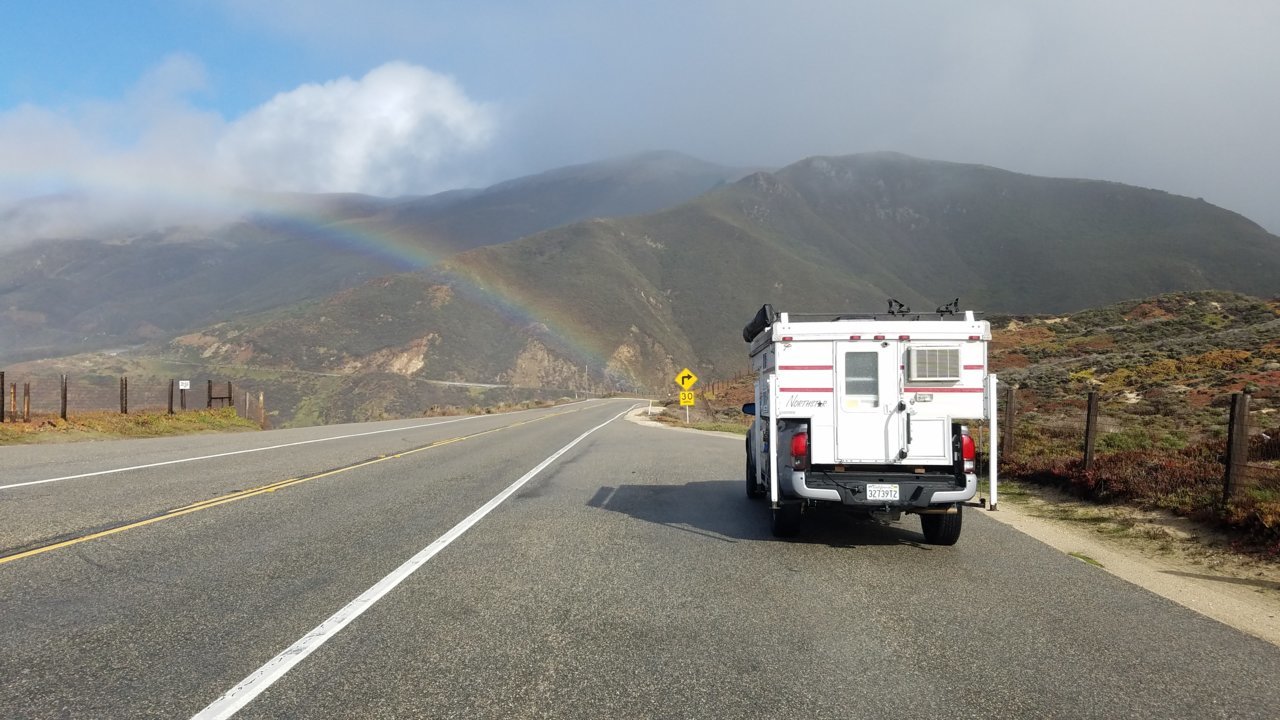

    I have an A/C in mine, but it's ran off of shore power, or my Champion inverter generator. Easily drops the temp inside the Northstar by 20 degrees. You can see it on the right side in the picture below:
