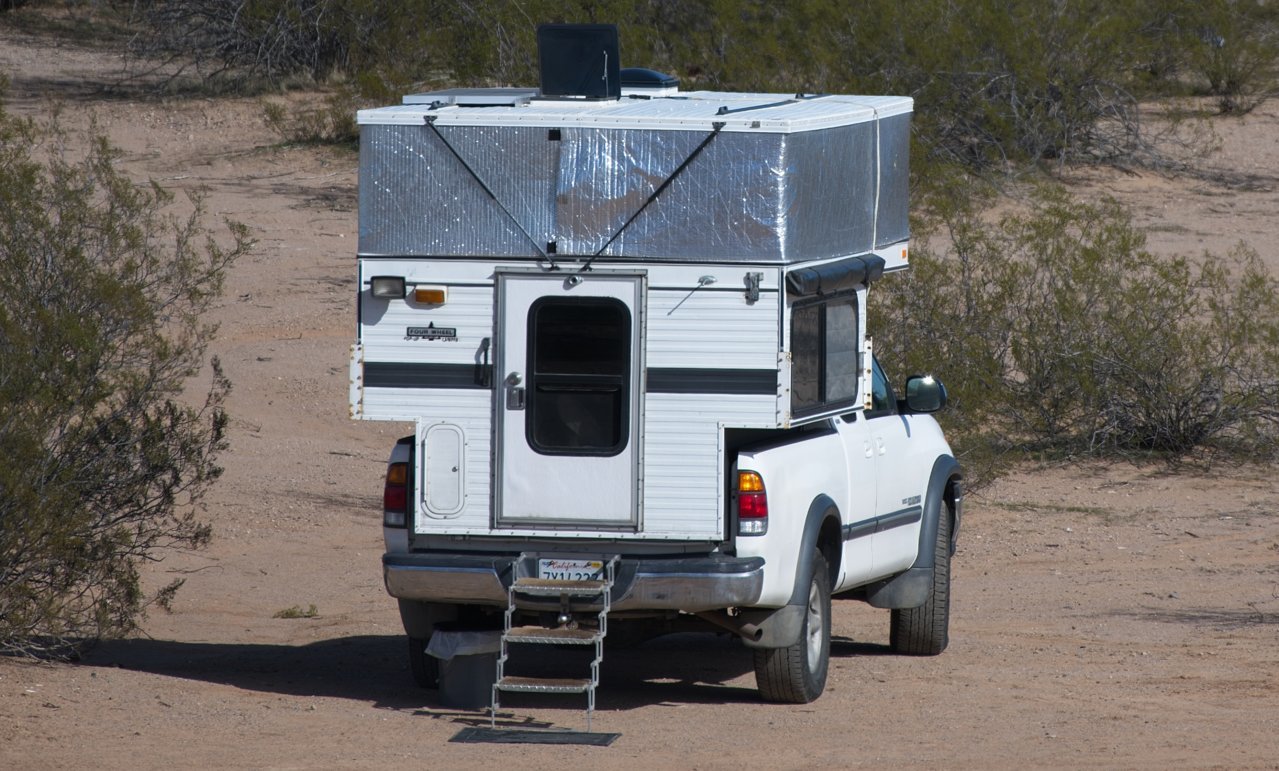

    Thermal barrier I’m on the fence about getting. Have talked to some owners and it’s more work to remove condensation from the outer walls. Of course this will depend on the climate you will be in....
    I’ve seen some other approaches:

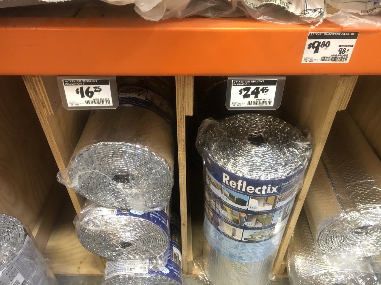

    This guy was in Tucson in the middle of there winter keeping in heat. Looks like a roll of reflectix fits right under the roof’s lip and adhesive backed velcro strips tucks it tight. Haven’t tried it yet but only draw back is no windows and less light.... humm

    Interesting. Could always cut out the windows. But how do you put it on without having a ladder?

    Yes I see your side door might make it harder. My rear hitch step I can reach it. Standing on the sliders or opening the cab door I think you can slide it behind the roof struts in front. Cutting in windows might make it too floppy I think...? Just guessing here, still haven’t tried it.

    For me the issue is where will I store that roll of reflectix... ?? A-ha moment dry bag it and somewhere between the cab and overhang.... humm I have the factory roof rack that it could be strapped to..... humm

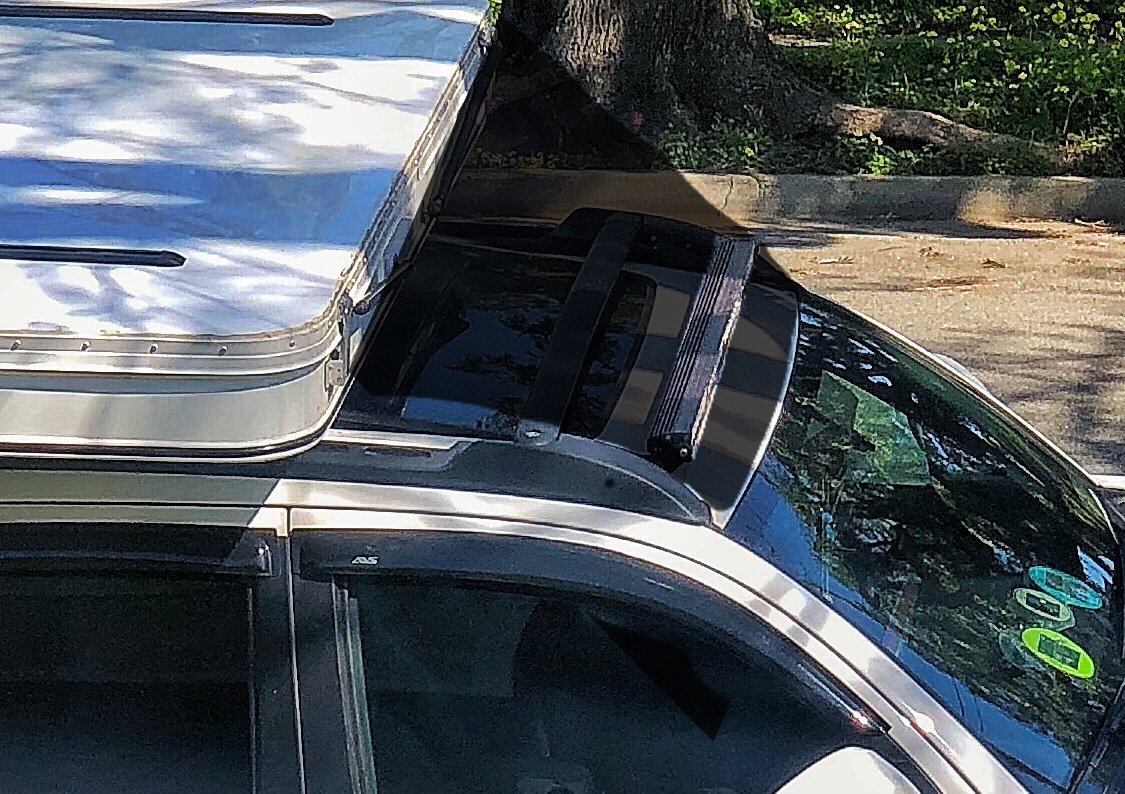

    Maybe this thread should evolve or morph into a hack/project/ideas thread??
    another one on my back burner is some kind of faring for the front...
    seen this:
    photoshoped this:
    not sure if it would be better mounted on the camper or the truck..??
    just throwing it out there since we’re in a like minded group..
    have a few more but may not be the right time to purge...lol

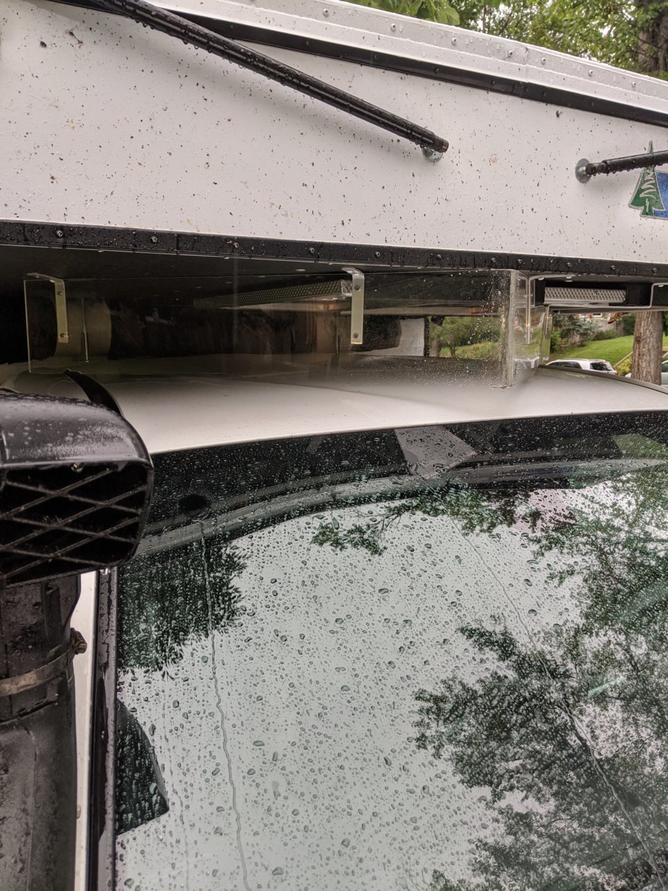

    Here's my solution for storage
    I have more pics and info here:
    https://www.tacomaworld.com/threads/taking-a-tacoma-around-the-world-need-advice.585792/page-44

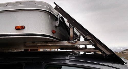

    I've also just built a faring for between the camper and the top of the cab
    It's working very well. More write-up on my build thread.

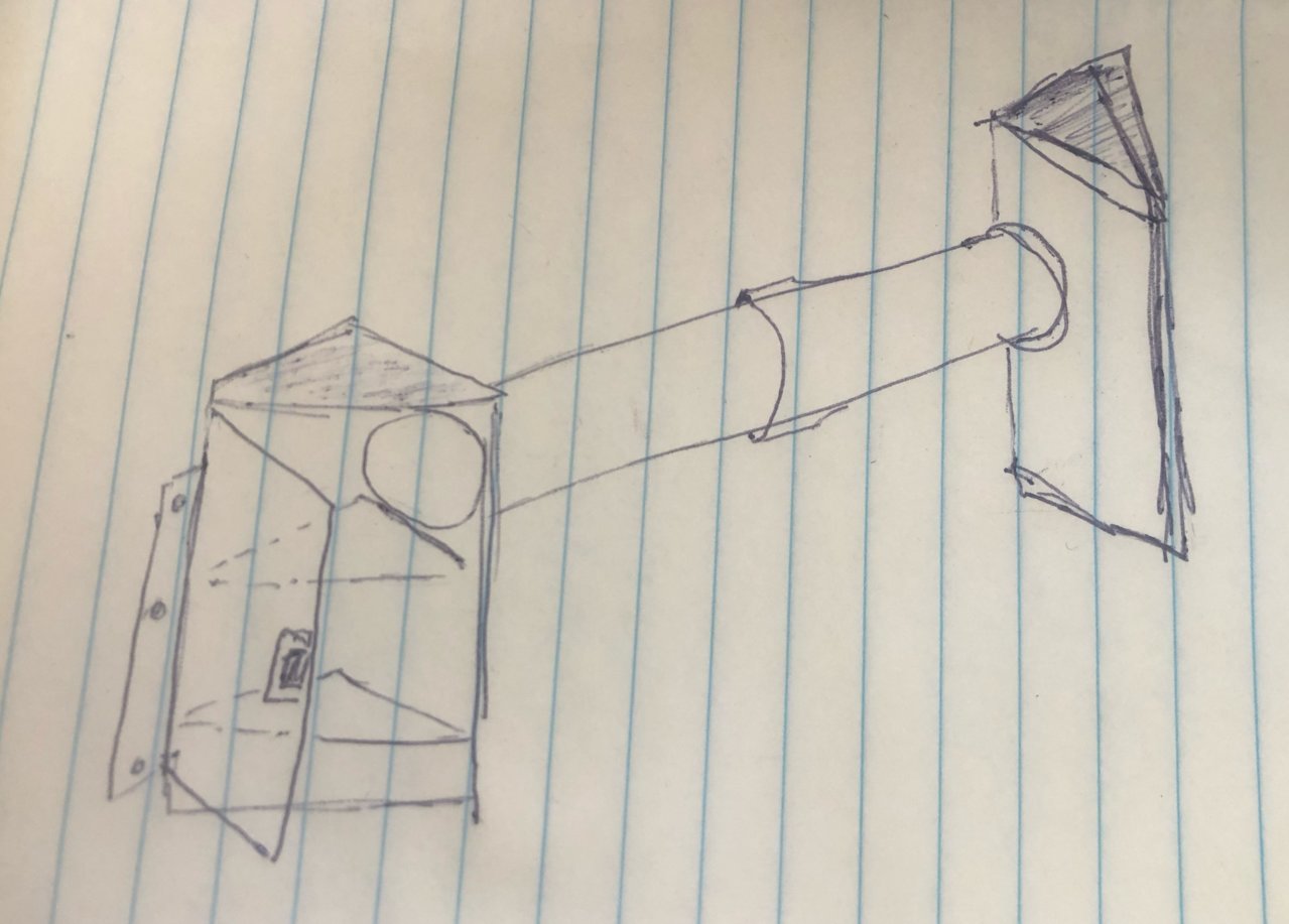

    I like it we’re not to far apart I had that same space in mind for some angled storage boxes w tube connect. Thinking auto storage, lubes, grease guns etc.. Also reducing the flat wall plowing through the wind. Here’s my idea sketch:

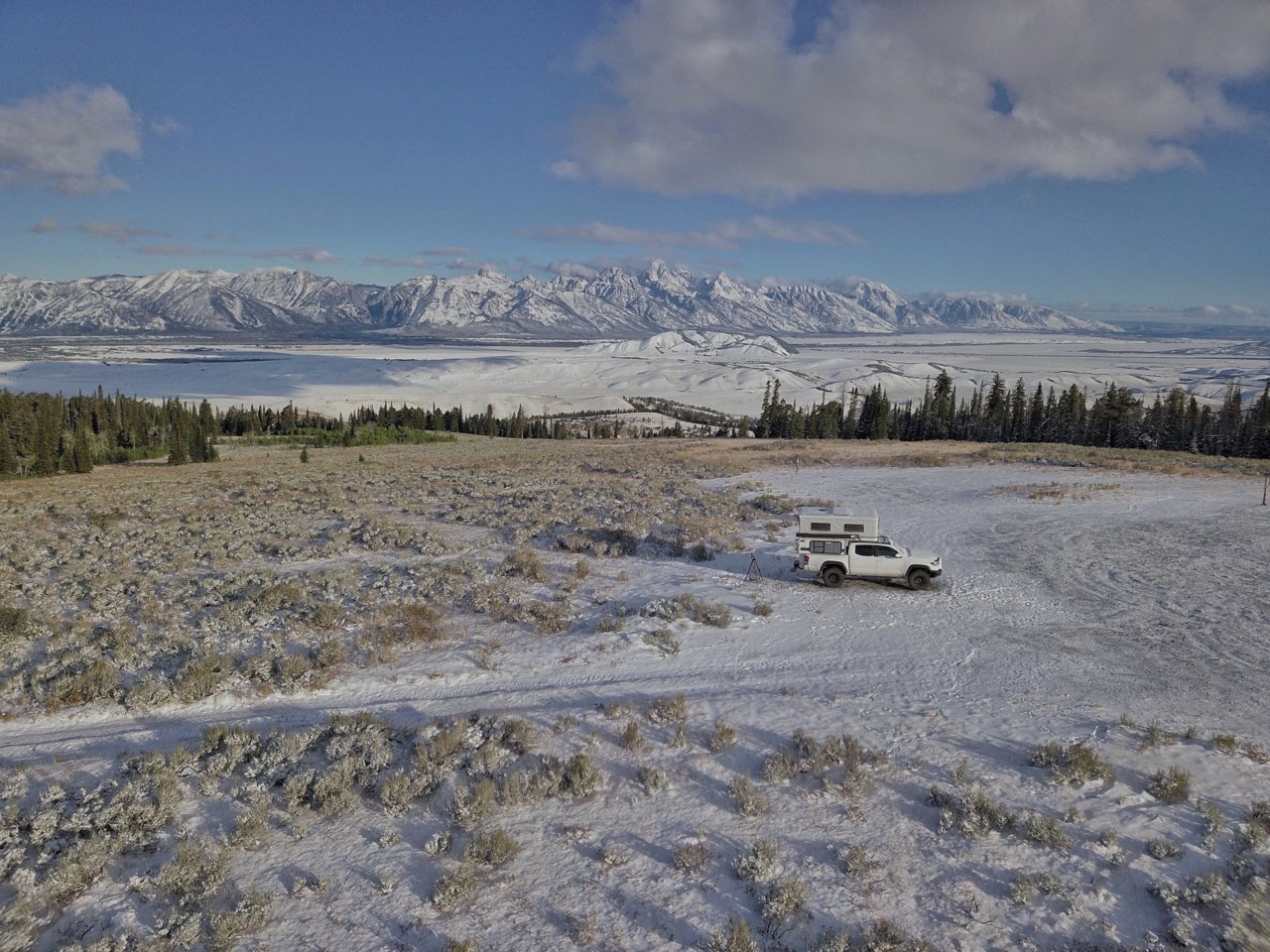

    Grand TeTons, Wy.

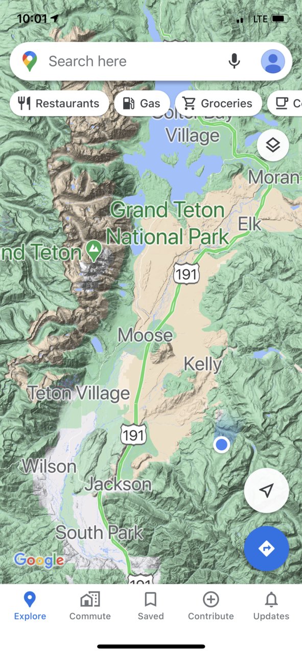

    This is awesome. It bothers me that I can't find the exact spot, but I think you're somewhere near here. You can see Teton Village Ski resort off in the distance... :thumbsup:

    Very close, out the end of Sheep Creek Rd. Disperse camp site 15
