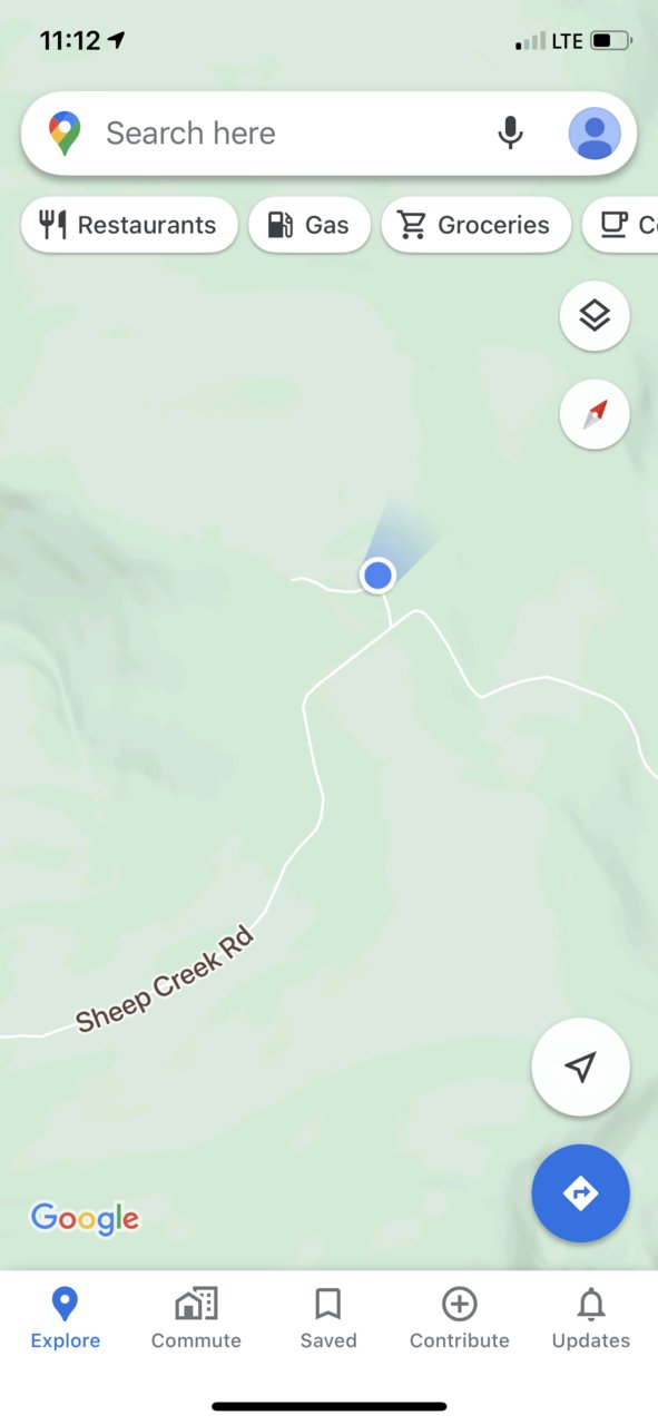

    That is so cool. You even pinged your location, and I think I've found it here. :cheers:

    Nice! Do you have cell service? We’re always looking for it as we’re still working

    Yep 2bars LTE sprint, have been able to stream Netflix/Prime w phone facing right way

    RyanDCLB
    RyanDCLB Well-Known Member
    Jun 13, 2019
    #296235
    3,490
    4/19 DCLBOR
    It's the same spot as here. :notsure: :oldglory:

    keep going up sheep crk rd

    Wait I think you got it!!
