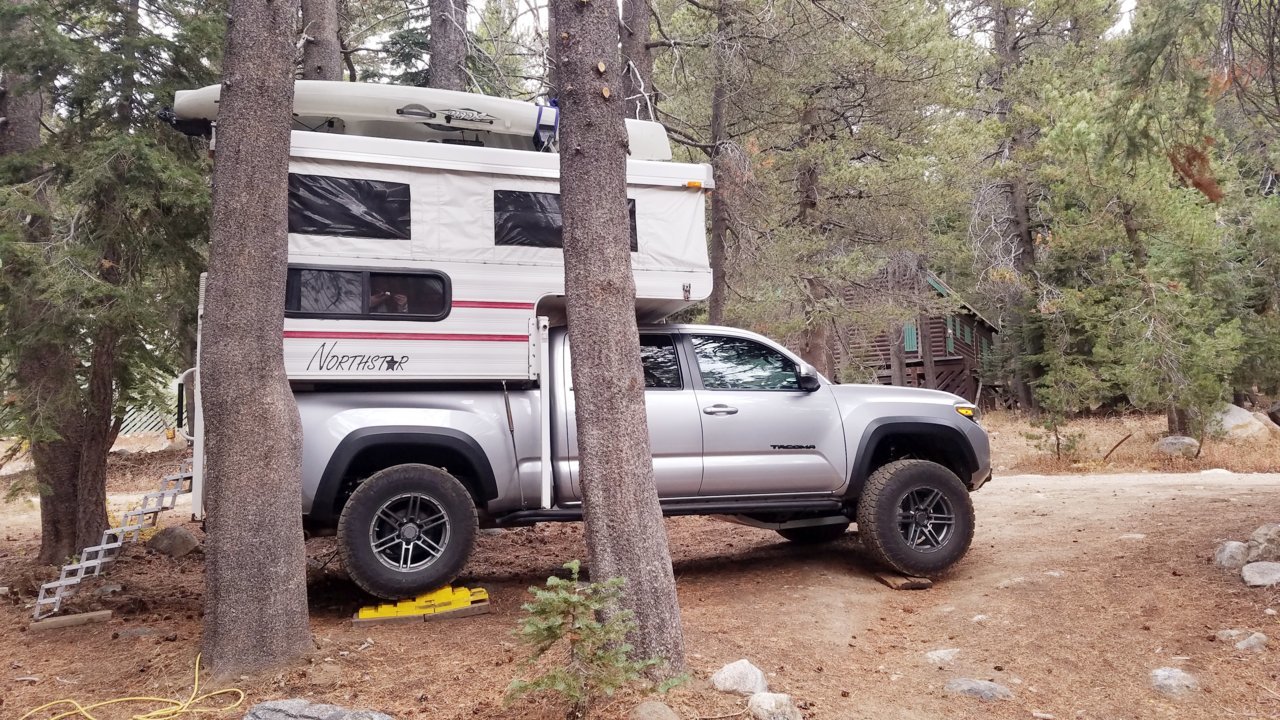

    Just getting back from a Sierra trip with the Torque airbags set at 30 psi, Dobinson 110 leaf springs, custom u-bolt flip plate with Durobumps helping the airbags. Remote MRA Dobinson shocks/coil over with the 352 coils. Extras including Archive hammer hangers, Marlin cam tab gussets, and Total Chaos spindle gussets. Fully loaded with a Northstar camper, with full armor, this setup performed flawless. :thumbsup: Mod list here.

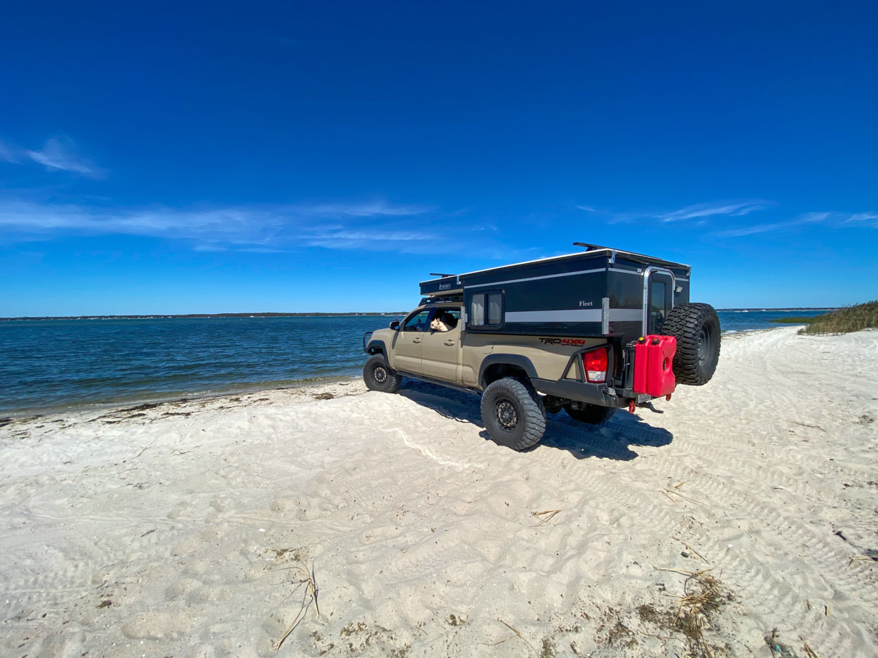

    But yeah, between the DCLB, the front bumper that makes the truck even longer, and now the rear swing out and 35" tire back on the truck ( @tsrhines ) , my truck is longer than most Tacomas. Never had an issue parking or wheeling due to the length. And I've made plenty of use of the bed (before the camper) that a SB wouldn't have been able to.
    I also just made a video of the camper:
    https://www.youtube.com/watch?v=LFiL7V6AiSw
    And here's a newer photo with the rear swing out on it again:

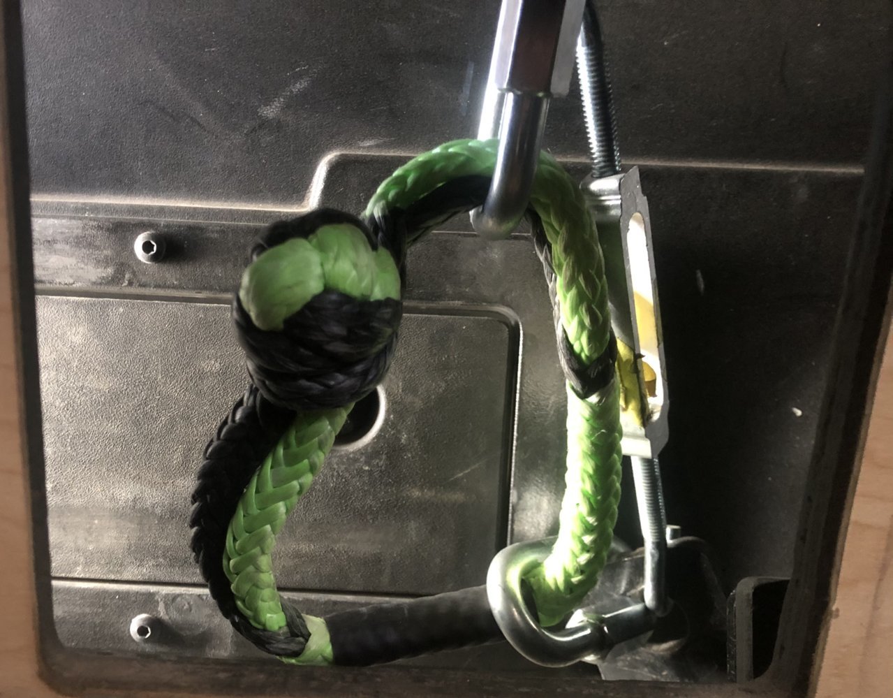

    Hope everyone is doing well! I have a must do for all FWCampers with internal bed mounts!!!
    Think of adding some safety feature in the prevention of loosing your camper under harsh environs....
    my first attempt and I may upgrade to d-rings in the near future
    these weak steel turnbuckles have been a constant battle for the last four years... A different turnbuckle is in the works and will post when I get it all ironed out. A more robust one dropped forged and clevis pins at the ends, typically used in rigging

    Whatever happened to just adding air shocks to hold up a camper? Probably a naive question but just curious as to why not?
  16. Nov 30, 2020 at 2:05 PM
    #276
    Steelhead Taco
    Steelhead Taco Oncorhynchus mykiss
    Jul 30, 2016
    #193323
    923
    Fred
    2016 OR DC SB MT
    If your just getting a shell and not packing for extended trips you might get away with it... but it’s safer to match suspension to your weight

    This seems like a great idea. I'm guessing it's a back up in case the turn buckles fail. But also this
    my turn buckles are aluminum not sure I've ever seen steel? Just curious as to the comment.

    Those look like the OEM aluminum. It's definitely a backup in case of failure, and a damn good idea.

    A lot of applications for turnbuckles, even all stainless in food production and sailing rigs
    edit:
    stock turnbuckles have steel hooks and a aluminum turnbuckle

    Agreed just the ones that came with my camper and the ones in the pics definitely look aluminum. Just an observation though. But it's a great idea none the less. I've always thought of mine flying off the back of the truck.
