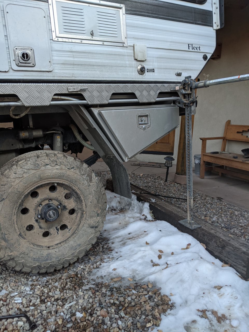

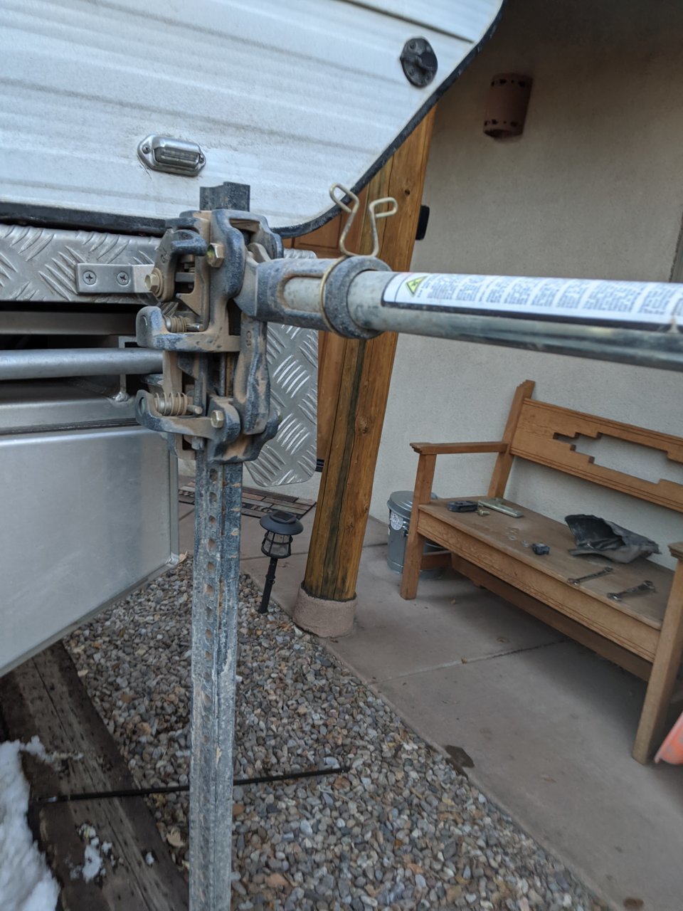

    I was rotating my tires yesterday. My problem which is specific to flatbeds is that I don't have any low points to use my hi-lift on
    Notice that my hi-lift is at its max
    And that my jack is on a 6" block of wood. The jack doesn't work off of the back due to the sloping back of the camper

    You've got the wrong tool (IMO). That looks like a 36" hi-lift, you probably need a 48" or 60" hi-lift. I also would look in to some kind of bottle jack or floor jack to lift from under the axle for this kind of maintenance stuff. Even used properly, hi-lifts are sketchy (I've had a jeep fall on me and pin me under the leaf spring and I had the front on a floor jack and the opposite side on a jack stand) so lifting that high in a situation that a floor jack or bottle jack would suffice is nuts. Hi-lifts absolutely have their place and uses, but general maintenance shouldn't be one of them.

    Agreed. I should have prefaced this with saying being full-time on the road the type of maintenance tools I have is extremely limited. Yes, I could go to a shop and have them rotated but now is the time to experiment with how to do it myself before we go overseas. I wish I could carry a floor jack but that’s not realistic for me. I only rotate one tire at a time and would never consider getting underneath the truck. I have used a hi-lift to lift up and push over the truck in extreme circumstances.
    I’ll re-look at using the truck’s OE bottle jack instead.

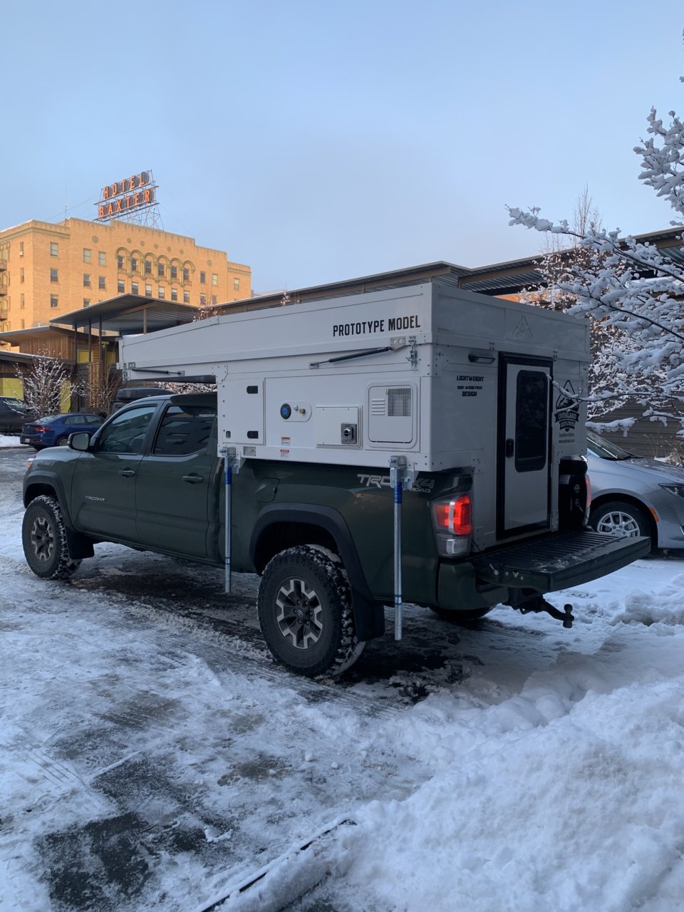

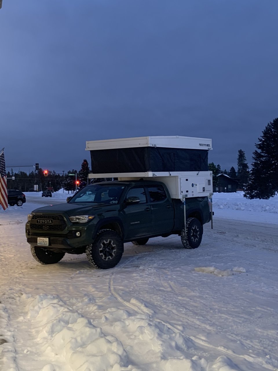

    I’ll just leave this right here. Drove from Washington state to Bozeman MT to pick up the camper from Big Sky RV. Spent the first night in West Yellowstone with -11 degree temps. The camper stayed a cozy 70f all night and could’ve been hotter but shit we where already naked since it was so warm all night.

    is that the Camp M? model curious how it would look on a short bed.

    Technically it is not the “cam M” it is the first ever slide in truck camper they built but it is the dimensions of the upcoming Camp M. It is about the length of a fwc swift model so it would work great on a short bed. For me I like it because I can close the tailgate.
