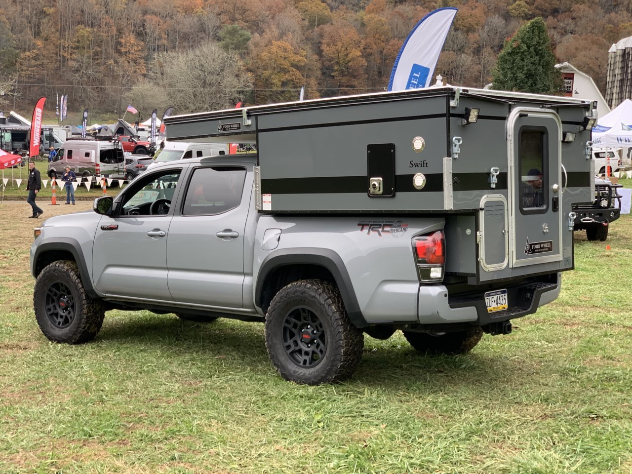

    We installed this camper on my truck at Expo East in about 30 minutes on an uneven surface. Really Easy with the jacks and turnbuckles :thumbsup:

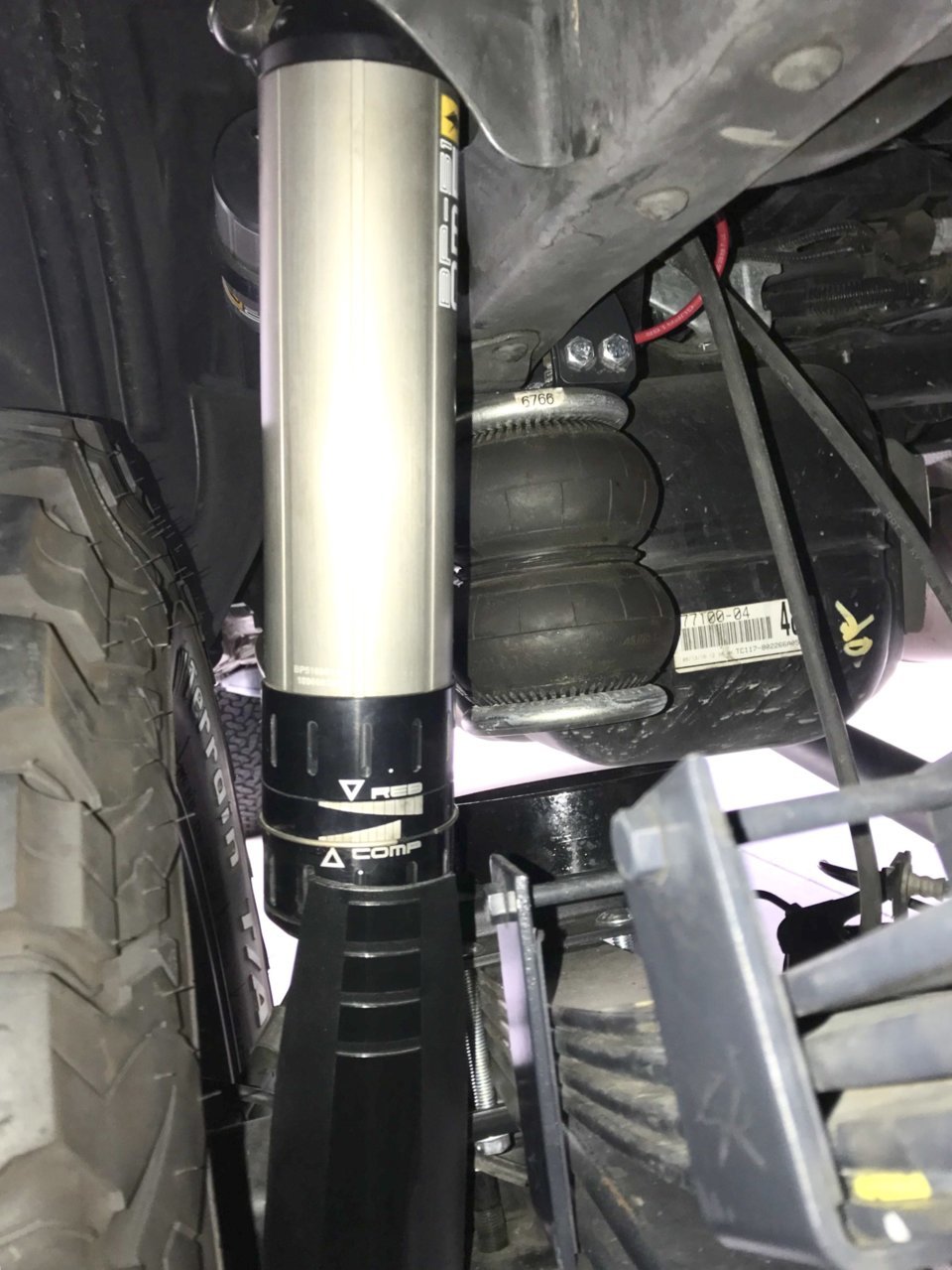

    I lifted my truck with a set of OME BP-51’s. In addition, I added a set of Firestone Ride Rite airbags. I have BFG KO2's in 285/70/17.
    It is a Shell Model with a heater and a solar panel with battery.

    The jacks attach to the jack brackets on the four corners of the FWC. Super easy to attach.
    I’ve camped in a similar swift shell model that’s pictured and it’d plenty comfortable for me, my wife, and 2 small kiddos.

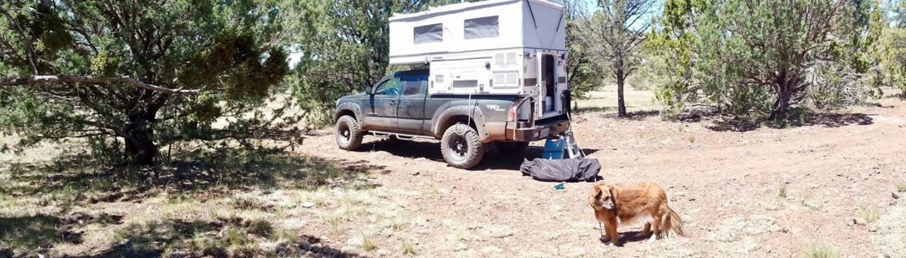

    I'm actually a 2nd Gen Tacoma...but been running with a FWC Eagle full time 5 year...just to prove the longevity of a Tacoma even fully loaded all the time.
    Custom Suspension for the full time installation.

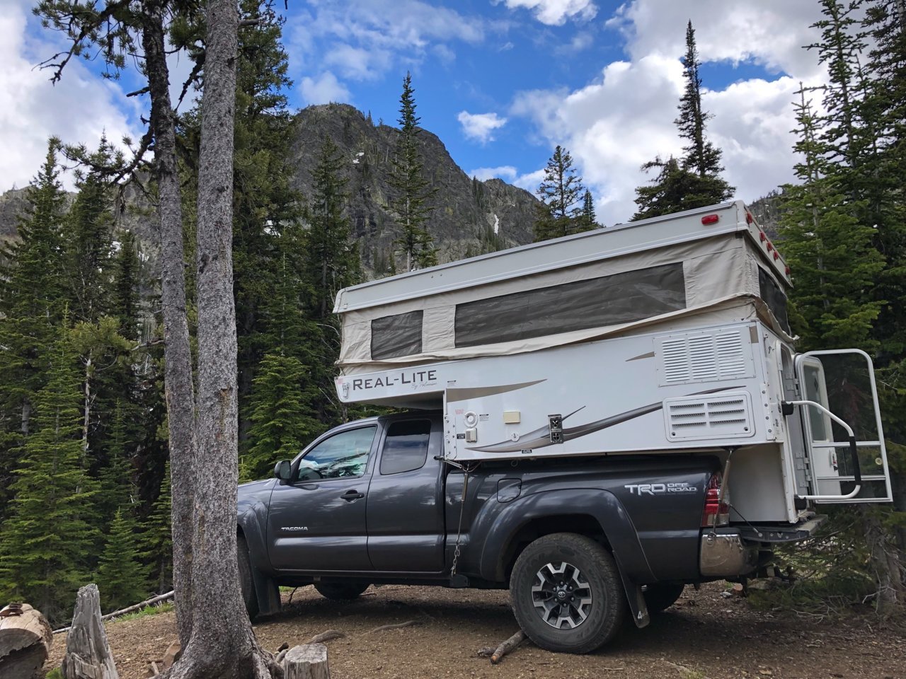

    These were photos my wife took out in the seven devils spring/summer of ‘18.
    The Forest River Real Lite / Palomino 1600 Softside series gained some weight around 2014 IIRC. They changed some features, making the pop-up feature motorized and added an outdoor shower among other things. There is no way the newer models are the same weight as that 2013 or older models.

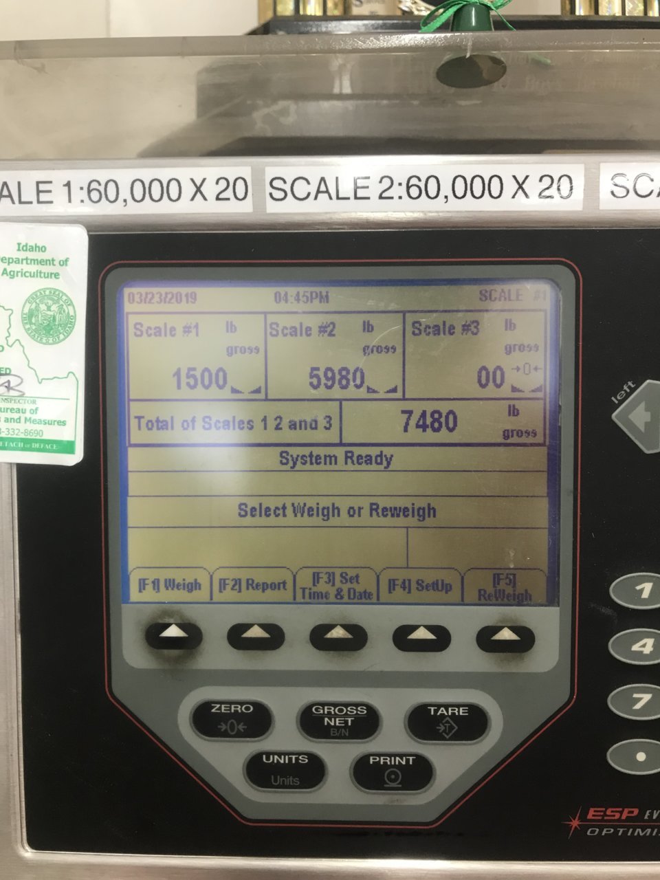

    I know of some guys that boast their shell model 4WC are ~600# when empty. This one is ~1050# with a full kitchen, 3-way ‘fridge, 10,000 btu furnace, 2-burner stovetop, kitchen sink, empty freshwater hold and a full bottle of propane. You can leave the bed made - pillows and all - unlike the 4WC that require some modulation once popped up.
    Configured like this the truck scales at ~6k#.

    To say I’m very happy w/ it wouldn’t begin to truly describe how awesome it is. I’ve lived in it for weeks at a time out at the base. Having a furnace and a couch to chill on while you’re having your AM coffee is a game changer.
    With Airbags and the right tires I feel like I’m set up for the weight just fine. I do run 75w140 in both boxes and the transfer case (ECGS recommends it in the TC while I’ve been running it in the boxes for 30k)
    Yes it will still go 80 on the freeway but I don’t really like getting 12-14 MPG so I try to keep it more civil, especially when I’m pulling the boat.

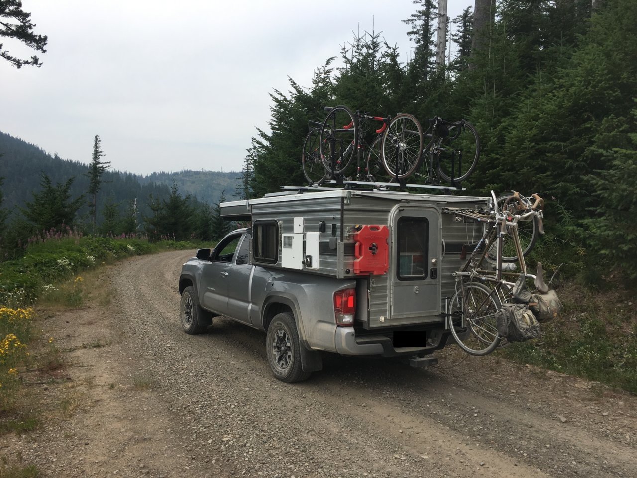

    My rig. 2017 Fleet Front Dinette. Heavily Modified.
