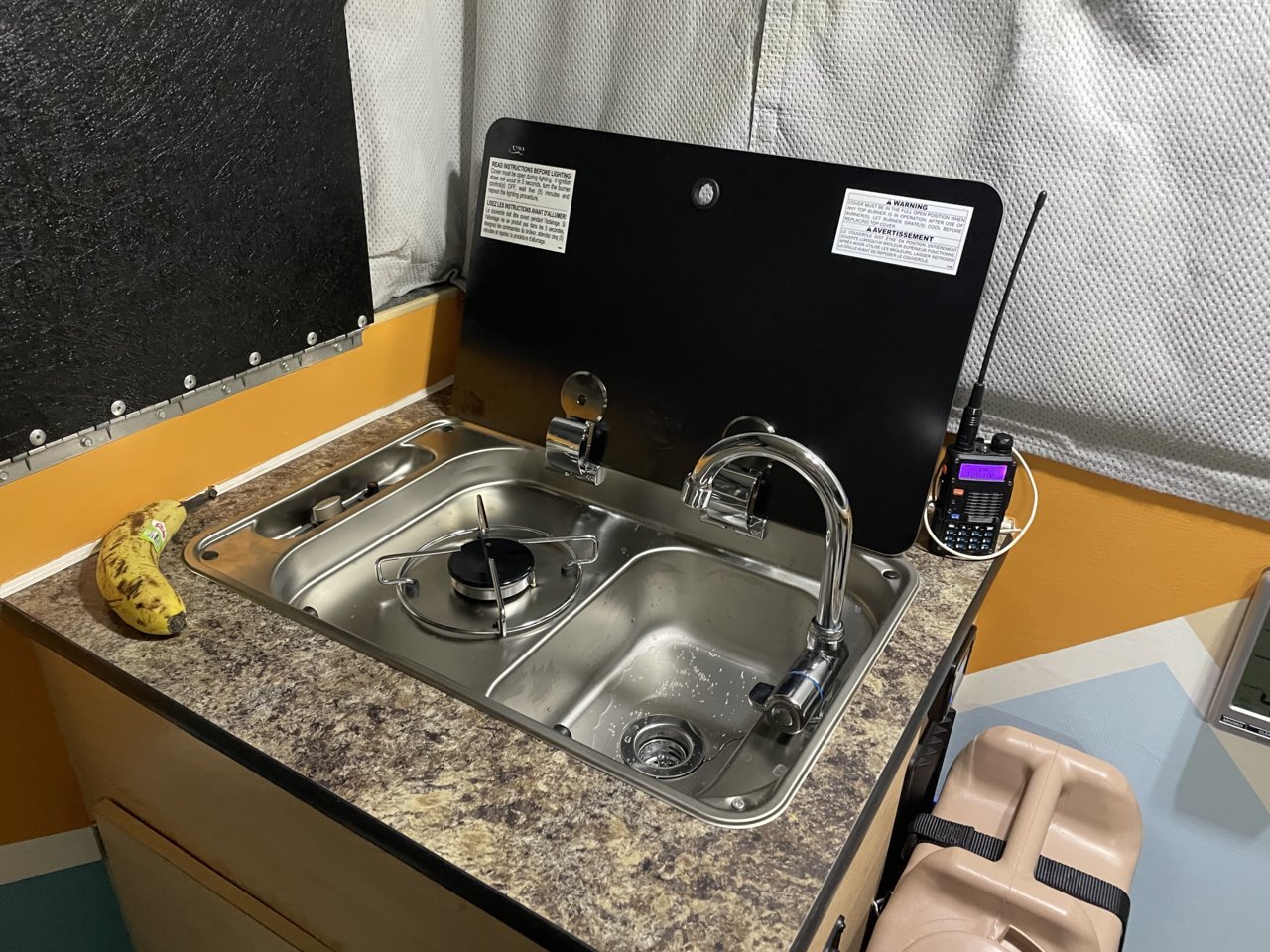

    My new Cooktop and Sink
    Gauges, Instrument cluster and my 5 gallon Jerry can as water Tank84A8D5DB-E164-4858-AC64-3F373A168CAA.jpg

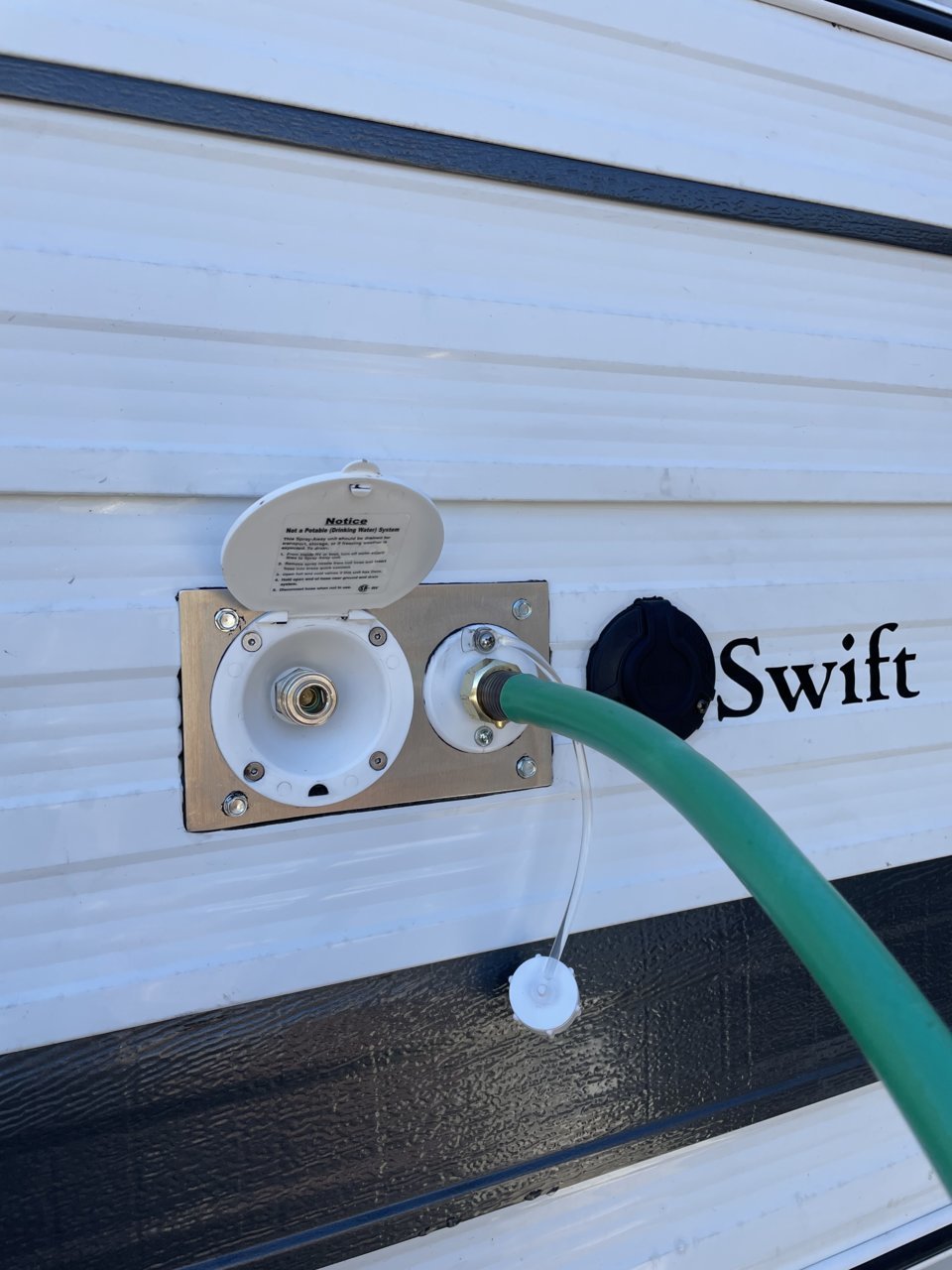

    Fresh water quick disconnect and Grey water outlet on a custom piece of aluminum mounted in place of old furnace exhaust. Also a 110 plug wired to a 10A Battery charger.ABE8D42B-8F4D-44A3-9EA5-D3BB71BBD477.jpg

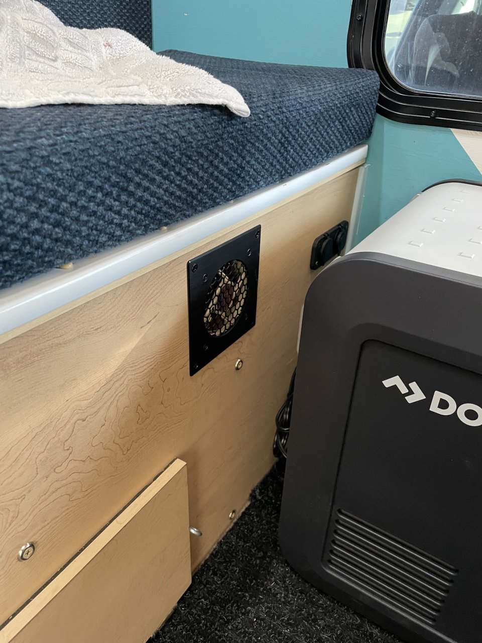

    Cooling fan draws cool air up from underneath a Victron DC to DC 30a lithium charger. The unit gets pretty hot so this was a must. It's wired in to a switch in the cab that enables the charger and turns this fan on/off591985B5-63DA-42BF-8B8F-51863B64B236.jpg

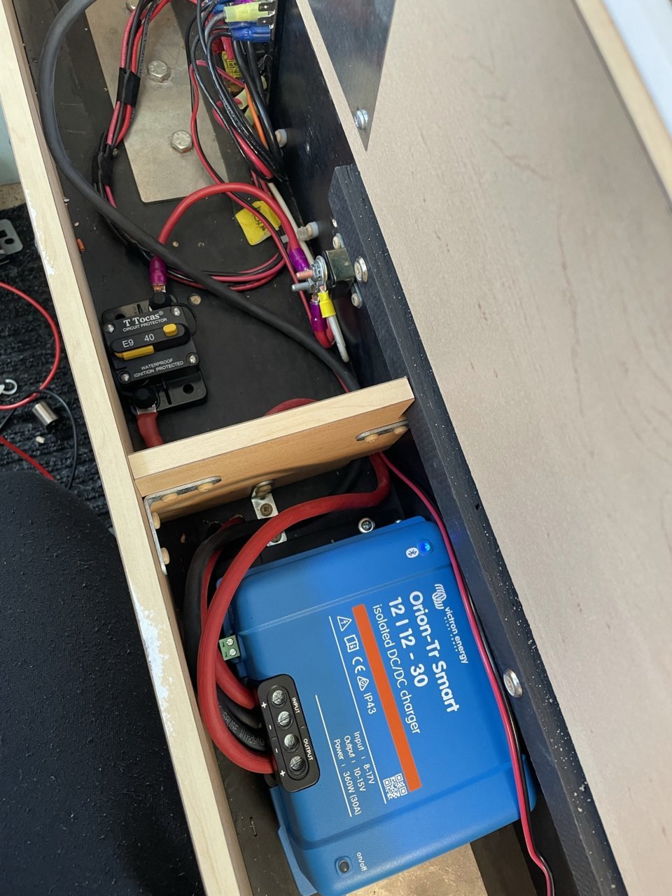

    The Victron Dc / Dc charger and wiring7F36E200-A493-484F-81D9-CFD5B56C8D05.jpg
