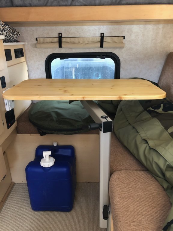

    Mine is the rollover couch but I didn't have much choice buying used. I put a Lagun Table mount on the couch and it works well. I like the storage under the rollover couch.

    Mine is rollover too. Can you post some pics of your table please?

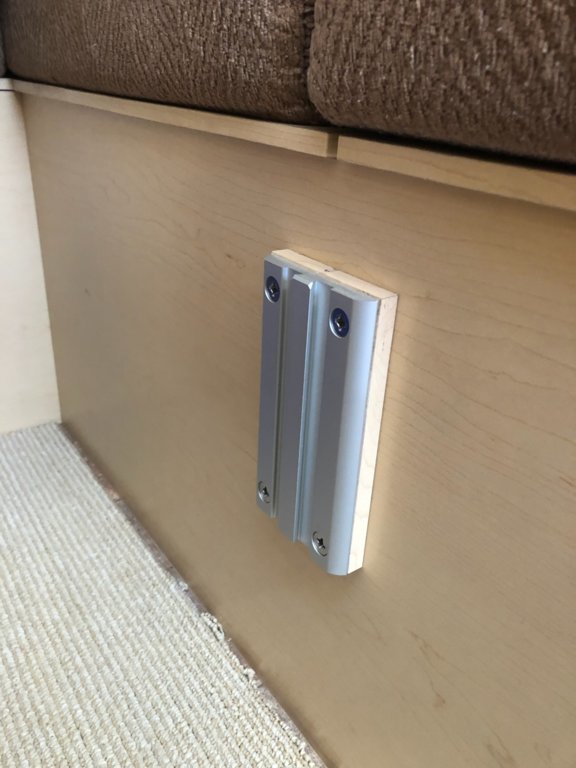

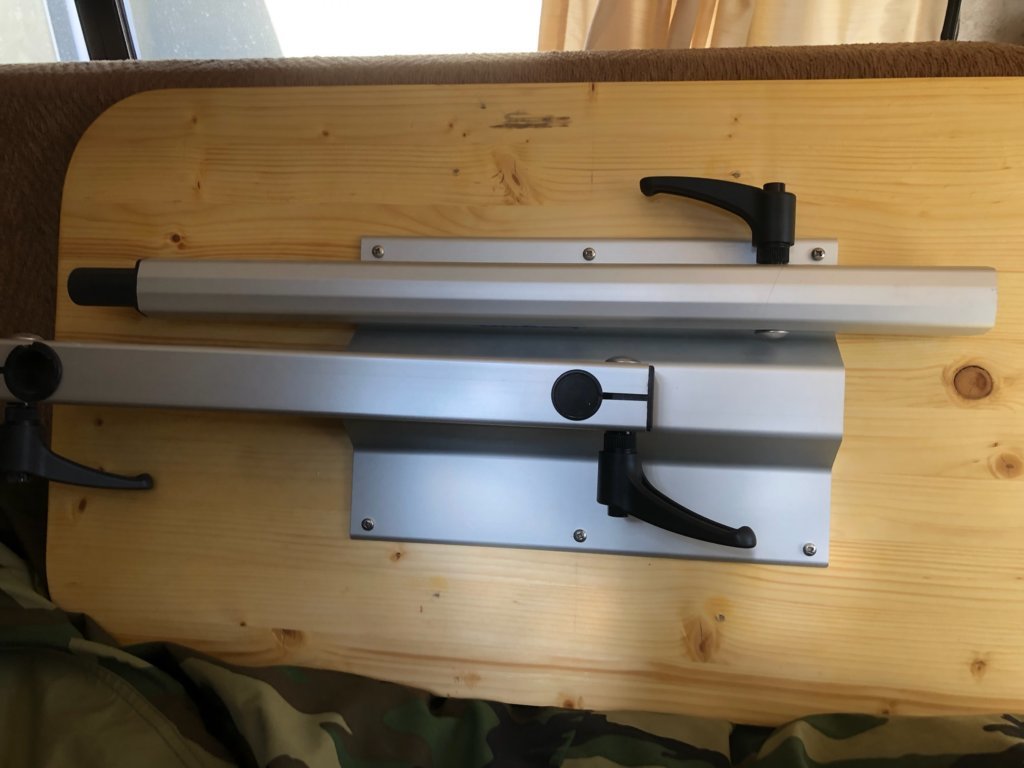

    Here ya go. I bought the Lagun Hardware Kit and just bought a piece of laminated wood at Lowes.
    https://www.lagunusa.com/product/lagun-table-system
    The mount on the front of the couch shimmed out to clear the lip of the couch.
    The legs stow on the underside of the table top.
    I trimmed the table top down to clear the cabinets.

    Thanks, that is really sweet job. I may do the same, as the current table is the removable one.

    You could probably mount the current table top to the Lagun bracket.

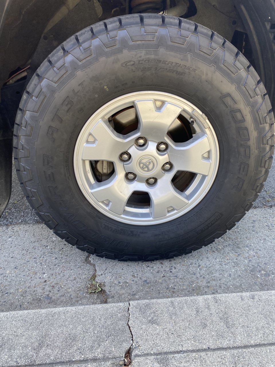

    Well I upgraded the tires today and moved to Cooper Discover AT3 LT. 10 ply. Amazing difference from the Hankook AT p rated.
    I am running 70 front and back but steering is light so going to drop to 65 front and try that out. 80 is max. From what I can tell most run 65/55.

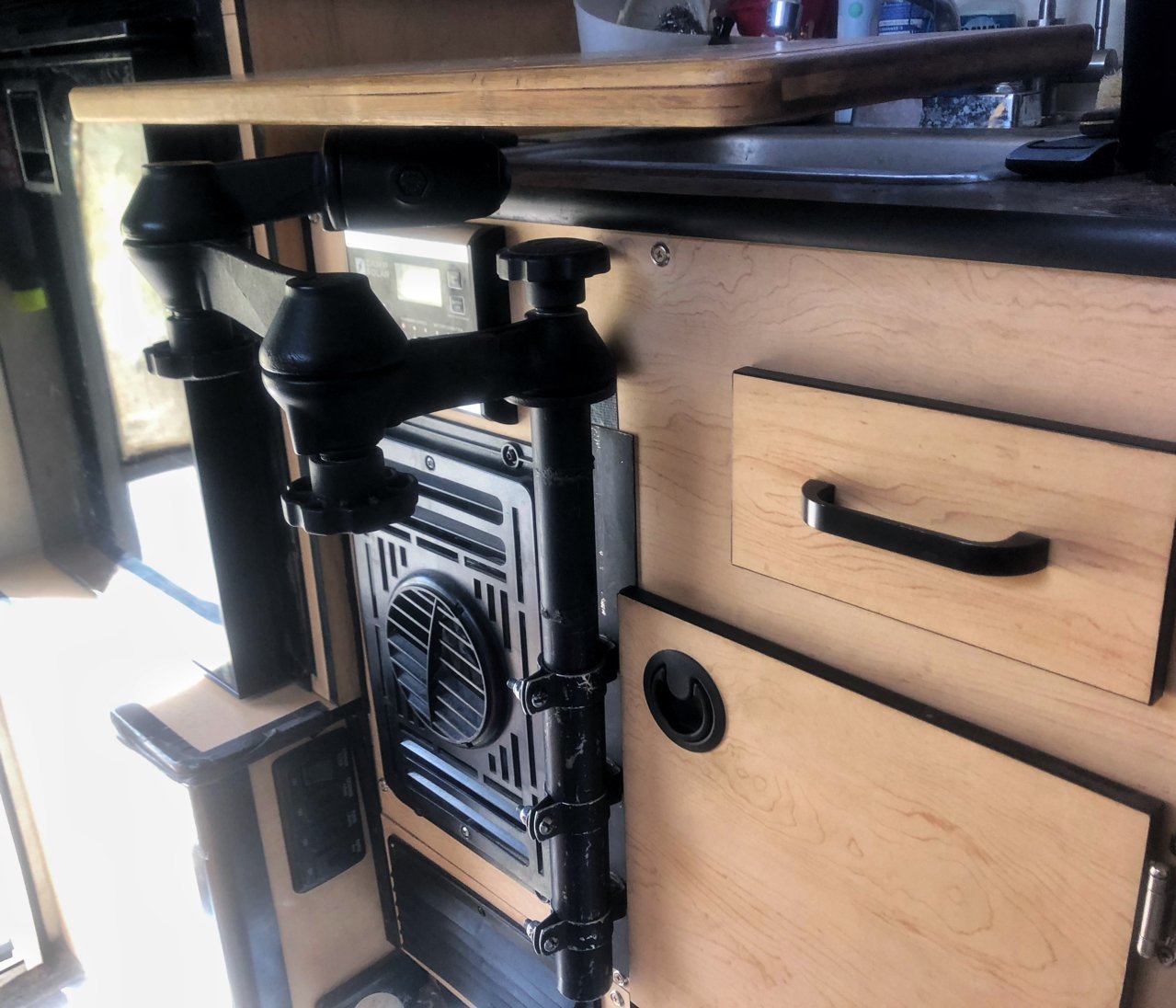

    my spin on the same idea, anything beats the useless table they give you

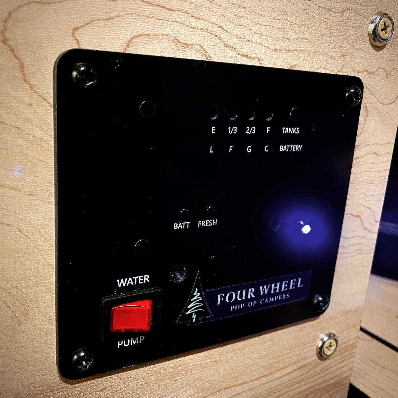

    more little fixes:

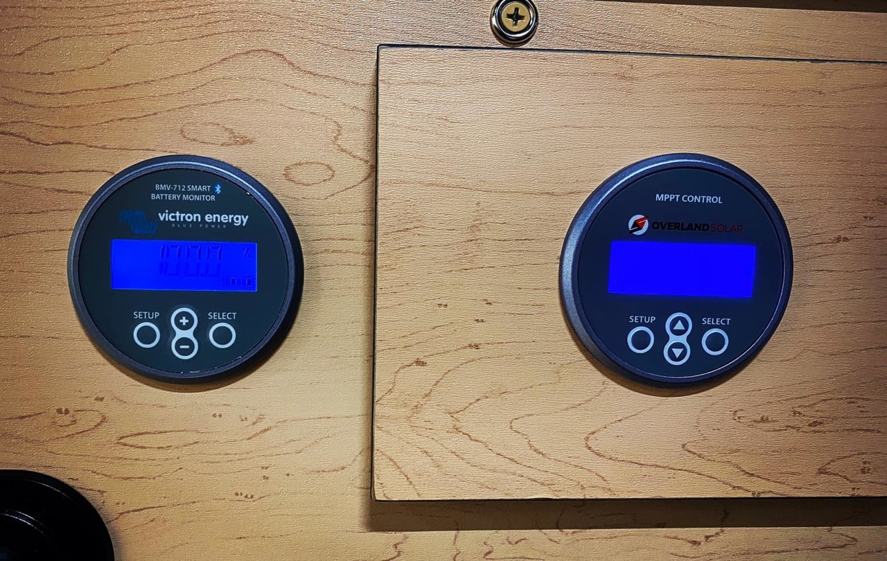

    Added a smart shunt/battery monitor, this has bluetooth so i can log history on my phone.
    I have the aux input wired to the truck battery so i can keep eyes on all the batteries!
    281800730_10116075814031633_794476717271_ae080d208f4f84cfc202801255b77b29dad3e6a6.jpg
    added a little blue LED that will light up when the automatic charge relay is latched. basically a quick glance to tell if the house battery is connected to the truck battery or not. Shouldn't ever NEED to know, but it makes me feel better knowing the status of everything.
    283087517_10116075814051593_124919053911_6c98d10db3993a6f218239f7ecaae4aacc56af9c.jpg

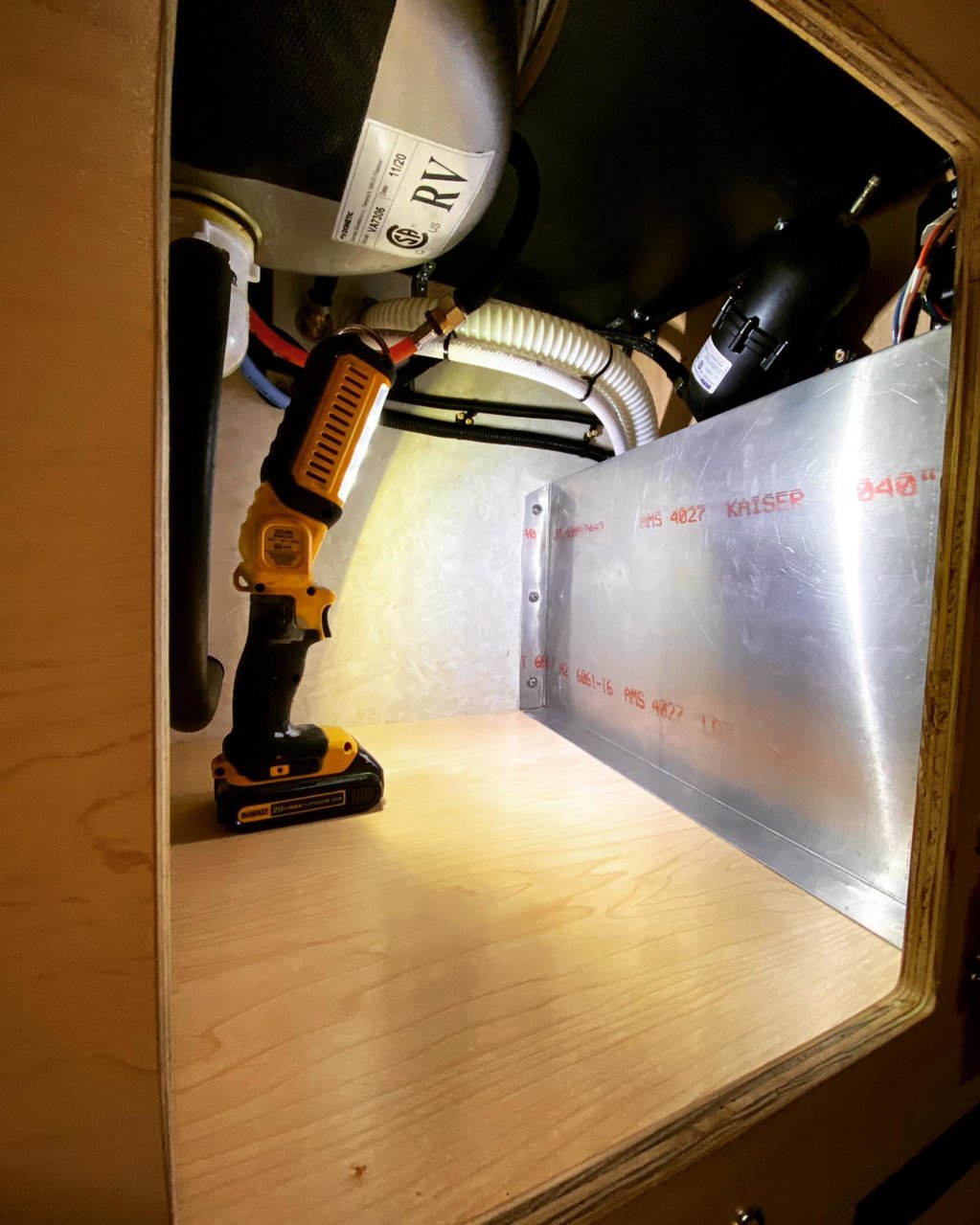

    after moving a bunch of electrical and water related stuff around in this cabinet under the sink I wanted to maximize the storage space while keeping everything delicate protected. So i bent up some aluminum and now have a good wall of protection while gaining some storage volume compared to the factory partition

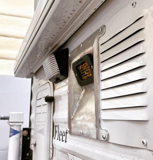

    If anyone has found a light that replaces and fits where the stock lights are pls share. The stock ones are on the delete list, switch fails and bulb contact corrosion reoccurrence. Mine have not stood up to fine dust/sands and wet environments. Their getting more maintenance than use o_O

    have you taken the stock one off yet? I'm wondering if it's just as easy to just eliminate them and plug the holes rather than replacement.
    the DD SSC2 has a backlight which im not utilizing right now but would function exactly the same as that original light.
    I should put some dieelectric grease on the bulb contacts... thanks for the warning.

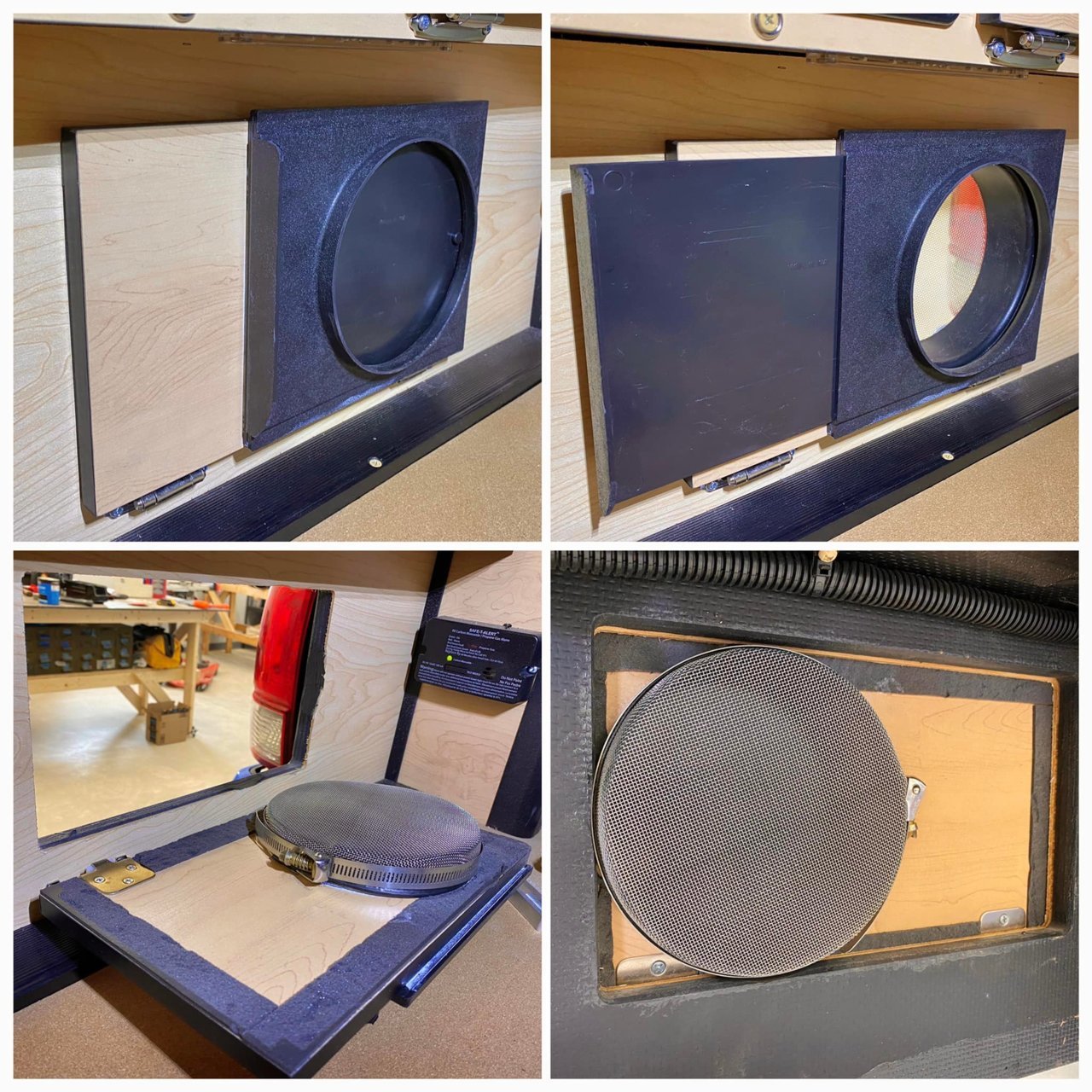

    more simple upgrades:
    Super simple turnbuckle door ventilation.
    Step 1. Poke a big hole in the door.
    Step 2. Install a big blast door.
    Step 3. Add stainless mesh to the outside with a big hose clamp.
    Step 4. Enjoy nice air circulation without the critters joining you inside the camper.
