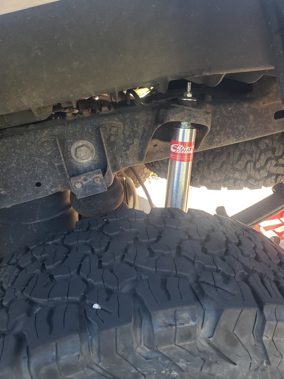

    Does anyone have airbags with their set up and despise them? Every speed bump I go over the back bounces like a pogo stick a few times. Thinking of switching over to a heavier duty leaf pack but $$$$

    if you're getting too much bounce after a bump, stiffening the spring will make it worse.
    you need more damping

    My rear shock absorbers are pretty old. Leaf packs and bags are discussed a bunch in this thread but rear shocks not as much. Suggestions??

    How much pressure are you running in them? Stiffer leaf pack is going to yield the same results.

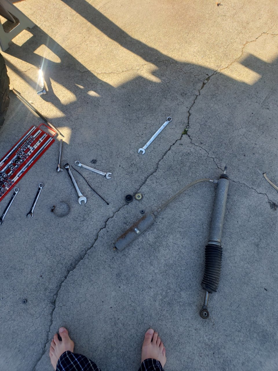

    35psi in the left and 25 in the right. Everything heavy on taco and fwc is on the left side . Yeah the rear shocks need to be replaced. I have some eibachs that came with the stage 1 lift that I'm gonna swap out soon. Bought the truck with twin tube absorbers in the back. Truck drove great with the camper off and I assumed they were better quality but they could be 12 years old . Just seems like the airbags limit the amount of travel back there especially with the cradles.

    I'm running fox 2.0x12 smoothies and have them on max stiff low speed compression setting on the stock valve stack.
    It was good enough with the stock bed + camper but with my additional fuel tank and an aluminum bed for the next season I have a feeling I'm going to need a stiffer valve tune.

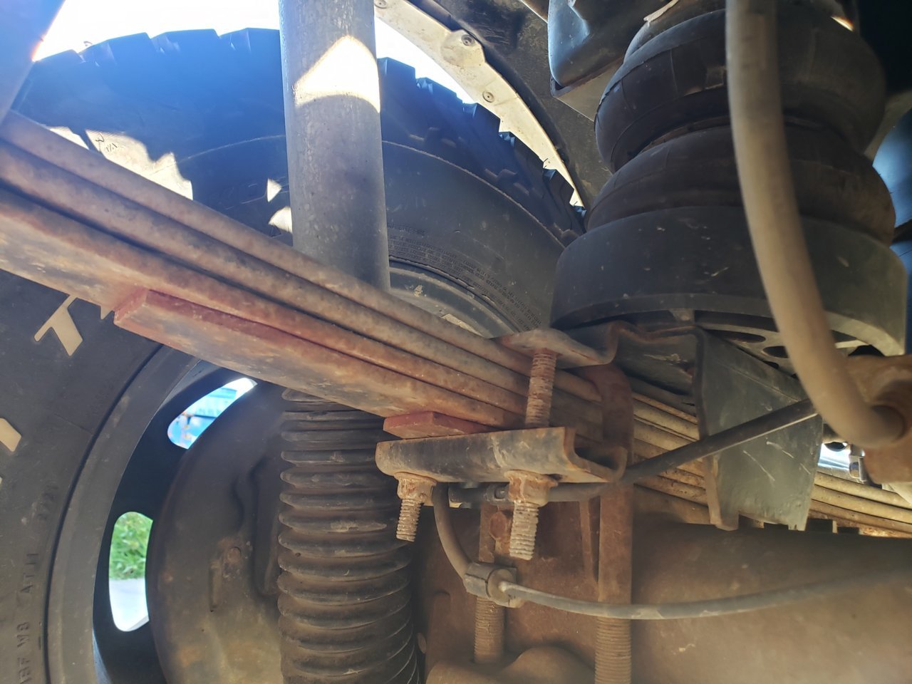

    Nice. Just swapped out some old icons (I think, probably 12 years old) for some eibach stage 1 rear shocks and that didn't make a difference. Here are some pics20230421_080755.jpg 20230421_080751.jpg 20230421_072915.jpg

    remember most bolt-on aftermarket shocks are designed for stock weight vehicles (not even at GVW)
    once a taco gets a fleet on it, you're pretty likely to be well over GVW, so anything bolt-in aftermarket will be underdamped for your use.
    the old school way to get more damping was to bolt more shocks on.
    now there's so many rebuildable and adjustable shocks on the market that make it a lot easier to do.
    I haven't contacted them or ever used them, but i assume companies like accutune can build you a shock that works with your weight and goals, if you are uncomfortable opening up a shock on your own

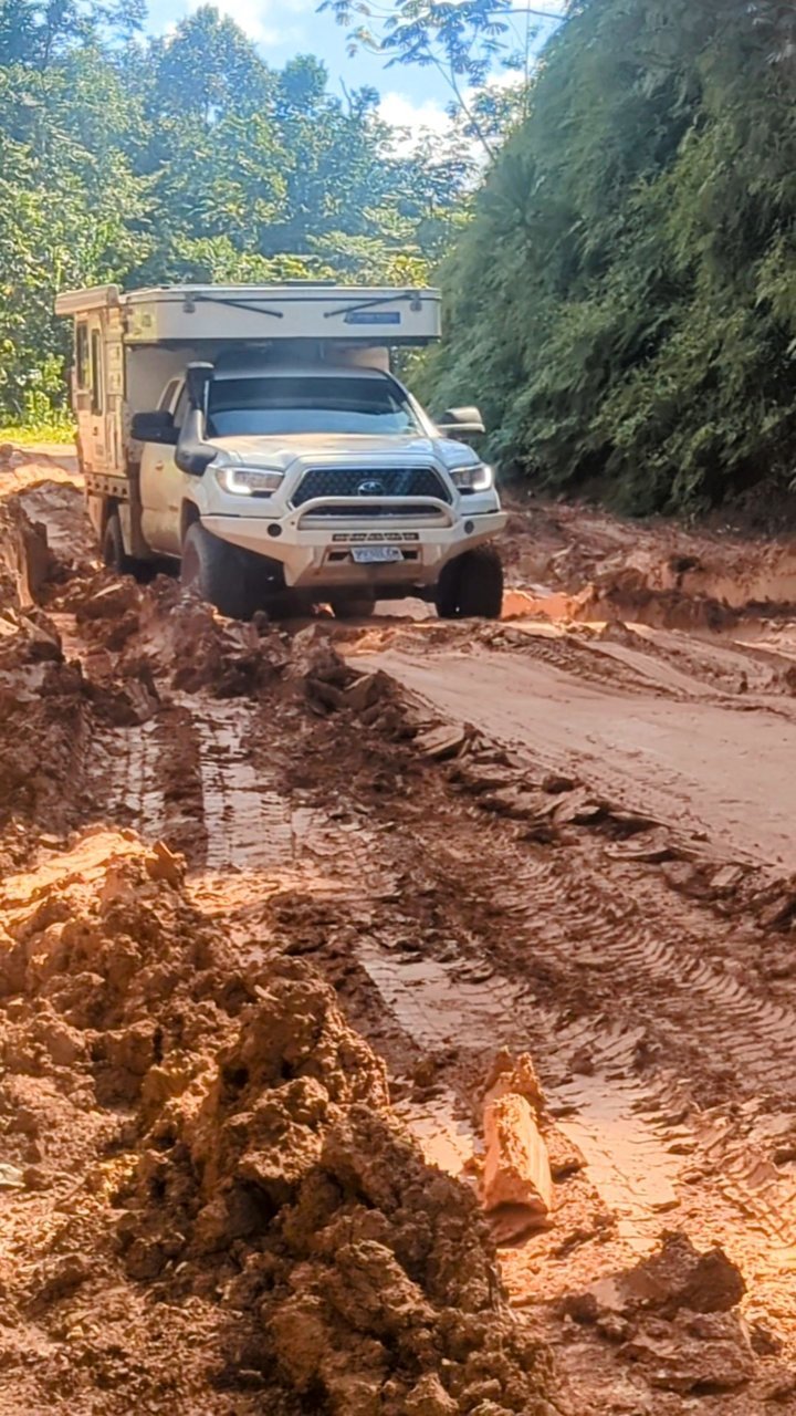

    I think FWC and its dealers are starting to be worried about mid-trucks exceeding their GVWR. We been living in our setup for three years, covering 85,000 miles, doing some very rough roads with few problems, but maybe we’re just lucky. Our truck is about 100 lbs over on the front end rating and 800 over on the rear. But we’ve modified just about everything except the engine/transmission, frame, and driveshafts. It would have been easier to base our setup on a 3/4 ton chassis but then we lose the nimbleness/reliability of the Tacoma
    A muddy road in Gabon, West Africa
    That being said I believe a Tacoma is tough enough to handle it but at a minimum it should have extensive modifications to the suspension. Additionally you should adjust your expectations of acceleration, braking and cornering for safety purposes

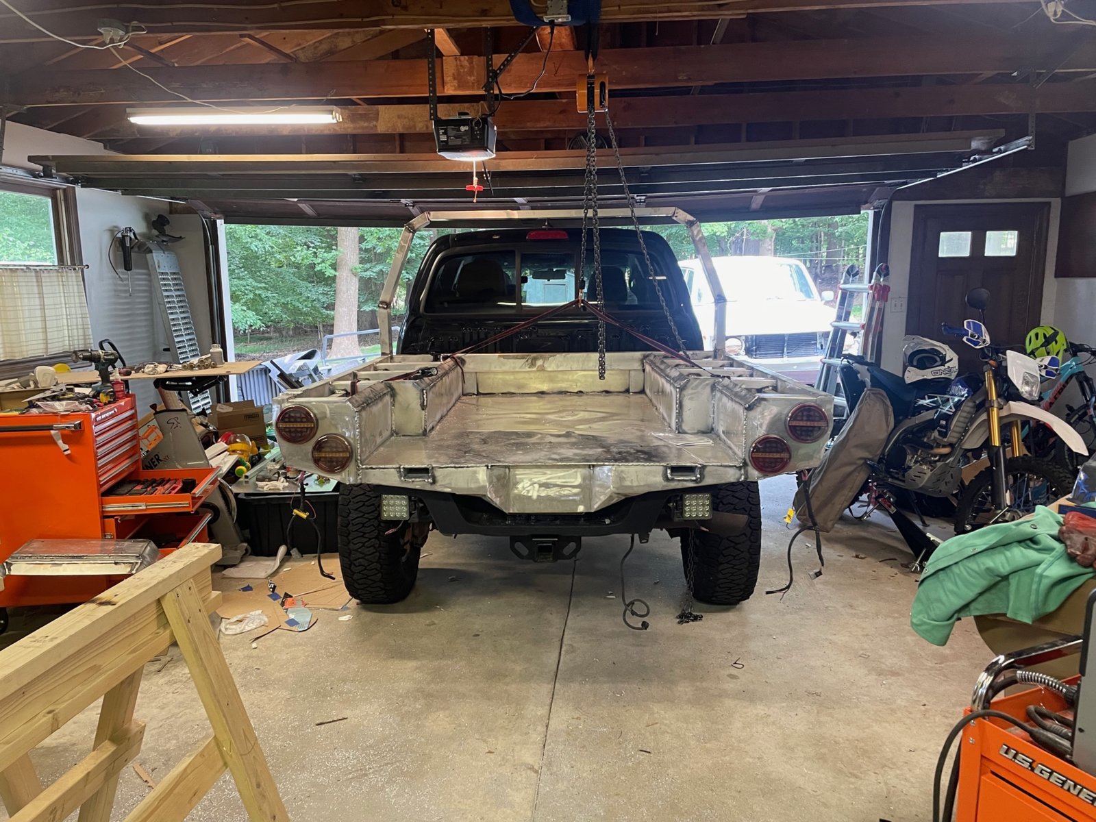

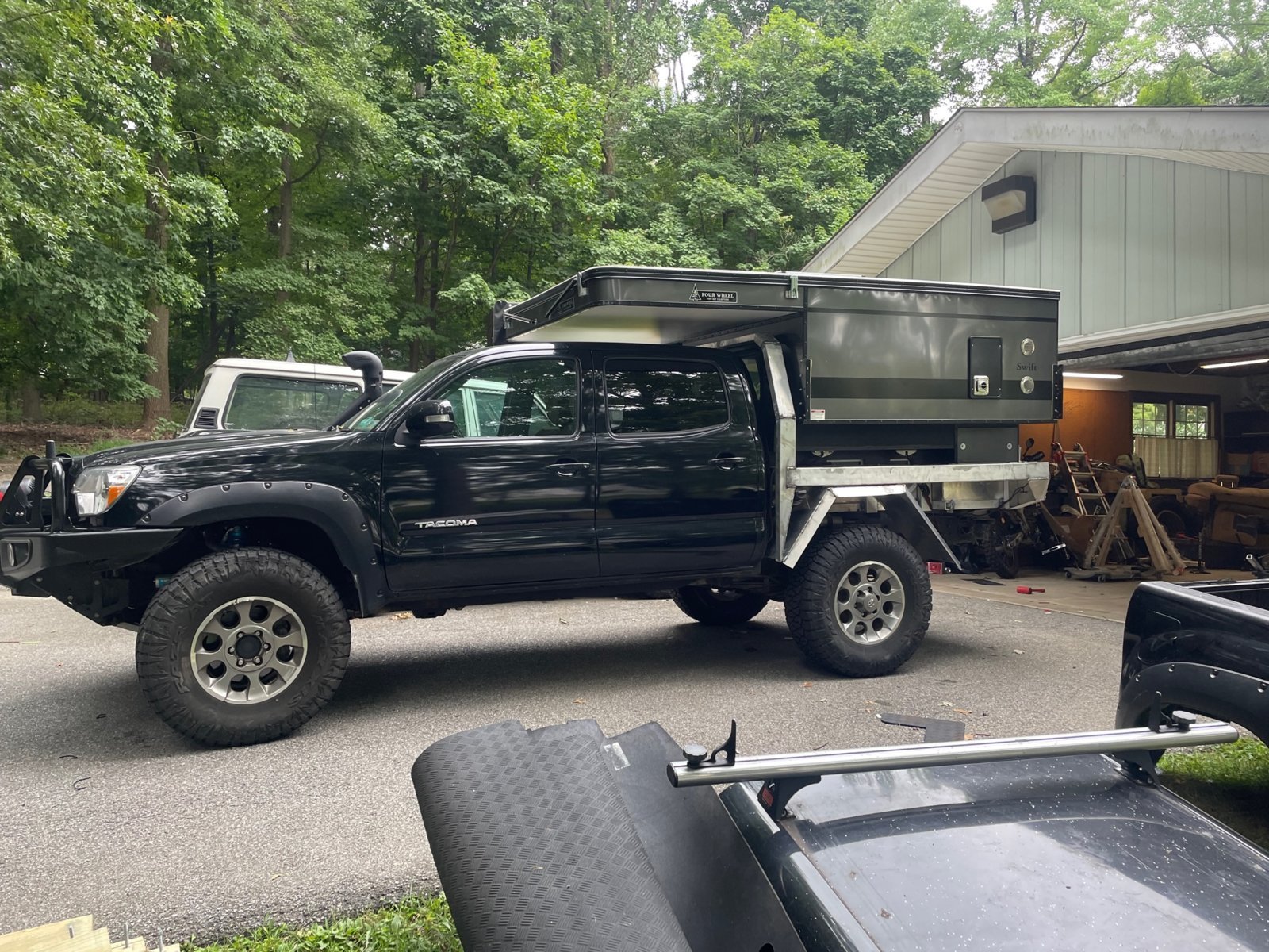

    Got the second iteration of my flatbed design mountable a few weeks ago! This one is all aluminum still working on some wheel well boxes and boxes for the gap between the bed and camper. First trip with the new bed at a local campground went well! IMG_5237 (2).jpg IMG_5244 (1) (2).jpg IMG_5258 (1) (1).jpg IMG_5271 (2).jpg
