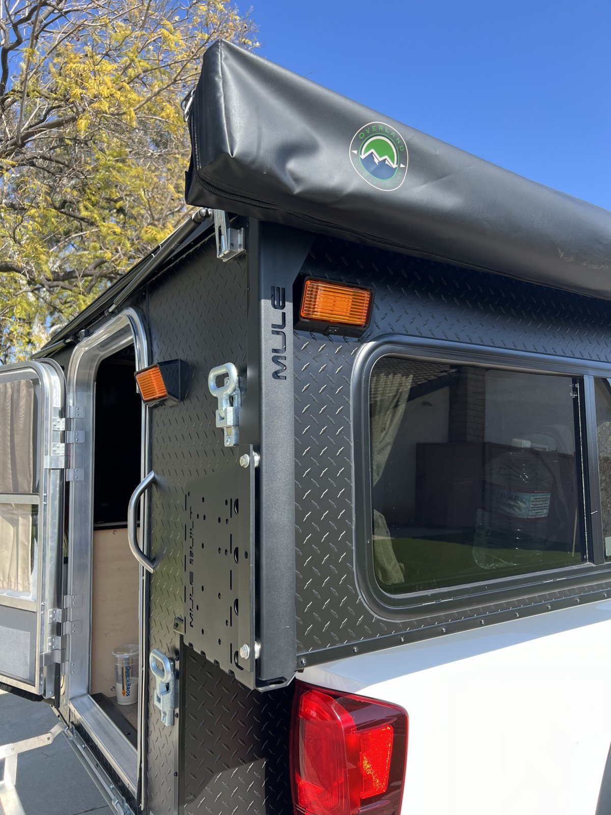

    Mule makes awning mounts that use the jack points.

    X2. Mule mounts are the best.

    Good to know! Is the Mule kit only the two uprights on the Jack points with expectation the awning will bridge the two posts? or does it include a cross bar between the post in case the awning that may not be wide enough to reach both posts.
    Reason to ask is I want to add a shower enclosure which mounts like an awning but is only 42” wide.

    So the awning is what bridges the two mounts together. I mounted my shower awning to the drivers side and mounted it through the outside and attached it from the inside just to have the most secure mounting for that.

    Thanks for info. So basically drill holes thru the wall and bolt from inside out to the shower tent with silicon sealant around the holes on the outside.
    I’ll look for my photos from the FWC open house factory tour and see if I can find a picture of the Skelton to show what structure they have running along the top edge before drilling

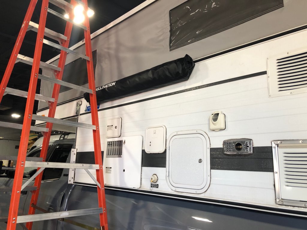

    I had a Zero Declination shower tent installed on my Grandby by a shop in Reno that was recommended by FWC when they were backed up during the Rona. They knew where the frame was and where to drill.
    EDIT: Pic added
