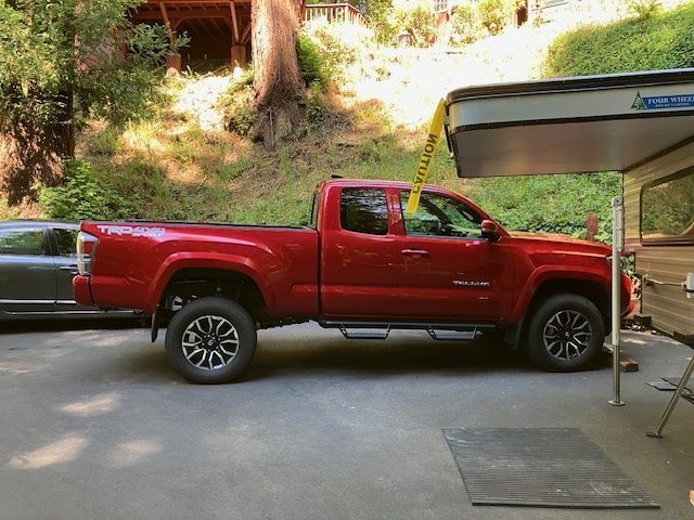

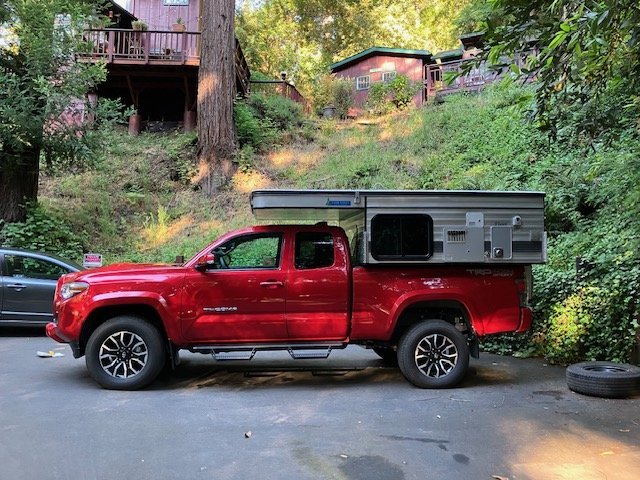

    For comparison, I just installed the Deaver Expedition, Stage 3 springs. Unloaded, the rear sticks up 5" higher than front. It probably would go higher but I kept the stock shocks on to act as limit stops until I get longer brake lines installed. Loaded with a FWC Fleet, it drops a little but rear is still 4" higher than the front. Hoping the springs will drop a little after running a few miles as I don't plan to keep the camper on full time.
    Measurements Unloaded from ground to fender, Stock TRD Sport suspension in front. I should point out ground was not level which may explain difference in side to side numbers.
    LF 35-1/4, RF 35-1/8, LR 41-1/8, RR 40-1/4
    Measurements with Camper, zero miles since installation, Camper water tank 2/3 full, measurements taken on a level surface this time
    LF 34-1/4, RF 34-14, RL 38-5/8, RR 38-1/4
    So far it is much higher than the 2" I expected. Also beginning to wonder if I still need airbags with this amount of lift from the Deavers or if I might have been OK with the Stage II. Next step is to change out the front coil overs to regain the 1" height lost in front from the camper weight.
    Looking for feedback from other with the stage IIIs if the Deavers settles down an inch or two after a few miles.

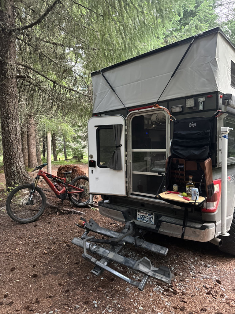

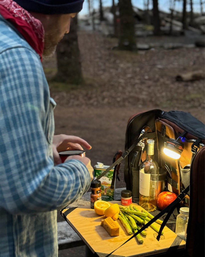

    Howdy Partners,
    Sorry for this quick product plug, but I think it's worth sharing.
    I've been working for this guy Russ and his new company DAYLODGE based in White Salmon, WA. Russ has invented this mobile camp kitchen/tool bench/remote office bag for vehicle-based adventures called the Workspace Table Bag.
    We just set up a local customer with a Workspace to use on the exterior of his 4WC.
    This was our first use of Workspace on a 4WC and it fits to the right of the camper's door, perfectly placed under the exterior light haha.
    We mounted it to the exterior using these Flexmount adhesive anchors (also by DAYLDOGE) + some carabiners and paracord to support the bag's top lid where we didn't have space for additional Flexmounts.
    This creates a bonus standing-height work area on the exterior of any camper.
    The bag can also be used stand-alone on any flat surface and/or you can mount it to the side of your truck bed by the wheel well using the included mounting straps. Super versatile and organized.
    Thanks for reading, comment if you have any questions or ideas!

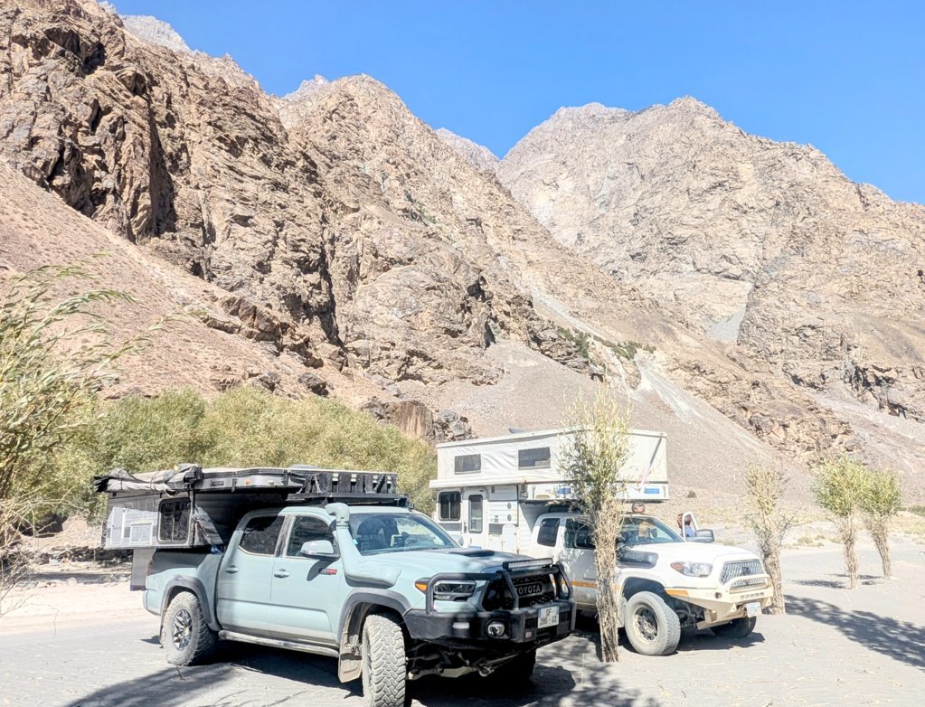

    Talk about a random occurrence. Driving along the famous Pamir Highway in Tajikistan, we ran across a French dude with a four-wheel camper mounted on a 2021 Tacoma. He had ordered both in the US and had it shipped to France.
    Super nice guy. Unfortunately in the year that he's had it, massive delays due to covid, he has his 6' camper mounted on a short bed with a foot projecting out the back. He's been driving it for a year and has already completely cracked the frame above the rear tire and had 3' area reinforced while in Iran.
    Ours, mounted on a 6' bed has 120,000 miles of European, African, and now Asian roads has had only minor frame issues (knock on wood).

    Looks like his sits a bit lower, which could mean he is hitting the bumpstops more often/harder.
    hitting bumpstops is a good way to banana the frame when overloaded.
    Still a bummer though. glad to hear yours is holding up good!

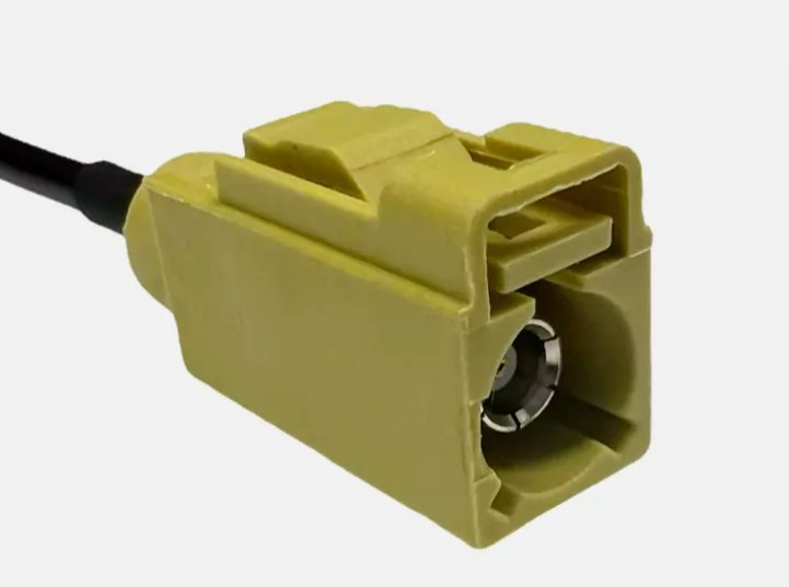

    Reporting back on my last post. IT DOES WORK! I gambled my $16.90 and bought one of these. Turns out it works...if you remove the yellow plastic part. Then it plugs right into back of the stock head unit without need for an adapter. Plastic part comes off easily with a dental pick and common sense. Plus it comes with a shortened 6 ft cable so you're not dealing with 20 ft of cable length when you only need 5.
    I first tried mounting the antenna part to a ditch light bracket but got poor reception, probably because A) ditch bracket was stainless, B) Ditch bracket put it in a location where hood could not create a full ground plane. Have since moved it a few inches forward on the hood and now get better reception but will still drop out occasionally as camper will still shadow the signal depending on direction truck is traveling and position of the satellite. Going to start looking at mast antennas that work without ground plane but have not pulled the trigger. Anyone else use a mast type antenna? Reviews seem mixed on the two brands that show up on Amazon.

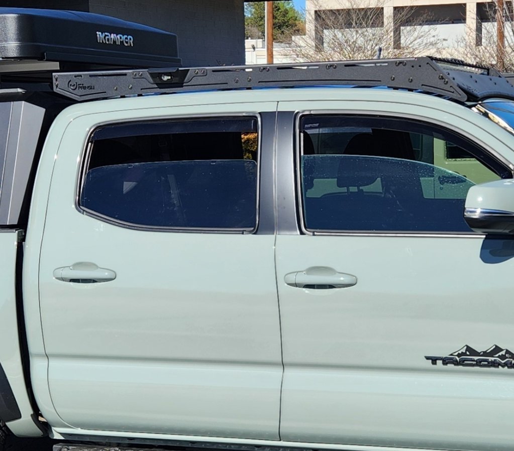

    A question for you all. I'm thinking about getting a Project M but I have a full size Prinsu Roof Rack over the cab of the truck. Will the Project M fit or will I have to remove the Roof Rack.
    Thanks in advance.

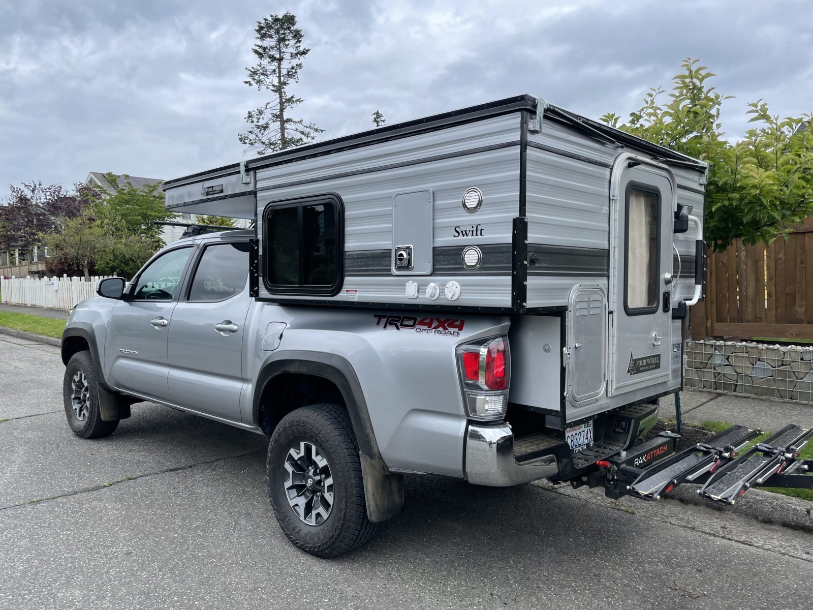

    My swift, (full slide in camper) fits great with lots of space between my rack and camper.
